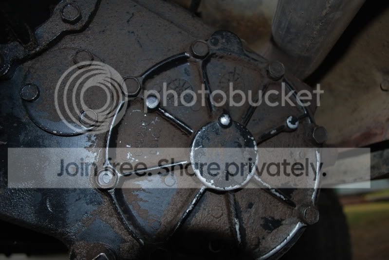

you have a syncro 205 tcase also. the rear cover for the front output has the tear drop on it. sine of a syncro 205.
nice truck.
its in the upper half of the big cover on the backside of the case, its cause this truck has auto hubs right? is having a synchro case a good thing?
its the thing thats kinda rubbed off to silver again, right in the middle above the center circle.

My 88 CC had a fixed yoke. Wes, can you answer this for us?
Yeah, only the crew cabs and cab & chassis trucks got the fixed yokes. All the other trucks got slip yokes, from K5 to K30/35.
