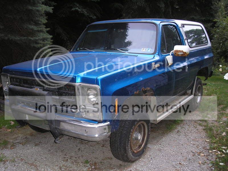

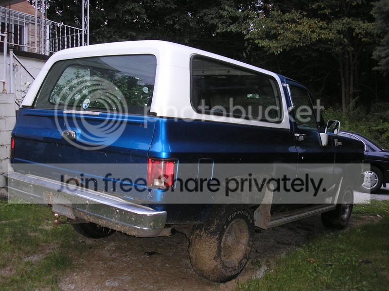

after lots of trucks, i finally got my first blazer. gonna keep this as a street legal wheeler/ light woods machine.
it's an unmolested '79, so i get to do everything to it. it's supposed to have a jasper rebuilt engine in it with 50k. 10 bolt and 12 bolt. got some rust that i'll have to fix. it needs front fenders, and i just sold 2 nice sets of those for $70:doah:. at least it does have new rear springs. not sure what else, didn't look to close yet.
the best part------ IT'S GOT A 465 AND 205!!!:D
i figure on a 4"-6" front spring lift and shackle flip. probably throw in a spare 14bff i have and maybe a d44 that my buddy has with 4:10's . i have a d60 for it, but it's still in a complete truck that i don't know what were doing with yet, it'll end up with one, just not sure when. got a set of 35" boggers that may go on it.
anyway here's some pics. i'll get better ones tomorrow.

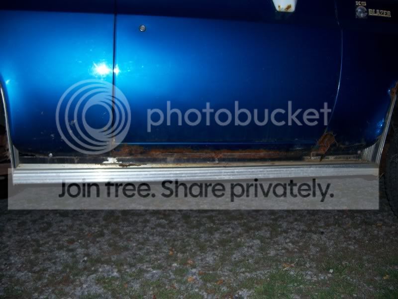

cool truck, never seen a mirror that rusty before :eek1:

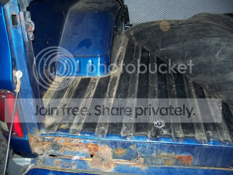

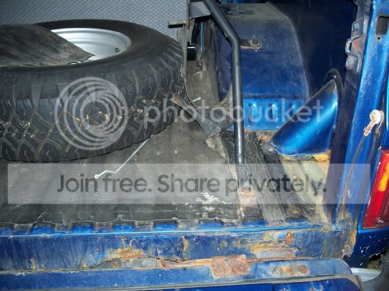

both of them are like that. the rear floor is in good shape except where the left hinge attaches. the frame is very nice.

looks like my blazer before i started aka rust all over don't let the rust intimidate you just cut out and patch one piece at a time. i hope you have your self a mig welder.

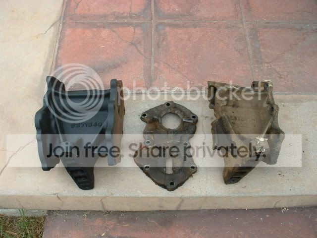

Thats cool your first K5, i picked up my 9th a couple months ago a 76 factory 465/205. Check those motor/tranny mounts real good, if the cross shaft for the clutch linkeage isnt level between the frame and bell housing you better replace them or you will probably end up cracking or breaking the trans/t-case adapter sooner than later.
wow, never seen a adapter break like that, usually we just break the right side foot off. i do have a mount i need to replace on this one.

x2 on the pics. overall rust does not look that bad for a truck in these parts. i have seen and had much worse.:D
