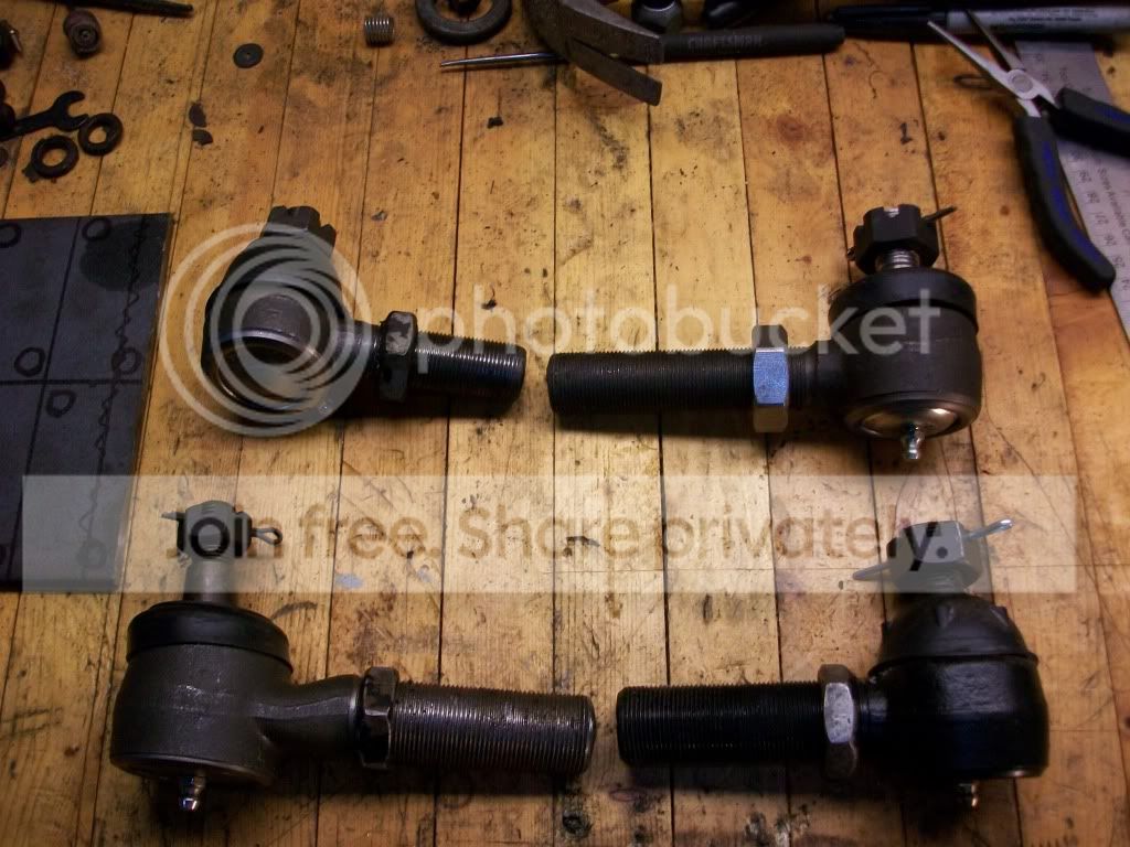

New TRE's in the crossover stuff and a new draglink.

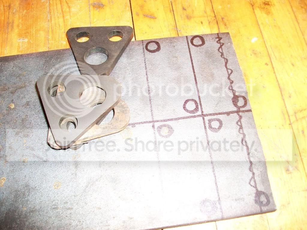

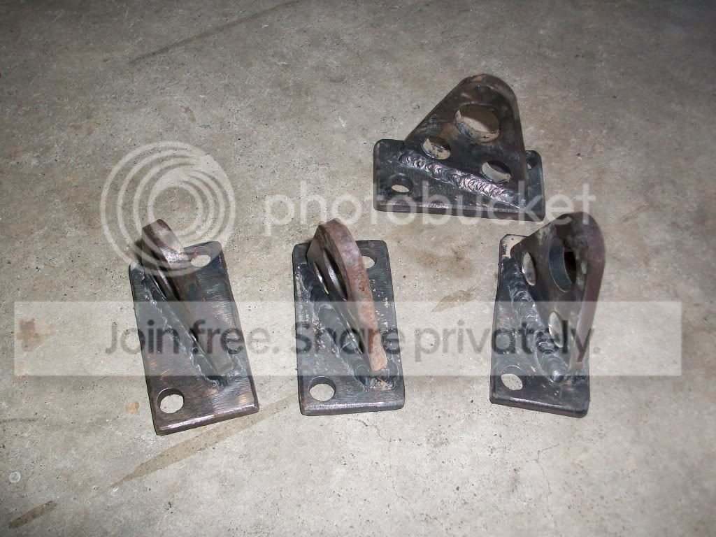

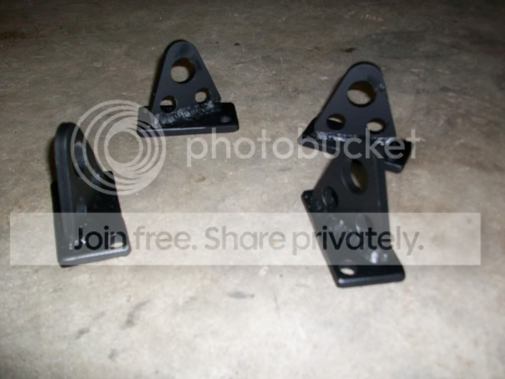

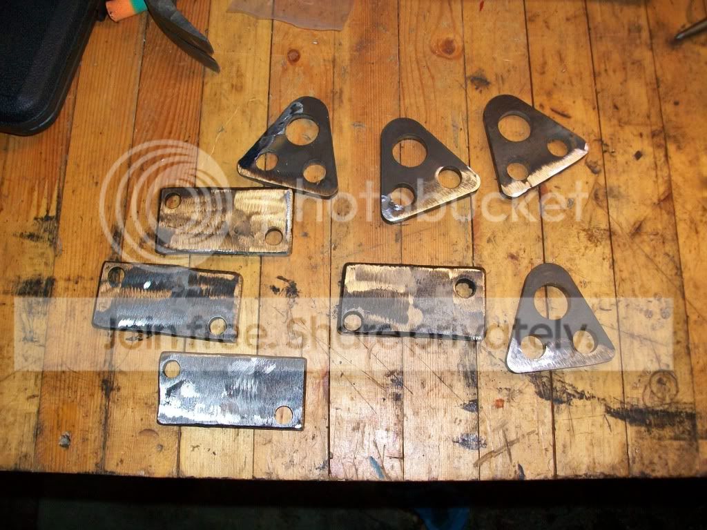

Tie downs. Some 1/4" plate and some 45* gussets from DIY

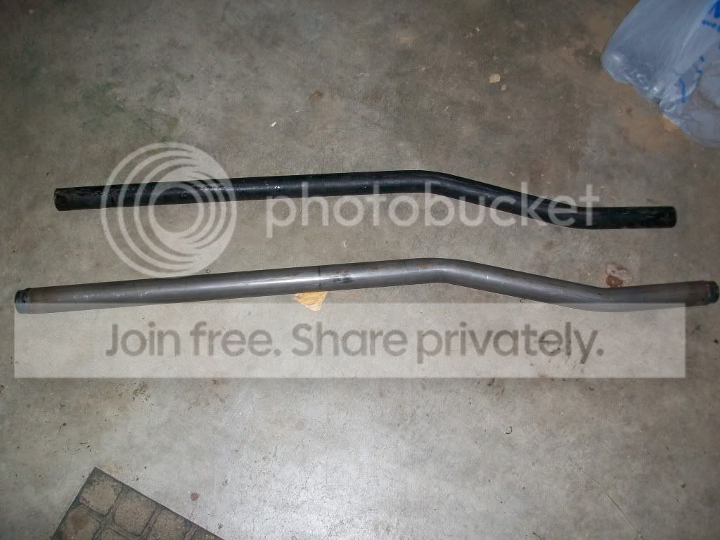

New TRE's. Ended up having to get a new draglink because the old one's TREs rusted in and I messed up some threads getting it out. Rather than trying to find somebody with 7/8 RH and LH taps to clean up the threads I just opted to get a new one made at my local shop. Also I had never really noticed before that my old one was a little short and I wasn't getting full turns to the right so I had this one made the right length to run the short ends.

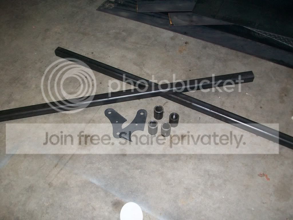

Next project will be an Anti-wrap bar for the rear.
I will be using 2" square tube .250 wall with bushings on the axle end and a Ballistic joint on the other.
Ballistic Joint
Threaded bung for adjustability.
Greaseable Bushing sleeves and axle brackets from DIY4X and some tubing.
Finally something good to see.:D Looks great, I really dig the tie-downs. I wish I had thought of that for mine, it's so simple and yet so much cooler than buying some cheap mass produced hook/loop.:wink1:

Thanks man! Yeah I was tired of having tie down straps hooked to random things with stuff sliding around back there. I'm in work on a rack system for my ammo cans and trail box with some sort of flip up mount or swing away for my spare as well.
