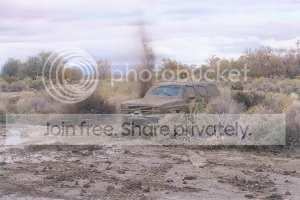

Testing out the 37's
Testing the Warn :crazy:
This whole set up worked great and besides a few axle shafts up front i didn't change much for a couple years.

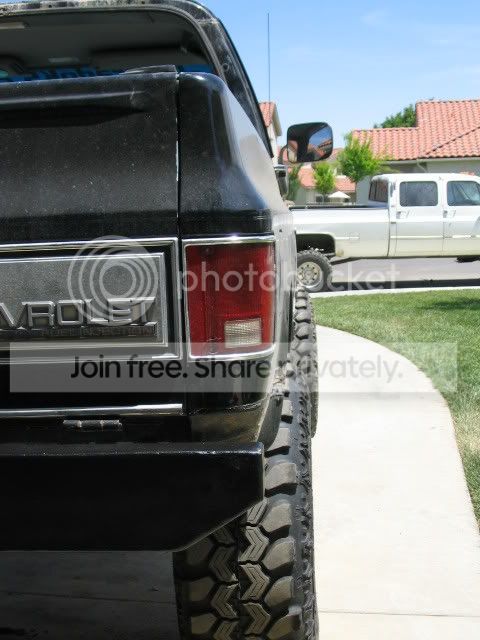

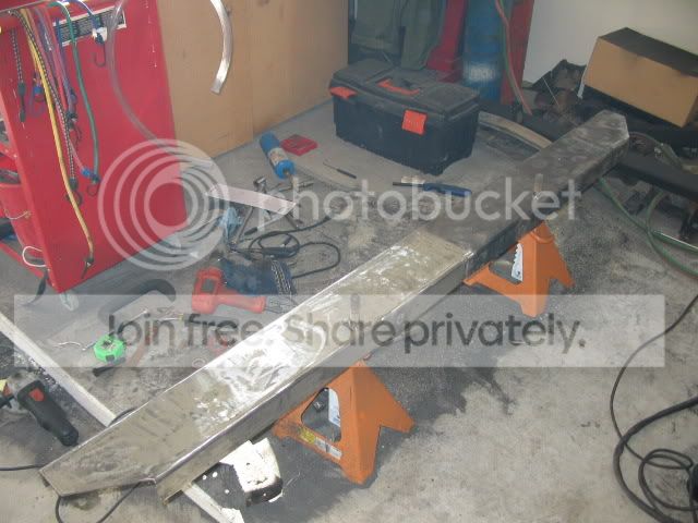

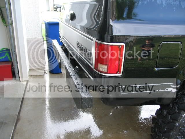

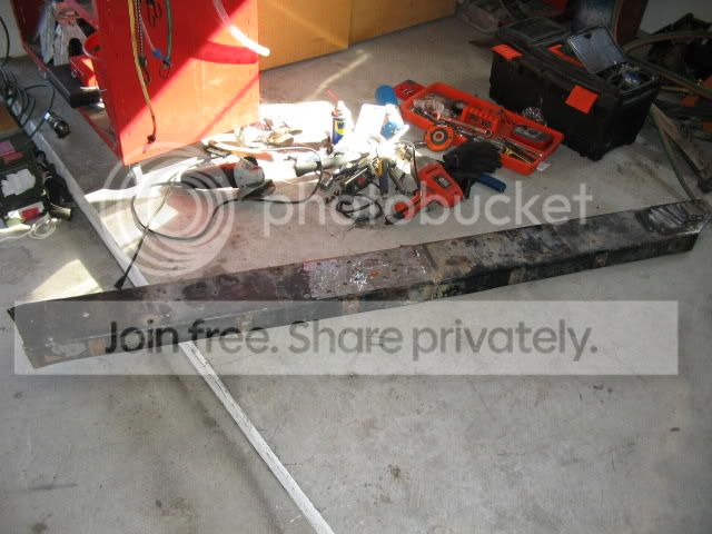

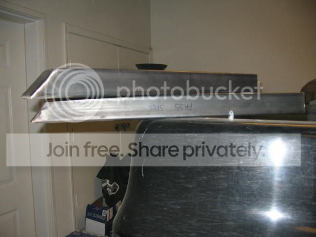

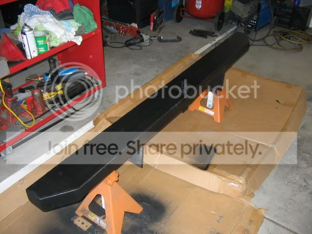

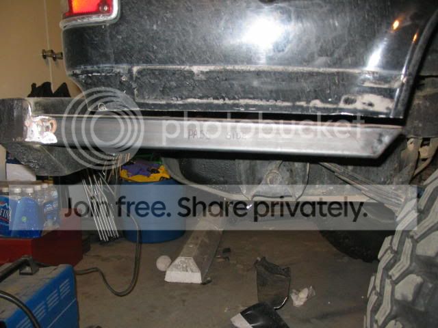

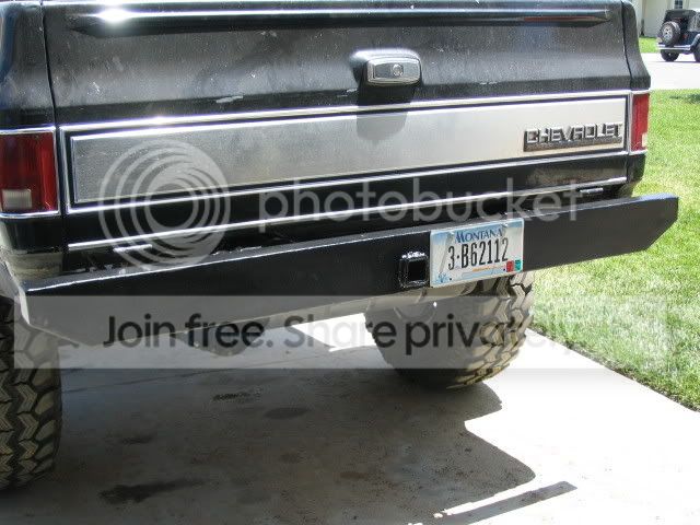

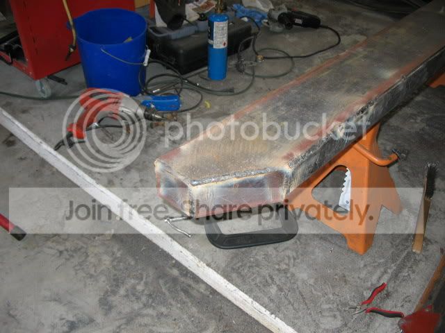

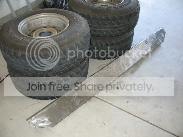

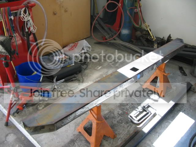

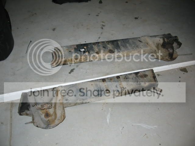

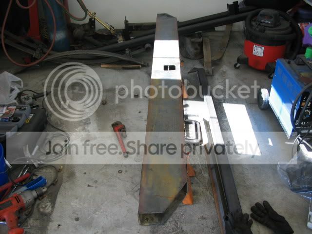

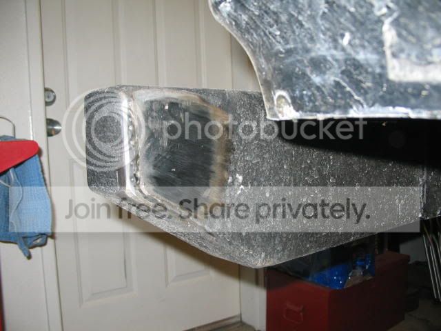

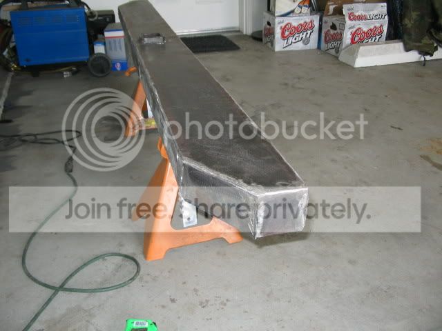

I needed a rear bumper, so I figured I'll build one again. I had scrapped an old truck in NV, but kept a couple chinks of straight frame sections of scrap.

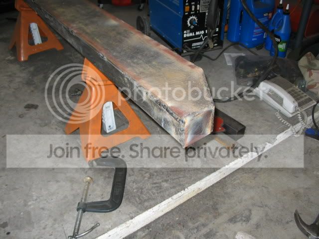

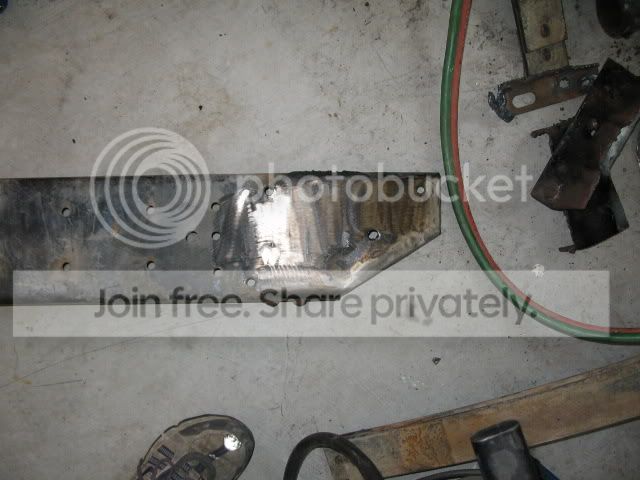

Trimmed the ends and welded them together. Tapered each end as well.

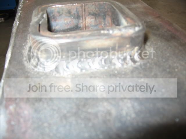

Then i filled all the holes and ground it smooth. Filling holes sucks!

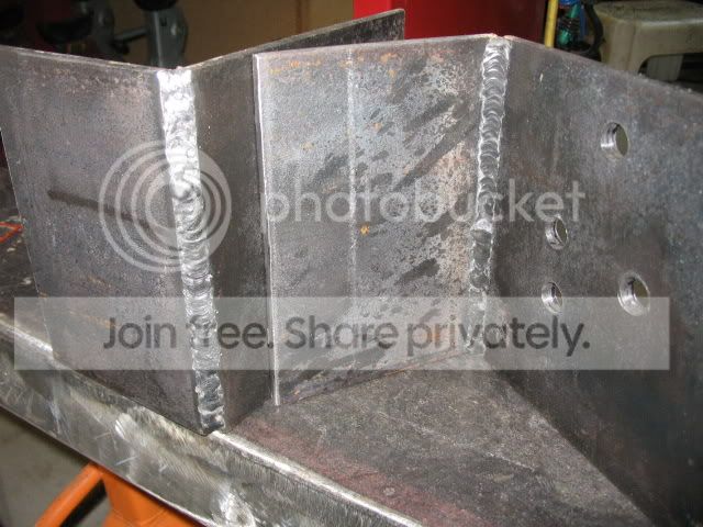

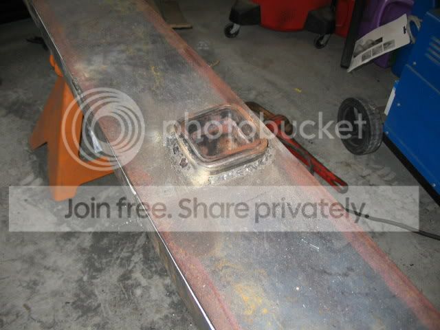

Bought a piece of 3/16 steel to enclose the other side of the channel. This will be the side everybody can see. :wink1: Cut holes for a reciever.
Capped the ends and started tacking it together.
Not the best looking welds, but this project made me much better at it, and cost very little.

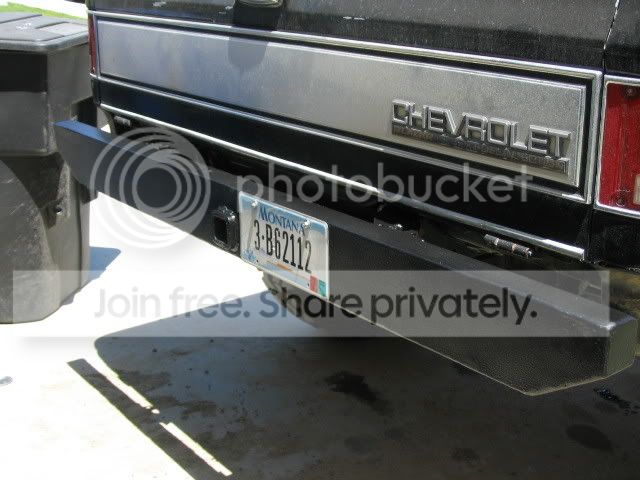

I used my old stock reciever, but recessed it so the pin goes in the back.
Built some brackets to mount it and ground it all smooth.

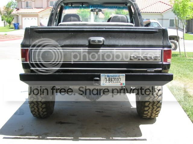

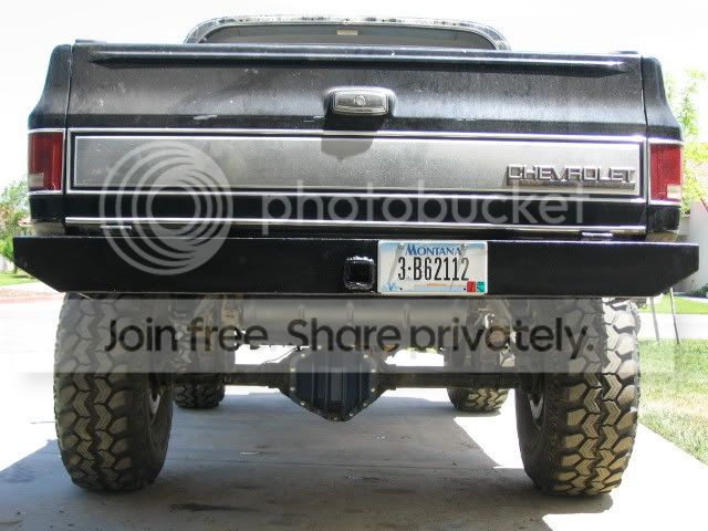

Got the bumper painted and mounted up.

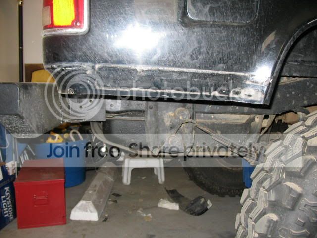

Decided to trip the quarter panels so I built some short sliders off the bumper.

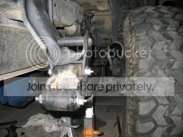

I had picked up some 56's around this time cheap from Esteban86k5 so I figured I would do that swap along with an Echobit flip as well.
The shackle angle turned out horrible and I was getting ready to deploy again. I threw my Superlift rear springs back in and left the shackle flip swap for another time.

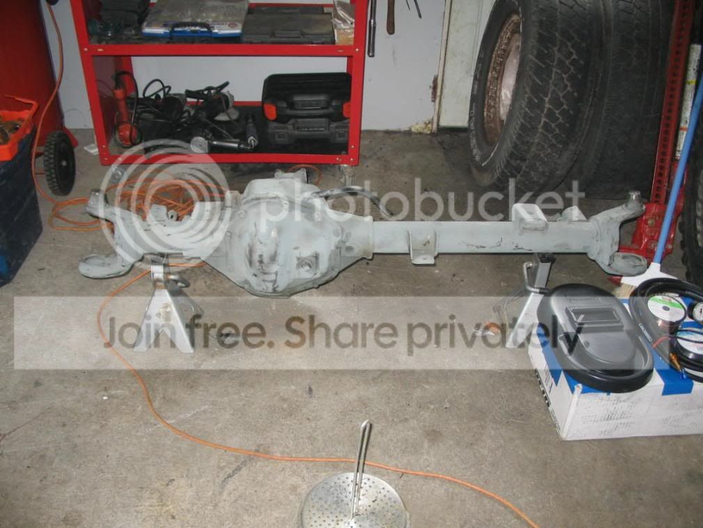

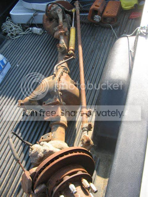

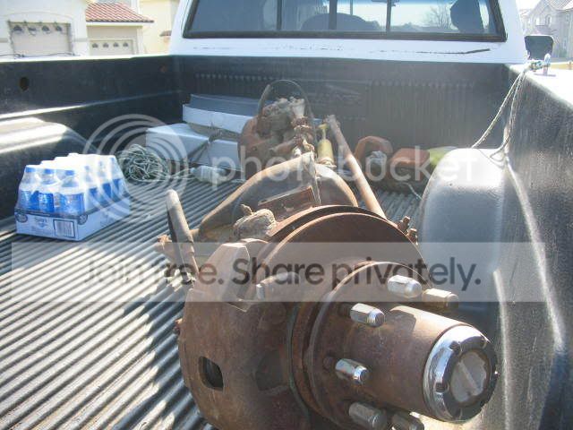

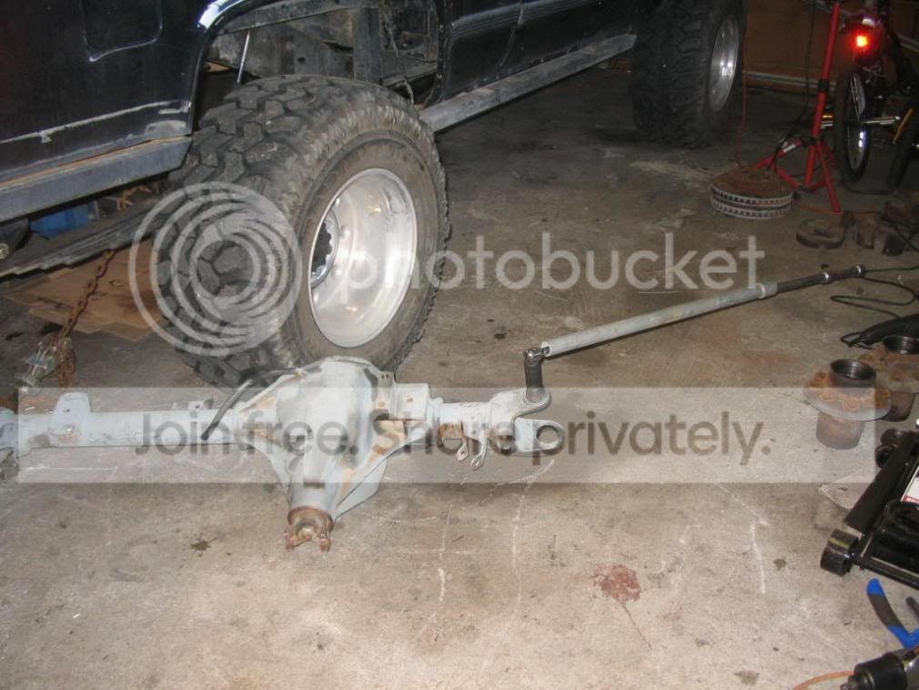

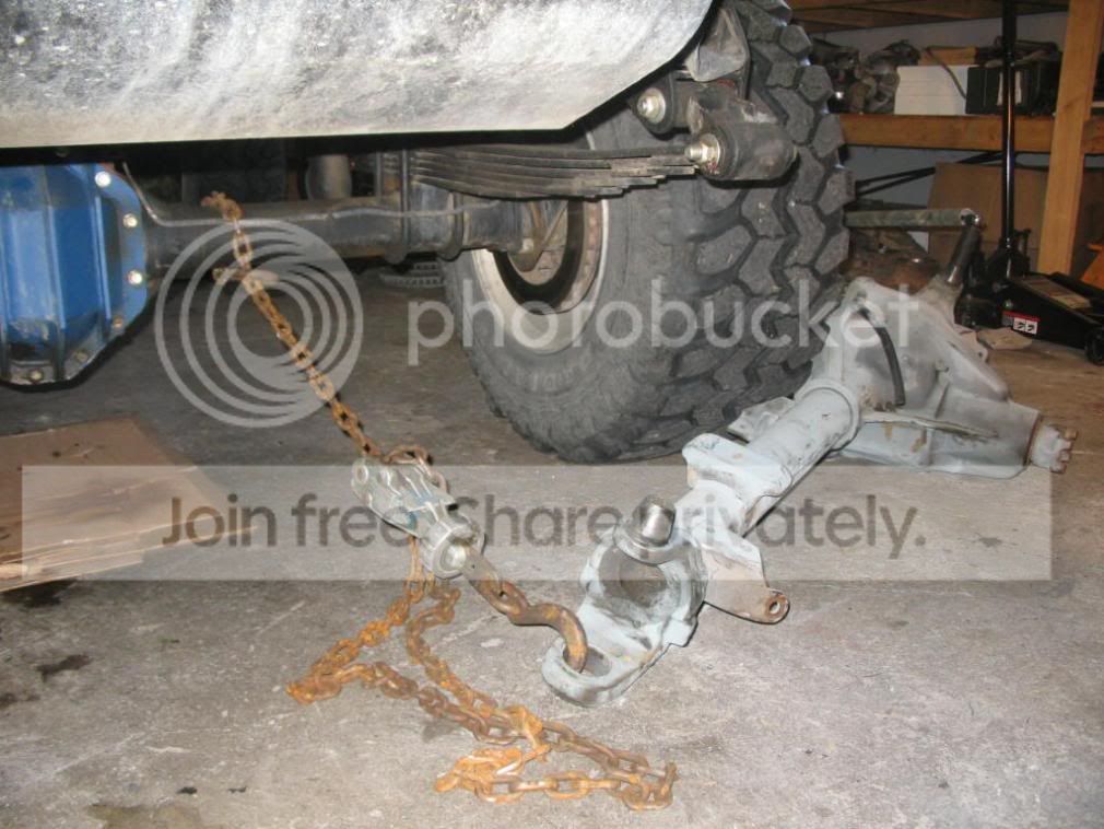

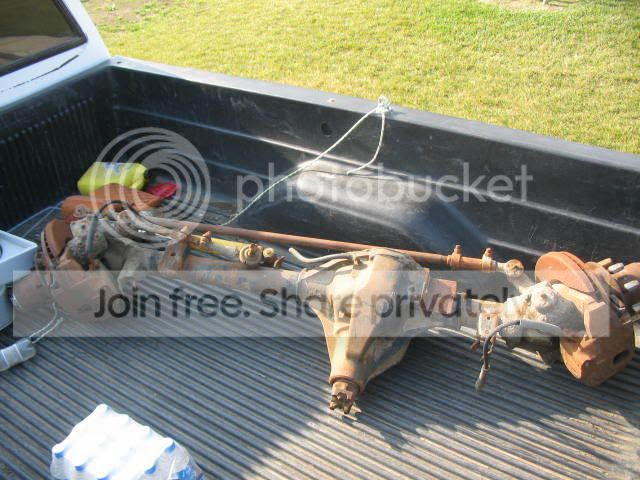

Enjoyed a few small trips into the Sierras before I left and stumbled across a guy who had a "big" front axle out behind his barn. I went to take a look.
Ask him what he wants and he ponders and says I don't know $400:wink1: So I picked that up of course. Only downfall is he said it was 3.73. Oh well I guess I'll re-gear it. Price was right.

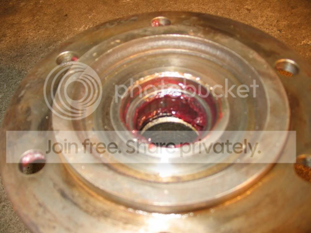

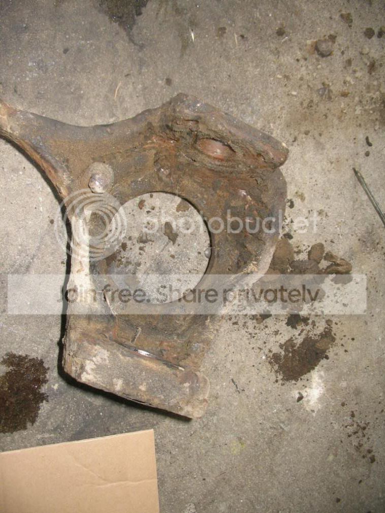

Had a little time before I left so I figured i would take it apart and check out the condition so i know what I need to save up for on cruise. Bearing hubs looked great and had lots of fresh grease. Kingpins were a different story. Shot some primer on it and left it that way ready to be rebuilt when I got home.

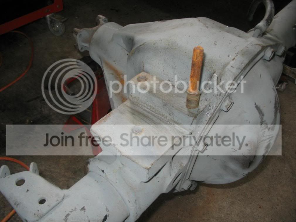

Also had a broken stud in the housing so i pulled that out.

56's out back with Echobit flip.
kerts USDR rear shackles
52's up front the old fashioned way
7.25 DIY shackles

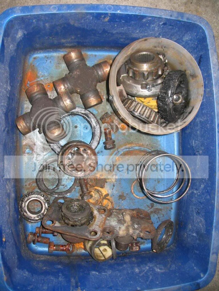

Old dirty parts

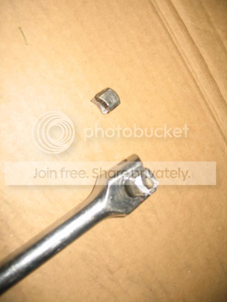

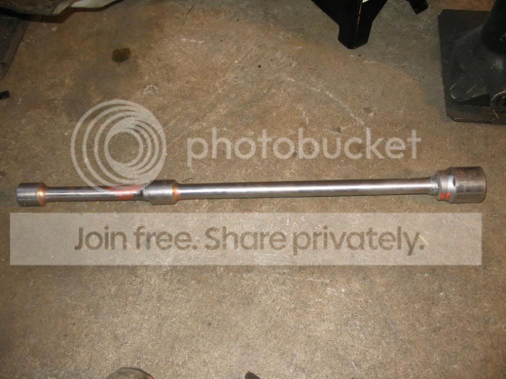

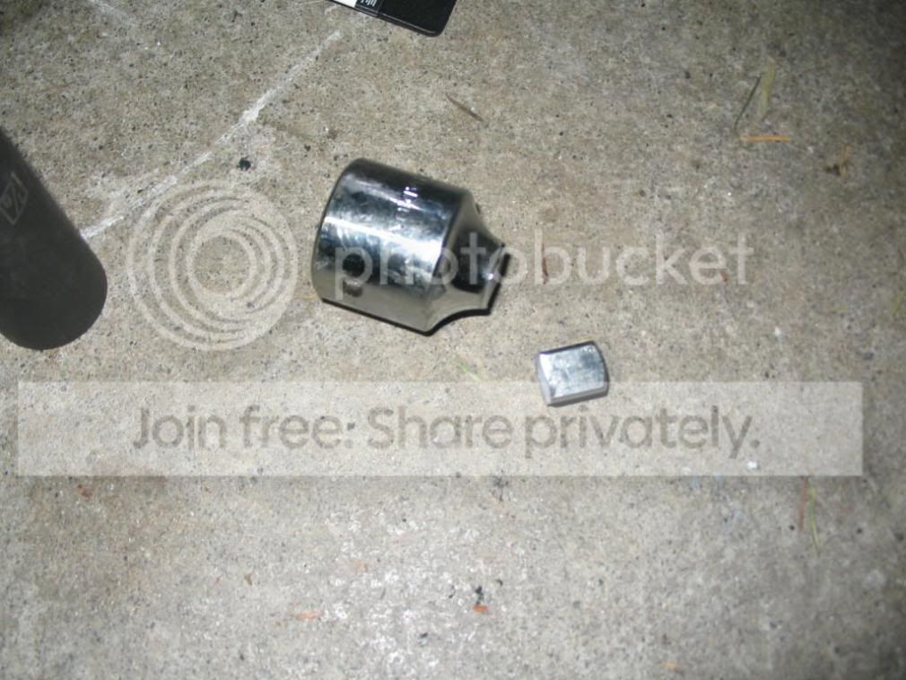

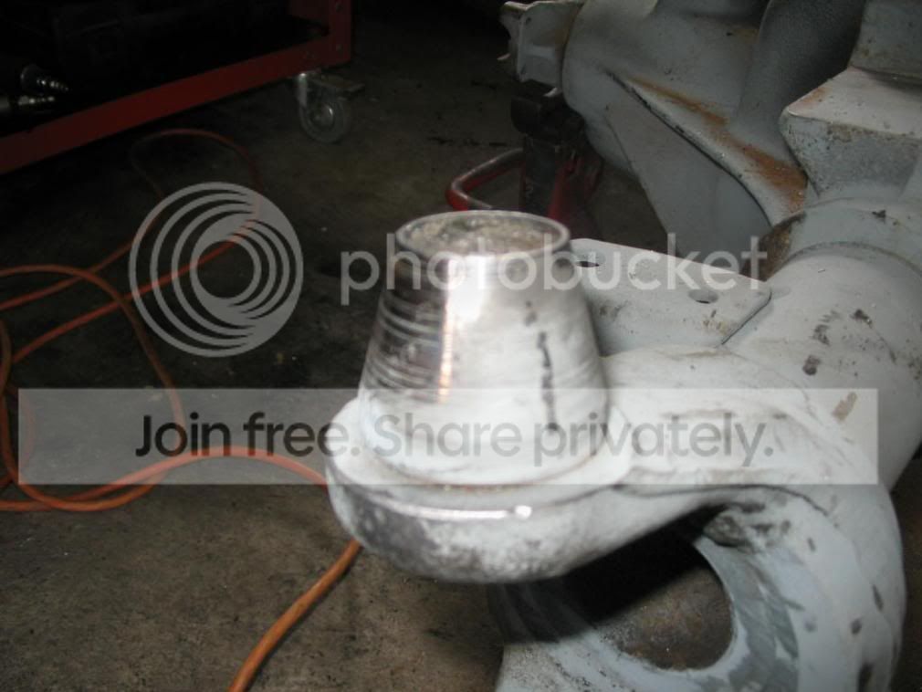

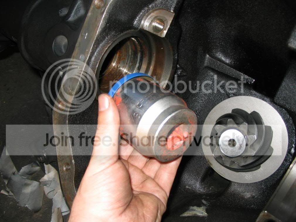

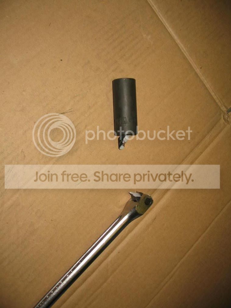

Removing Kingpins..difficult with a loose axle on the floor:wink1:
1/2 inch drive tools proved to be unsuitable for this task
Casualties
1 napa breaker bar
1 Craftsman breaker bar
1 3/4 to 1/2 step down
1 pass side door when the first breaker bar broke :haha::haha:
OOps

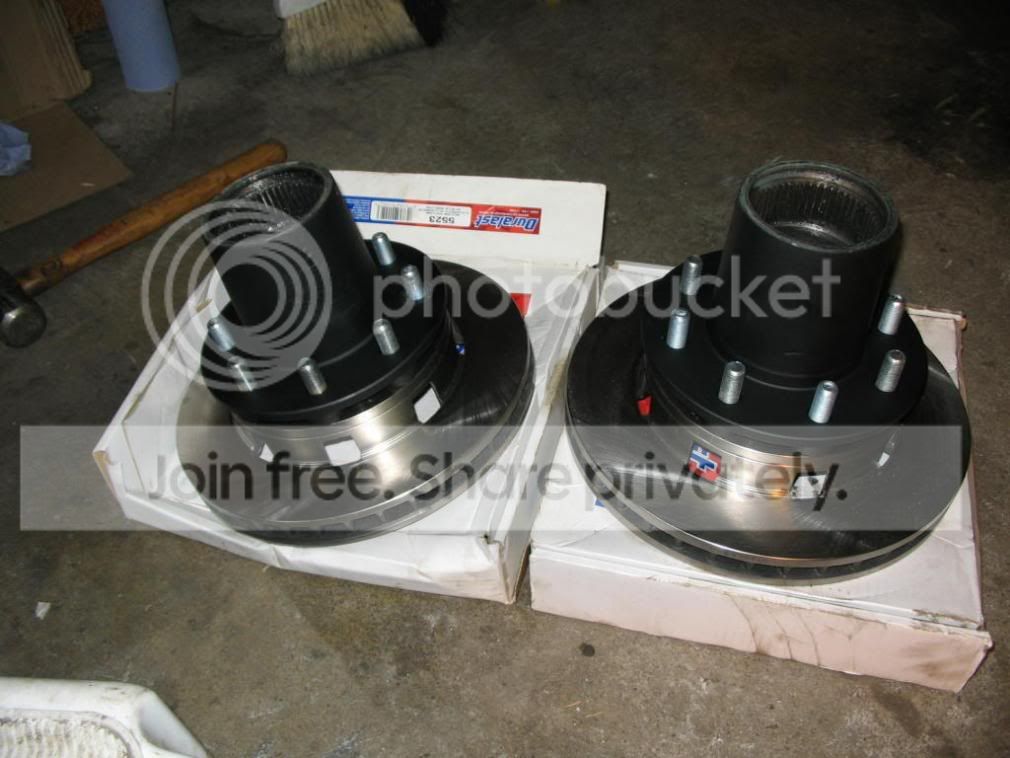

4x4High sent me a piece of 7/8 stock and I got a 3/4 drive socket and got them out finally:D

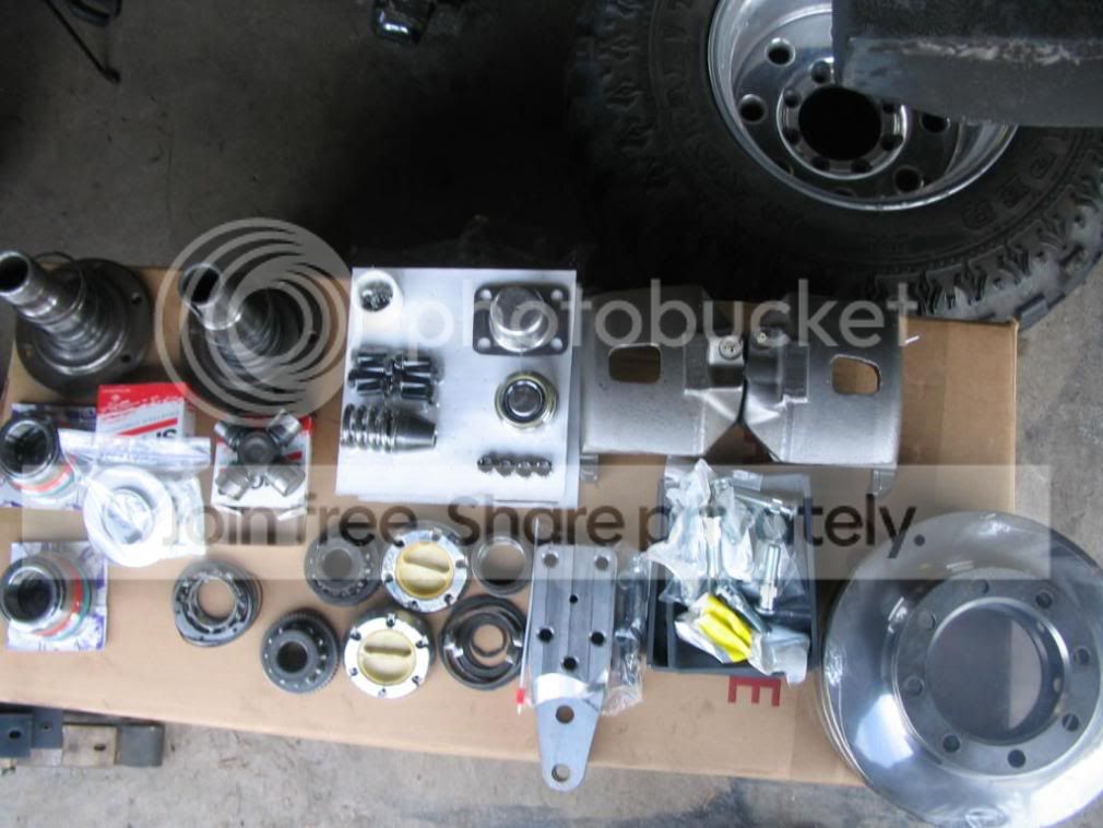

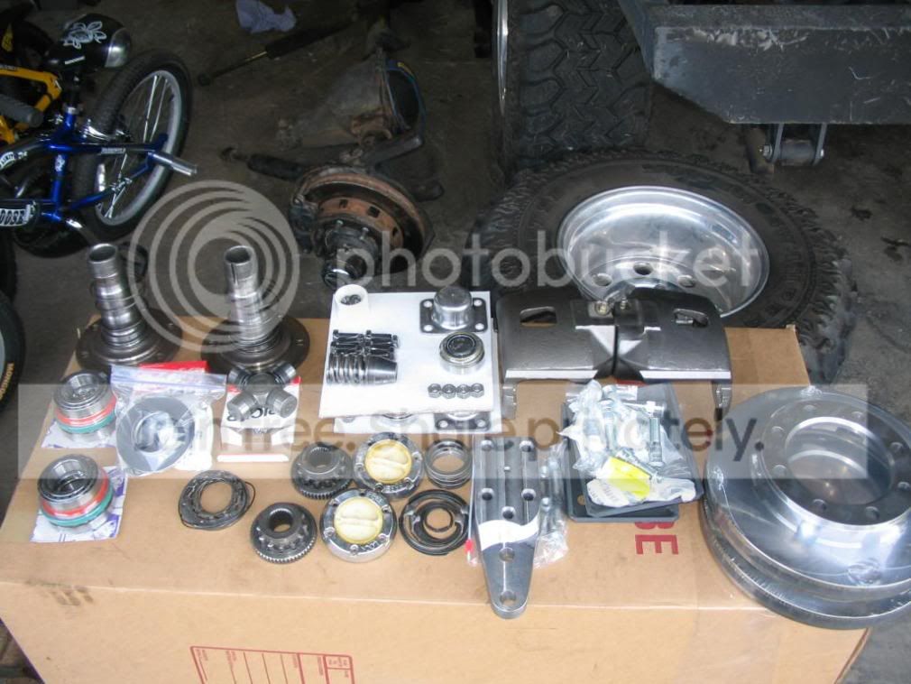

New shiny parts.
Kingpin rebuild kits
Wheel bearing rebuild kits

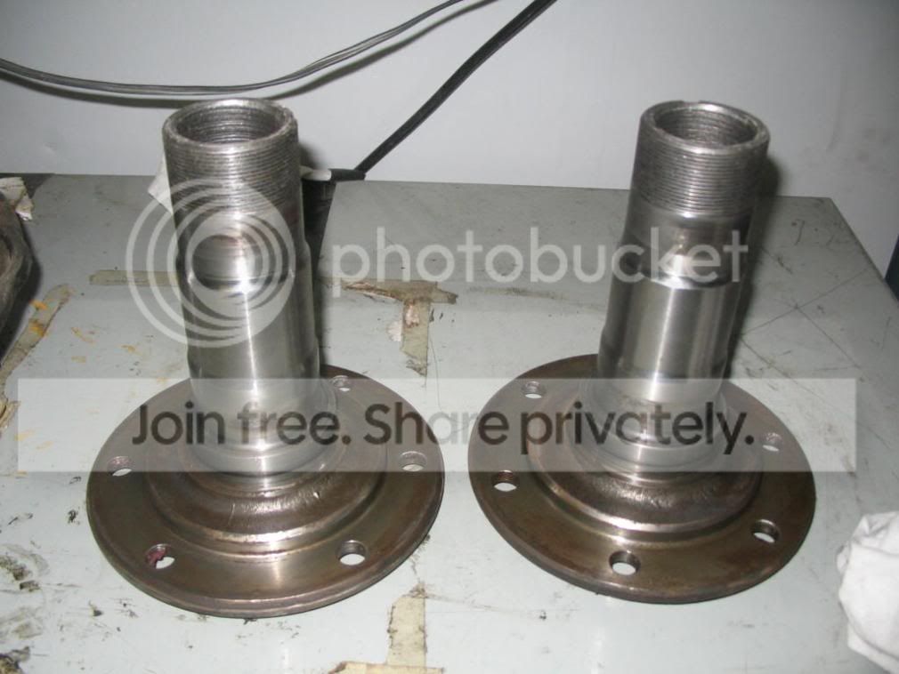

Spindle rebuild kits
Calipers and pads

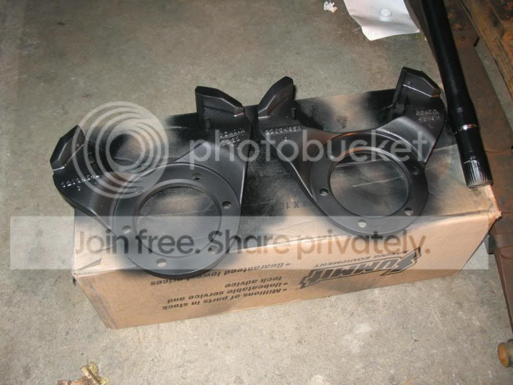

DIY4X spring plates
Wheel studs
Rotors
Sky steering arm
Spicer U-joints

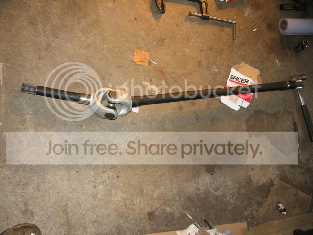

Also picked up a CV rear shft and long slip front shaft

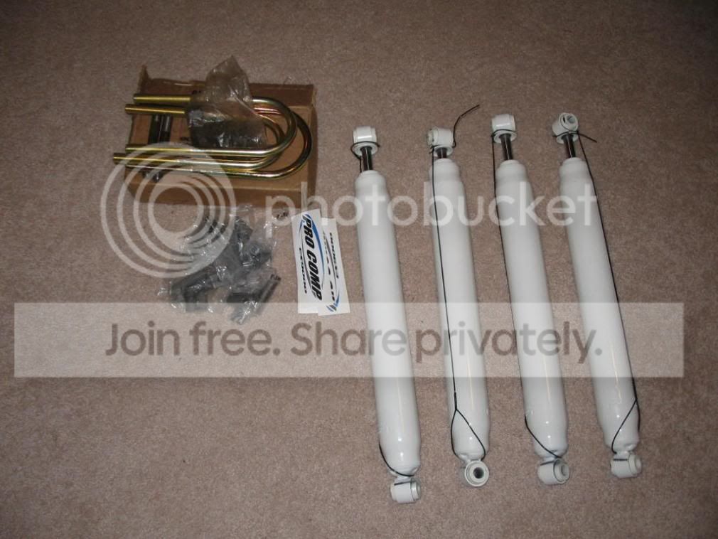

Pro Comp 15" travel shocks and U-bolts

do you have any more pictures of that rear bumper?
Yeah I think I have some more. If not I'll take a few. It needs to be re-painted. I'll try and get them up tomorrow.

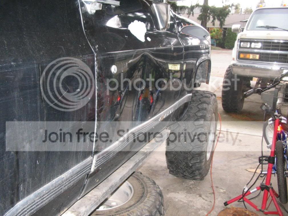

VERY NICE BUILD! and im doing a balancing act with my truck, i want to get it rust free and nice and shinny black and go wheelin,i could care less about scratches or deeeep scratches,but if theres a single tree in my path,for my bodys sake, its coming down if i have no other options. some people may get mad but, i like my body lines... u can always re paint it and put stock axles in and stock bumpers back on and it will be a perfect restored rig.i want a girl that can take a beating and still look beautiful:D kind of like a lot of guys do with jeeps, VERY capable but still and straight body. but its not easy.

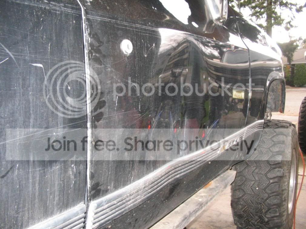

I really don't have much for body damage and the worst thing about the paint is how faded and oxidized it is. Being stationed in nevada for 3 years and CA for 3 years didnt help that. The dent in the door will pop out I'm sure. I kissed a tree with the right front fender so it has a small dent. but I try and keep it somewhat straight.

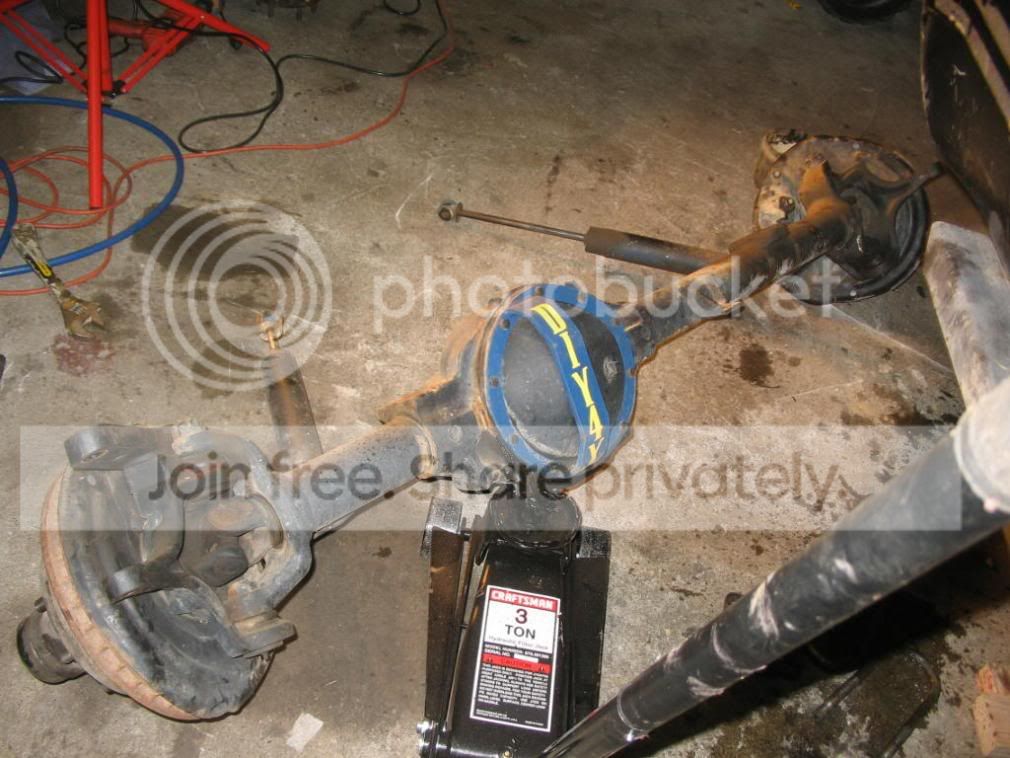

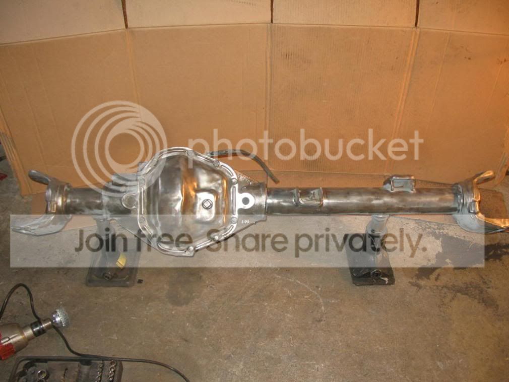

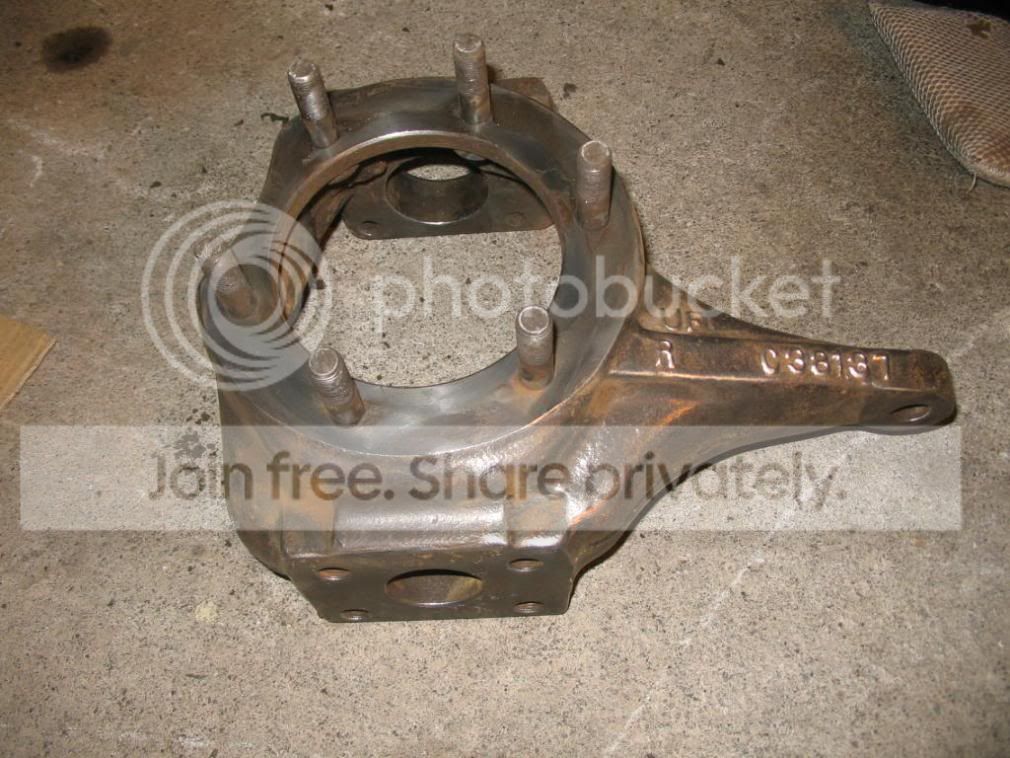

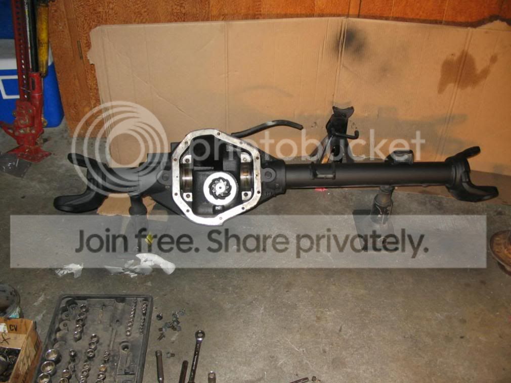

Thanks for all the compliments guys. Ok back to the build. Got those Kingpins out and started cleaning up the rest of the 60.
Spindles and knuckles cleaned up
Housing cleaned up nice and ready for primer.

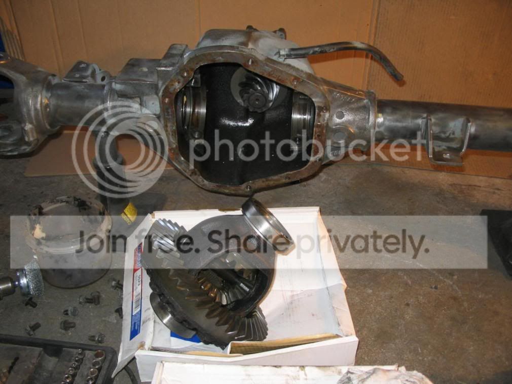

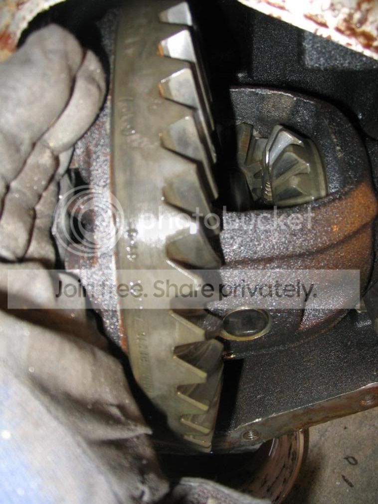

Oh found out something during all of this. The axle was geared 4.56 not 3.73 so I decided to leave the front alone and just find a matching rear or re-gear my current one.
4.56 :wink1:

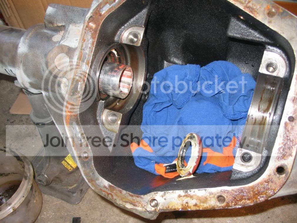

Carrier out. I used the rag method.
Big socket and a couple extensions.
Inner seals out
New seals in after i cleaned the tubes out good.
All cleaned and primes with new seals!
New Spindle bearings.

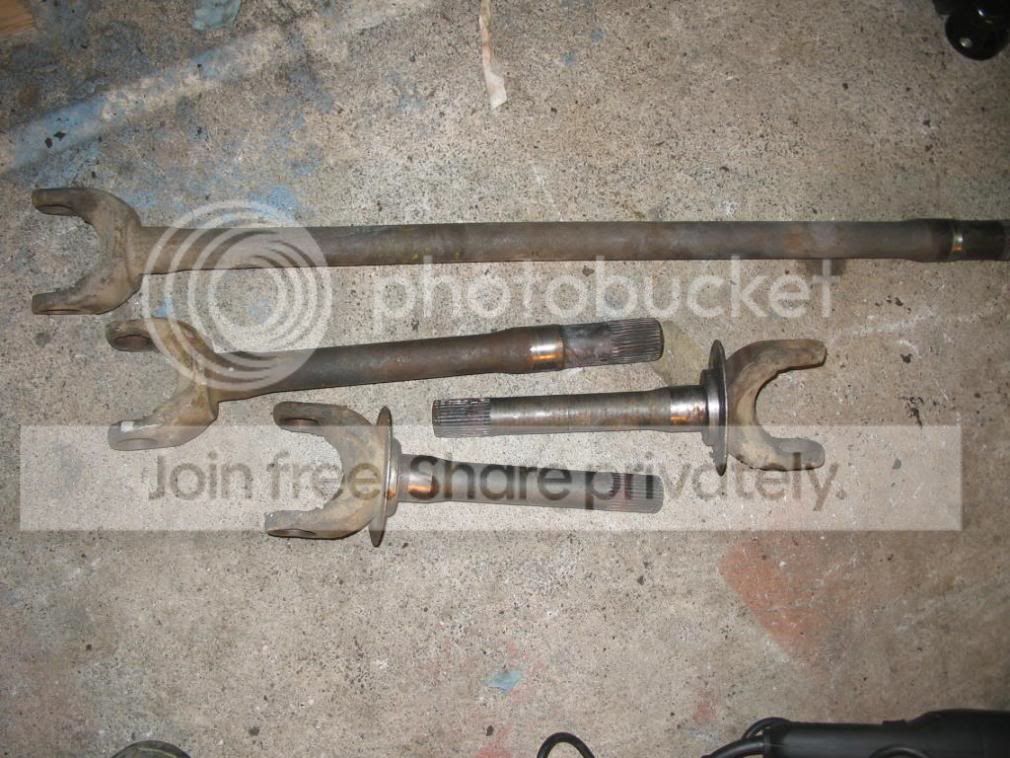

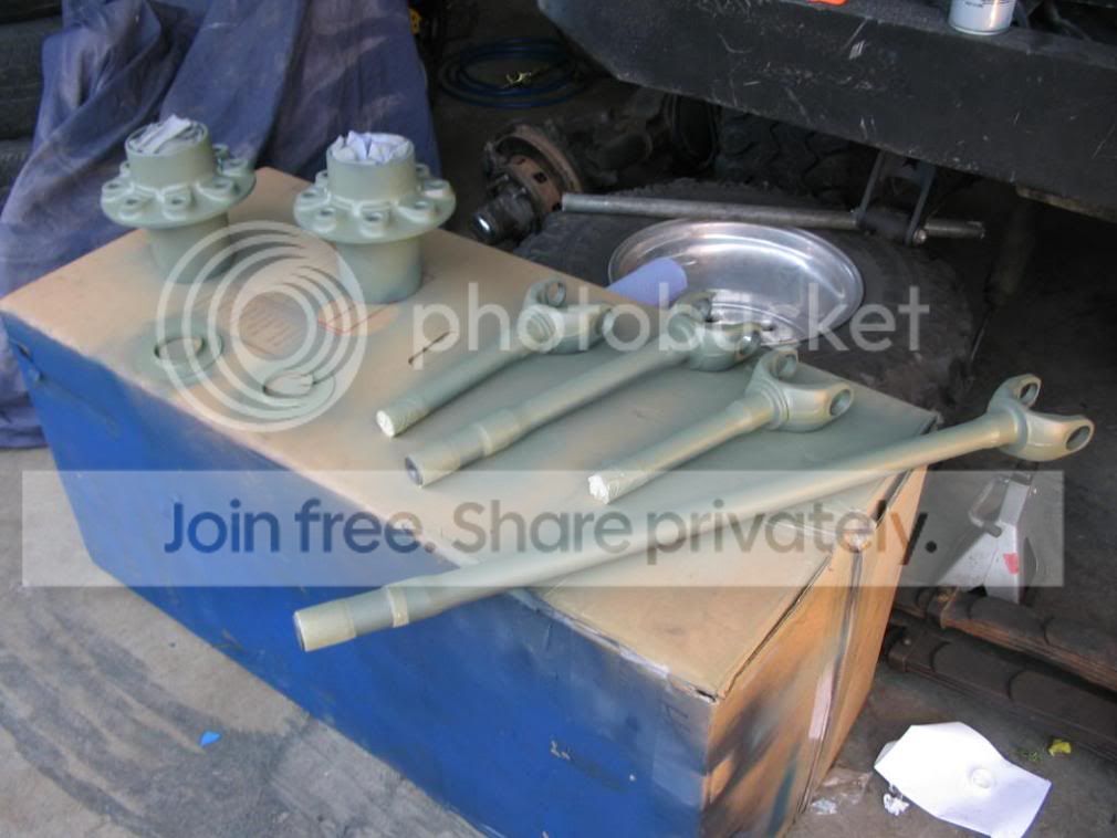

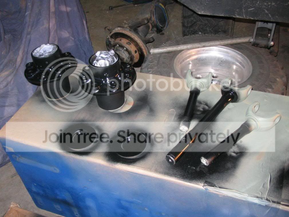

Bearing hubs, shafts and misc harware cleaned up and getting painted.

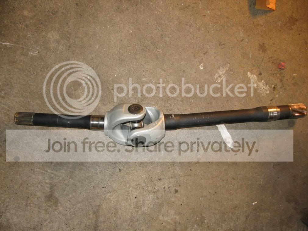

New Spicer joints.
Hubs and rotors together

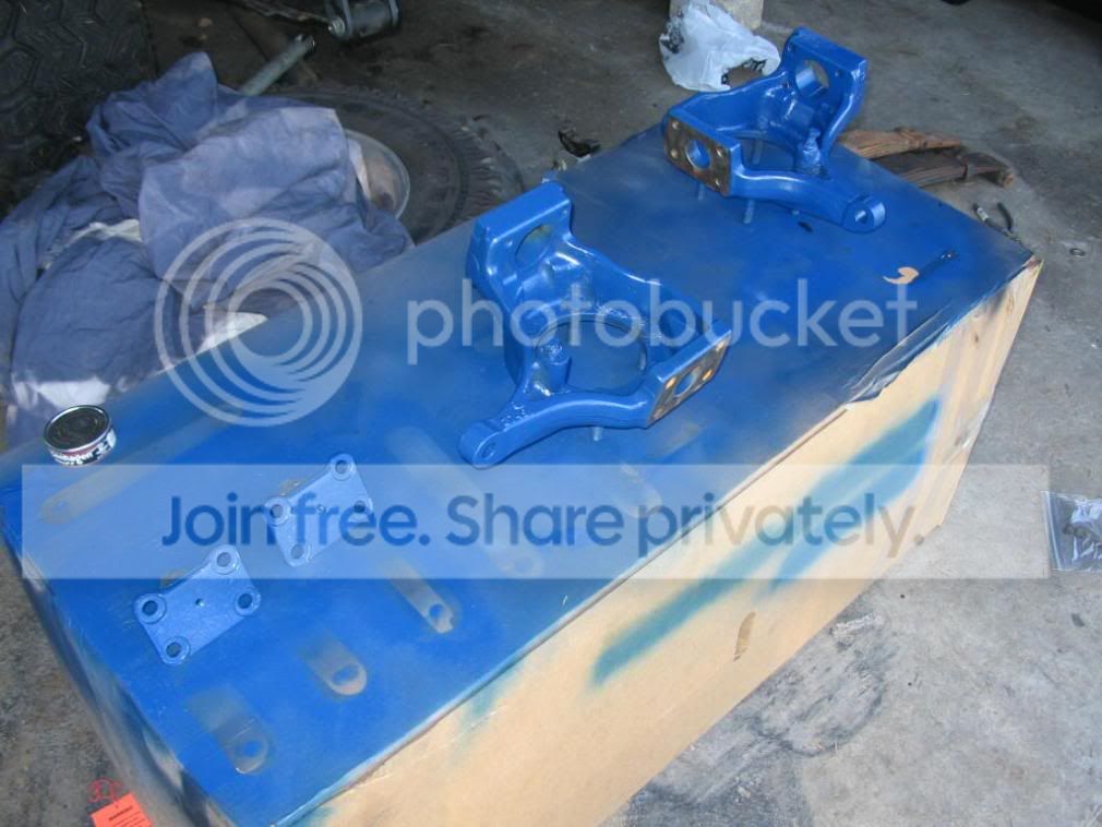

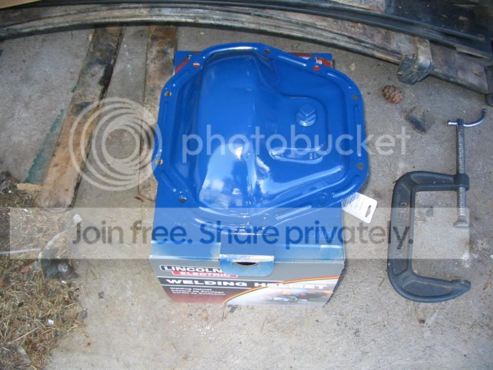

Diff cover and knuckles dark blue just for some contrast.

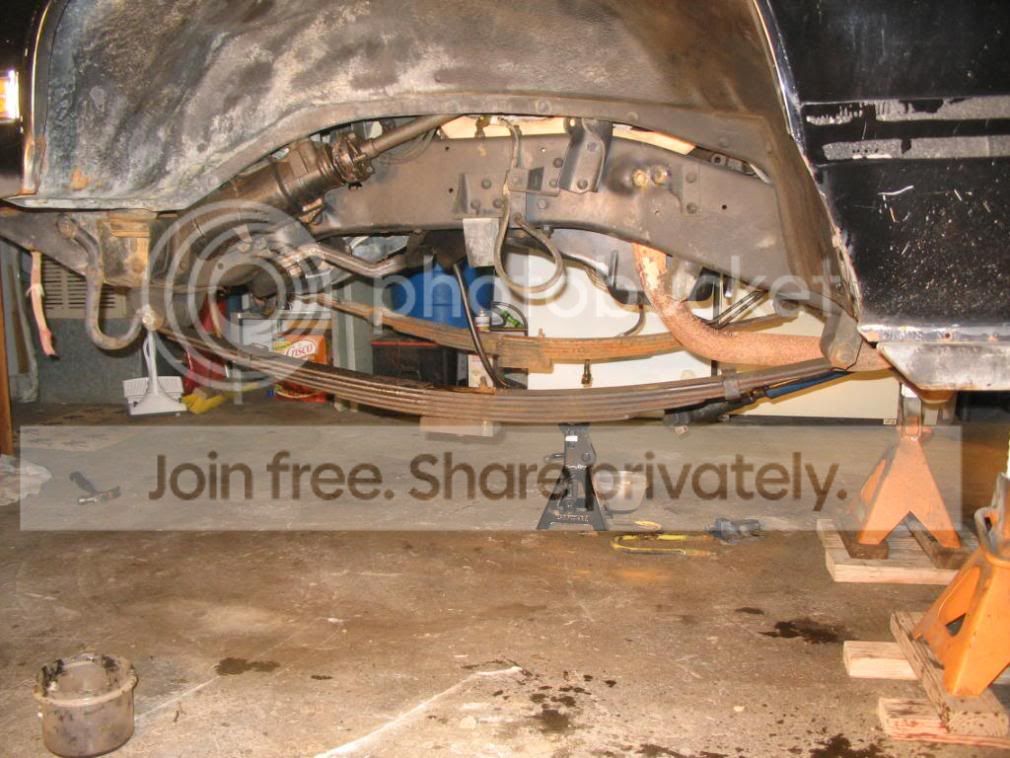

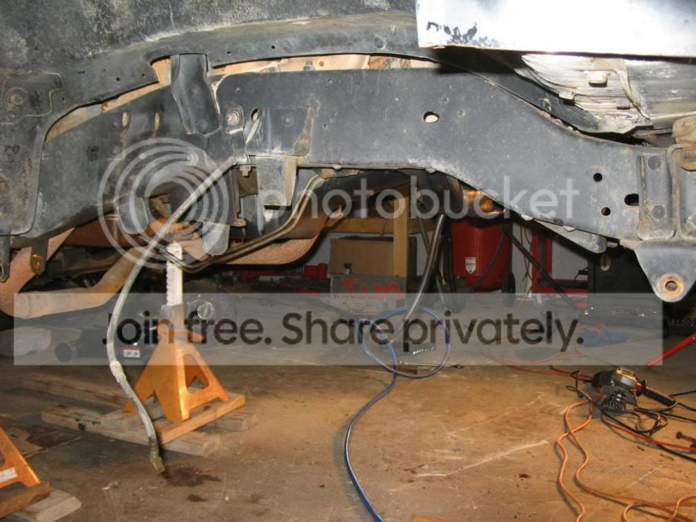

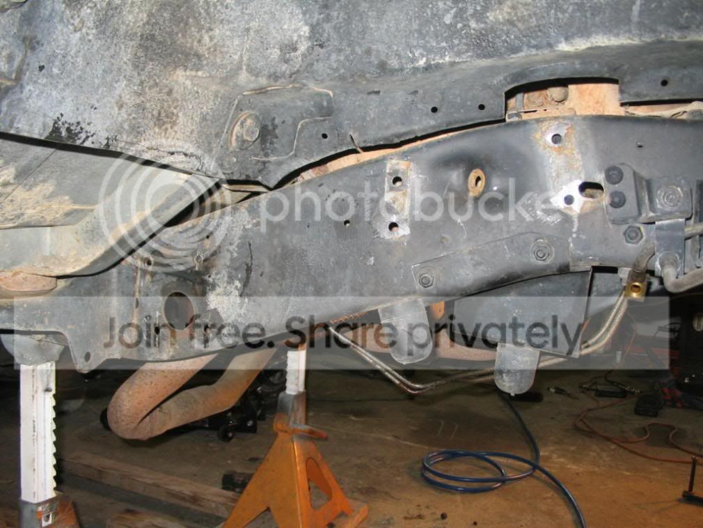

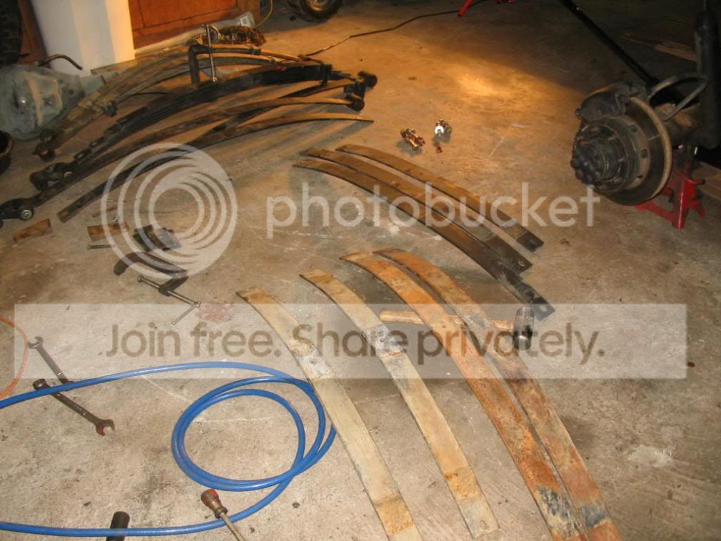

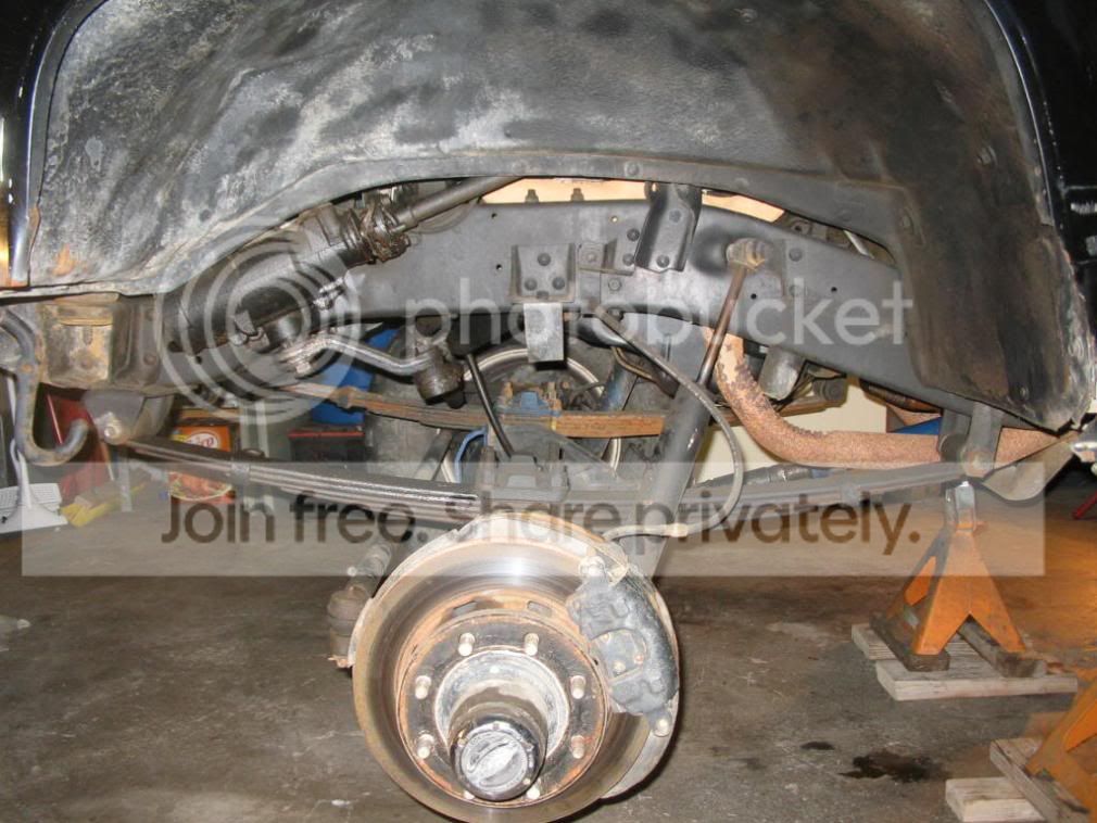

Axle came out fairly easy so on to the springs
Now the crappiest part of them all. Me vs rivets :mad:
These ones arent too bd cause you can actually get to them with a cut-off wheel and notch them first.
These ones up front SUCK!
Thank god for the air hammer. Still not a pleasant task though.

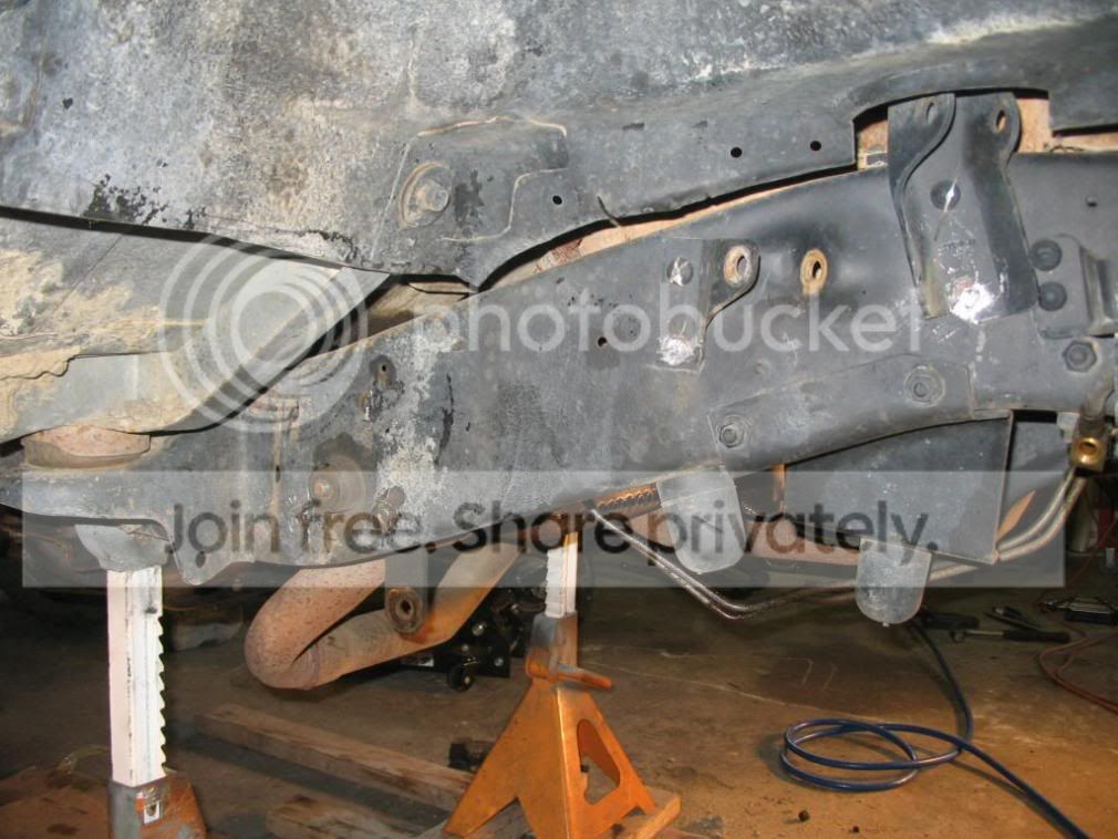

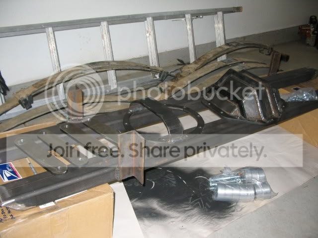

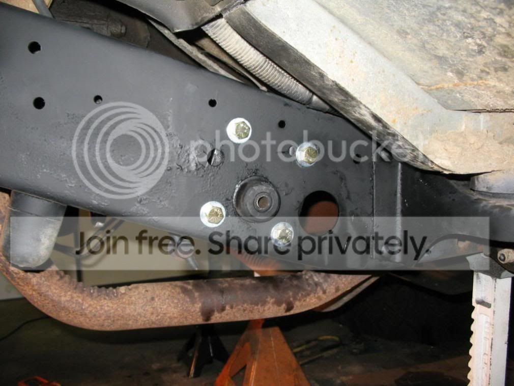

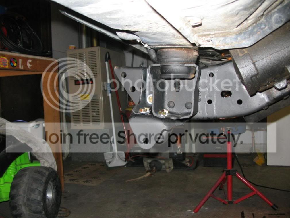

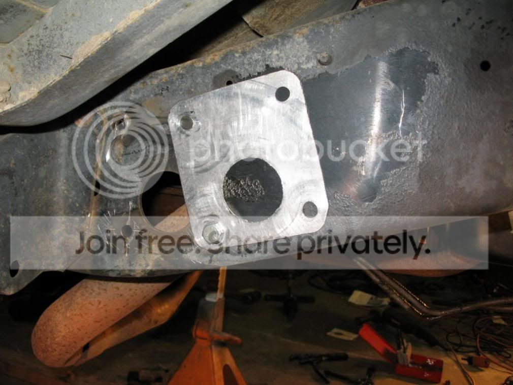

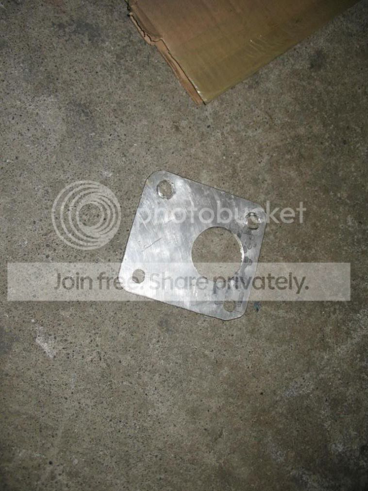

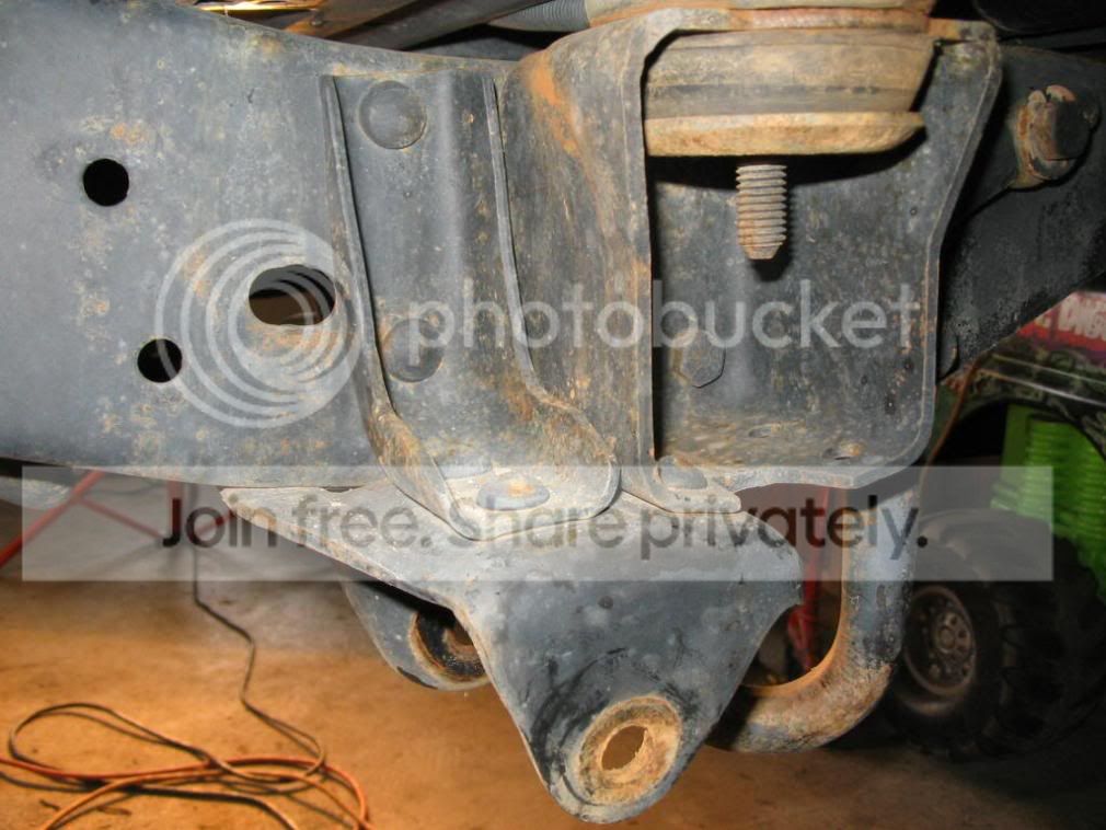

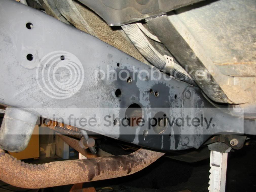

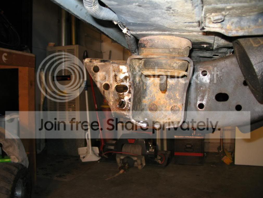

I built a template from some scrap aluminum I got from work for the frame mount shackle hangars.
I used the lower forward hole as a refrence on both sides. You could also use the upper forward hole, but it made the mount lower. I am using the 7.25 shackles so I wanted to keep it up a bit to prevent any castor and driveshaft angle issues.

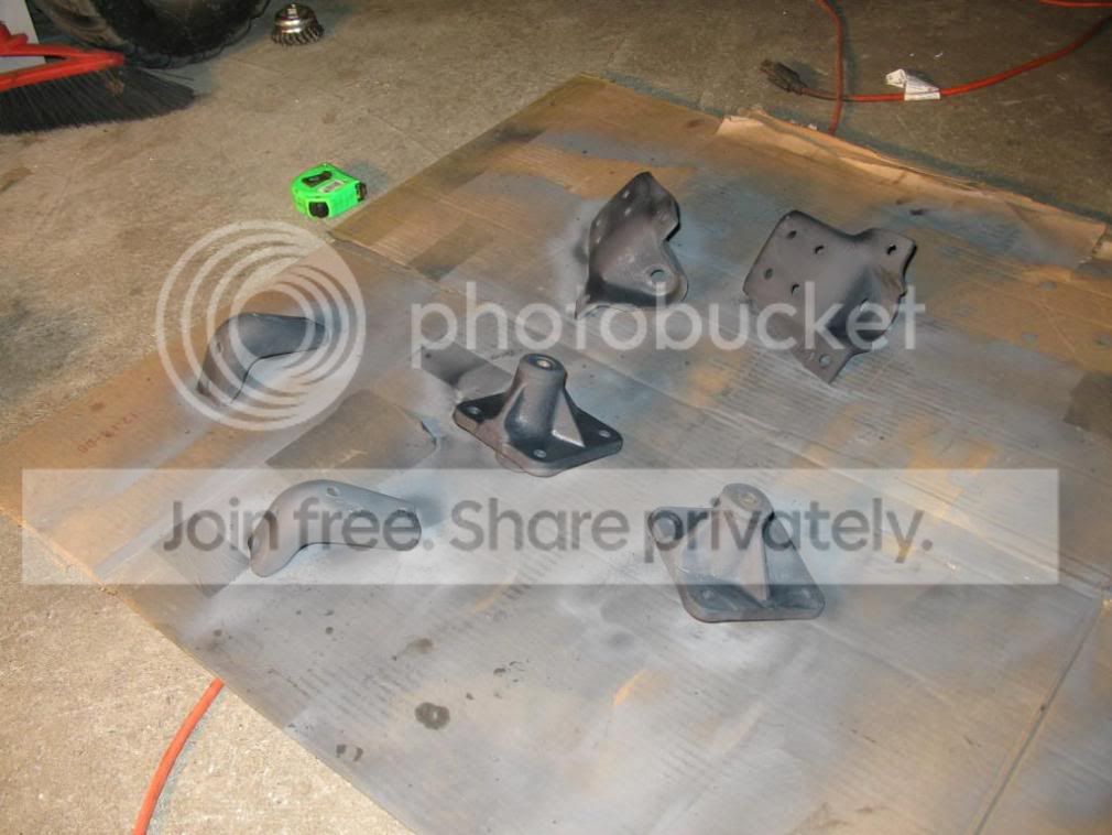

Bracketry all cleaned and primed

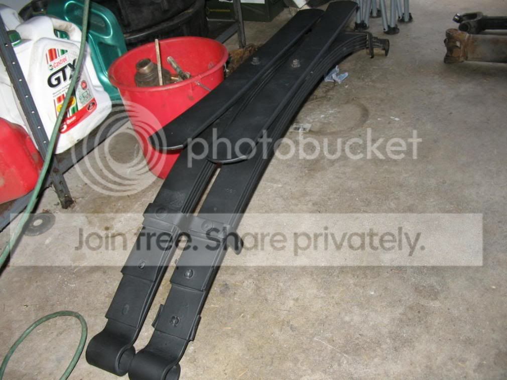

springs cleaned up a little with new center pins.
Rear shackle mount.
Front mount

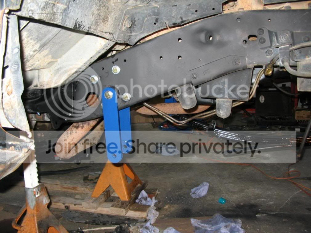

Shackles hung. I welded the 1/4" washers from Kert to the shackles.

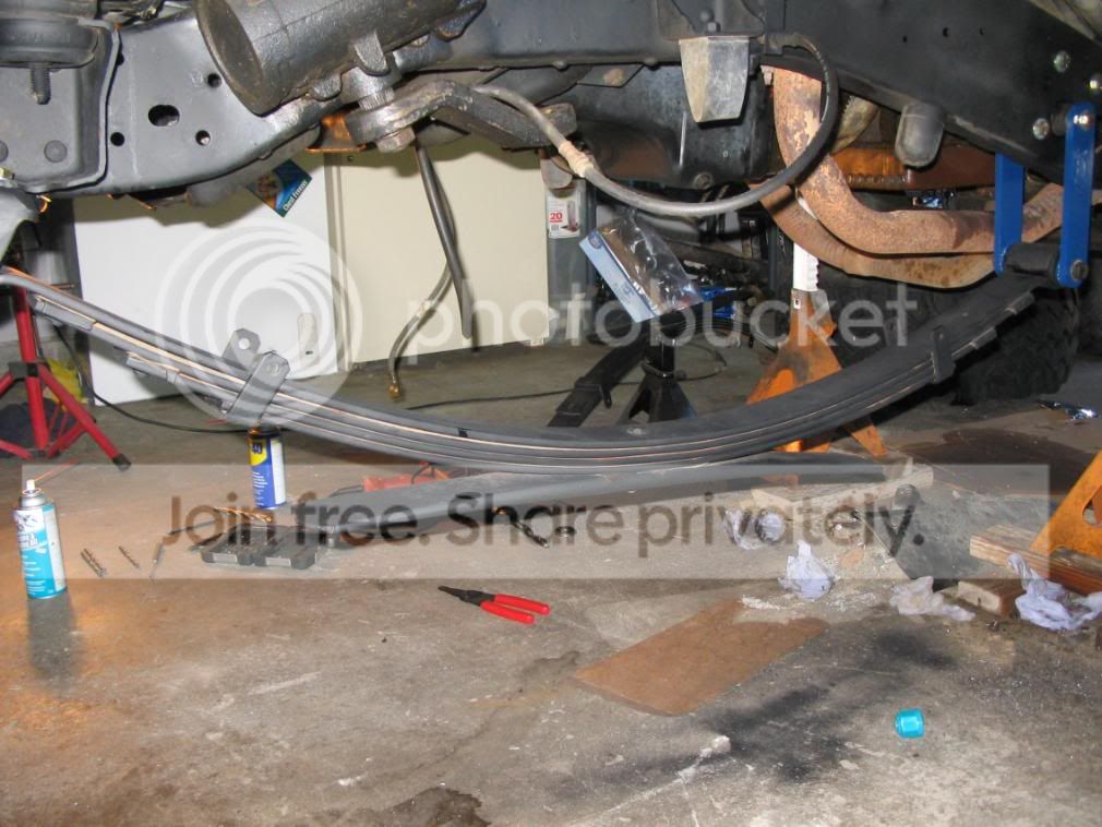

Springs going in.
Swap complete now its time to get that 60 hung from the springs. :D
