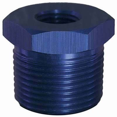

naw, its a friend of mine wanting to put a temp sensor in place of his tranny drain plug. Drain plug threads are 1/2"x20 (bolt threads, I dont know what all the little 3 letter prefixes besides NPT mean), and the sensors threads are 1/8" NPT. So it needs to be threaded 1/2"x20 on the outside, and 1/8"NPT on the inside.
Just to be clear, something that looks like
Drill and tap the plug to 1/8" pipe, don't tap it too deep, reuse the original copper washer. easy fix man. I drill and tap 1"-2" 90* fittings regularly for 1/4" guage lines. or other applications.
Yeh, I figured have to end up doing that, just figured be easier, and less chance of screwing up if found the bushing/reducer/doo-hickey/thing-a-ma-bob

A -5 ORB fitting has 1/2-20 threads. You could buy a -6 JIC to -5 ORB adapter fitting and then drill & tap an -6 JIC cap with the 1/8NPT threads. Screw the -5 x -6 adapter in with a crush washer instead of the o-ring. Use the JIC cap for draining the pan.
You could use AN fittings in place of the JIC (they are identical except for material), but for that location I'd highly recommend sticking with steel fittings.

Sure, but for all that he could drill and tap the plug hes got.
K.I.S.S.

I've seen oil drain plugs with a "piggyback" plug in the center you remove to drain the oil--they are 1/2"X20 thread(possibly oversized to make up for stripped threads though)--the center plug is a 1/8" pipe thread...thats one way to get what you want..:laugh:
But for all the hunting you'll do to find one,I think brazing a 1/2" fine thread nut into the pan would be easier and faster..probably cheeper too!..:crazy:
Yeah, I've actually bought these before for marine water pump applications:
http://www.fittingsandadapters.com/malortofempi.html
part #32-5-2. These are steel, not brass though.
