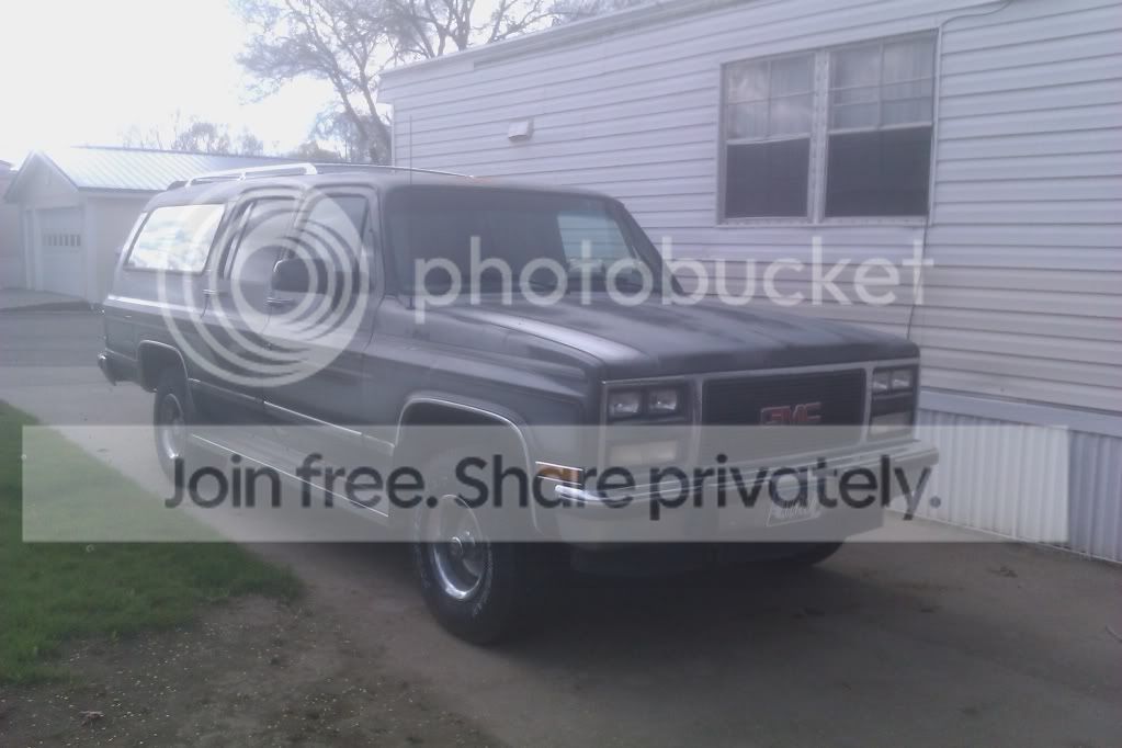

I found it on Craigs List in Billings for $400, the ad said timing cover is off, you just need to put it back together. I went and took a look at it and was impressed how straight the body was and no rust to speak of, it was also loaded up from the factory pretty good and had a Grand Prix package or something similar.
Specs: 350 TBI 187,000 miles, 4L60 or 700r4 not sure, NP 241, Tow Package, HD Radiator, 100amp Alternator, 3.73 10 Bolts.
So my main goal for this thing is make it into my camping and camper pulling rig. Not planning on doing any hard core wheeling with it, I have a Toyota for that. Future will be 14 bolt rear and Dana 44 front with 4.10 or 4.56 gears, Built 383 and built up 4L80e and some new paint. On to some PICS.
New to Me
How it sits currently

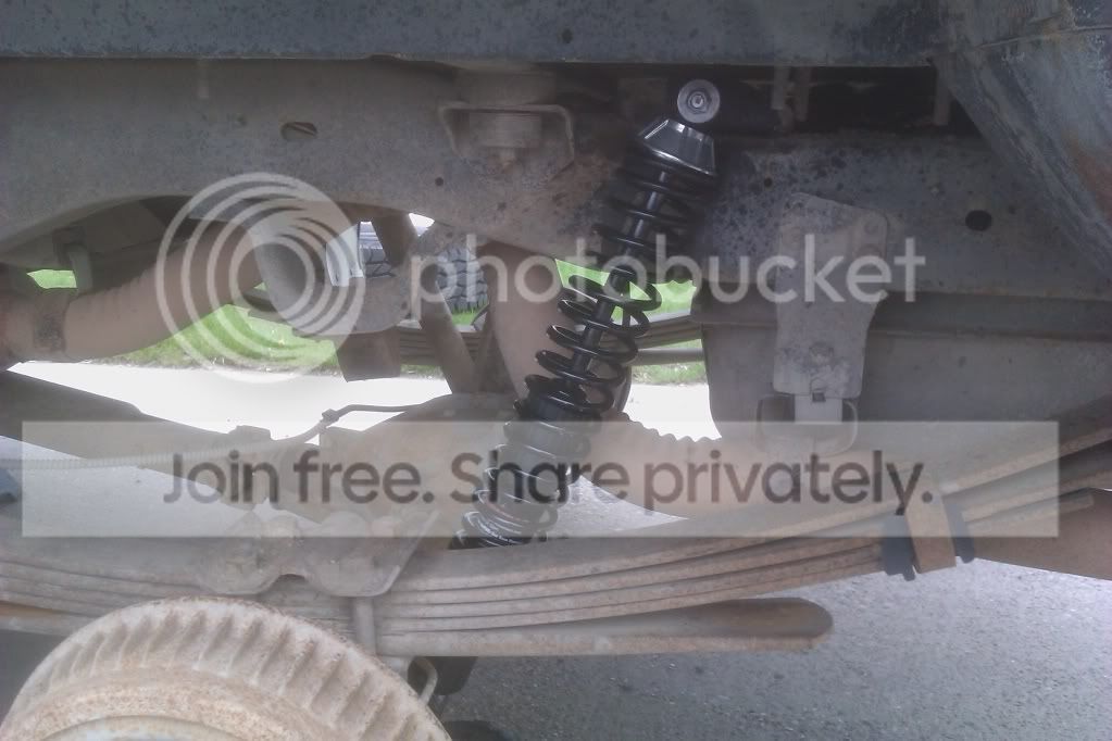

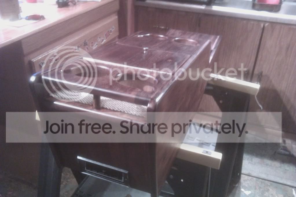

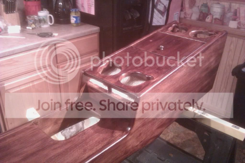

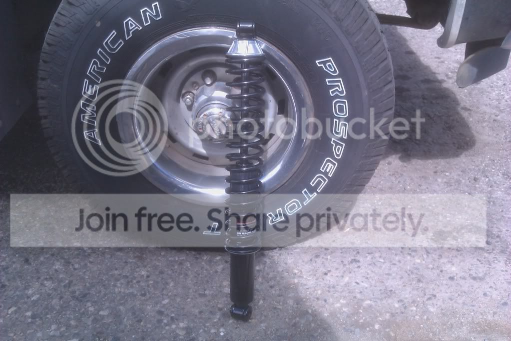

So far I've put new 31" tires on it, new shocks, CD player, refinished the wood console (I should have taken some before pics of it) and Ruff Country add a leafs on all 4 corners. Here are some more pics.

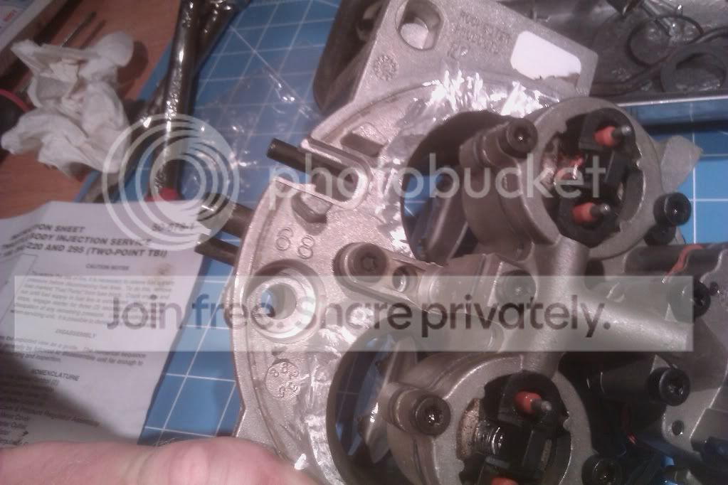

I have also ordered the TBI mods from CFM Tech and I picked up a rebuild kit also, I'll report on how it works when its installed.
Any more details on the add a leafs? In the rear, did you just do the coil overs, or did you do add a leafs and coil overs?
The picture is before the add a leafs, but yes I did add a leafs and the coils. I was going to do air bags but for the price of the coil overs I thought I would give them a try. I got the leafs from JC Whitney for around $160 for all of them. Kind of a pain to install, I had to take the whole spring out, heat and bend up the tabs then install the leafs. I'll get better pics this weekend I just had these on my phone.

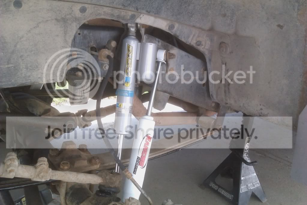

A little more progress this weekend. Added the 5150's up front and finished my 7 pin trailer plug. I also got some more pics of the interior just to document the changes I'll be making.

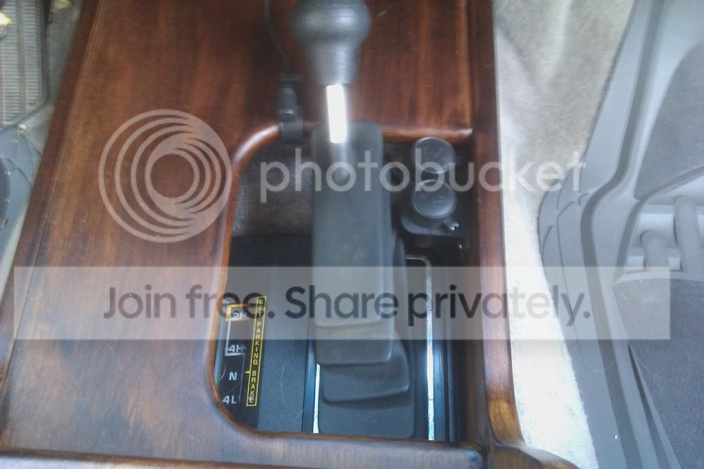

First the interior.
Notice the power mirrors, and they work!
Added some extra power outlets.
Suspension shots

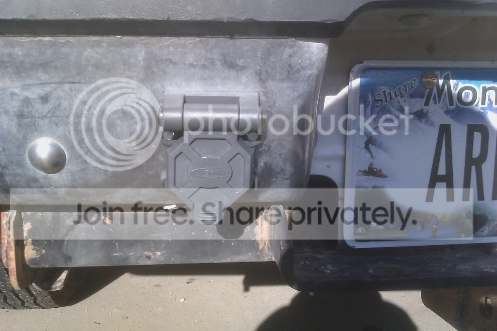

Not the coolest update but it's one none the less. Cut a hole in the bumper and put in the 7 pin trailer plug to keep it safe and out of the way.

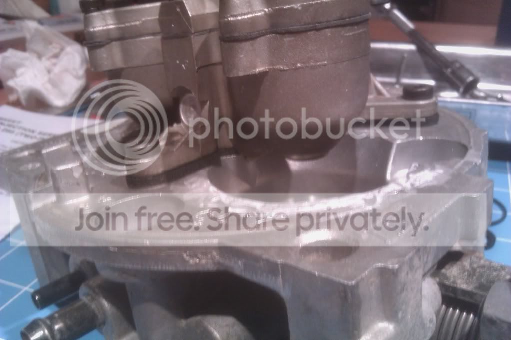

Cool, that's what I thought. Now a new issue I get to deal with tonight. Last night I rebuilt my throttle body and did the ultimate tbi mods. What a difference that made, like a 30 horse gain :D and much better throttle response. But, I think I need to adjust my TV cable, it wouldn't shift out of first unless you really got on it. I've researched it today and it don't look too bad but is there any tips or tricks you guys know.
How bad was rebuilding the TBI unit? I suspect that I need to do this and I'm hoping it isn't going to cause me any more grey hairs.
It was actually extremely easy. I did it in about 3 hours but I also grinded down the butterfly shafts or whatever there called and grinded down the lips around the throttle bores plus I had a 3 year old to chase after every 5 minuets. But it was all well worth it, runs sooo much better now, and again, it was like gaining 30 horse. I got a kit from Oreilly's for $24 but make sure you get about 5 cans of carb cleaner.
