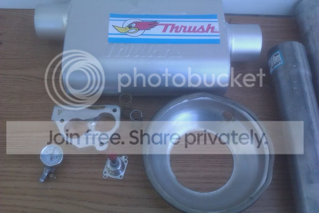

:D Thanks to Wyomingboy, I just got a bunch of CFM stuff in the mail today :bow: I got a spacer, pressure regulator, salad bowl and some more generous odds and end from him for an excellent price!
I also picked up a Thrush 2 chamber muffler last week I'm hoping to get installed this weekend. Got a lot of work ahead of me this weekend to get it all installed. If drinking beer and wrenching is called work :rolleyes:???

I got my Thrush muffler on this weekend and it sounds great. I also took my cat in to recycle it and got $50 for it, bout paid for my exhaust. Was $50 a good price, or did I get screwed? The cat on that thing was a beast, probably weighed 30-40 pounds.
I dont know if ya got screwed but I gotta take mine in yet too. They are huge aint they. I'll see what I get. Notice any acceleration improvement? mine seemed to get a little better
Actually, yes! It does seem to have more power but I'm sure the muscle car sound has some to do with it also. It is breathing a lot better now with better throttle response to boot. Still need to get the CFM mods on now and would really like to get a nice set of headers in the future. Aug 14th I'm going to go pick up my new axles so I'll be going from 3.73 to 4.10's, that will really make it feel like it has some low end torque.

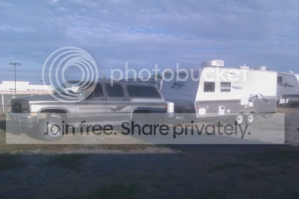

Took the burb out on the maiden voyage this weekend camping. Pulled the camper (about 5500 lbs loaded with water) about 90 miles round trip and burned a quarter tank. Not to bad I think, I tried to fill it up so I could figure out my MPG's but the damn pump shut off at $105 - I still had about 2 gallons to go :doah:
Question, it towed fine doin about 60 then all the sudden my 4wd light came on and I lost a ton of power? I pulled over and actually engaged the transfer case then disengaged it, light went off but still no power. I limped the last 10 or so miles doing 45 with it to the floor :confused:.
Two days later, hook back up and do 65 no problem all the way home and still had to let off the gas a bit, she really wanted to go! :eek1: You think it had something to do with the computer? Seemed like the engine just came alive for no apparent reason. I did add the salad bowl from CFM the night before I left and didn't unhook the battery but that's about it.
