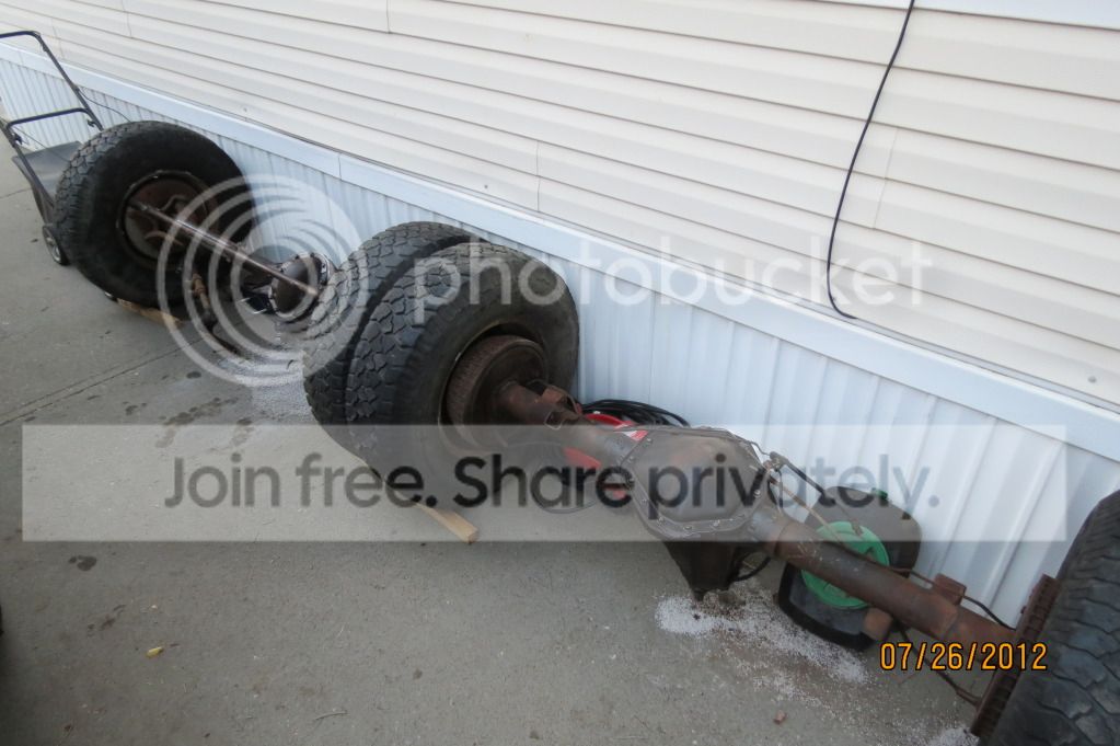

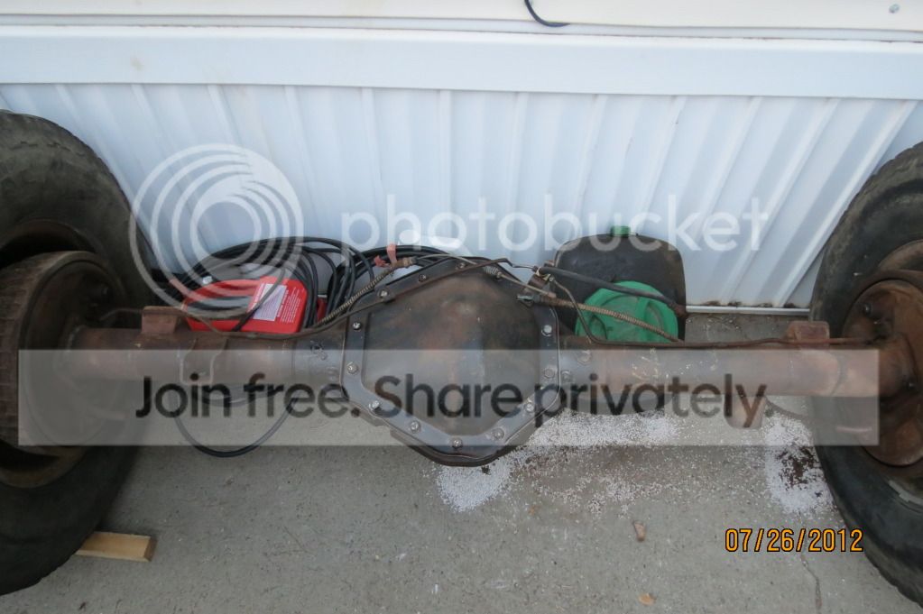

Got the axles home on Sunday. Just what the guy said, 44 and 14bff with 4.10's. I pulled the cover off the 14 bolt last night and got it all cleaned up. Everything looks good, now for the front tonight. It was fun getting that beast out of the trailer by myself.
He even let me keep the wheels and tires. 235/85/16 Goodyear Work horse with 50% tread.
Here are some pics that I promised.
14BFF and Dana 44 out of a 77 3/4 Chevy. I cleaned them up and drained the fluid on them. The front had some water in it and some surface rust in some of it but I think it will be fine. The ring and pinion look perfect.

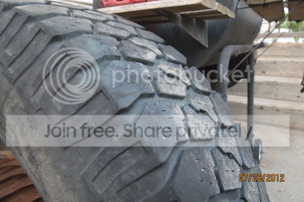

Got some decent tires and wheels with it too. Manufacture date was 2007 so I can get some use out of them. I plan on putting my tires off of my Tacoma on the Burb when I can afford new ones. They are 255/85's (33x10) tall and skinny's.
These:
They are still about 65% on the Toyota.

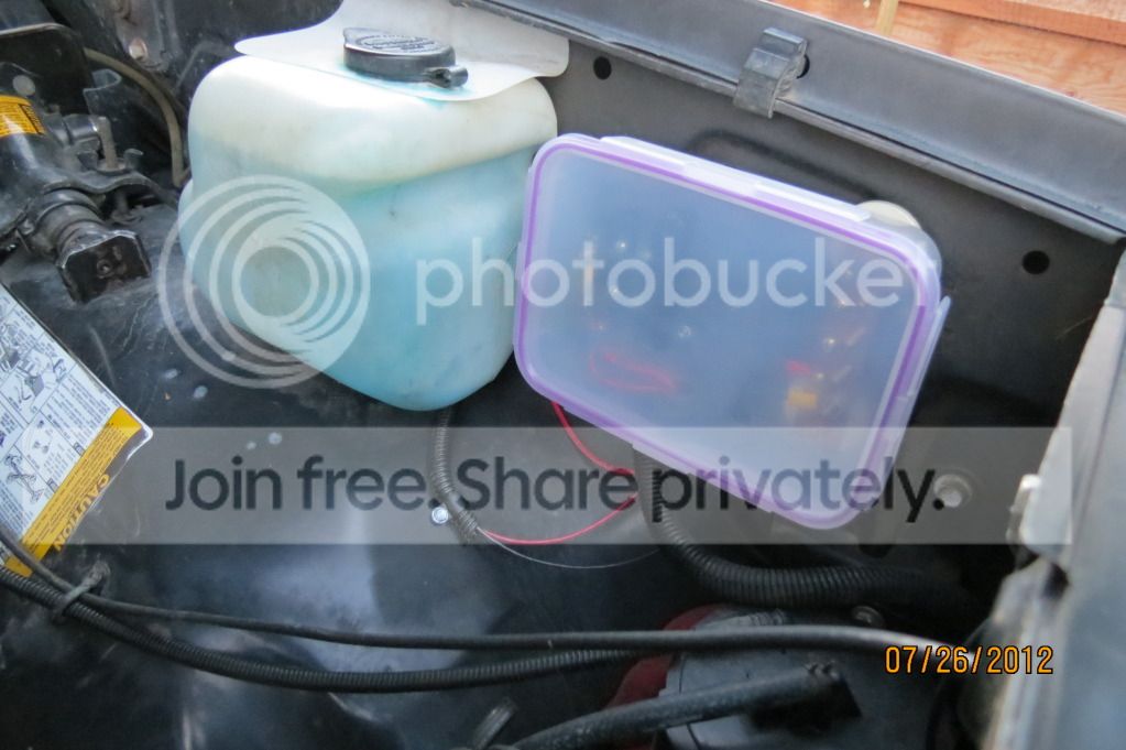

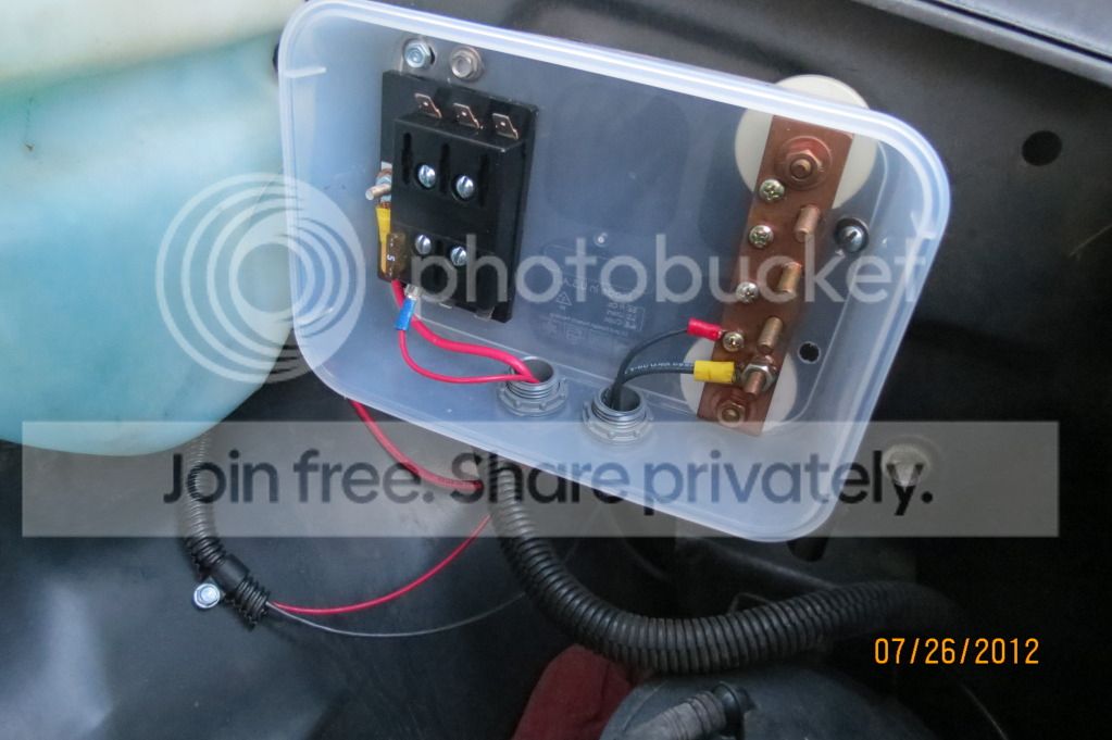

And here is some other stuff I got done in the last few months. Home Brewed fuse panel under the hood. I just have my heated O2 hooked up to it now.
Cover off:
Fuel pressure regulator and gauge:

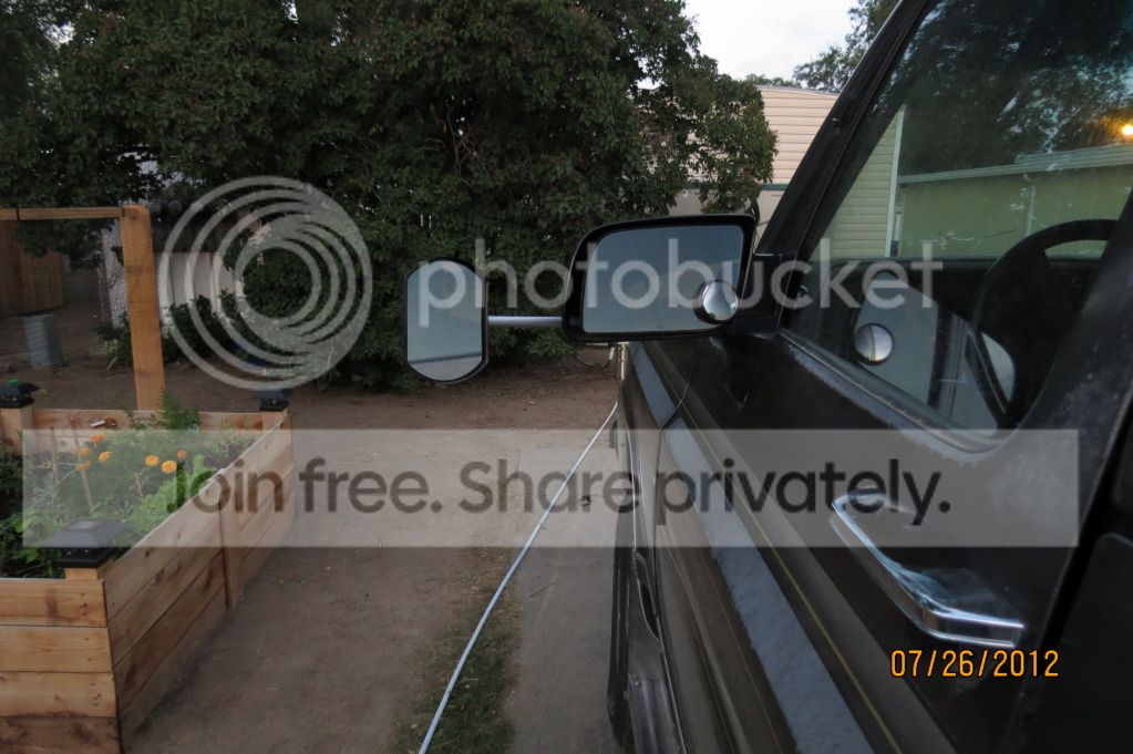

"Kustom" Towing mirrors...:whistle:

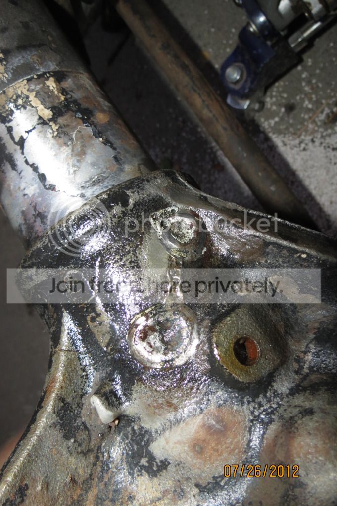

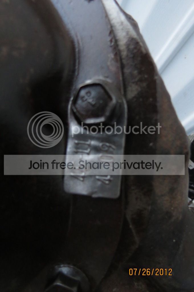

Can someone tell me if this weld is from the factory? I noticed it when I was cleaning it. It is connecting the two plug welds.
Still had the diff tag too. I don't think the fluid was ever changed on this thing.
Looks good. I'd check the load rating on those tacoma tires before you throw them under the burb though.
There 10 ply load range E or D, Can't remember for sure right now. I know they have a higher load rating than the 31's I have on the Burb right now.
Good work, then you are all set! Most people end up with P or C tires on Tacomas.
And remember, the rating letter doesn't always give you the right idea. The Load Range D 33x12.50 BFG's on my burb have a higher load rating than the stock 235/85 Load Range E's, so its always worth checking the numbers.
