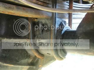

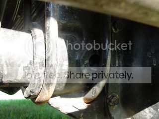

Mine used to be two u-bolt this until two weeks ago. That's the way Mike did it when he built my truck. I don't know of a spring plate for it due to the 4" hole spacing for the "casting" side u-bolts. Not sure if he made it or bought it. Sorry, I ended up modifying my spring plate to go back to studs so I can't even send you the one I had.
He had to notch the web on the back side of the housing and drilled a hole through the web on the bottom of the housing. Seemed to work fine but you have to bend open the u-bolt - not sure how much - to get it through and around the housing. I just cut it off. Seemed easier.
When I started on the spring swap I didn't even know that the casting side had studs. When I replaced my front springs I stripped a u-bolt so I just bought two tube side u-bolts and two casting side u-bolts. Didn't realize the problem until I tried to swap u-bolts. No way I was going to be able "bend open" the DIY4X grade 8 u-bolts.:haha:

Yes, you would need another "casting side" u-bolts. Mine were both the same size when I took them off. If it comes to that and you have to do it I can take some pictures of how he modified my diff casting webs.
You will want to get a "cheap" u-bolt so you can bend it open to get it on and then bend it back. At least this would be a reversible modification when you get home, other than weakening the diff casting somewhat from drilling and notching.

The u-bolt is 4.5" x 11.5" x 5/8"
Mine looked just like that except he just notched the rear web which necessitated bending the bolt. Just taking it off like above allows you to put u-bolt on upside down through the web hole and then pivot up into position. There's really no downside to taking all of the web off like that as the structural integrity of the web is already gone when notched.
