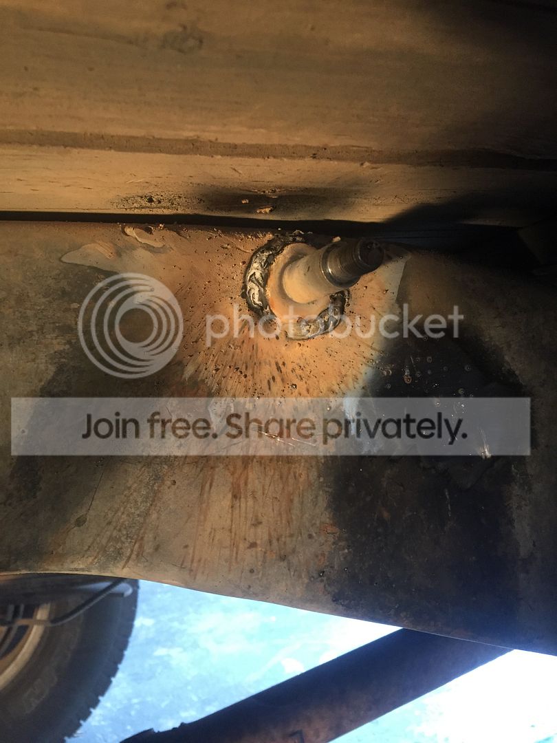

So I finally had some free time to roll around underneath the truck. Found a booger welded frame fix at the pass read shock mount.
