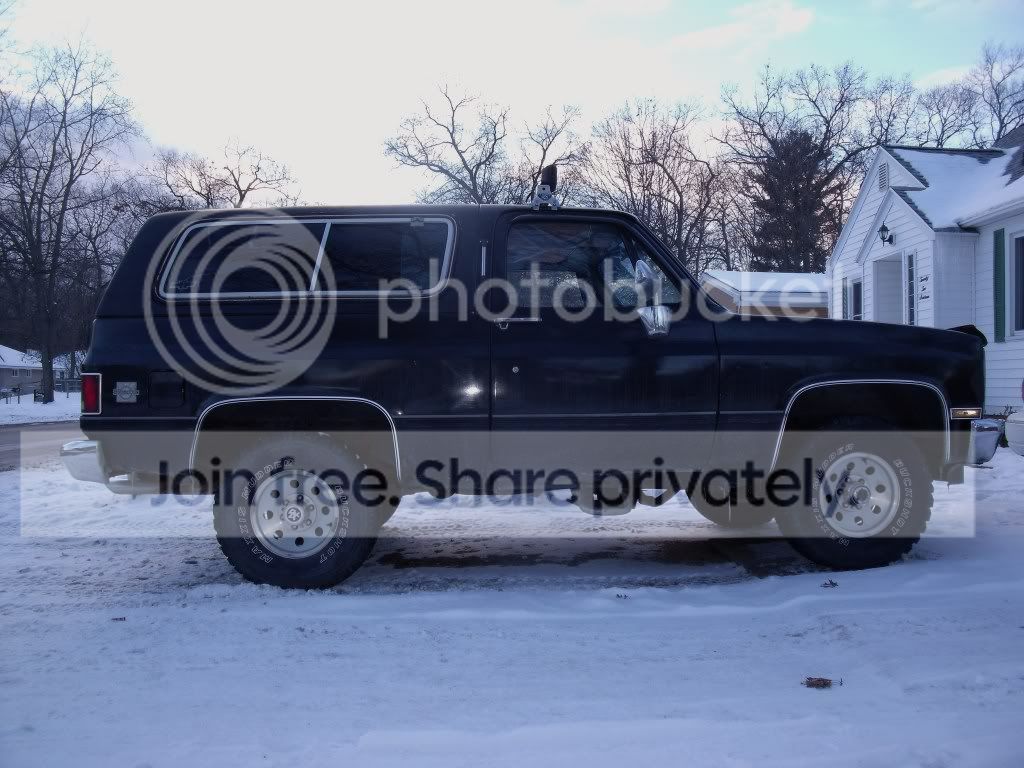

Oh heck while your at it toss in a couple of pics :pimp: ...(for good old porn and so we can see the 40" tires and get a clue).

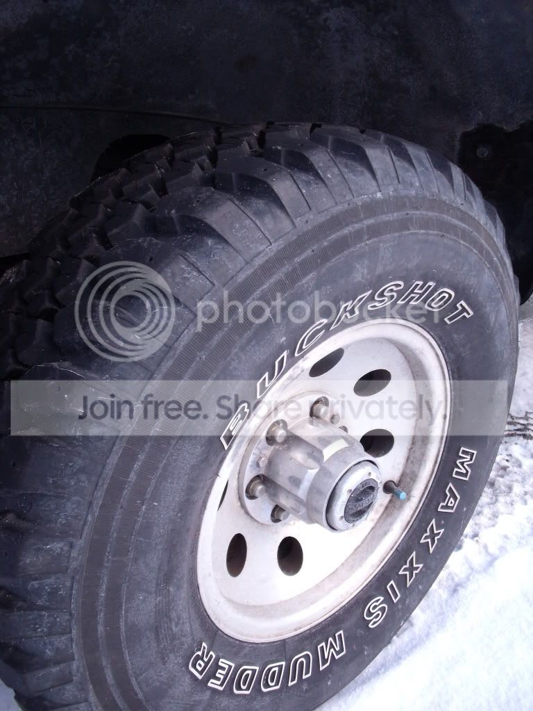

32 X 11.5 Buckshot Maxxis Mudders

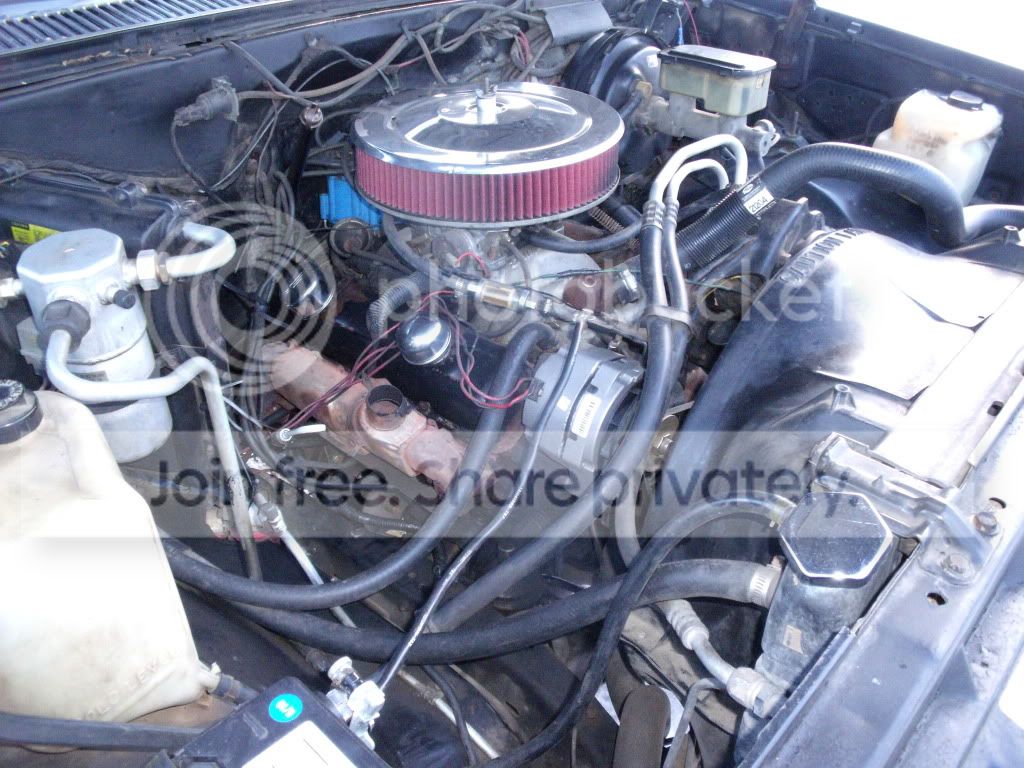

Haha their you go put in a couple pics. Wish they were 40's then it would make some sense haha. Ive had it for about 4 months i think. Sucked the same fuel down from the day i brought it home. I just ordered an oil pan heater to help for cold starts. I do need to check timing

Doing the math given a TRUE 32" tire and if you're positive about 2000 rpm's @ 60 mph then you have 4.56 gears. I would pull the rear diff cover and count the teeth on both the ring and pinion gear then divide the ring gear by the pinion gear to see exactly what you have. This combo would definately be the culprit of your fuel mileage.
a 32" tire is going to throw your speedo off a bit.
Got a GPS, use it to measure miles. Or to measure how far off your speedo is.
4.56s with 32s and your speedo is definitely not reading correctly.
