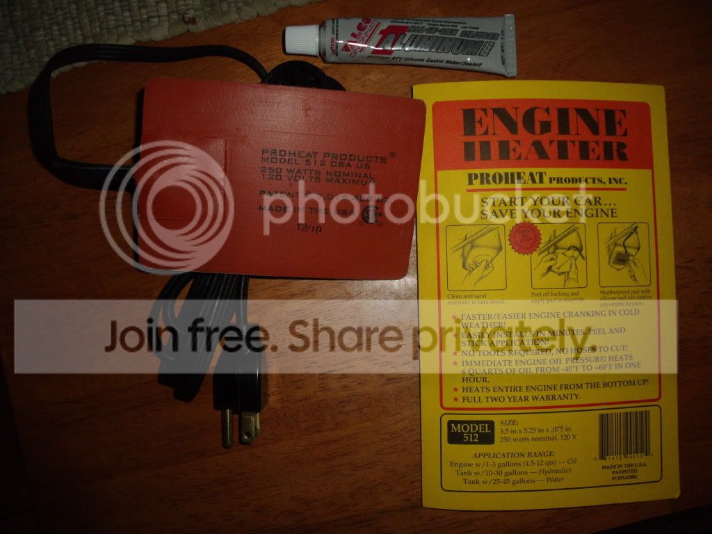

Bought this ProHeat oil pan warmer, supposed to heat 6 quarts of oil from -40 to 60 degrees in a few hours. Seems to be working, not like the truck is hot when i get in, but warms up much quicker with less idle time. 250 watts so im gonna get a timer that turns on about 3 or 4 a.m because im up at 6 for work every mornin. Made in the old USA though so :waytogo:

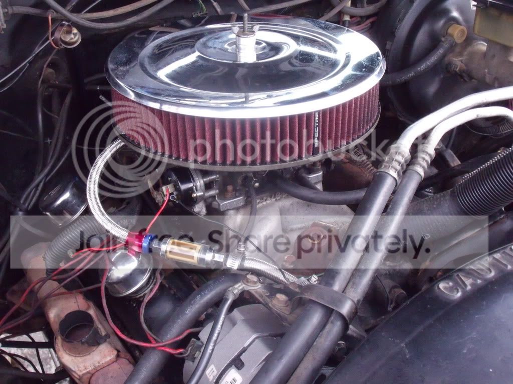

Also i jus put in a new electronic choke, mine went out and ive had a tractor choke from TSC rigged up for a few weeks. What a pain, takes like 8 tries to start it on a cold morning, ive been really breakin in that new starter lol. The electronic one works so much better once adjusted right.
Also i had 5 points at auto zone a couple weeks ago and that means $20 lol so i splurged on a new gas line, mine looked pretty dry rotted. But its pretty aint it lol. :D Now to take care of that big wire mess, and cut that cat off.
You'll get better performance and probably slightly better fuel mileage once you ditch that air cleaner for one that sucks COLD air instead of the hot underhood air.
I disagree--in cold weather a" heated "air cleaner is a must for maxumum fuel eficciency....it helps the fuel vaporize properly and keeps the carb warm enough to prevent icing....tis true a colder fuel air mixture increases power in hot summer weather but in winter it'll decrease mileage substantially....
GM introduced the air cleaners with hot air intake pipes coming off a "stove" on the exhaust manifold in '68 to help the leaner mixtures fire more readily and prevent bogging or flat spots during acceleration...it was part of the controlled combustion system (CCS) that also had the introduction of the 195 degree T-stat and advanced ignition timing ,among other things to not only lower emissions,but improve driveability and fuel mileage...
check your cat, check the timing, check the state of tune. loose nut behind the wheel?.......until the vehicle is running the best it can who really cares what the gear ratio is at this point. i still don't see any reason for that intake setup.......is that supposed to "hot rod" it and for what purpose? an engine is a system where all components need to work together as a unit, any mismatched parts will spoil the recipe and do more harm than good. that's my $.02.

I didnt put the whole setup in their, thats how i bought it. What would you recommend? I honestly do like the looks of it (once its cleaned up) but if its that bad of a set up i guess i could get rid of it. I will be taking this truck to the sand dunes once its summer so its gotta have enough power to climb lol.
In fact the riser on the left of the pic (the round duct fitting) is for the heat off the manifold to the stock air filter and it is to heat the air for better fuel economy.
That only functions for several minutes until the thermal switch in the air cleaner housing is warm enough then the trap door closes and ONLY sucks air through the duct from the grill area. :deal:
The system was designed to help the engine warm up quicker when cold.
Well the dunes means climbing. You can spot the Holley and Edelbrock guys right away - once the climb starts they start blowing black smoke and slowing down. You have two choices for climbing - EFI and Quadrajet. Guess what, they both improve your gas mileage as well (OK, yes Holley and Edelbrock have "off road" carbs now...)
another hint is that Performer RPM manifold is made for top end (up to 6,500 rpm)and not low to mid torque. that carb you have is 600 cfm i think and all you need is 500 to make that motor run just fine. that carb doesn't belong on that manifold either. if you're "needing" to run Edelbrock stuff get a Performer manifold (not Performer RPM) with a 1403 carb. the bone stock 305 motor, tuned properly, worked fine for me in my '85.
Is the quadrajet the stock carb on these or an aftermarket??? I guess that is a good idea then, ill have to look online and see if some hot rodder would like to trade me for his plus some extra cash maybe. how hard is EFI to install on a carbed motor?? and how much $$$. Estimate
Do i get to keep my HEI?? or is that junk too.. lol. Sucks to find out all these parts i thought were sweet are junk lol.
