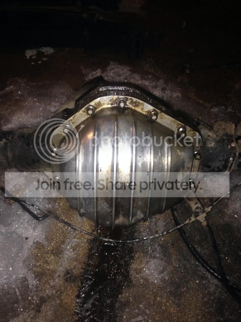

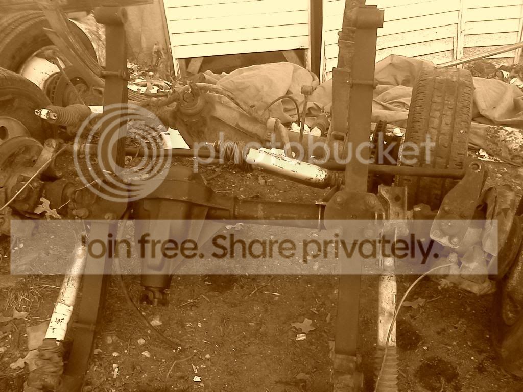

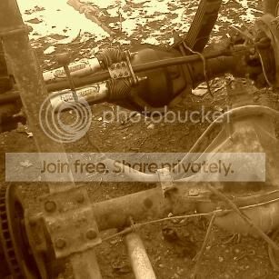

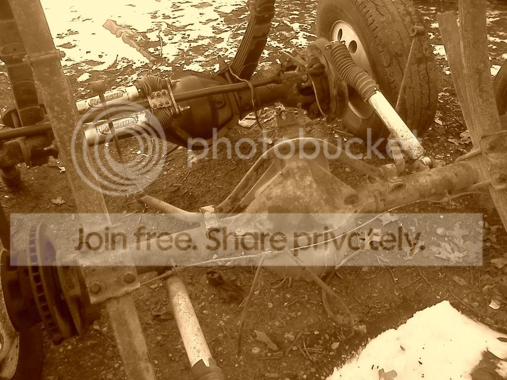

Ok I ran across somebody on craigslist who has a pair of axles for sale, they don't really know exactly what they came out of but have them listed as being for "73-87 chevy". I sent them a text to see if they knew what the gear ratio was and for pics. This is what I got. I know they have some weird sepia filter thing going on but it's all I have.
I know the front axle is a Dana, but when I noticed the kingpins I got to wondering if this might by chance be a D60. I was hoping one of you guru types might be able to tell me if this is just a D44 with kingpins or if maybe I stumbled on a d60? The real reason I want to know is that the offered me both axles for $400, and if that's a D60 I'm on my way.
Thanks in advance
You know what, I hadn't noticed the diff being on the drivers side.

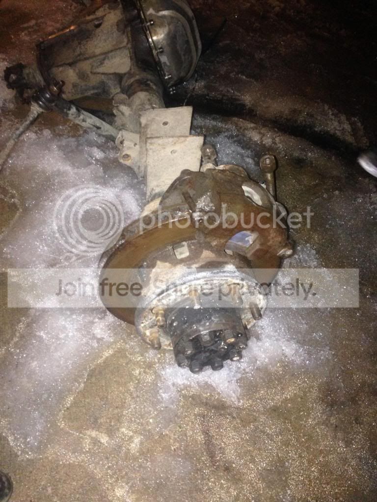

****, for $400 I'd buy it and flip it for $750-ish. Especially if you get everything pictured - lift springs, crossover steering arm and 14 bolt with rear disc and aftermarket cover (may indicate other work like gears or locker).
The only drawback I see is someone ground a groove in the web of the 60 housing for a u-bolt. OE u-bolts would go down, not up.

The 77-79 Ford Dana 60 is virtually a direct bolt in.
The 85-92 Ford Dana 60's aren't even close, their spring pad spacing is almost 5" wider (36.5" for the later Ford axles, GM is 32" and the early Ford's 31.5" is close enough that they bolt in).
If it's the early one, you can use it. If it's the later, you can sell it for way more than you paid for both axles. You did well :thumb:
As mentioend above I would verify the gear ratio and maybe a locker or limited slip in either. Both axles have been modified as shown by the disc brake conversion on the rear, aftermarket diff cover, and crossover steering arm on the front. While these are common mods on this and other off-road forums they are not real common for mall-crawlers.
As mentioned above you need to determine whether it's an older or newer version axle. Don't think you could use the newer version without substantially modification to the front suspension because the driver's side leaf spring would come down in the middle of the pumpkin.

I found the casting numbers 620093R and ran a quick search it turns out this axle must have came out of a 78-79 Ford F250 "snow fighter" and F350. (Any more info would be great)
Both axles have 3.73 gears

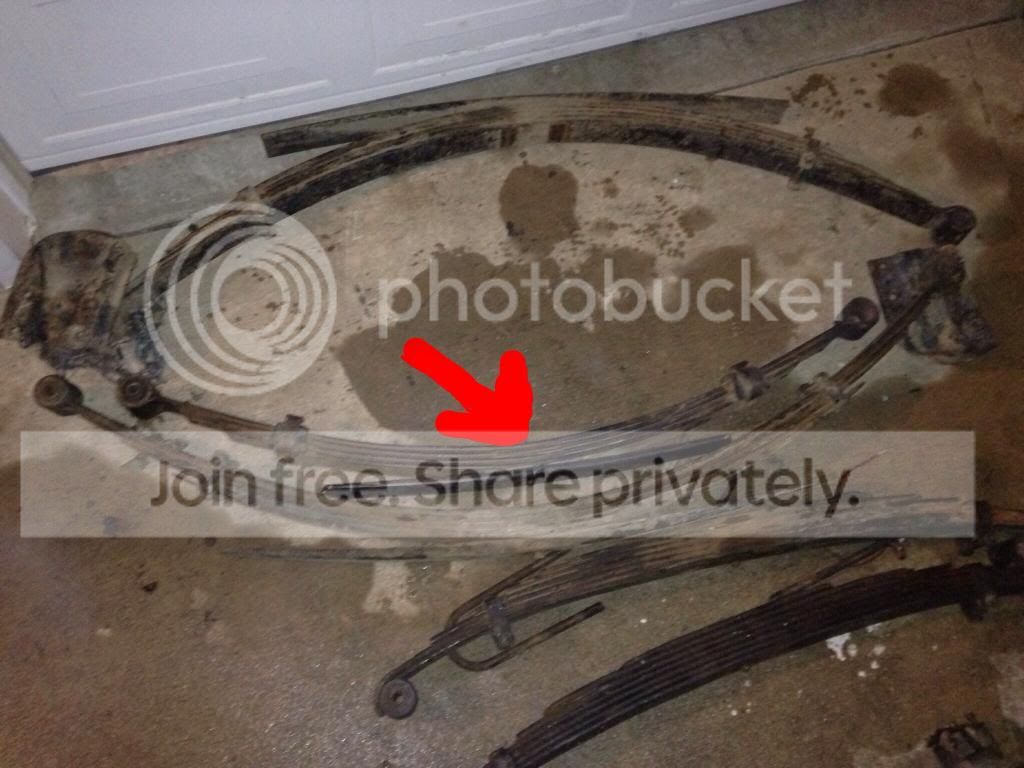

I also got these leaf springs. The red arrow is a set of stock 52" rear K5 springs that I threw down for comparison.
The 14 bolt had this sweet thick aluminum diff cover, and the disk brake conversion. And I'm not sure but I think it has posi. The diff looks a lot like my other 14 bolt (open) diff but no little windows where you can see spider gears (?). I forgot to take a pic. Will post one tomorrow.

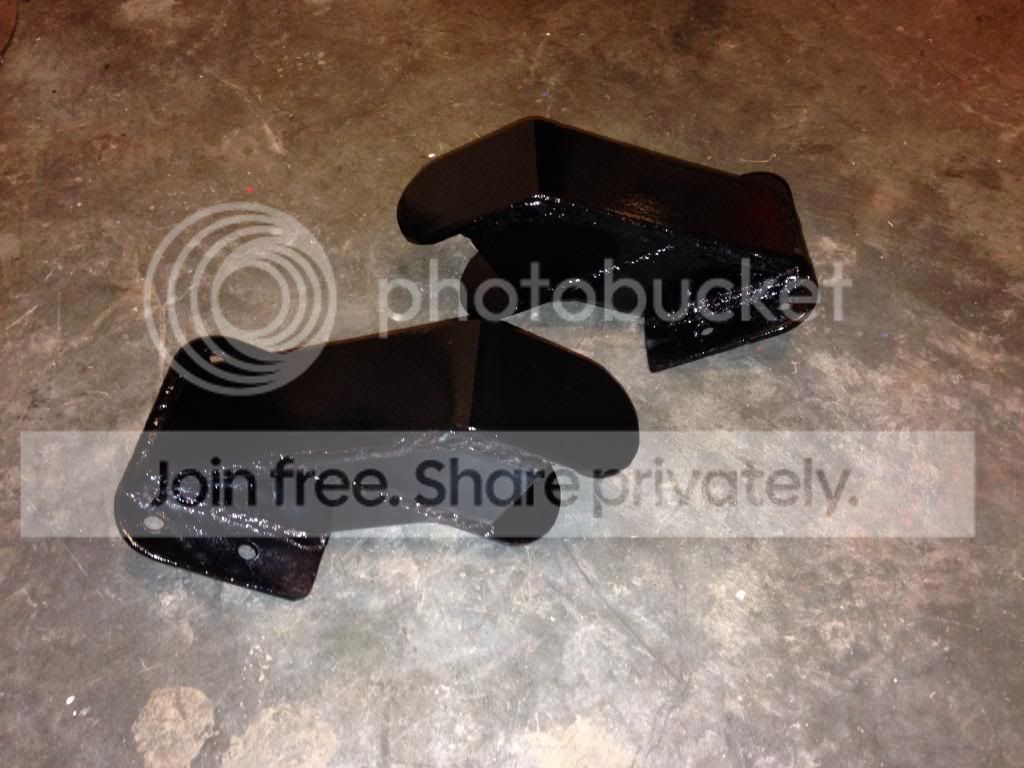

And I thought I might throw in a gratuitous picture of the shackle flips that I built out of 3"x1/4" square tubing and 3"x3/16" flat bar.
What do you think?
Yes I still have to drill holes for the shackle bolts.
What do you think?
I'd make them so they wrap around the frame and bolts to the underside of the frame as well.
Other than that, they look good:waytogo:
