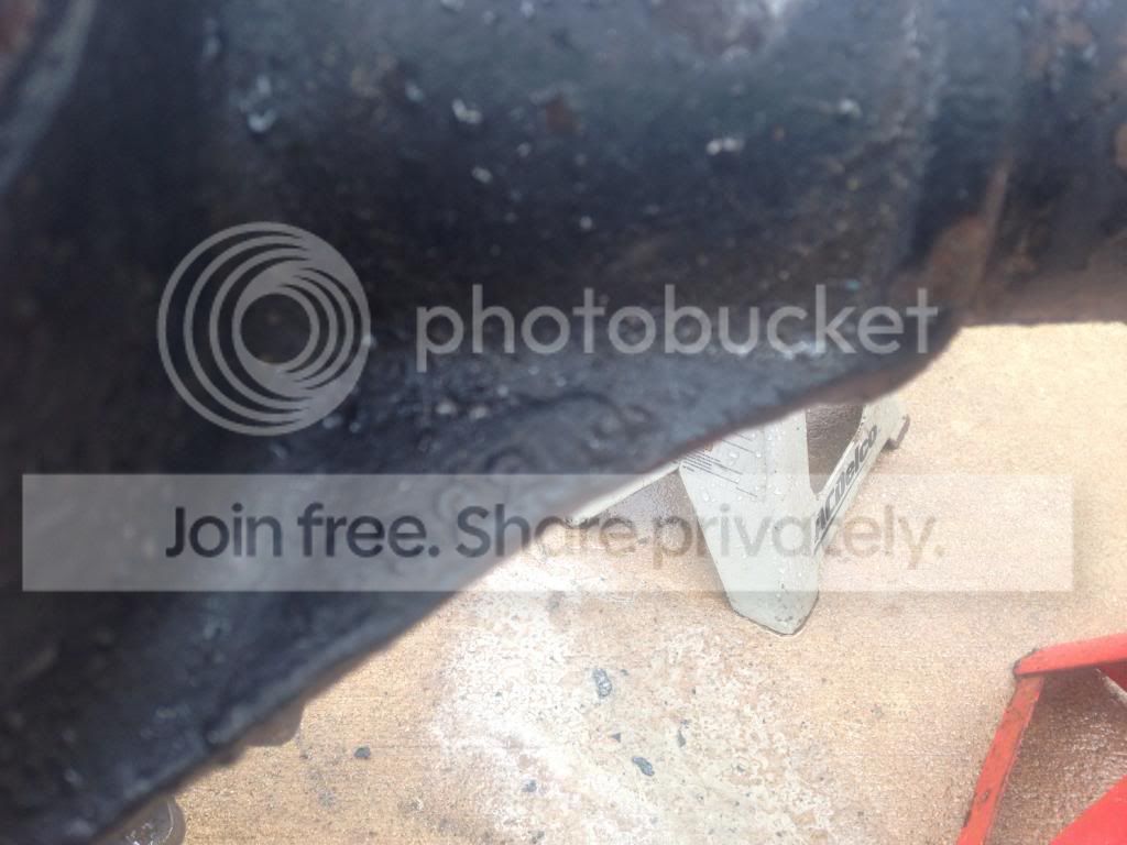

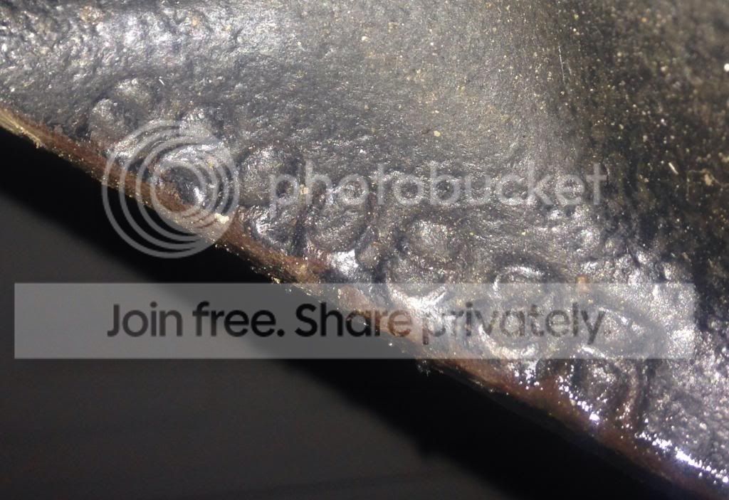

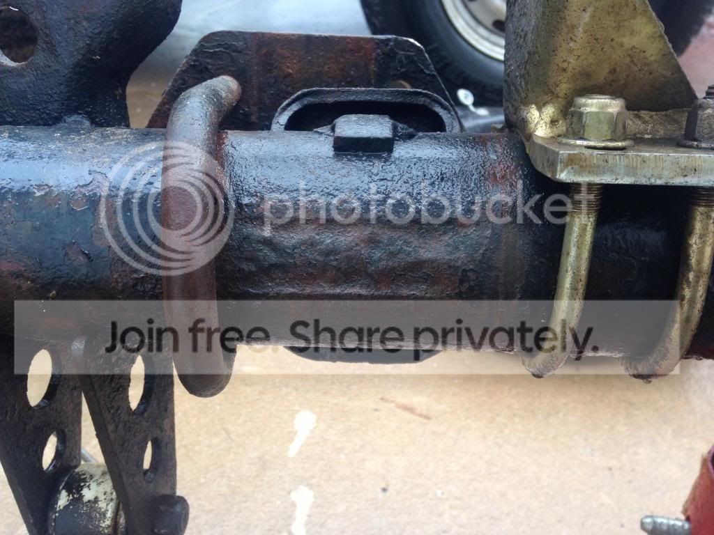

Ok I went out to look for some more numbers and this was all I came up with.
This is the number I posted last night.
Then there was this (322) on the back side.

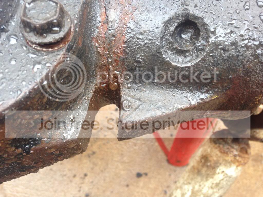

This is where they apparently ground it out for the inverted u-bolts.
This was on the top of the axle tube but I can't make it out.

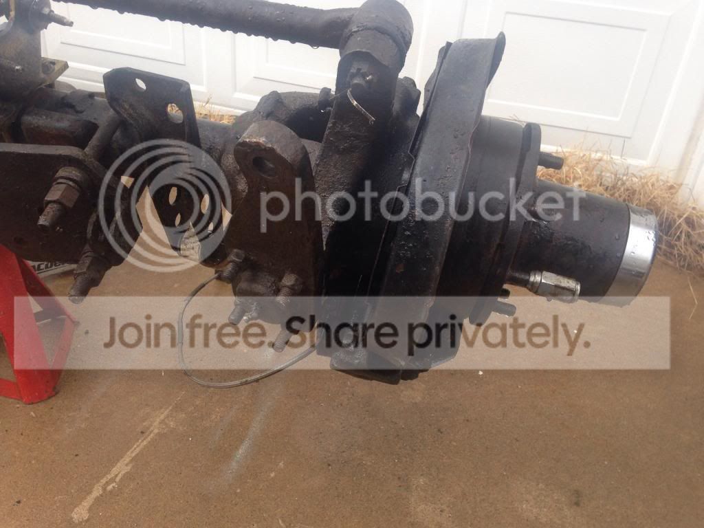

Here is the steering arm, isn't this backward for a Chevy?
I thought the are was supposed to stick out the back, then again I've never done crossover steering before.

The BOM number will be on the tube not the webbing but I doubt you'll be able to read anything. It will be stamped in, not raised, and approx 8 characters long.
That is a regular (probably ORD) crossover arm. It should work for you but you'll need to verify the TRE hole is the correct size for your drag link assembly.

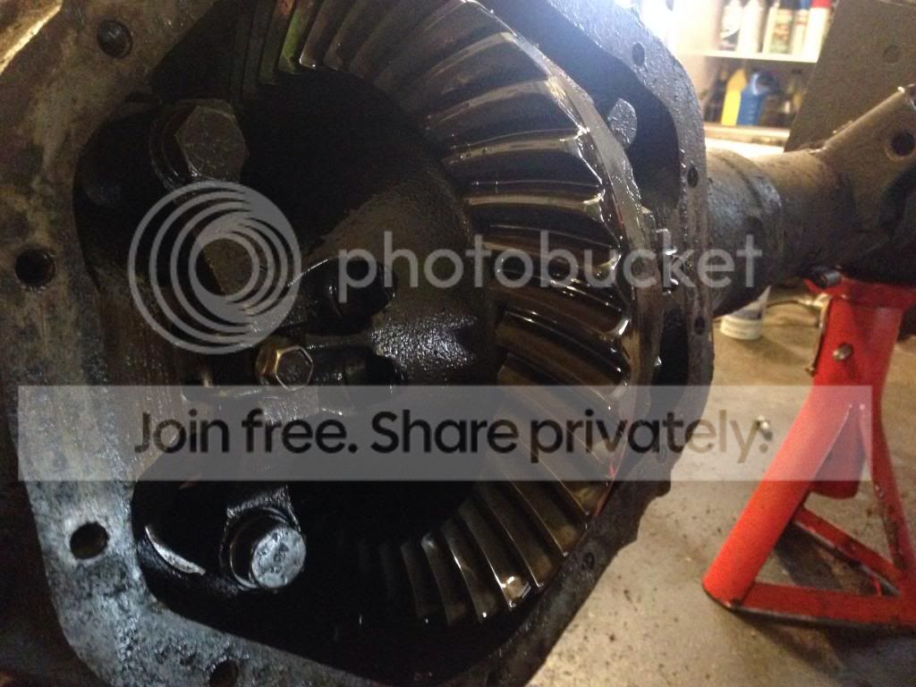

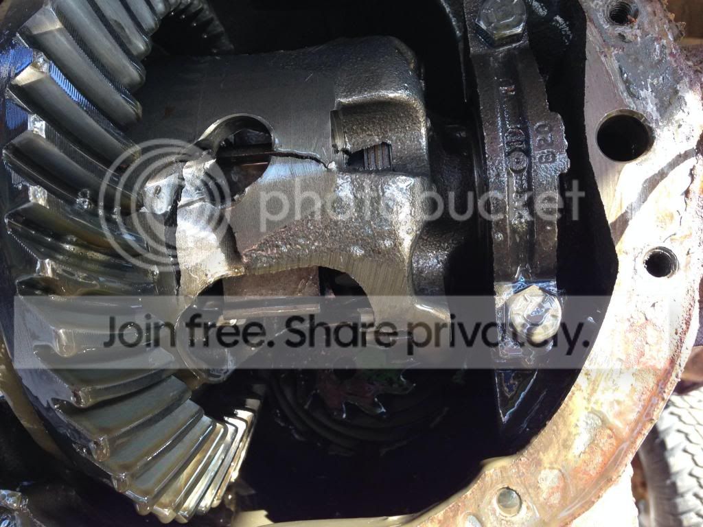

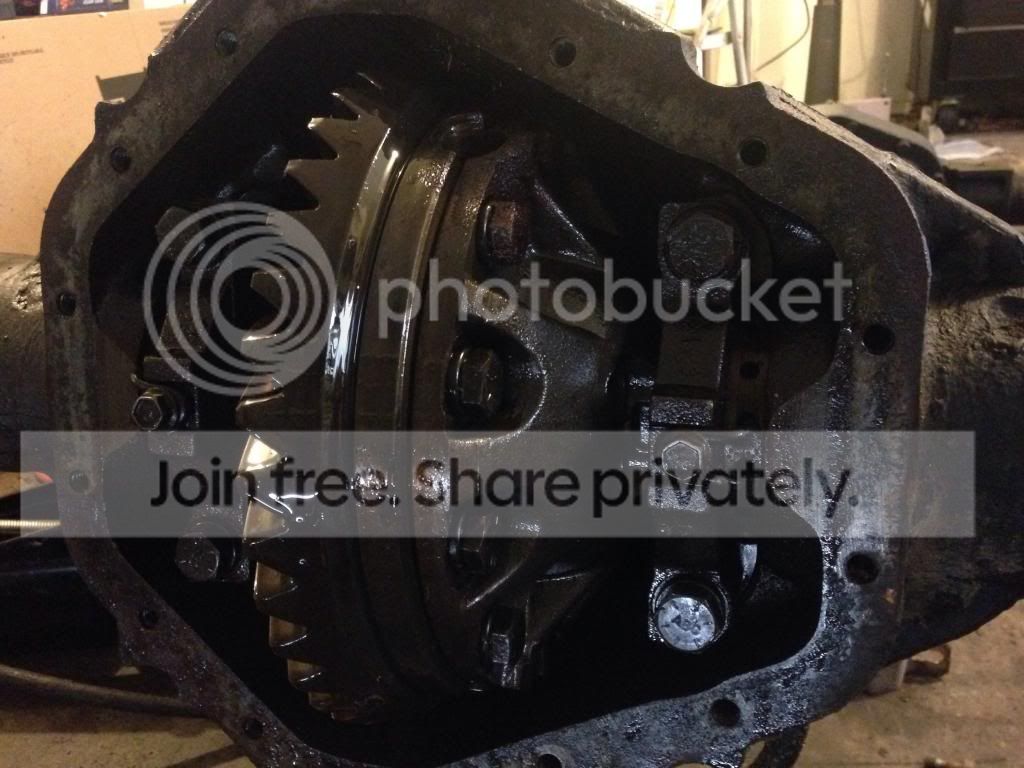

Which type of locker is this I'm my 14bff?
The only numbers on the carrier are 414C and 1171
I've seen the billa vista bible, but if anyone knows of a good page that covers identifying all of the different types of carriers it would be nice to have. Especially since I plan to do a bunch of buying and trading in the process of doing my convertion.
They are better than the 1/2 ton stuff. They still have problems, but usually not exploding problems. The one in mine was all worn out, teeth ground off the fly weight. When they work they are ok, when they don't they are just as bad as an open. I welded pulled the weights out of mine and welded it up.
