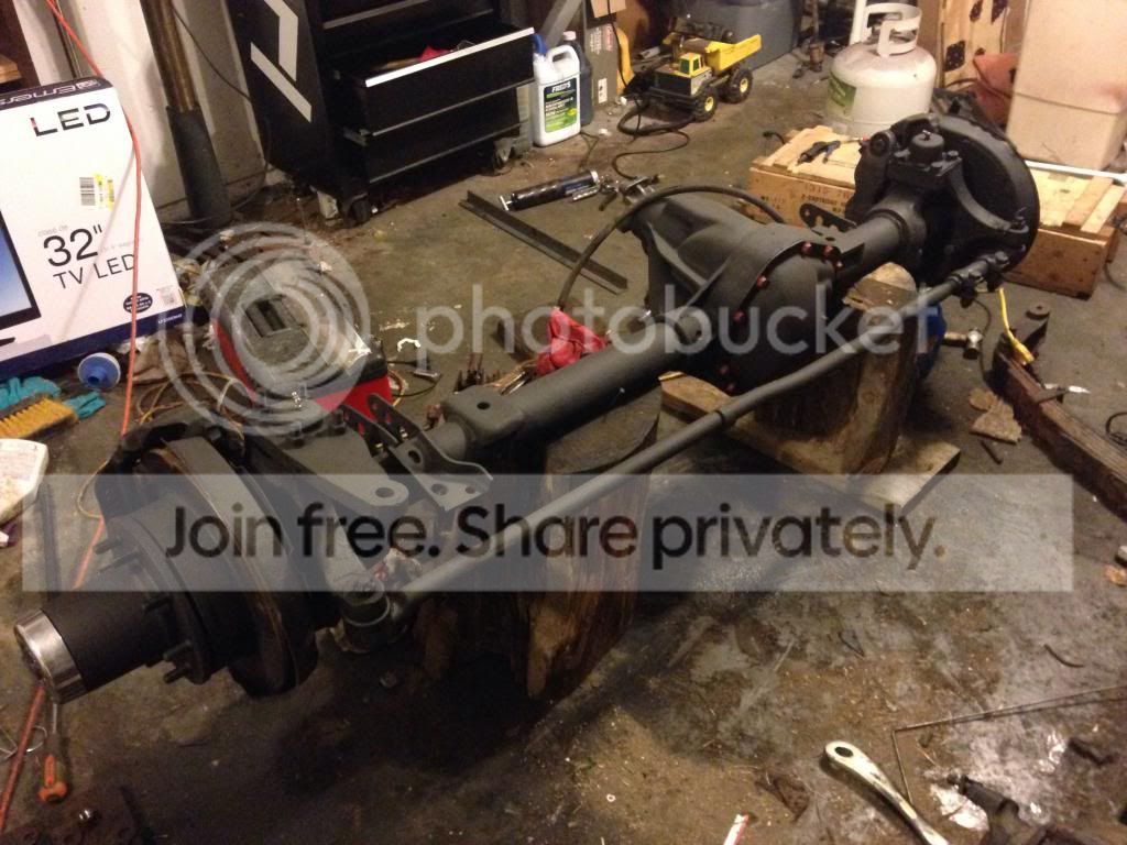

Here she is.
All slicked up ready almost ready to install.

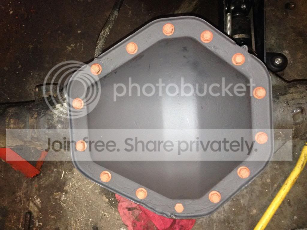

And the 14 bolt is starting to look better too.
The other 14b

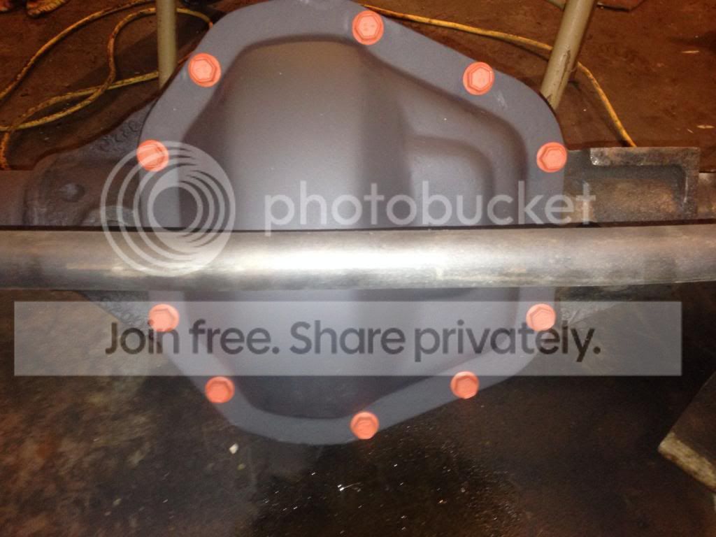

60 before I painted it all
