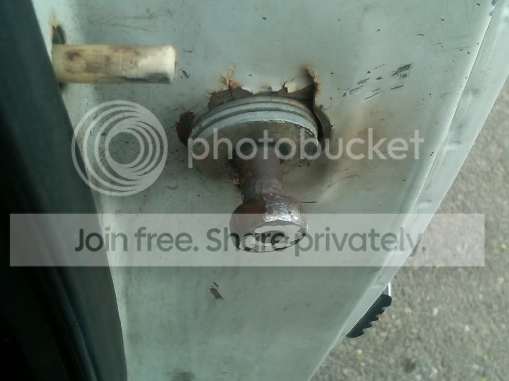

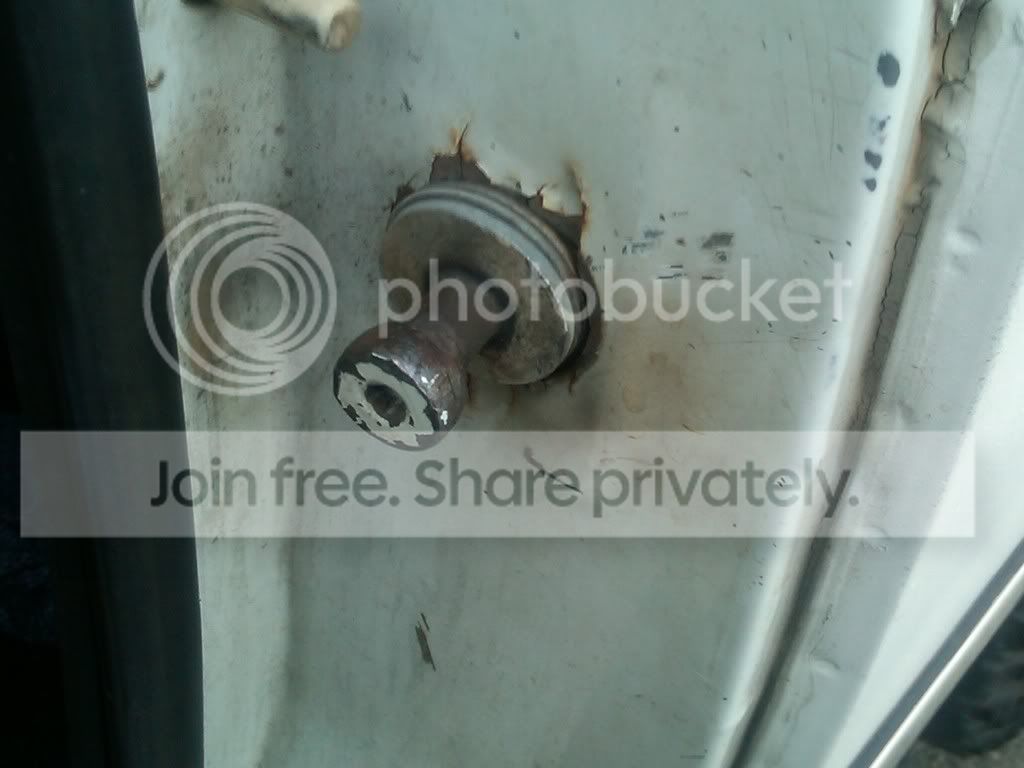

tomorrow im gonna stay after work and try to fix my door latch. as you can see the area around the post is broke and the post isnt straight anymore, im gonna weld the breaks and i have a big washer im gonna weld on there to pull it all back together and stiffen it. right now the door wont shut all the way (have a gap) and its hard to open.
anyone have a better idea?
Nope thats how I fixed it in my 442.
Knock the pin straight and weld the snot out of it. Theres a plate in the pillar thats tacked behind the sheet metal. When you weld it just burn the sheet and the plate together and it will be much stronger.
Stupid design.
