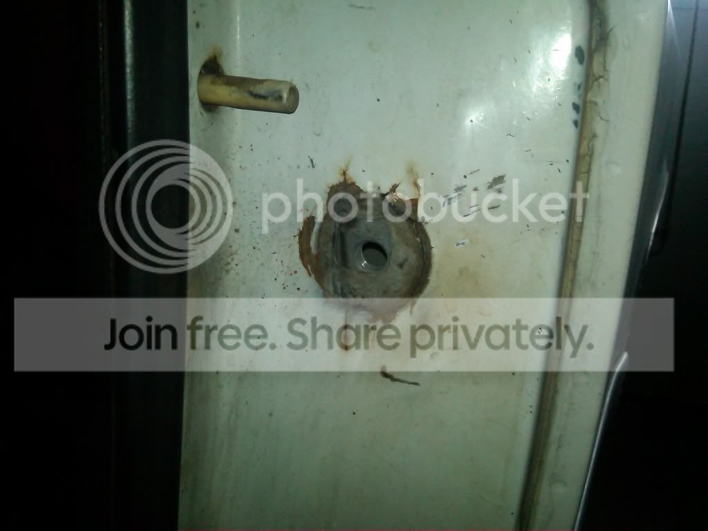

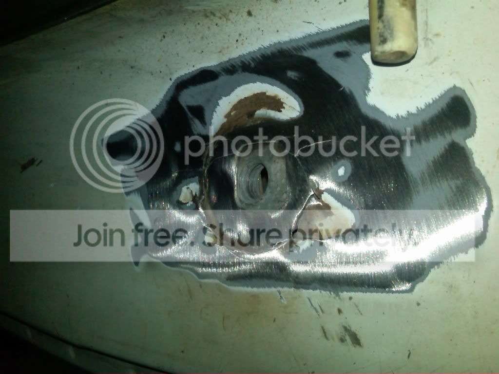

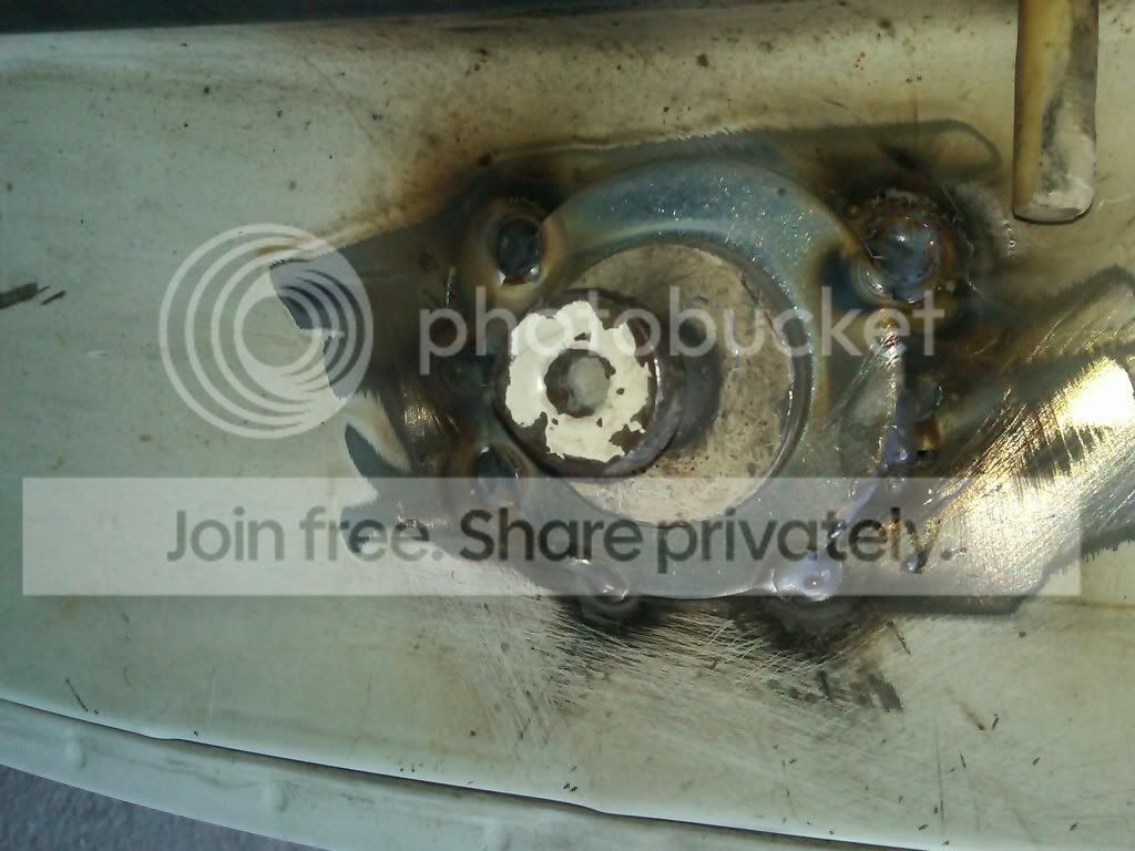

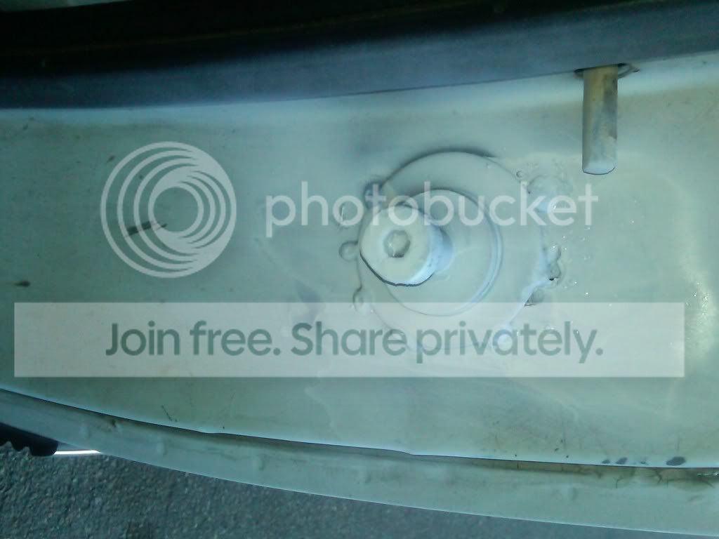

well she aint pretty but shes stronger and the door works good now. used the welder at work, which is a piece of crap, the drive gears are going out so i basicly had to pull wire out, tack, then pull more wire out.
wanted to get some paint on it before it tried to rust, but its so cold the paint just ran

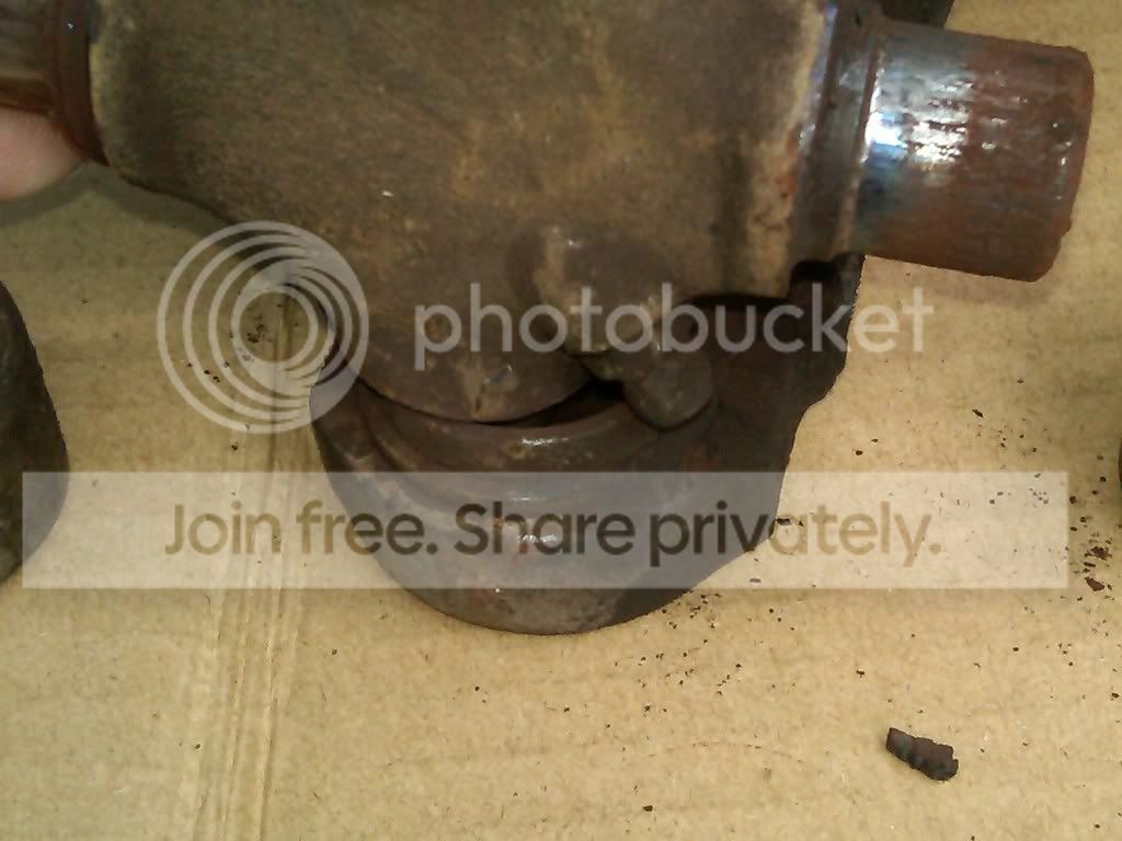

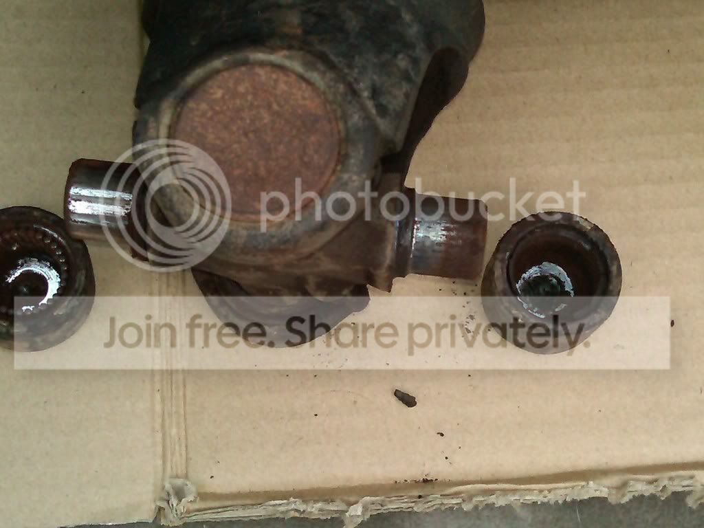

pulled the driveline so i could change out the output shaft seal, ive never seen u-joints this bad that hadnt broke, the bearings were pulverized to dust in a couple.
so i got new u-joints put in, output shaft seal in, pulled the rear diff cover, fluids were pretty good in the axle and found out my gear ratio 4.10 gears kinda shocked me lol.
