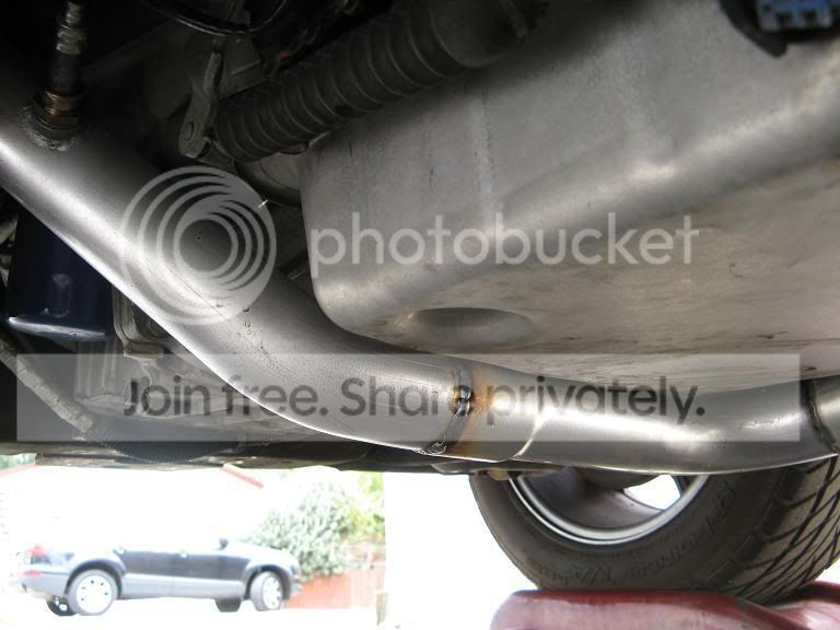

Just a guess because its a pic but comparing the pipe to the shaft makes me think 2in at most for the pipe size.Looks winky dinky.Is the pipe suposed to be roughted under the shaft?That dont seem right to begin with.You said you want to put something together but why not just get a new ypipe made for the truck?
Just got out and measured it comes out to 2 1/2.
OOOO blazer stuff that's right. But really, this 4.3 had a stock 1.5" y pipe, just tiny, got smaller the newer they were, and hung down lower than this one. 2"+ no precat = better. Only hope to have my blazer one come out this clean. I like the idea of going back under the engine, but would any crossover steering get in the way? Or new crossmember for the mater?

I like the idea of hugging the front of the trans pan, might wrap it thought to keep the temps down and make it the pipe removable for trans maintenance.
I like the idea of going clear over to the back of the oil pan too, not sure if the support rods would get in the way though.

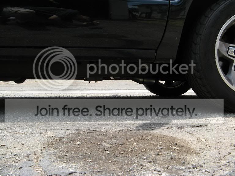

Are you running a cat? If not the way I did mine seems to work well. It is very similiar to munepits above, but instead of running a y pipe I ran dual 2.5" pipes into a Magnaflow with a single 3" outlet over the rear axle and out the driver's side. No Y pipe to deal with, and the entire exhaust is contained above the frame rails helping to prevent trail damage. I was able to get the trans and transfer case out without much of an issue when I rebuilt the trans.

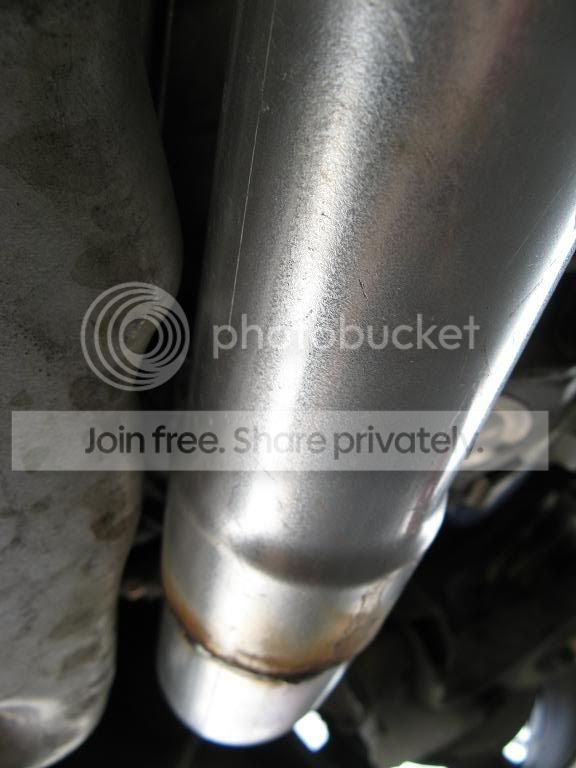

New Y-pipe 70-series Flowmaster
I have to show off the new y-pipe I had made this morning. I have Hedman 69830's with a 700r4 (yes they clear the linkage). 70-series flowmaster with a flowmaster y-collector. The truck has a great sound to it now. Nice and mellow. I can talk to my family now. I'm very happy with the way it sounds.

What size pipe and any chance for a video clip to see how it sounds?
So you ran duals to behind the xfer case....interesting.
My ypipe comes RIGHT under/in front of the trans pan.

Yeah, I've seen someone else do it this way. I liked it... so I copied it.
Nothing against this routing, was just thinking out loud. I took direction on routing from Scott. He actually went and talked the shop through where he thought it should go! :waytogo:
