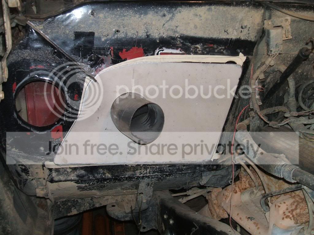

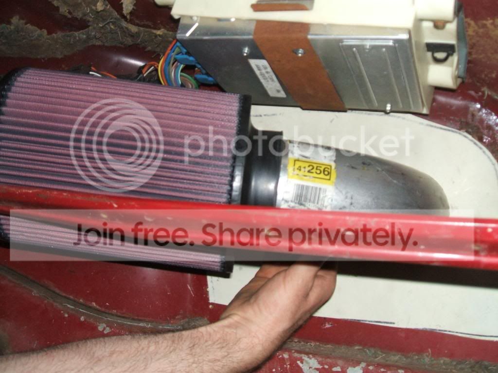

Back to the intake, My intake runs through the firewall and the air filter is under the pass side dash

now this is what i was looking for thank you. i have ac so i wouldnt go through the firewall like that but i love the setup. so it looks like you cut up a stock filter housing to use on the carb correct? did you just use some sheet metal to make it taller like that?
Mine is TBI but yeah we used the original base and top of the air cleaner housing. That's some flat steel we had lying around. First it was bent around an old brake rotor to get the dimension pretty close, then it was clamped & welded to the old air cleaner pieces
