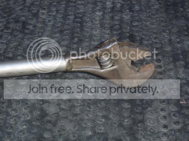

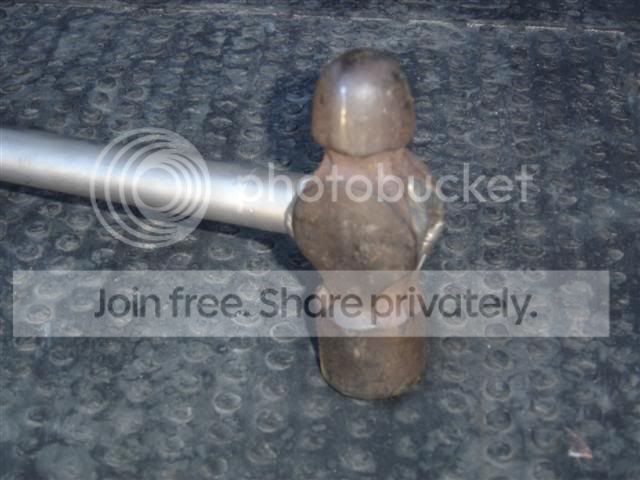

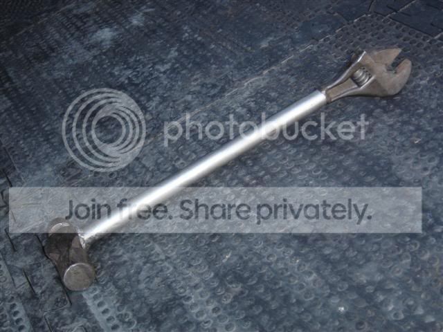

Navy Adjustable Hammer
I got bored one day a few years ago and made this...
Screwdriver end :haha:
Adjustable Hammer :D
The Multi Tool :bow:

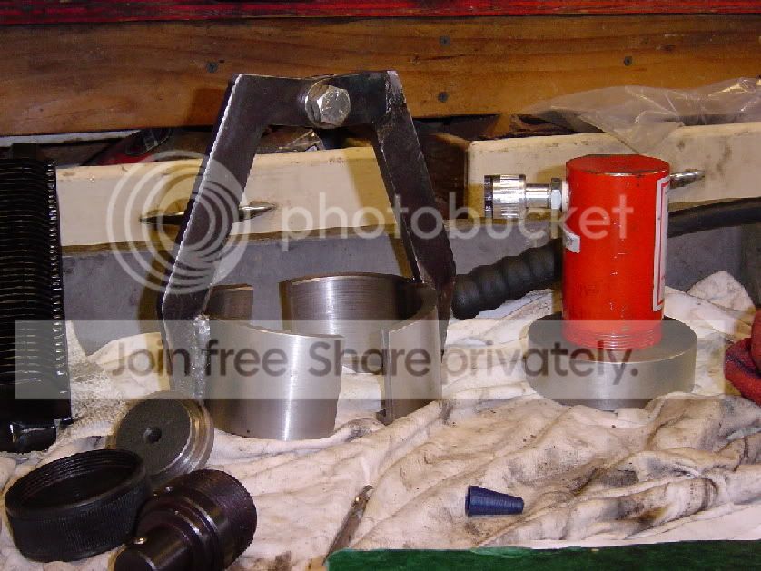

I made a puller for the carrier bearings on my D70U.
With the race on the bearing, the Hydraulic ram with the metal ring is placed on top, then the hinged doohickey is clamped around the whole deal. Then, the metalring is threaded towards the end of the ram until the top of the ram is snug against the top of the yoke, effectively sandwiching the bearind and race between the puller jaws and the threaded metal ring, then, hook 'er to the pump, and pump away. Works like a charm. The materials cost aboot 1/4 of what the proper tool from Randy's R&P costs.
