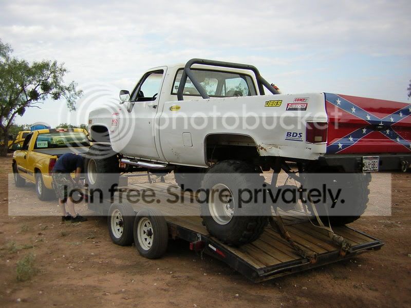

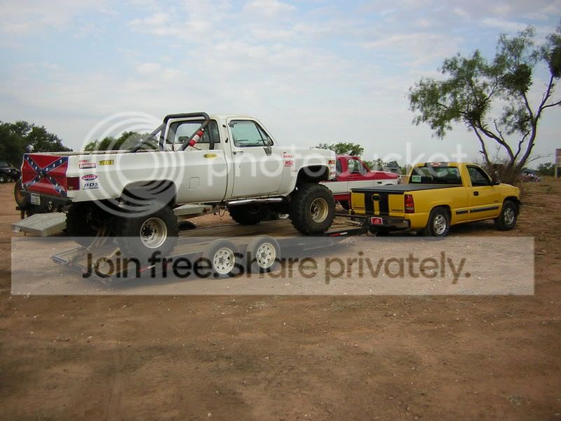

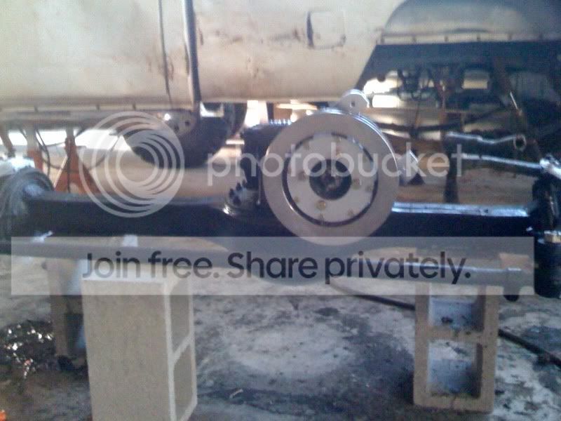

replace and rebuild 2 axles, paint, and install new brakes hydraulic assist and rear steer, build 4 new rims and mount tires, put tranny and t-case back in, dont test drive it just pull it on the trailer and leave for shiloh after working on the truck for 36 hours straight, dont worry about saftey or sleep.....

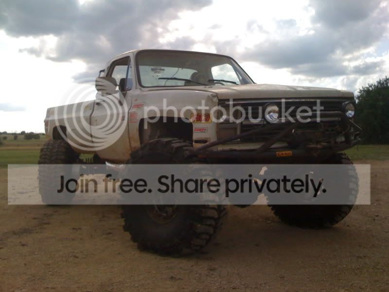

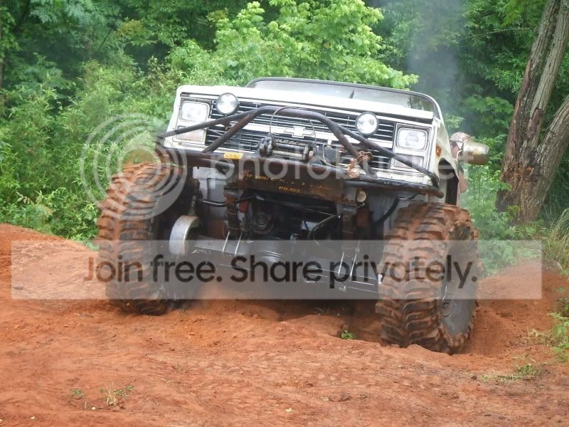

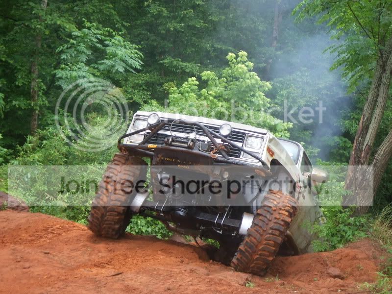

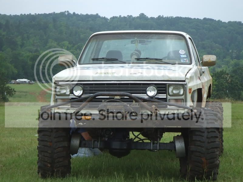

well thanks, i think it looks a lot meaner now myself, but i really liked the straight body....it took me a while to not fear body damage (thanks daniel)...

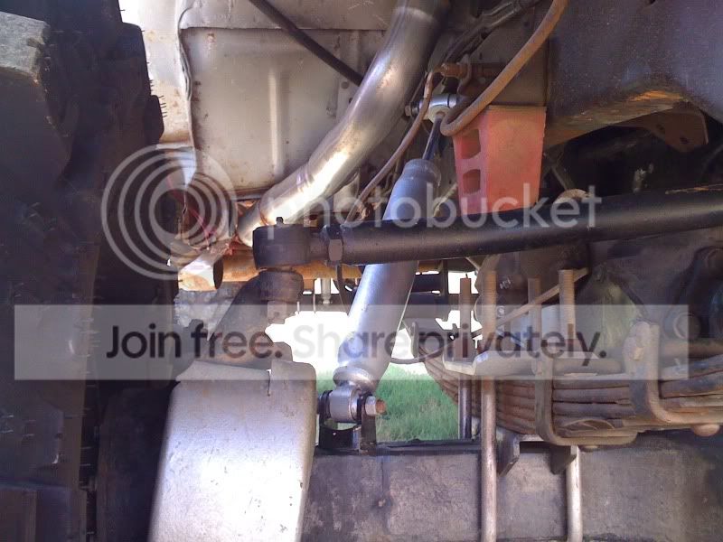

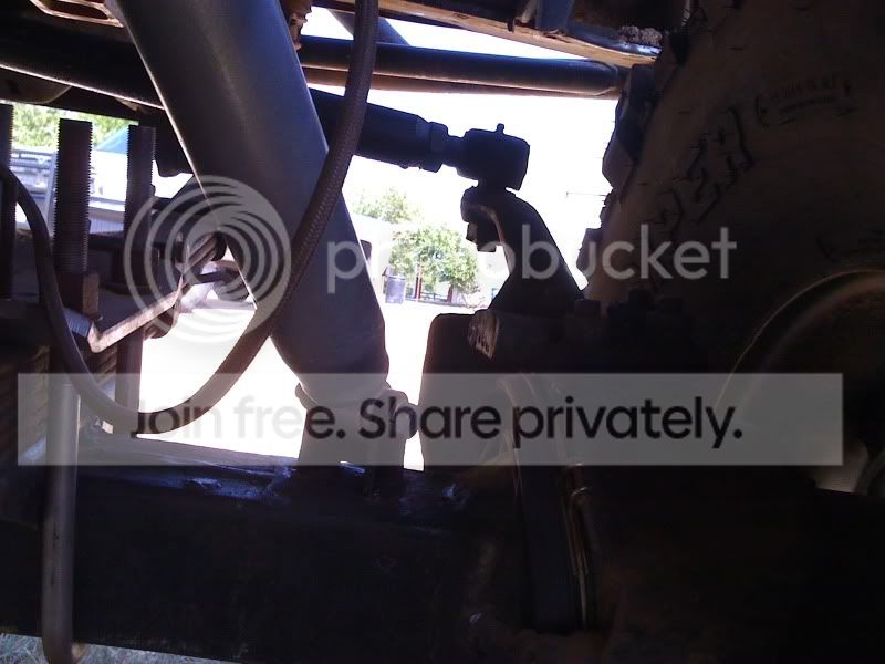

but no, i do not lock it out on the street, i just try really hard not to hit the button lol...i know i probably should, but i havnt figured out a quick and easy way....any suggestions?
Quick release pins on the cylinder ends so you can remove it and replace it with a solid link? You'd have to have a spot nearby where you could store the cylinder without removing the lines.
Or just quick release pins on a solid link that is parallel to the cylinder?
ya, i may try that....a solid link opposite the ram with some quick release pins...why didnt i think of that :doah:.....i would feel alot safer on the street that way....

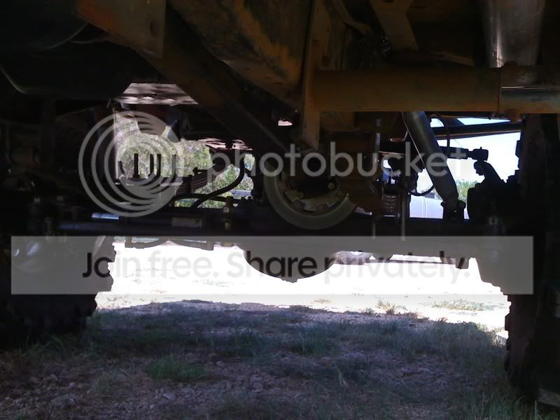

Lol been there with being under the truck. I hate that feeling of "jeeze I hope the wind dont blow to strong and move a grain of dirt under the tires while I'm banging on this broken part" :D
That towrig of your has to be screaming in pain :doah:
yea, i find myself in that position pretty often...that particular time is when i found out my rear driveshaft did not have enough slip and ripped the output shaft out of the tcase :doah:

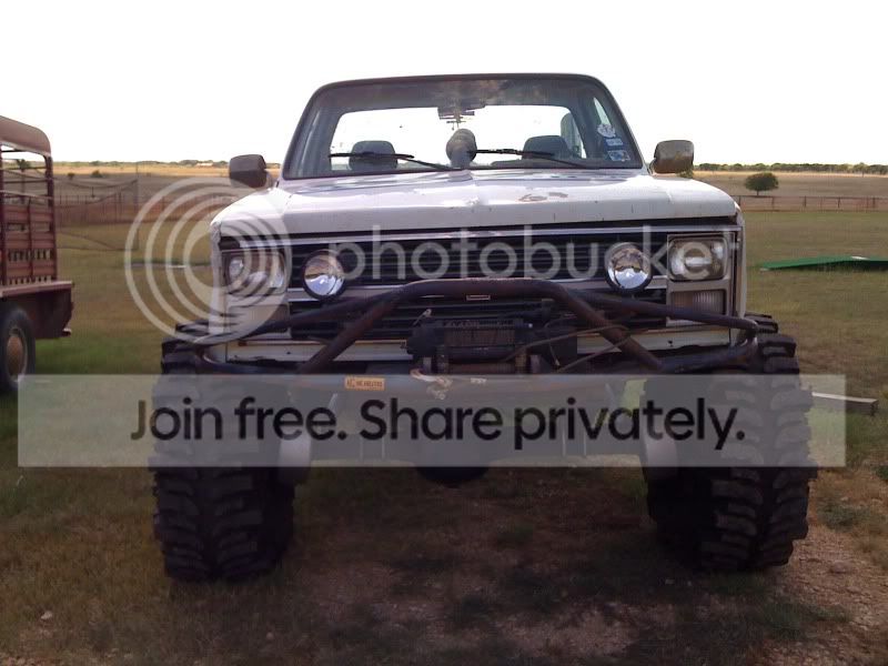

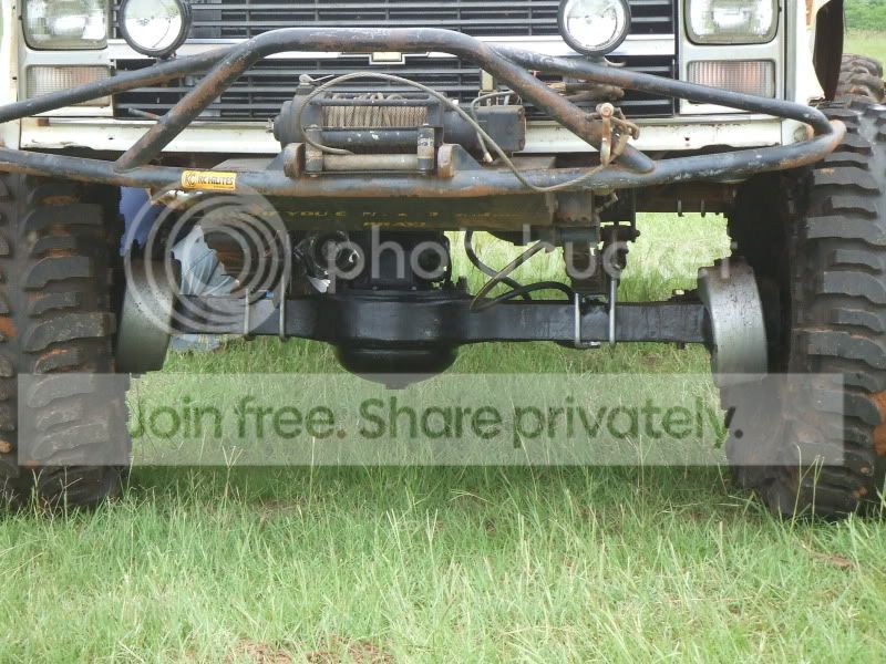

front axle...
turbo...

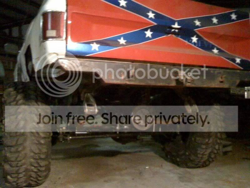

rear-steered....

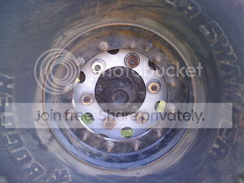

H1 rim with Copperhead Fab center....

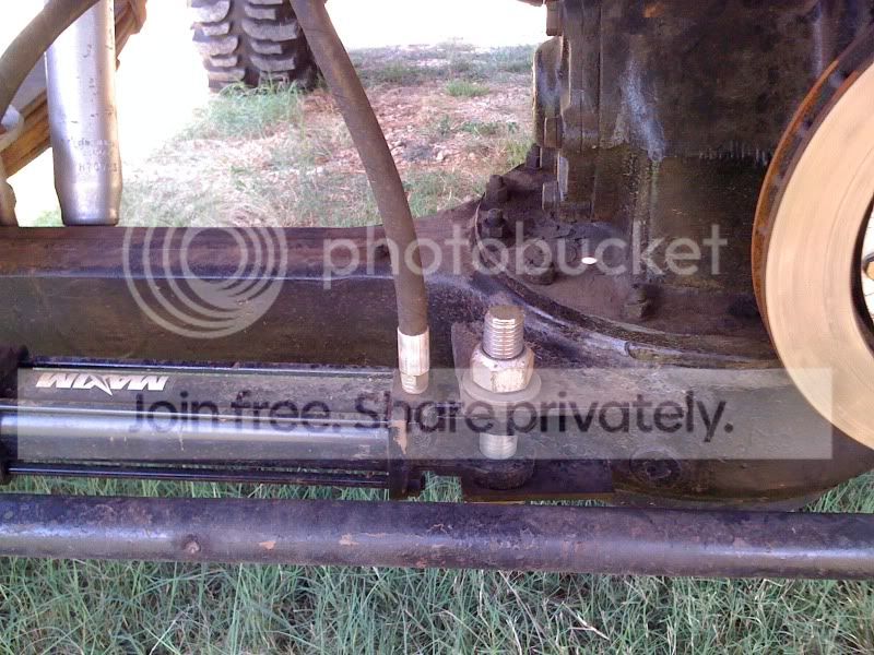

Rear hydraulic setup....

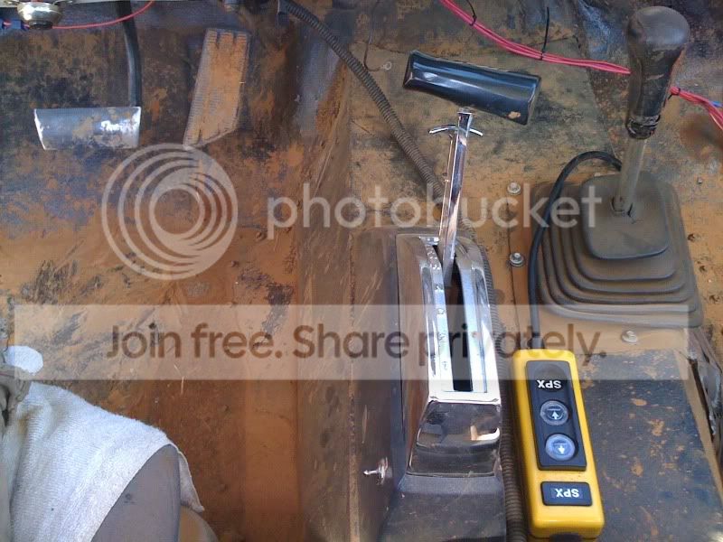

shifters and rear steer control

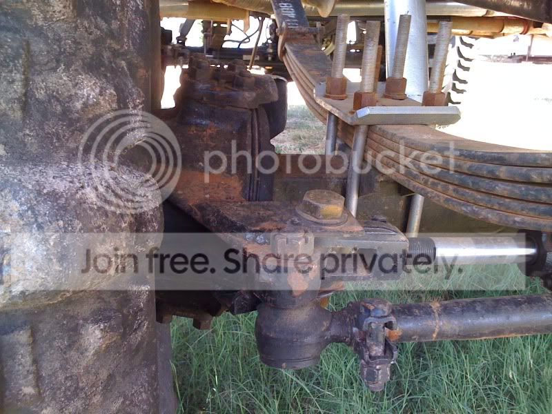

steering arm

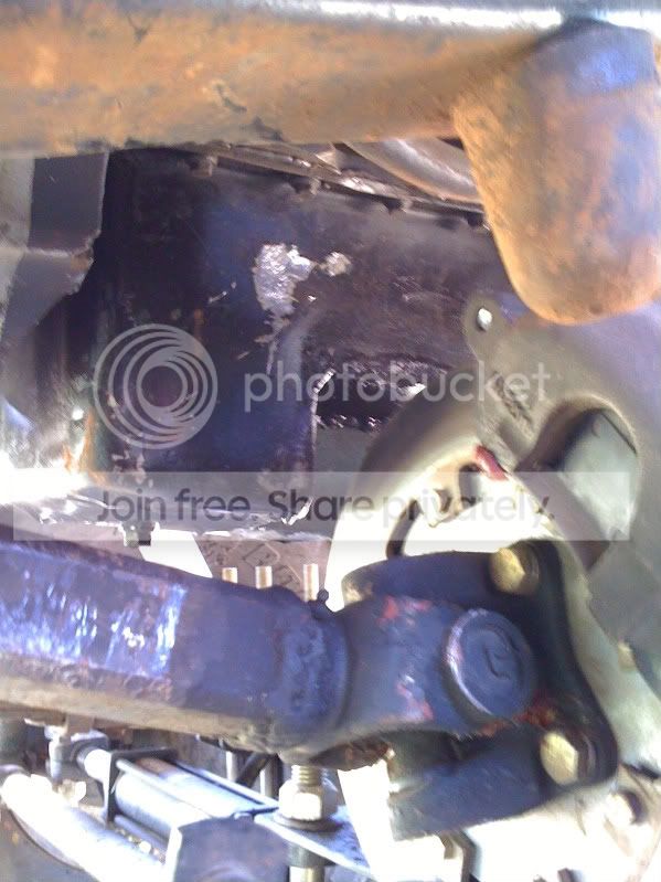

front driveshaft and notched oil pan to clear brakes...

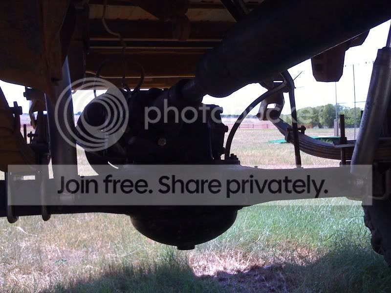

rear axle and reverse shackles...

rear hydraulic setup at the knuckle...

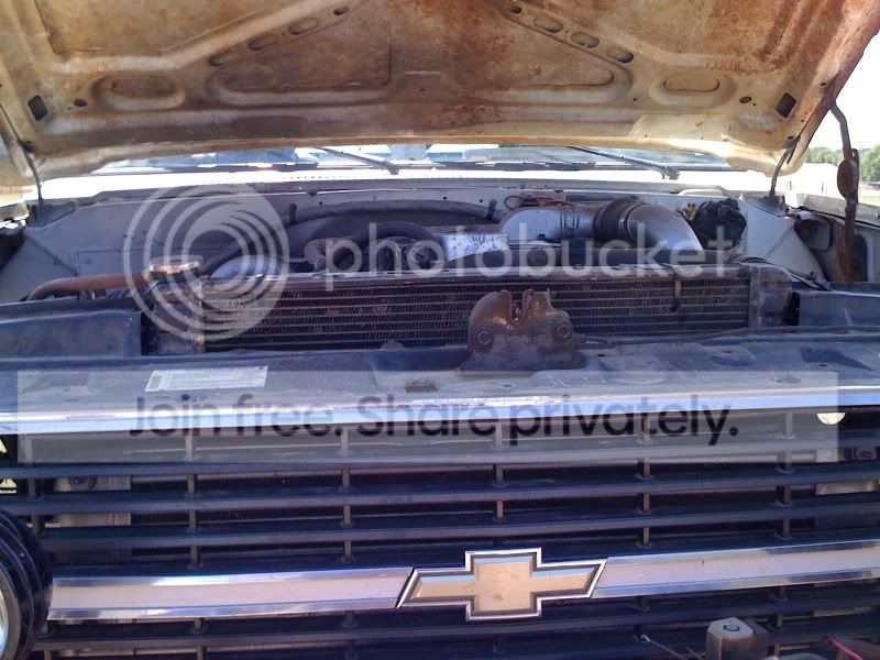

had to cut radiator support to get radiator further forward....

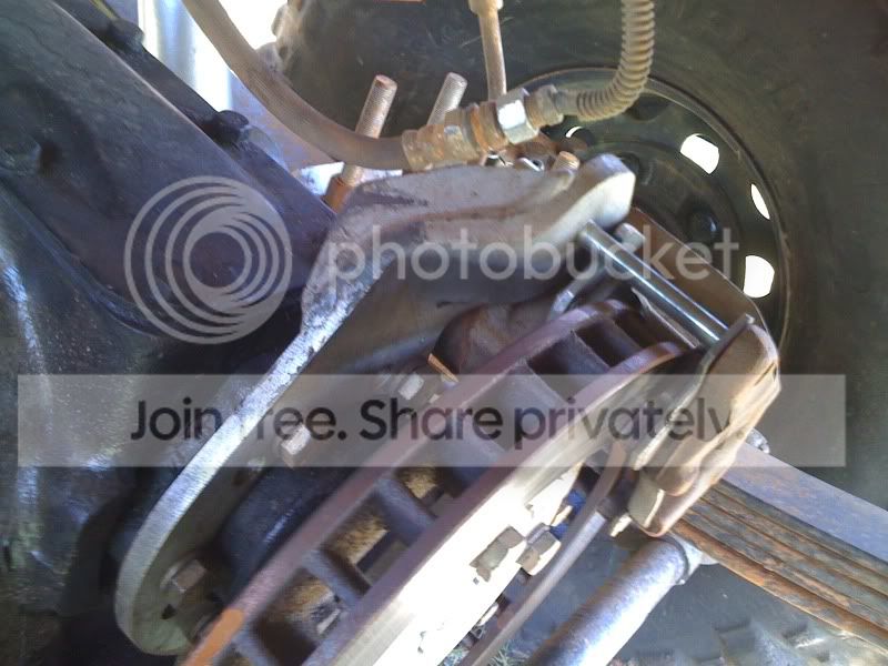

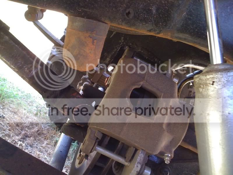

rear brake setup from DIY4x

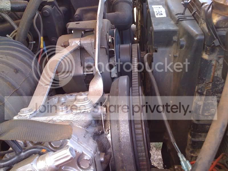

york compressor and summit electric fans

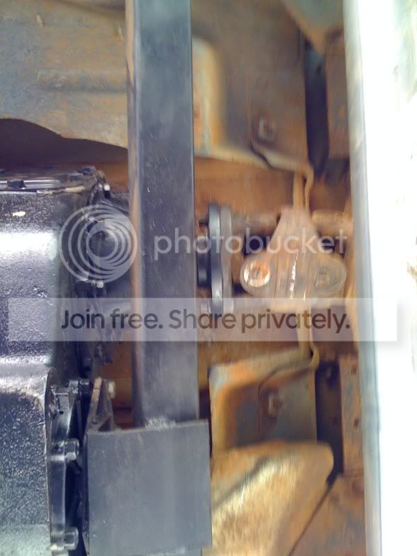

rear support for tcase...

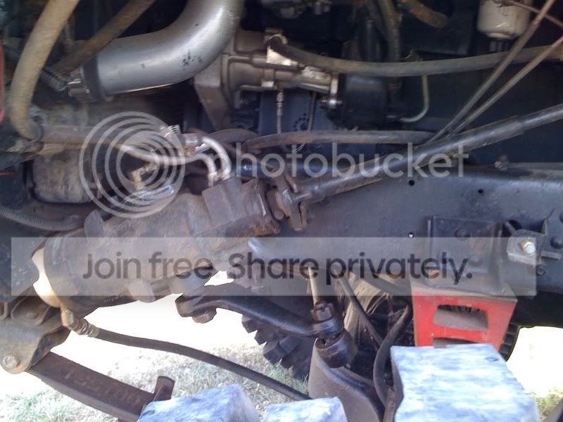

steering...

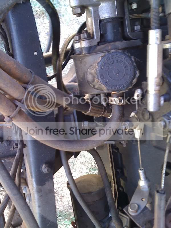

motor mount and power steering pump...

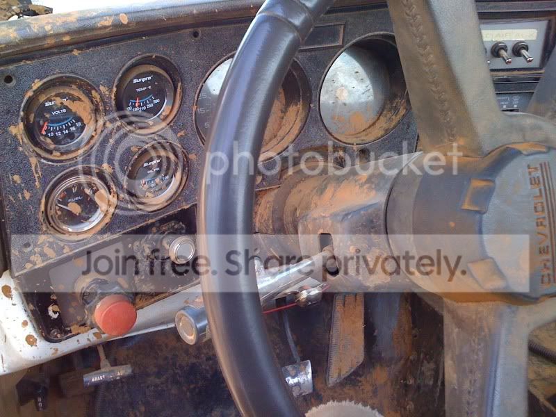

gauges and hand throttle...

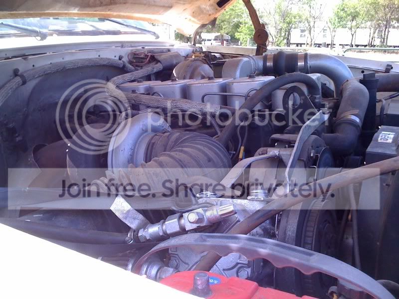

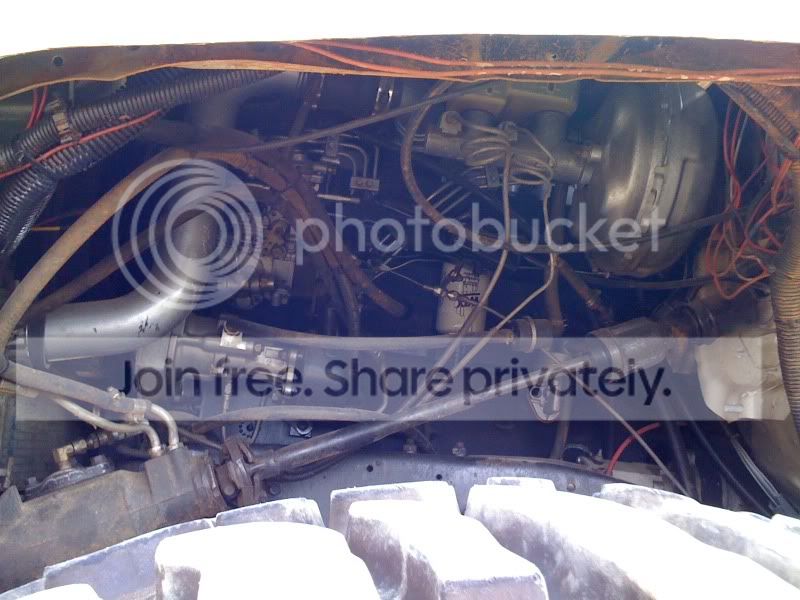

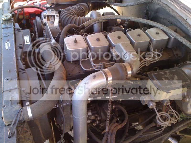

engine compartment...
steering arm and draglink...

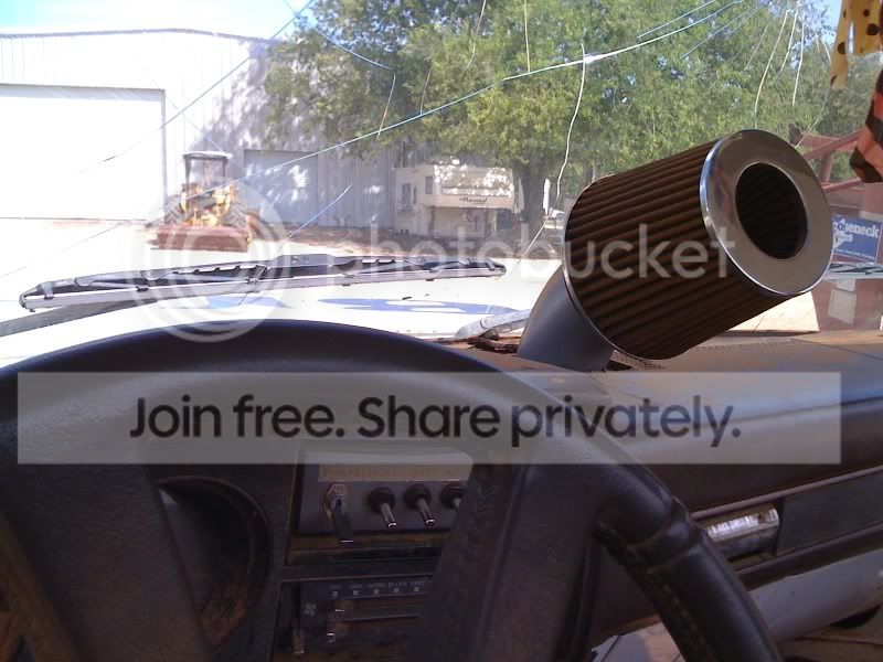

the dash snorkel lol...actually keeps it a little cleaner than the engine compartment...
notched oil pan...
Was your truck a 1/2ton to start with? The reason I ask is if it was a 1/2 ton frame how is it holding up to the cummins? Also are you running just pinion brakes on the street?
How loud is it with the snorkle on the dash like that?
Your windshield looks like mine. :doah:
the truck was a 3/4 ton to start with, had a 14SF and an 8-lug 10-bolt...pretty much the same frame i believe though...it appears to be holing up pretty good...i did some checking on the wieght of the cummins and the wieght of a 454 and they are pretty close...also i used the stock motor mount location so i didnt figure i would have any problems...time will tell tho.....and yes, for now all i am running are the pinion brakes on the street...bad, i know, but i cant afford wheel brakes right now....but i dont even touch them till about 5mph, i downshift....i dont hardly drive it on the street that much anyway, just to the car wash and the gas station, sometimes its cool to go to wal-mart or dairy queen just to look like a badass :bow: lol

it gets kinda loud sometimes with the turbo, but i love it :rolleyes: .....
