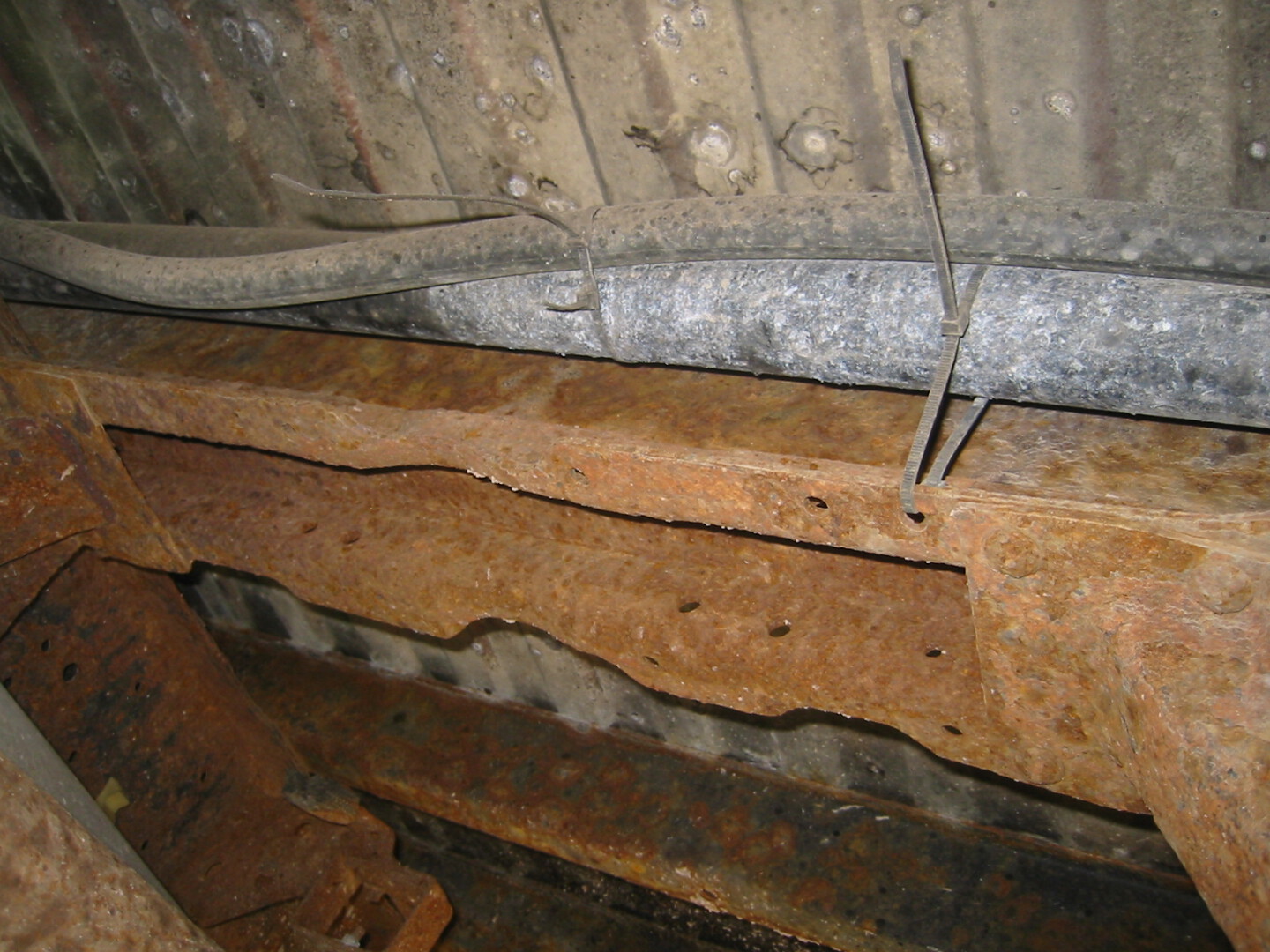

Let me demonstrate:
My C10's frame that spent it's entire life in MIchigan:
And and example frame from a vehicle from the south:
There's still paint on that frame!

Let me demonstrate:
