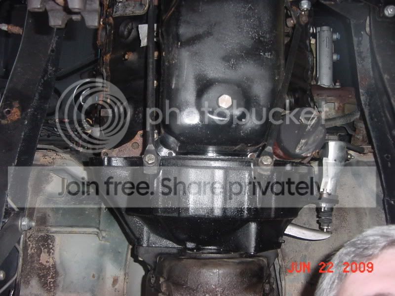

There is a bracket that fits between the block and motor mount plate. The only way would be to lift it up, un bolt the plate from the block and slide it in. That's why I was wondering if they were critical or not so much.

Pretty straight forward :dunno: no motor lifting... You need to look @ it again. Mine went in after a 700r4 to sm465 conversion. Why would you need to lift your motor :confused:. The biggest pain in the ass I had was putting my starter in before my dust shield :doah:.
The top end of the bellhousing bars bolt to a bracket sandwiched between the block and motor mount bell. Your pic only shows the lower end. Bww3588 doesn't have the brackets installed on the block end.
Look at the forward end of the bar in this pic, you can see a portion of the bracket.

Actually if you you follow the pic to the motor end of the brace you can see it (maybe your looking on a phone?). There is room on mine to run the bolt through towards the block and thread the nut. Not really sandwiched imo. My chevy is no different, just sayin...
You might want to look at what all that lot is going thru.
Bolt -> bar -> bracket -> nut
The bracket is between the motor mount bell and the block which is all resting on the motor mount. Lift is required to put his missing brackets in.
