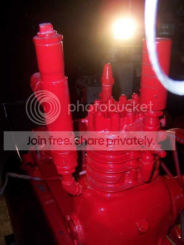

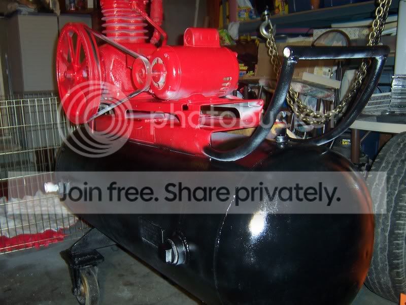

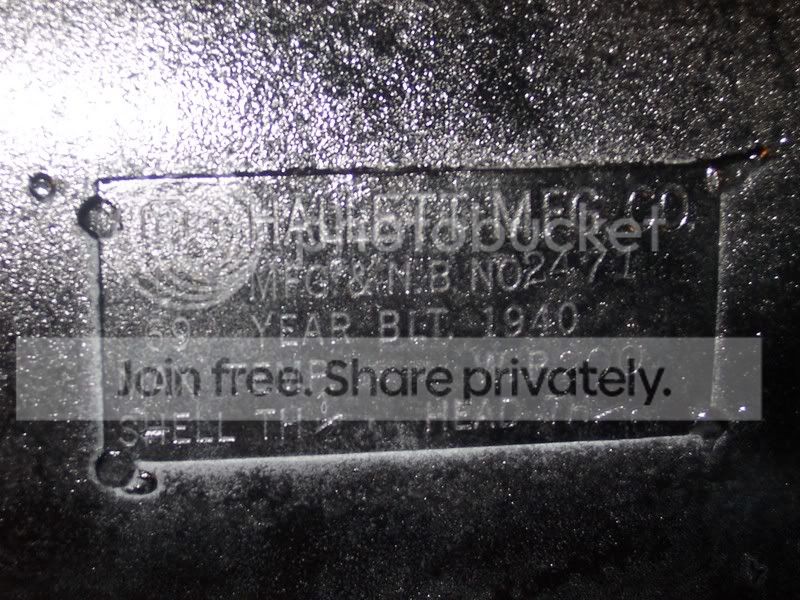

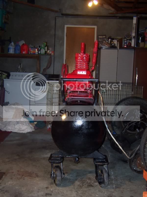

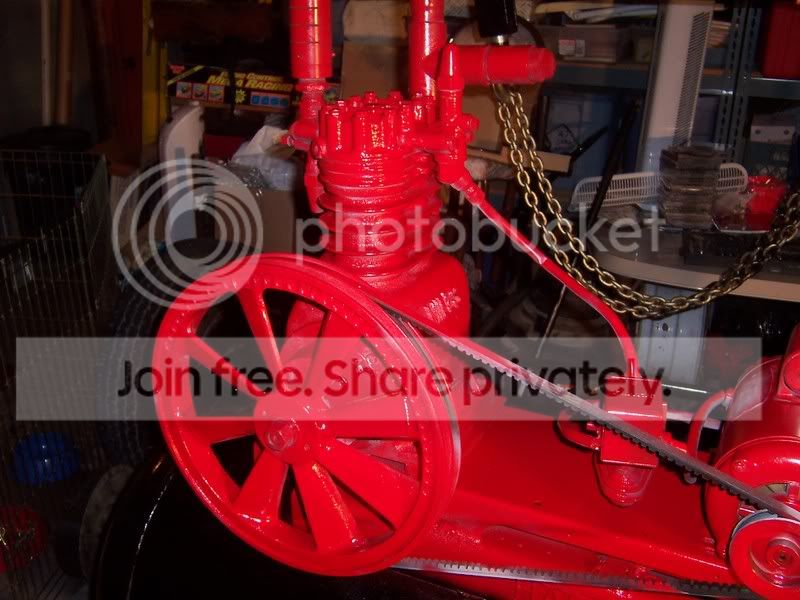

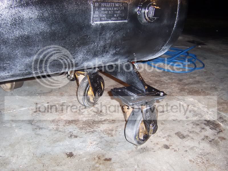

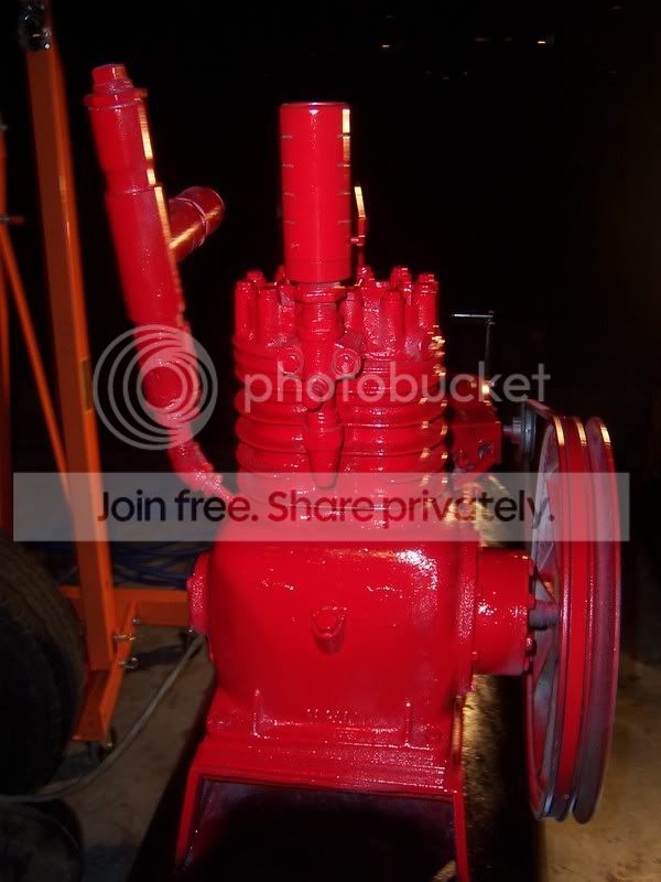

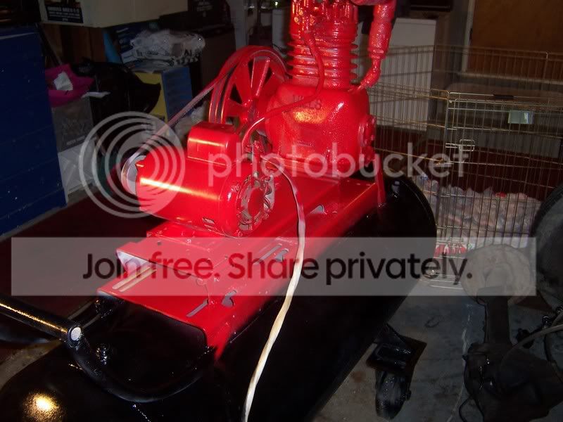

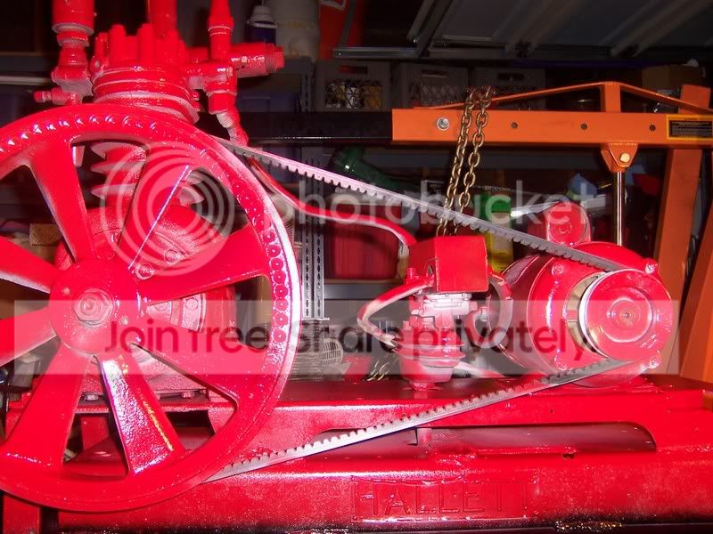

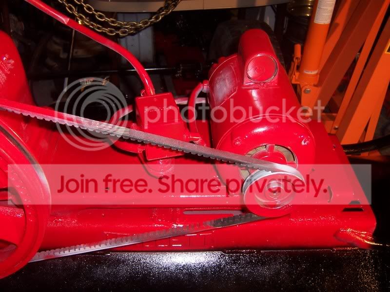

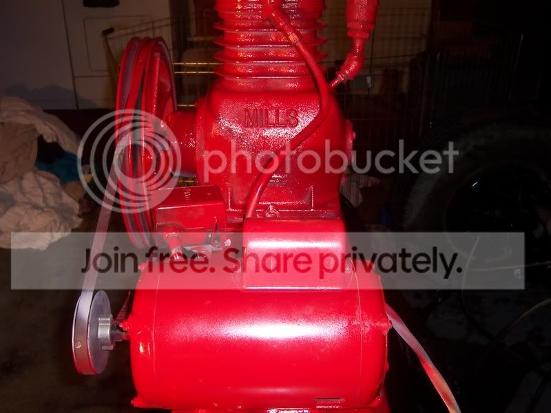

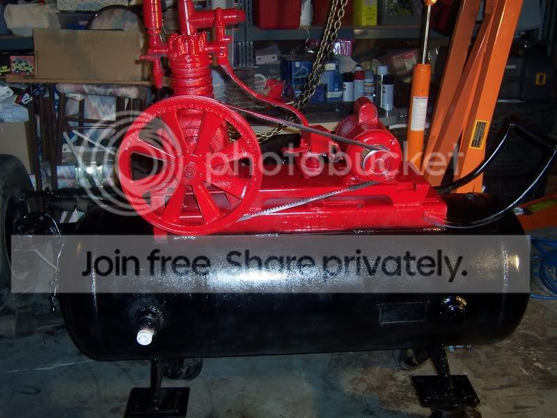

Anyways I got it all cleaned up so here's some pics...oh and btw look at the manufacture date on the tank...1940! Gosh I love old tools...
