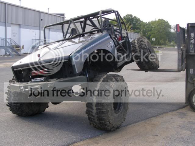

Looking at any truck that flexes worth a damn its clear to me that you can push a leafspring on one side down farther than it would go in just droop. The fact that the pumpkin isn't centered amplifies that problem.

Going fast and having the axle drop out quickly will achieve similar results in my head.
Maybe not quite as far, but with centerline of the diff not being out at the spring, articulation wont have the same effect on the shaft.

So I have had many many problems with this. Not only in a square. But in every long travel leaf spring suspension with shackles in the back, in a front axle ( non centered) application.
The one situation where you almost always have problems are climbing a steep high traction surface. The front axle in forward movement wraps down not up, your front end is unloaded ( in the air) then it grabs traction and gets just enough traction to create axle wrap. And boom seperated driveshaft.
In addition in rapid transition i.e. jumping if you have very little spline engagement the driveshaft can bind that's can also result in serious issues.
In my suspension I have measured 7.75" of slip. I give myself an inch on compression and 2" on extension. So about 11" of travel is what I require. In 5 years of wheeling with a 12" travel shaft I have not had a single problem with the slip
