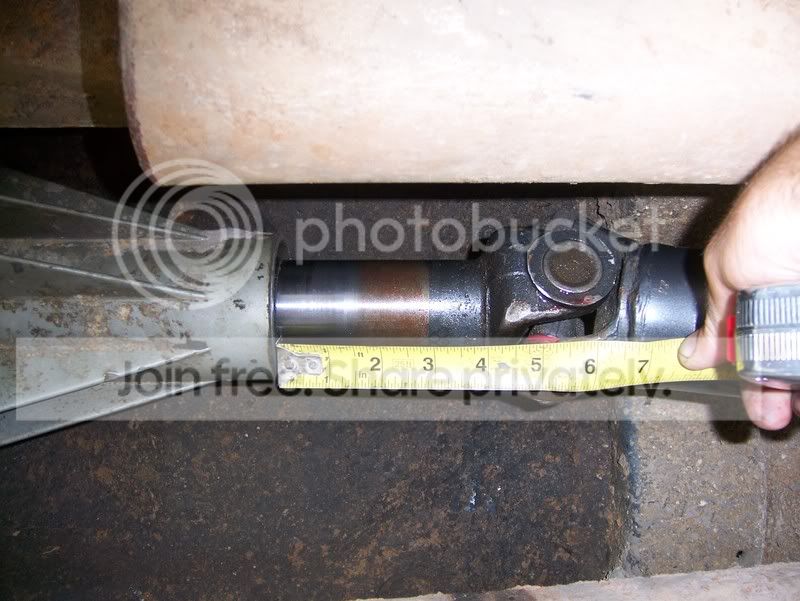

looking at this picture, and knowing that the slip yoke is a total of 6"s long how much would you tell the guy at the driveshaft shop to lengthen it? i was thinking either tell him to add 2"-2.5" so that the driveshaft can still move in plenty.
to the rust line, bout 1 3/4" to 2" max.
The shiny part is what was originally inside the TC for all those years... the rusted part is the part that's exposed to the elements...

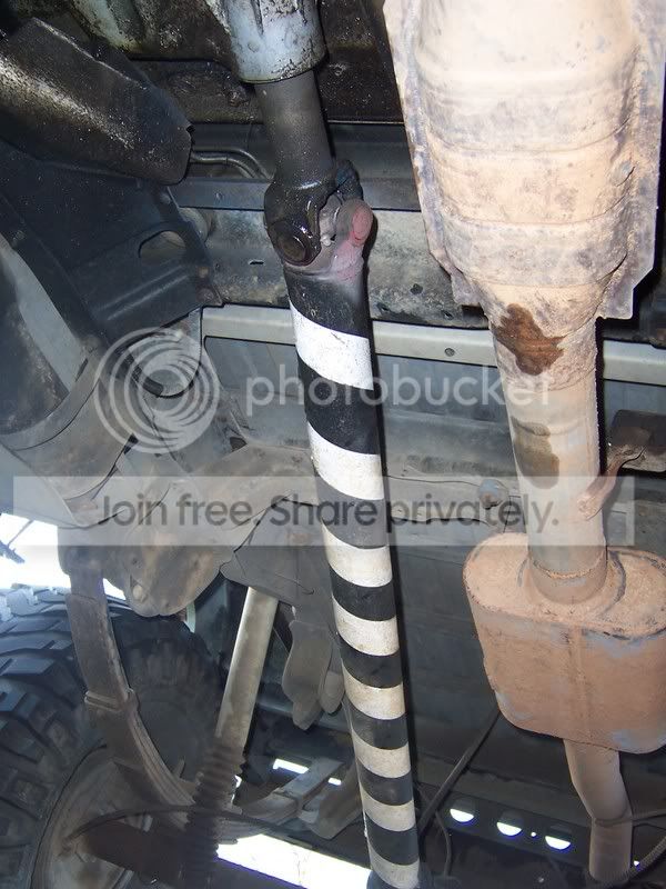

Here is how my stock length shaft looked with 8" of lift....

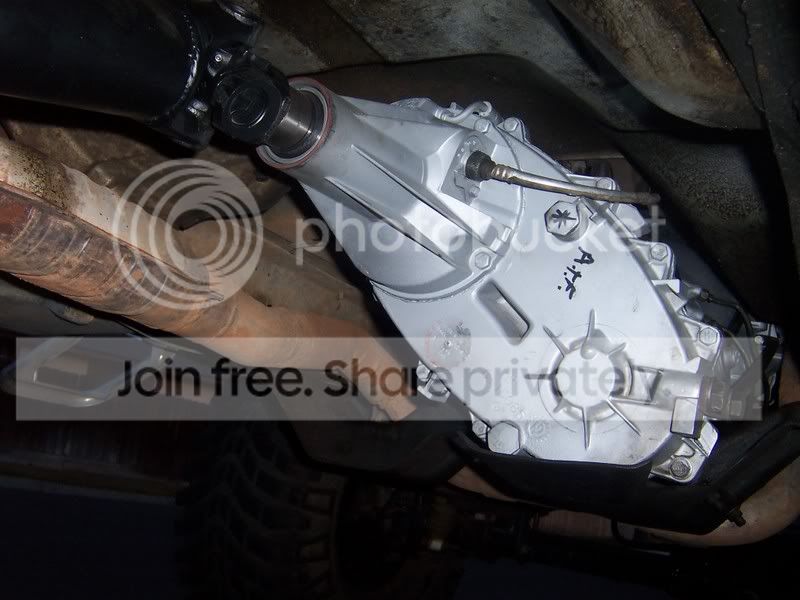

Here's my new shaft...
2"

sure, the rusted spot is how much the factory allowed to stick out hence the rust from it being under the truck its whole life outside of the seal. The shiny part should be inside the slip part of the transfercase so it is behind the seal.
I usually like 2" of slip and your showing 4" sticking out so it should go in right next to the 2" mark or the rusted mark.

well that rust spot is not where it was "originally" after i put the lift on i ended up breaking an ear off of the yoke and it was cheaper to get a new d-shaft than to get a new yoke welded on... that shaft has only been in the truck for about a year...
i'll go ahead and tell the guy to lengthen it 2" and to weld on a 1350 yoke...
