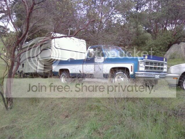

by the by.... awesome score on the truck, that thing looks CLEAN for having sat under a tree that long. im a little bit jealous.

Unless my eyes are really going bad, those headlights look square and that means 1980 model year. You sure its a '79?
No not too sure about anything with this beast. The door sticker says 11/79 on it so it may very well be a model year 80. It has Texas plates with no stickers on it. Bill of sale but no pink as of yet, might be in the 5th wheel after I start poking around? 36000 original miles on it so the speedo says. I had a hard time believing that till I looked at the brake peddle and gas peddle pads they look brand new.:dunno: A old man had it and lost the ability to drive about 10 years ago. They put him in a home years ago and he signed the truck over to the property owners where it sat. The deal is that If I get the truck running then I go back and haul off the Fifth wheel that he hauled in there with it. So I guess I was also given a holiday rambler 5th wheel as well.:haha::waytogo: Only real damage is the passanger side mirror was wiped off at some point, repaired and needs paint. Little rust in the front corners of the hood and the hood has been creased where the hindge stops. A few wires eaten through under the hood and a mountian of rat **** thatis now gone.
So the grill is an 80 GmC grill?
Anything beyond the 9th month is consider the next model year so 11/79 makes it a 1980 model. :thumb:
yea that's an 80, the model change was in Sept 79.

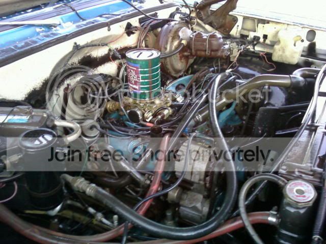

hahahahaha, dude, that coffee can air cleaner is so rat rod its sexy. :waytogo:
LOL... While I do build Rats Rods the can was to keep the Rat shiit from jumping in the carb while power washing it. Wish it was 76 or older and pre smog. Id run a filter like that! LOL Removed a whole trash can of rat shiit and nests.... NASTY! I know when I fire it off the first couple of time its going to stink soooooo bad!
