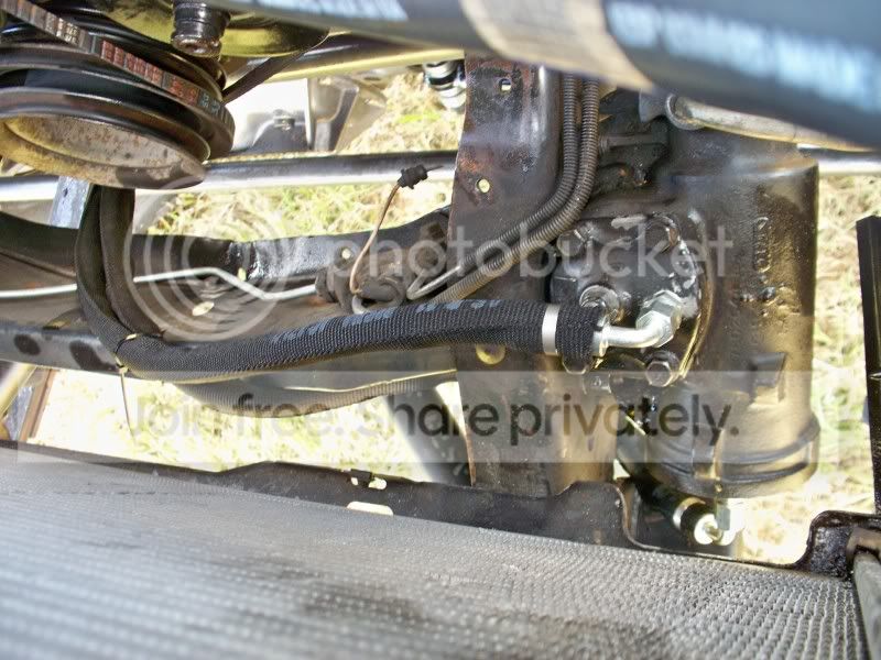

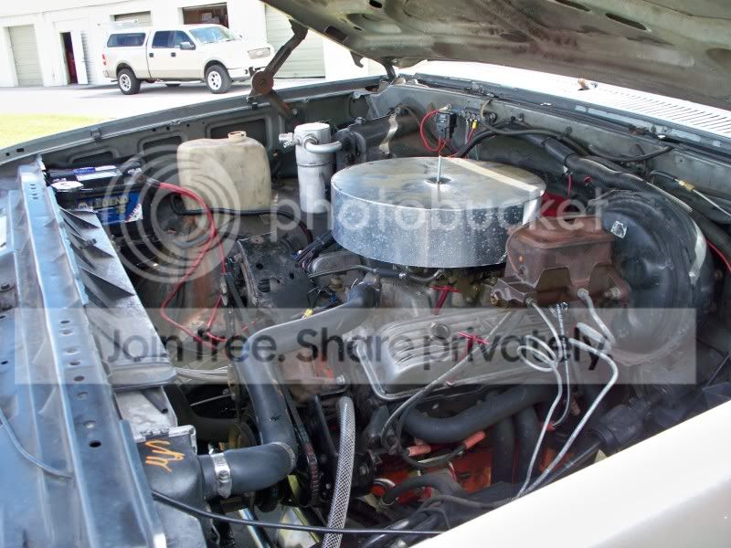

All done, I either need a new pump or I need to modify it to flow more.
I think my total cost is around 250 dollars
I also need to mount my reservoir and get a real line that will hold up to power steering fluid. I may also modify it so that it is always taking cooler fluid from the reservoir. I'll also throw a cooler on.
Without the electric fans

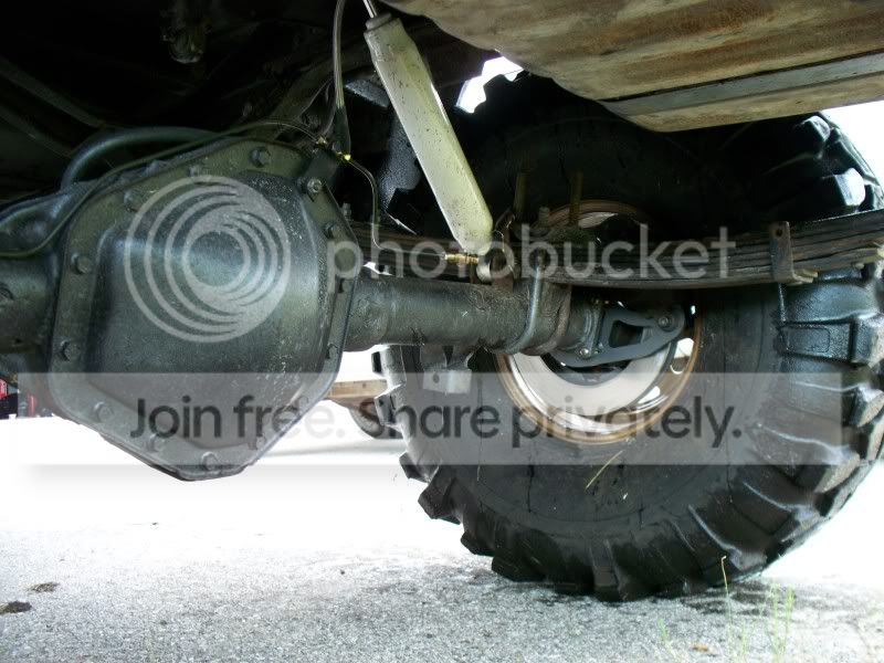

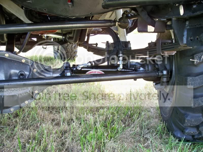

Also, I am going to use these along with limit straps, so hopefully my springs have a long life
I probably won't make them adjustable though
They are timbren rubber springs, If anyone works at a big truck place and get them at a good price let me know, I'm still looking for a good priced dealer. I've seen then from 20 bucks to 50 bucks each depending on the dealer.
I'm going to get part # A515-65, that is also the model shown below.
http://www.timbren.com/aeon-double-convolution-springs.htm

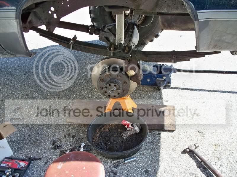

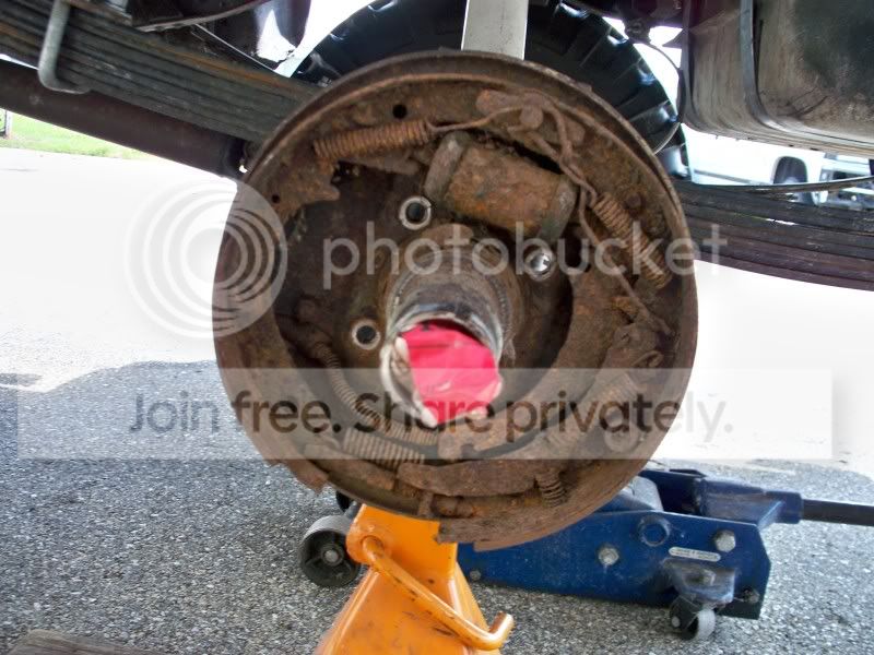

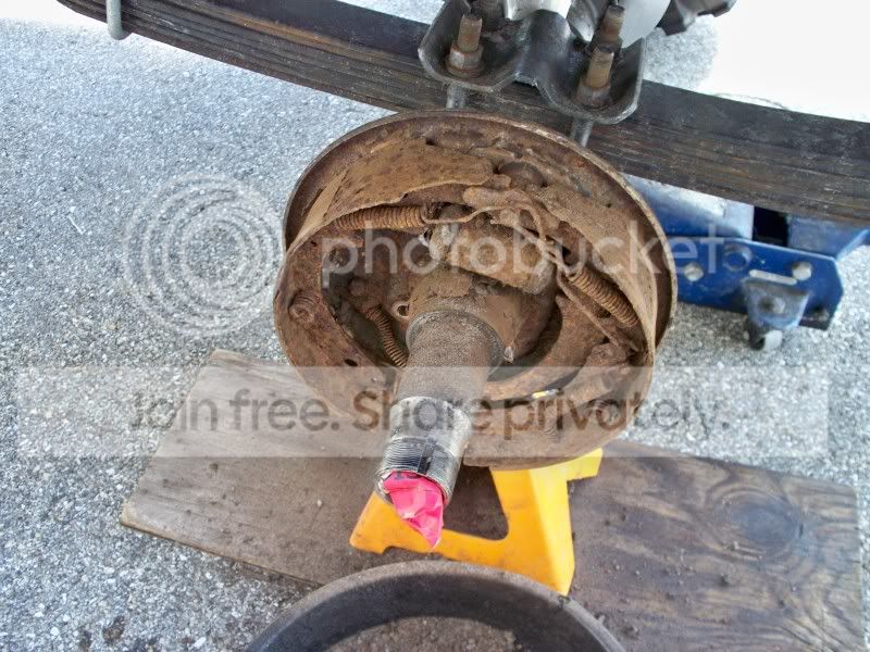

Everything came in over the past week. I'll mount the timbrens at a later date. Today I installed one rear disc brake.
I used 1/2 ton 4x4 calipers and have 100 bucks into the brackets and bendix rotors.

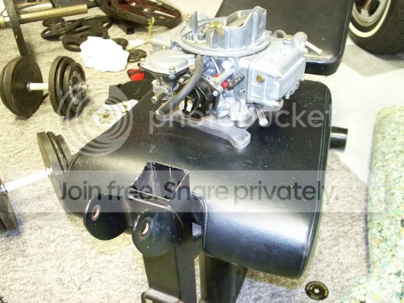

Also my carb is leaking, I have a new one in my garage that I'll throw on. I'll throw on the spacer too, what the hell.
And pics of the fans, my dad added weatherstripping to it while I was working on the brakes.
nice work bench haha.fab is coming along good.i still havent found my burb yet.one will come along eventually.
Thanks, the brakes were definitely pretty simple to do. The impact definately made it faster.
brakes look good... what's the fan setup out of?
I believe it's out of a supercharged Aurora. My dad got it at the junkyard when he was going through his get every nice electric fan phase :haha:
I think it was the cause of me having no pedal :D
