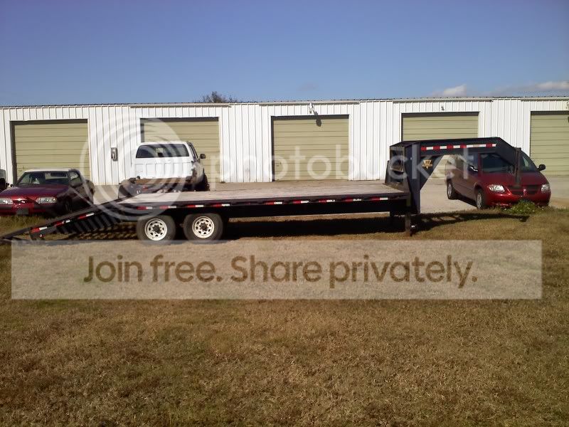

Need to do a little wiring and going to regrease the bearing and other basic stuff, other than that it pulls great, pulled it probably 100 miles from where I picked up.
Pulls great, I think my cummins drive better with it behind than unloaded

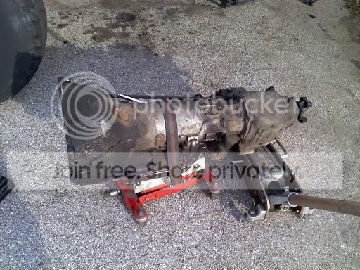

Cleaned it up after I took this picture. Going to have it rebuilt and a manual valve body put in
Do you think it would be worthwhile clocking the t-case up when my 4 link crossmember hangs down 1.5"?
from the looks of it,it doesnt hang down much more that the 4 link.and with that crossmember,i dont think it would really get caught on much.its pretty well protected.you can extend the crossmember with a skid plate and never have a problem.

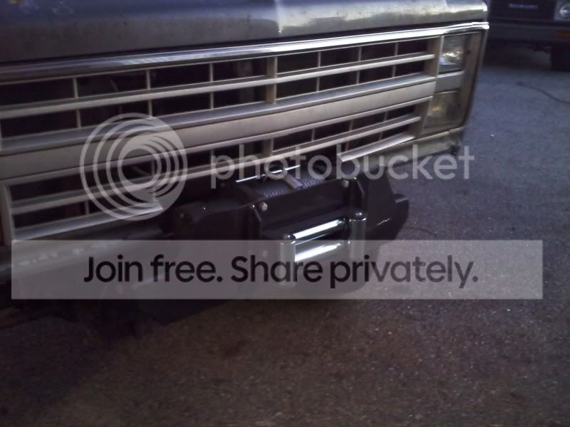

Brought it home, going to wire the winch up and do the trailer brakes
