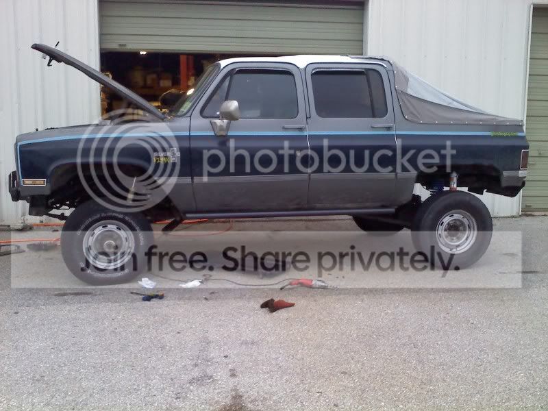

Put them in today and drove around the little commercial area which is about 300'x100'
This was on 32" roll around though, I haven't got the 40's on it yet
I'll be back in town in about a week and half for a month, I hope to maybe actually go wheeling in that time frame

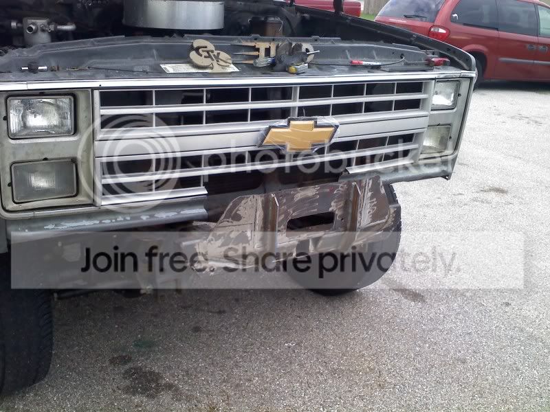

Will do, I'm going to start with the hideous bumper on there right now.
I'm going to try and get some steel tomorrow
I'm going to try and make it pretty set back and I'll have to cut out some of the grill
I'm gonna cut the last few inches of the bumper on each side also. Should look pretty good actually. I'm going to have to cut out the grill to get it in

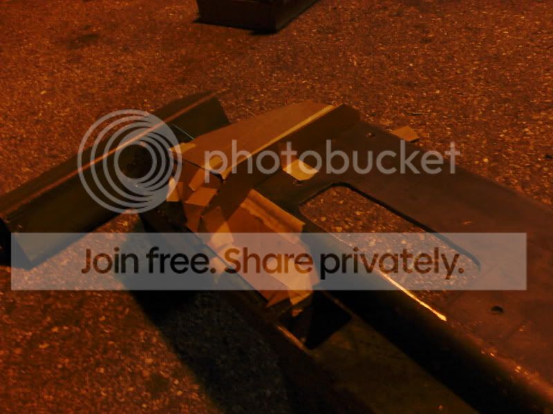

I've got more pictures. I also got the other side done, it was dark out though
Just gotta upload them from my phone

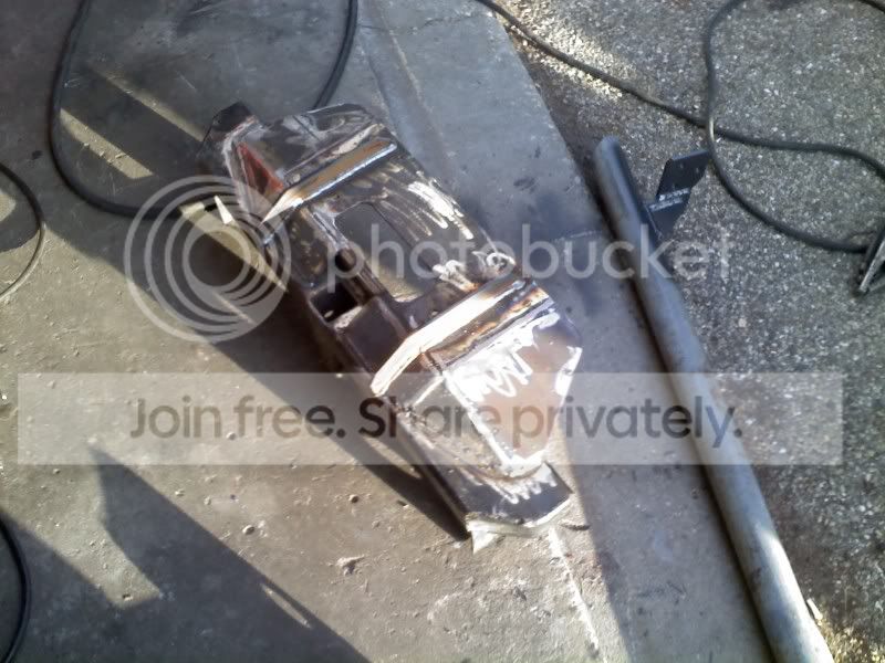

Modified diy4x brackets, basically slapped a piece of steel on them
I'm using pipe, it's .150 wall and about 2.2 diameter
Galvanized, kinda scary to weld but I took all the precautions. Didn't really even notice it since I ground it all off, only stuff on the inside of the tube
