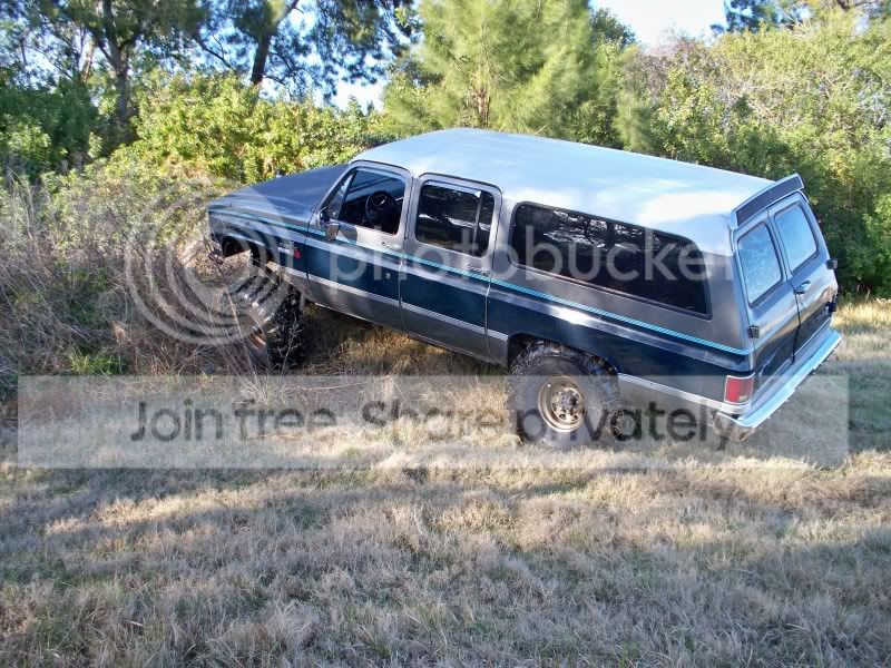

I'm not really sure on the flex, my tire was into the inner fender pretty hard. Plus I never tried both directions or different angles on the hill.

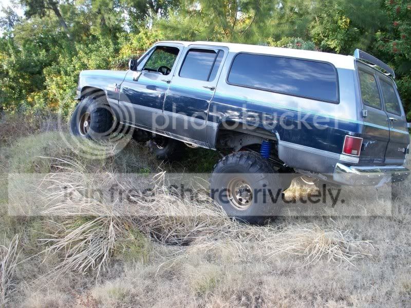

i think the flex in those pics is more a function of your wheel base in combination with what you were trying to flex on.
Flex your front tire up something. It will transfer the rig weight to the rear more and make the rear suspension work more.

In the first pic I noticed that the pic is aligned with the truck. Look at the trees in the back ground they are sideways. I don't have a program to rotate pics so I couldn't fix it.
I could have probably flex more but I was hurrying it up because sometimes cops drive by

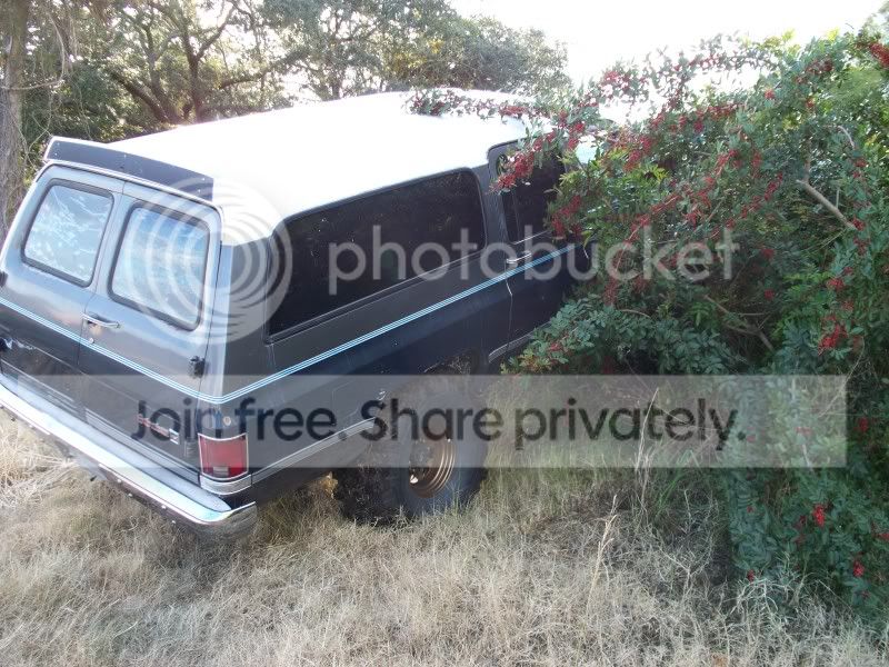

The passenger rear was stuffed into the inner wheelwell also.
