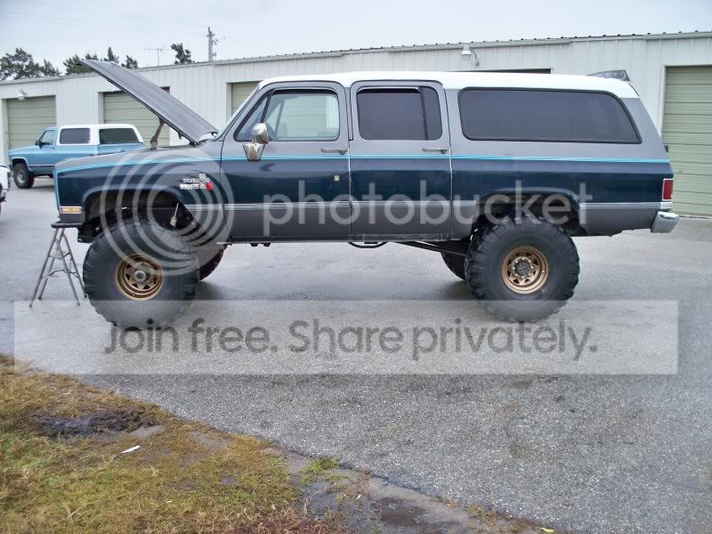

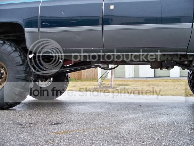

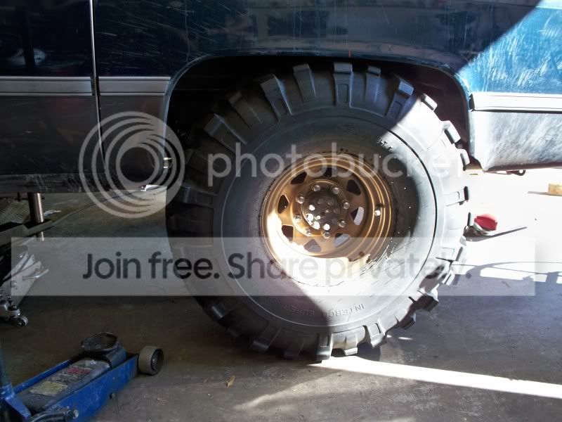

Howdiy's halfassed 4 link
I imagine the weight of axle pulling down will it a few more inches
I bet under a real situation, you'll have WAY more than "a few more inches" of droop in there. Good work, here. Definitely getting me interested in doing something similar. :)
I had to order 1 1/8 fine nuts, they will be here Wednesday

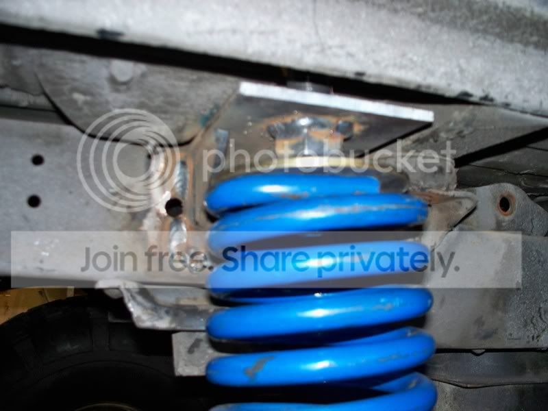

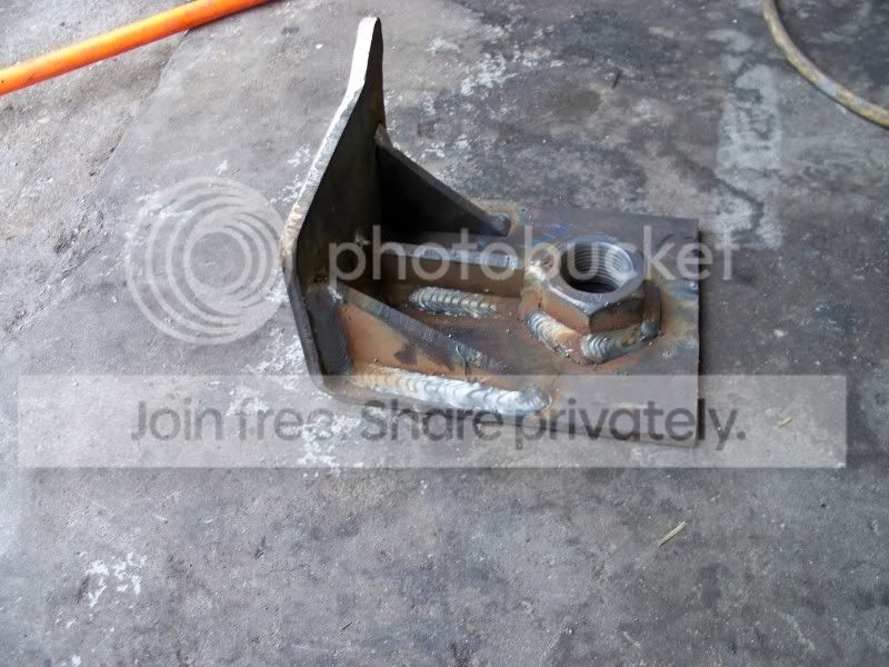

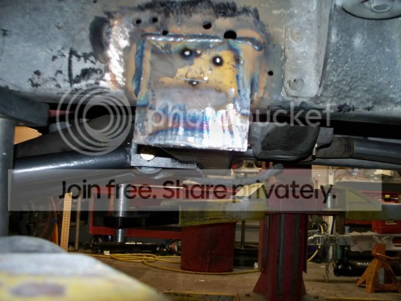

Yeah I just have to do one more upper bracket and it's done
Besides the shocks of course. I think i can get away with 12" travel shocks though.
I got a booger weld on the lower part :mad:

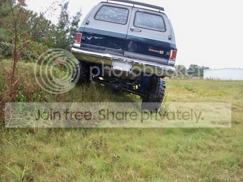

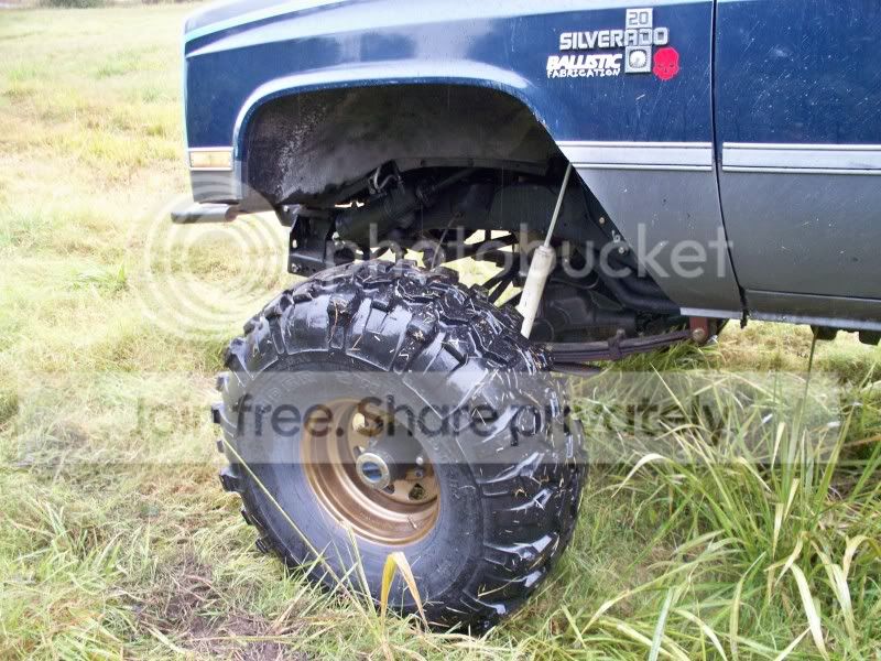

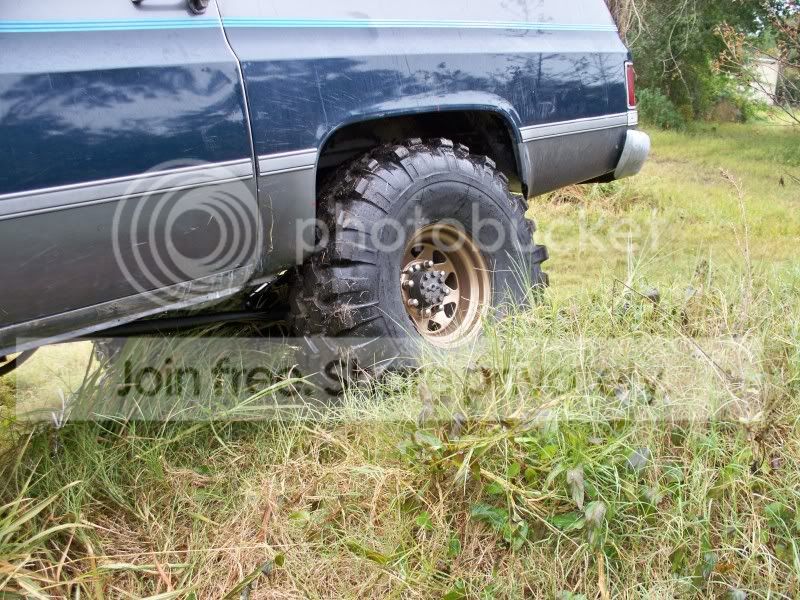

If all goes well I'll have some pics of it flex out on a dirt hill by tonight.

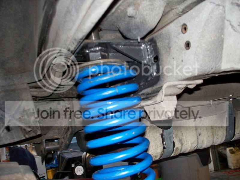

I just started with the rear because my leaf setup was pretty crappy. I had 2wd front hangers and a shackle flip in the rear so my springs were really angle down. This gave me a pretty crappy pinion angle.

I finished the other side, didn't get to drop it down yet. I had to leave early to go out to eat.
I remembered to paint it at least lol

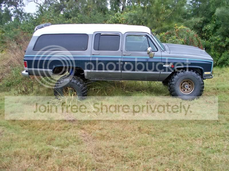

Drove it today. Realllllllyyy bouncy. Way worse than leafs with no shocks, no friction on coils.
I didn't really get it flex out that well. It was freezing, plus no shocks, plus my engine isn't running too well at the moment. It seemed like the front was doing all the work.
My axle looks further forward in the pics also.
