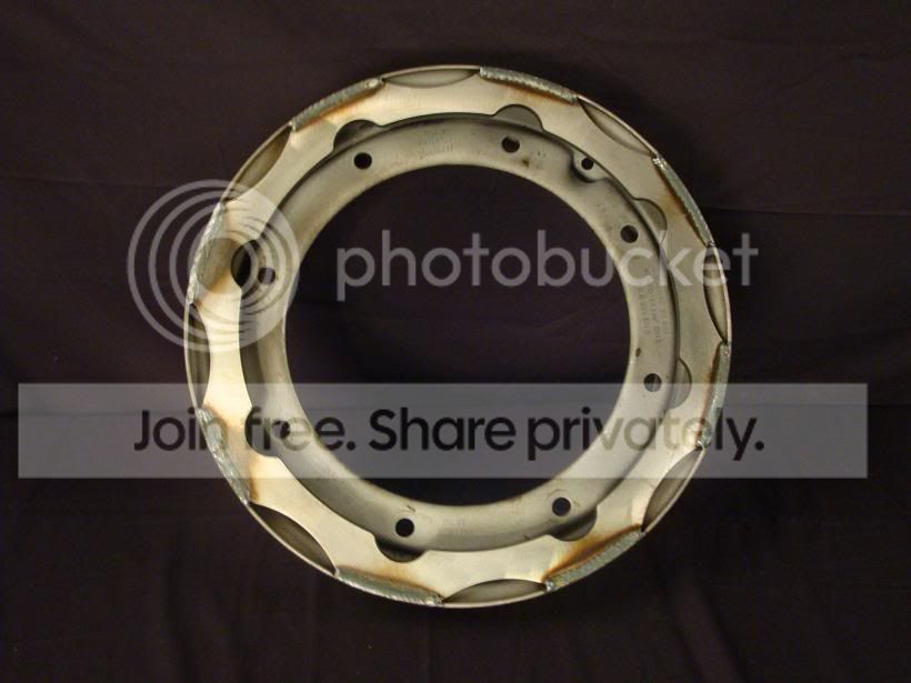

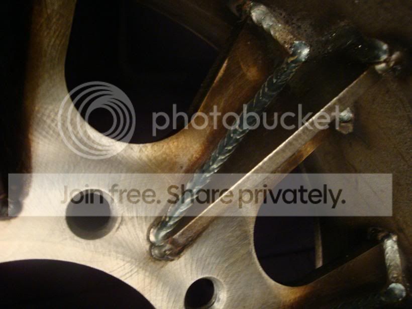

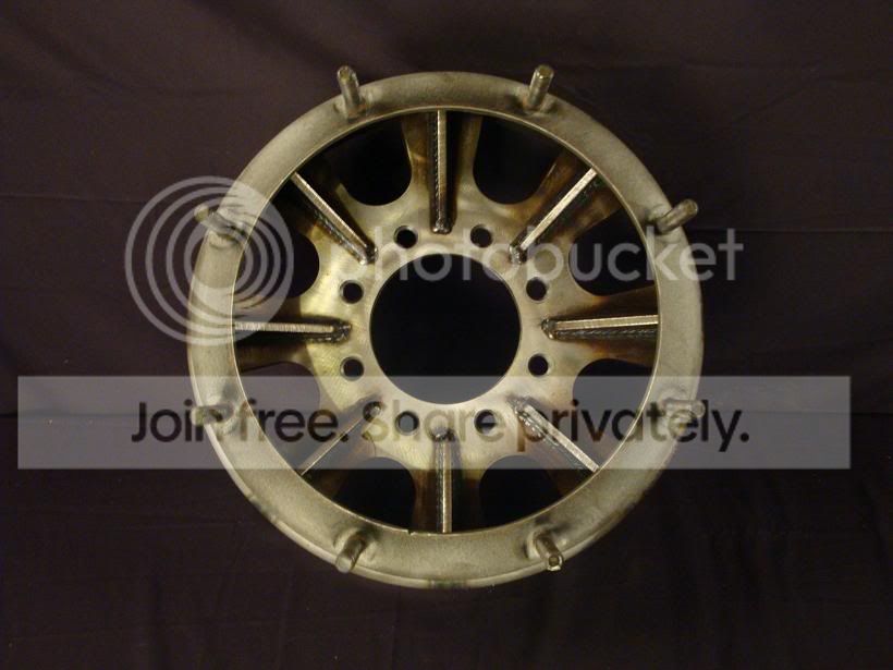

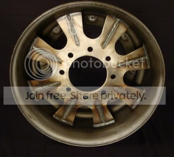

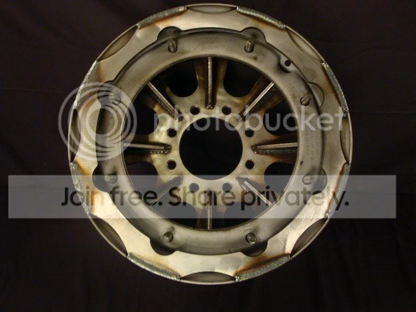

Rencentered and rock ring welded on.
A look at the back side
Just the recenter job here. 3.5" back space.
The rock ring, a minimalist approach
Close up. Appropriate lug nut seats are cut prior to welding. ALWAYS.

question, maybe stupid but i havent found any info that i'm looking for. i'd need a complete set as pictured above, but what i'm wondering is are these wide enough say for a 44" bogger? if so will they handle ok for a liitle street driving? sorry in advance for any stupid questions but i really think that would look good powdercoated black on a set of 44's :D
The rims are standard hummer width which I believe is 9.75". How wide are your 44's? My 44's are something like 18" section width If memory serves. That'd be too wide for these rims IMHO.
i guess there is no way to make them wider?
There is always a way. Problem is, when you get into that kind of alteration, time its said and done, you would have been better off buying a different wheel all together.
