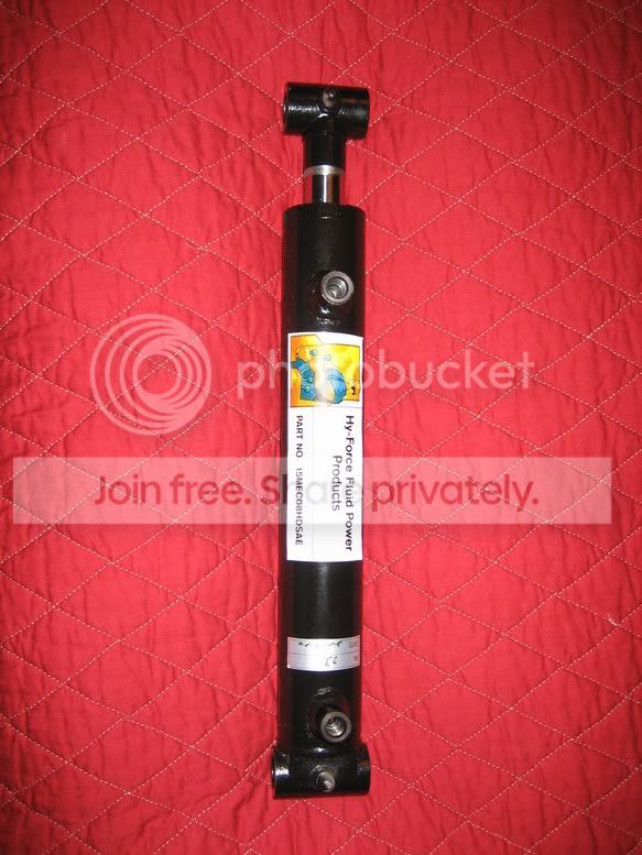

Guess what showed up at my house today (end hijack)
So how exactly are the ends of this the wrong way? they look like they work fine?:confused:
They will work fine, but as it is, the lines coming off the ram will have to be pointing to the front or to the rear of the truck. Most people like to thave them pointing up to keep them alittle more protected. All ya have to do is cut the tube off the fixed end of the ram and weld it back on 90* from where it was.;)
