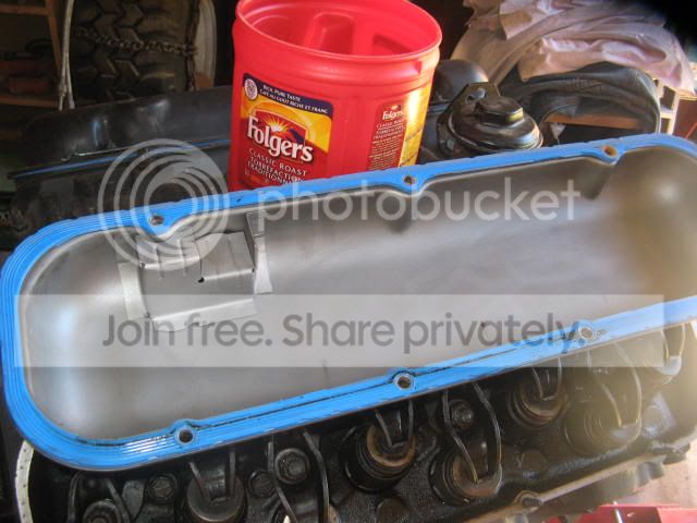

Valve cover off:
Awefully clean inside, and good quality gaskets.

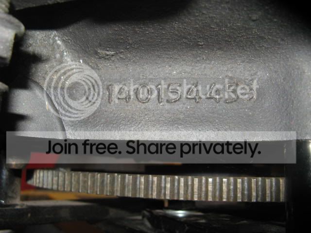

Snapped a pic of the casting numbers on the heads. Everything i can find says truck 454, peanut port. Good low end heads?

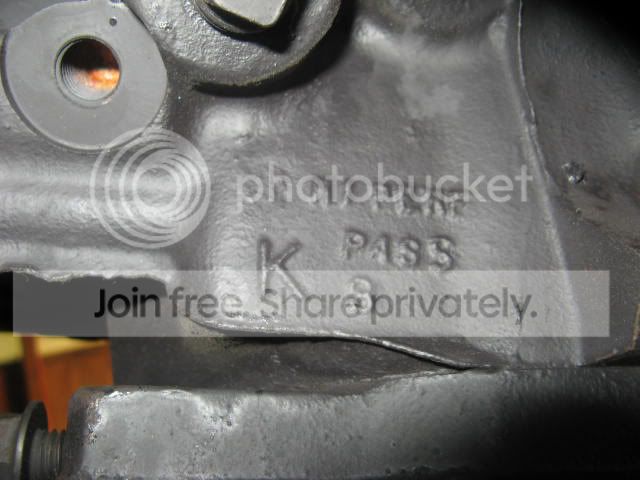

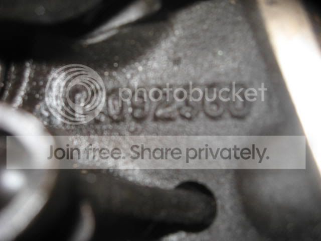

Engine numbers:

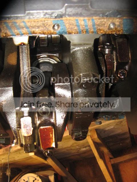

Pretty clean, and nice to find 4 bolt mains...

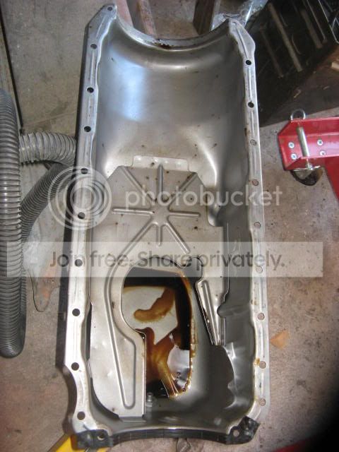

Inside of pan...
So, the only other thing I think I'm gonna do is remove the balancer and TC cover and have a look there. I think it already has a double roller on it, but I can't see well enough to be 100% sure. As for the rest, it's damn clean inside...I will do a compression test on it and if the numbers look good I'll run it as is.

4 bolt huh...I got the same casting and its a 2 bolt:crazy:
That's weird, maybe a 3/4 ton vs 1 ton thing? Every casting number reference site I could find called it as a 4 bolt main block though, none said "2 or 4 bolt mains" for that number.
GM could be so strange at times. 2 bolt is still good for a healthy power and rpm range, I wouldn't worry about it.
