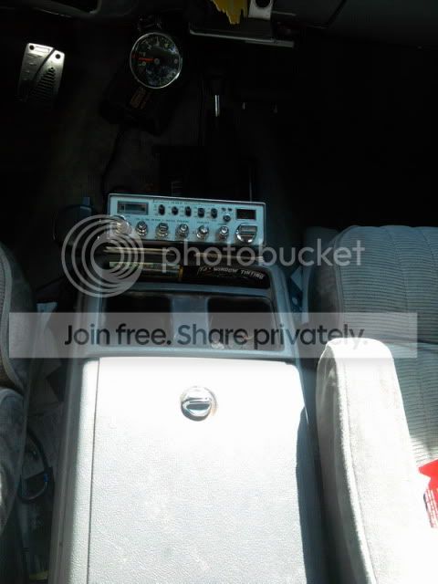

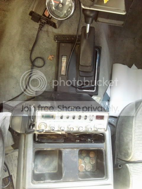

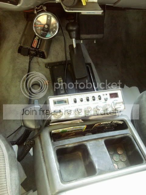

In front of the center consol, out of the way, does not affect the t-case shifter, and yeas it does occassionally get some soda spilled onit, but nothing major. I learned to just barely crack the cans while driving with something in the cup holders, minimizes spillage. :D
Mine's alittle dirty now, haven't messed with it much as far as cleaning, been too busy lately with other stuff, but here's pics. Wires run under the carpet.
