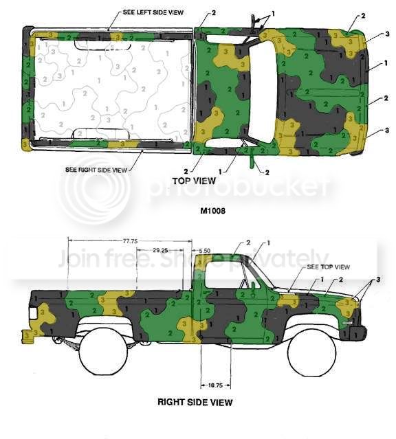

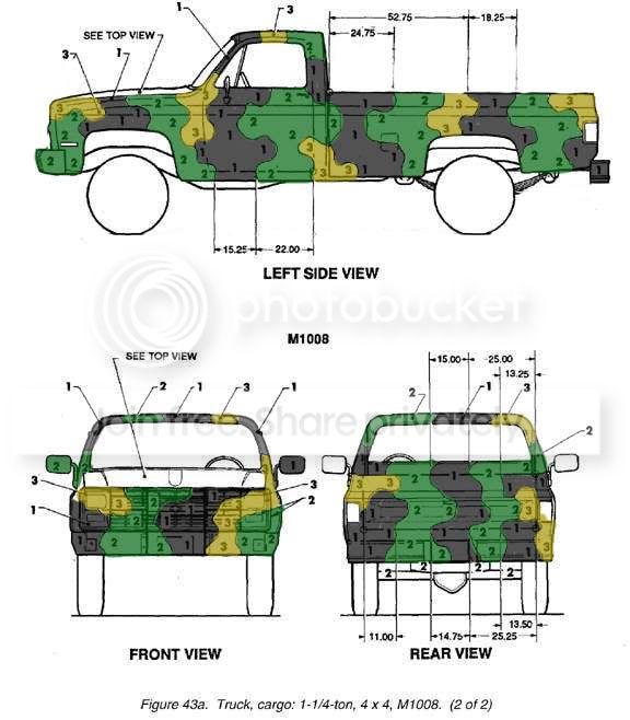

I can give you all the info that is required for exact camouflage per US army for free it tells you how and shows everything you need.
Go here http://brochures.slosh.com/cucv/ then go down a little to http://brochures.slosh.com/cucv/tb43-0209.pdf TB43-0209: Color, marking and camouflage painting of military vehicles, construction equipment and materials handling equipment.
