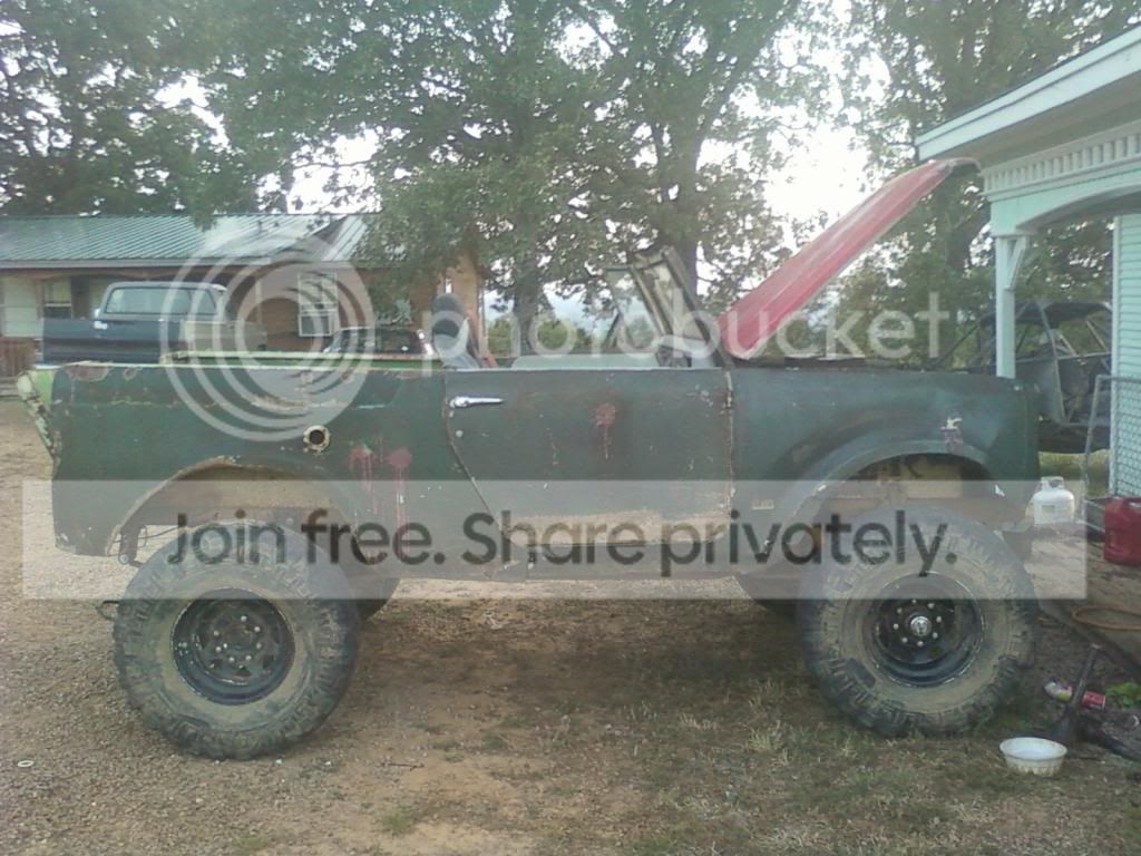

anyway, used the scout as a yard tractor to move some junk around
Cut out some of the hood supports so my hood would shut all the way
then I took off that rusty old half top, planning on a cage with a soft top
removed rear seat divider
and got some rear shock mounts added
I also pulled the oil pan and pump. shimmed the pump and cleaned the pickup screen. helped oil pressure a little, it never drops completely to 0 now so maybe this engine will last me a for a few wheelin trips. All I really need to do before going on a ride is mount some seats and mount the propane tanks so that everything is safely secured. Oh and I still need to get a title for it but I have insurance on it and I have a few local trails that I don't have to get on a public road to access.

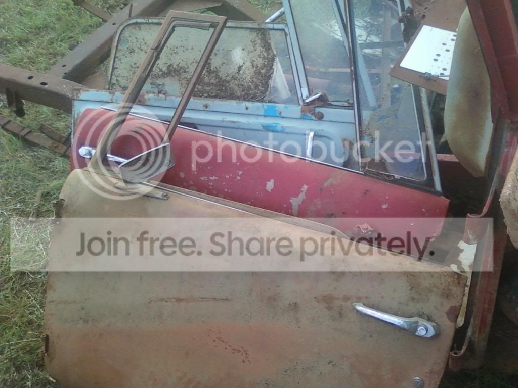

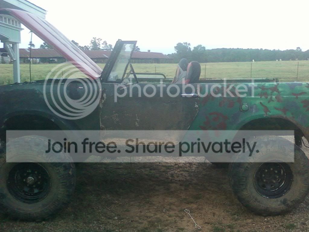

Found some doors for my scout and put them on just to see what it would look like.
Don't know that I care much for it. They are heavy but may be nice to have when winter gets here.

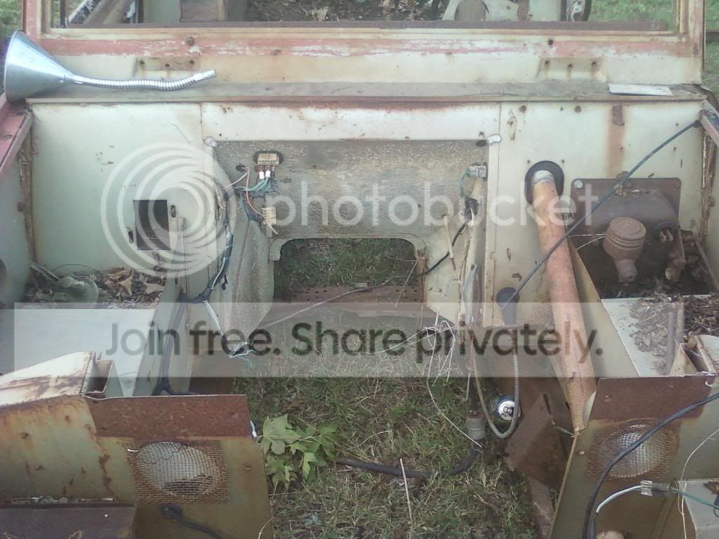

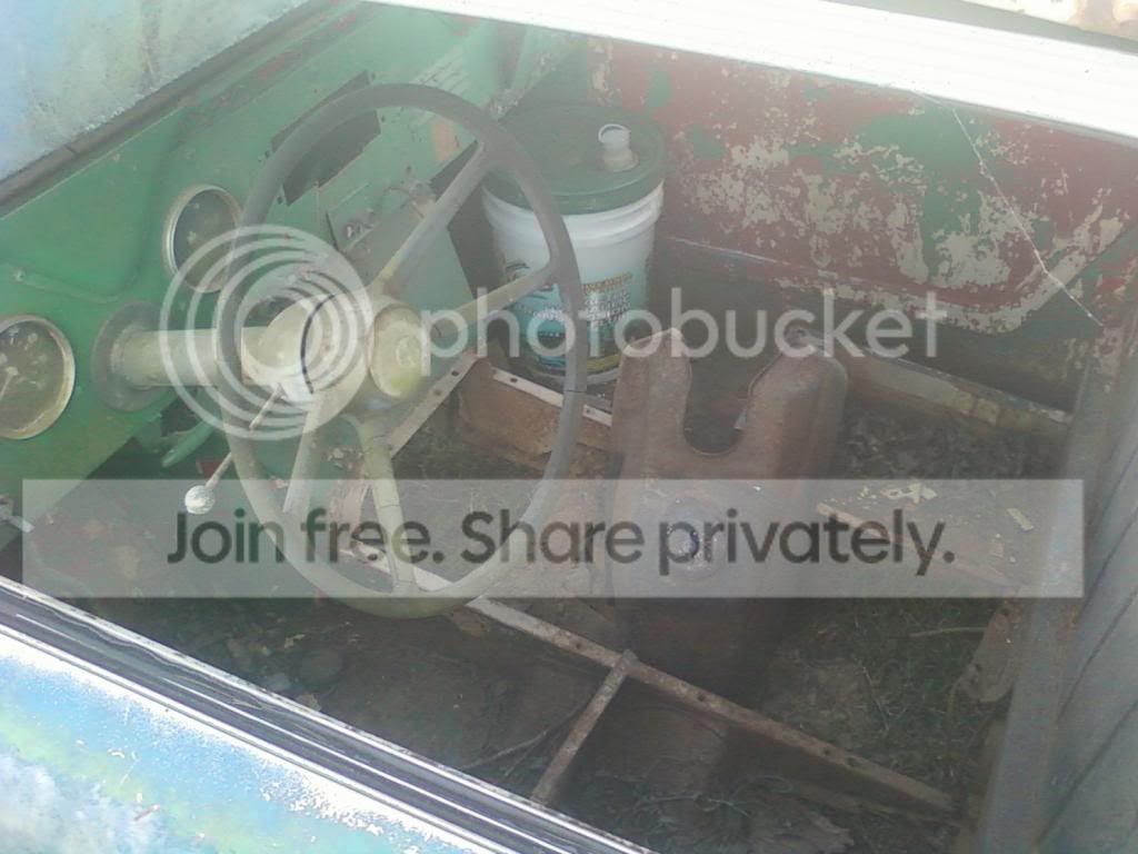

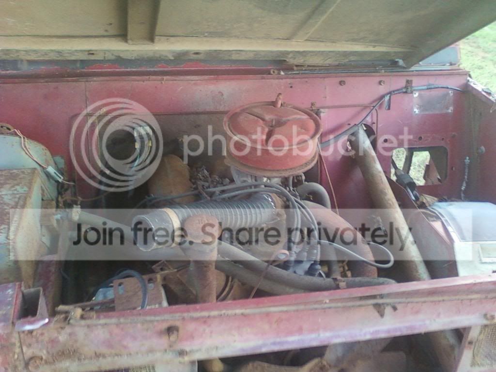

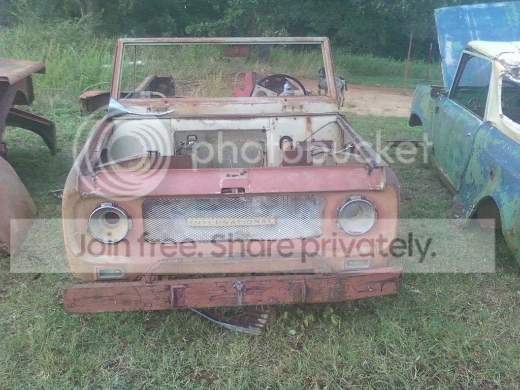

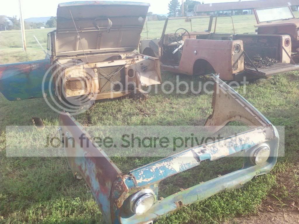

And here is the rest of my scouts and parts

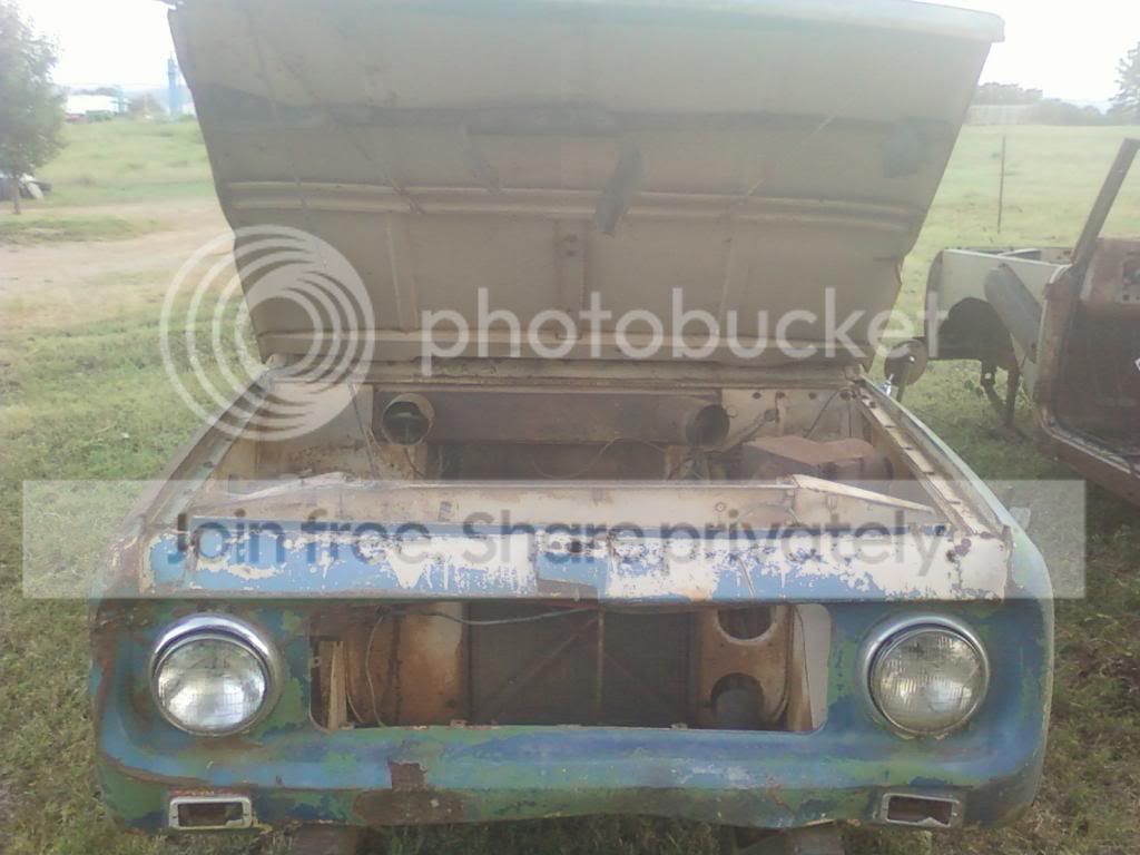

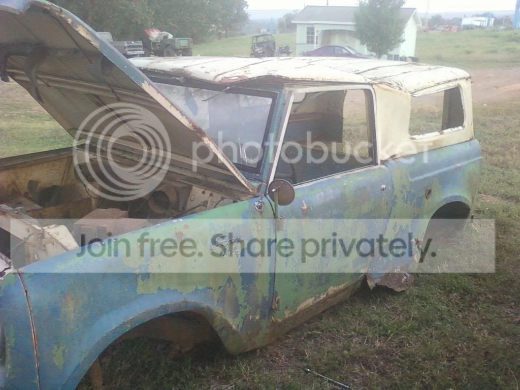

First is the scout 80, not sure what year, the vin number come back as a 1970 Cadillac but its on an IH vin plate with all the scout specs:dunno:. Body is mostly crap, no drivetrain, but a few good parts like steering, bumper and a couple body pieces

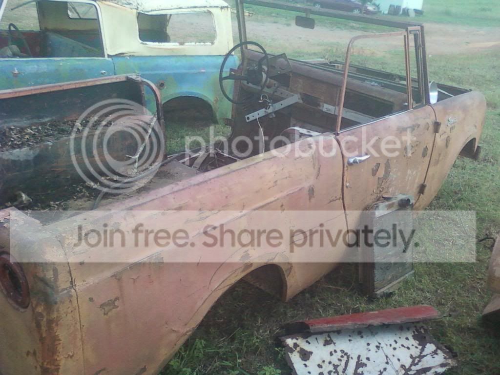

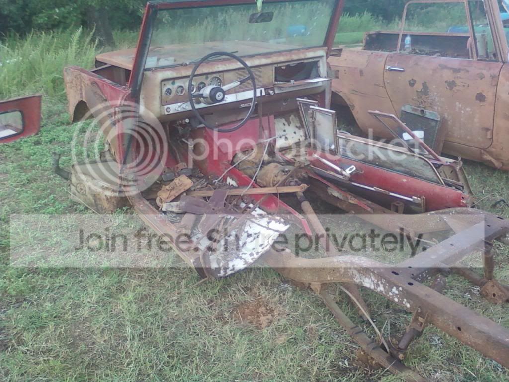

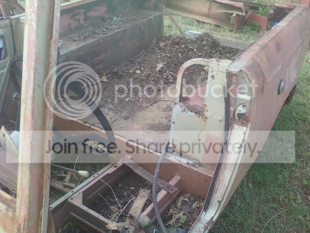

Next is a 66 scout 800. Most of the body has rusted off but I was able to dig most of the body panels out of the woods and a few pieces of them will be useful. But it had a good 4 cyl with 3 speed and axles. This one was suppose to be my wife's first vehicle. Now 15 years later there isn't much left but hopefully we can piece one together.

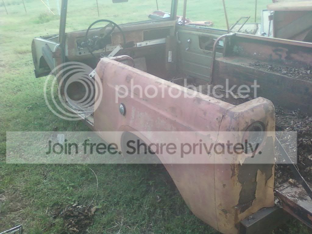

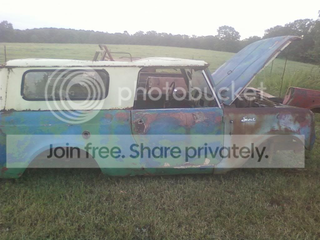

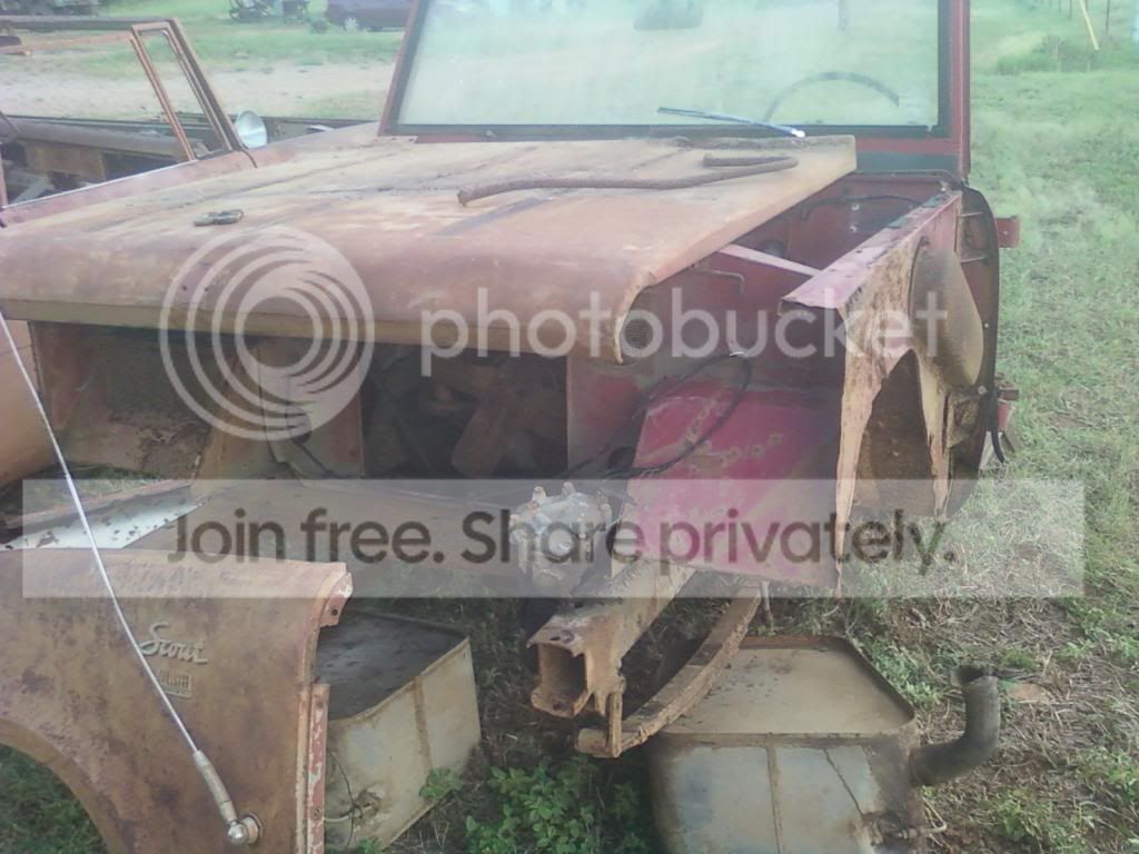

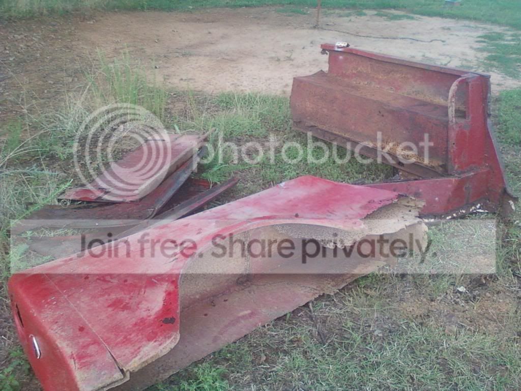

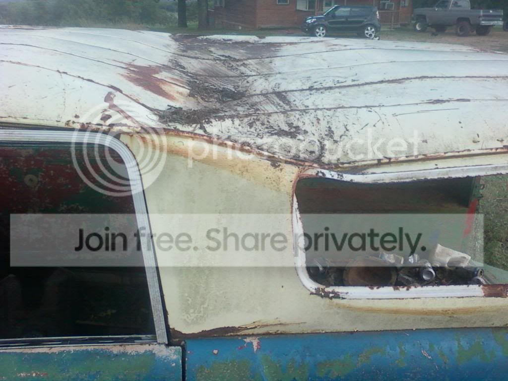

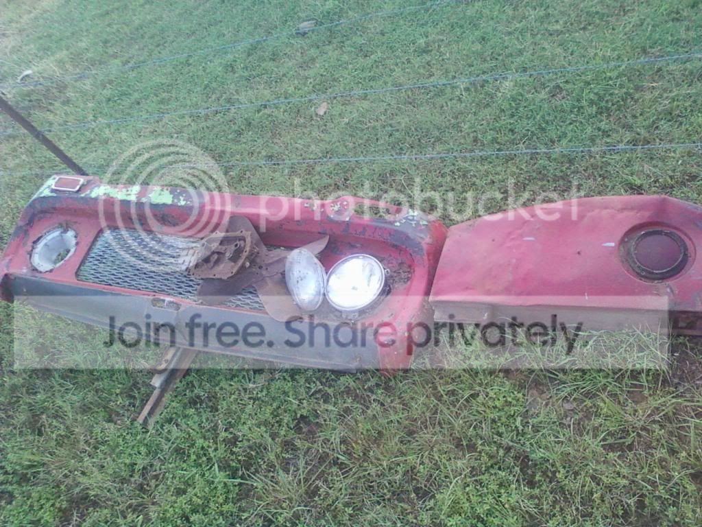

Last but not least is another 66 scout 800. This one is body, frame and springs but it has the nicest body and the least about of rust of any of them. It will take some time and a little cutting and welding but the body shouldn't be too difficult to fix.
It has a perfect grill, one bedside is perfect, perfect hood, and one perfect fender. I have two good doors out of the bunch and one good half top and one good full top. Out of what is left Ill have to patch two places in the floor, one rear corner and part of the bedside and one of the front fenders.
Already pulled the front clip off the blue scout as it has the good fender I need
Right now the main priority is to get the good parts off of the scouts I wont be using and scrap the rest to get it out of the yard. Then Ill have to build some kind of shed to house the project so its out of the weather.
yeah, tree fell on blue scout. Ruined a good top. And don't worry, I wont throw away anything that I think will be useable. Mostly just the rusted out body pieces.
Keeping frames, any drivetrain parts and interior pieces, like heater parts, dash parts, windshield frames etc. Nothing that can be used will be scrapped.:thumb:
