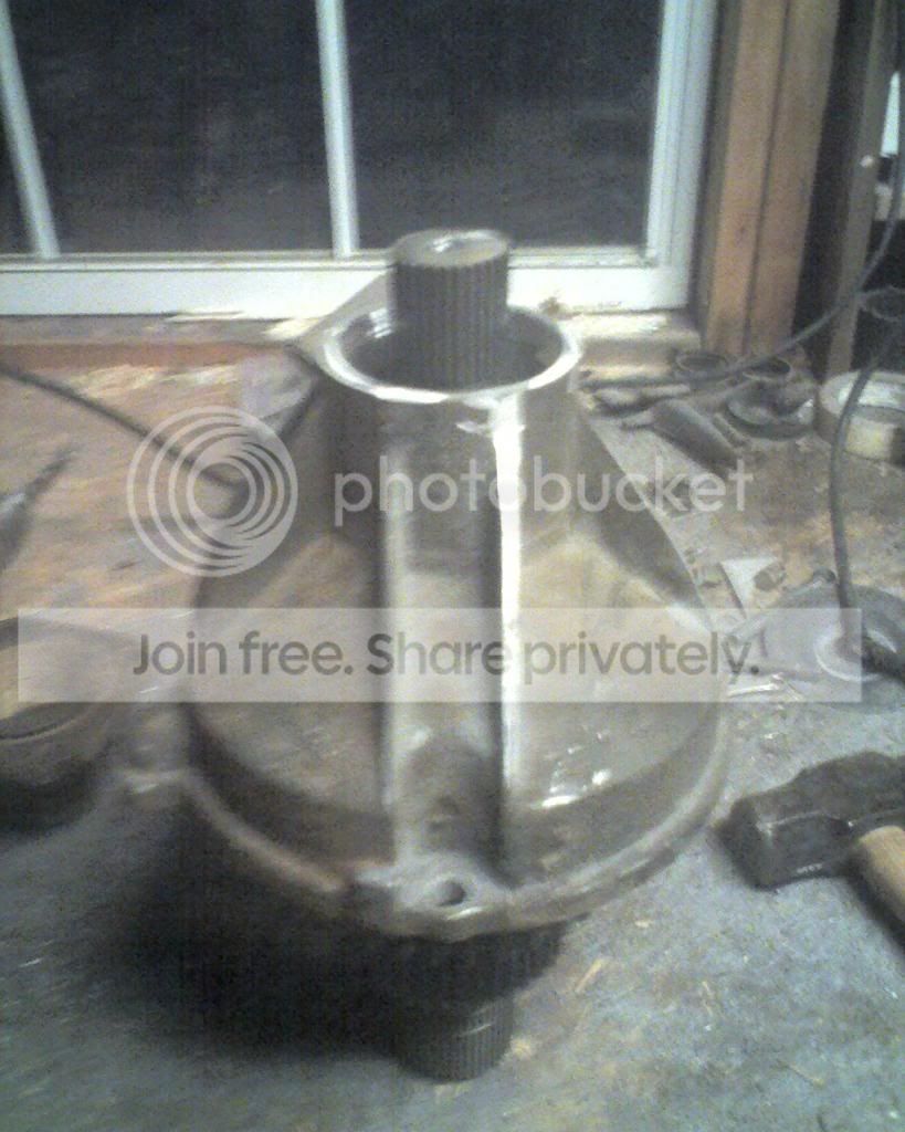

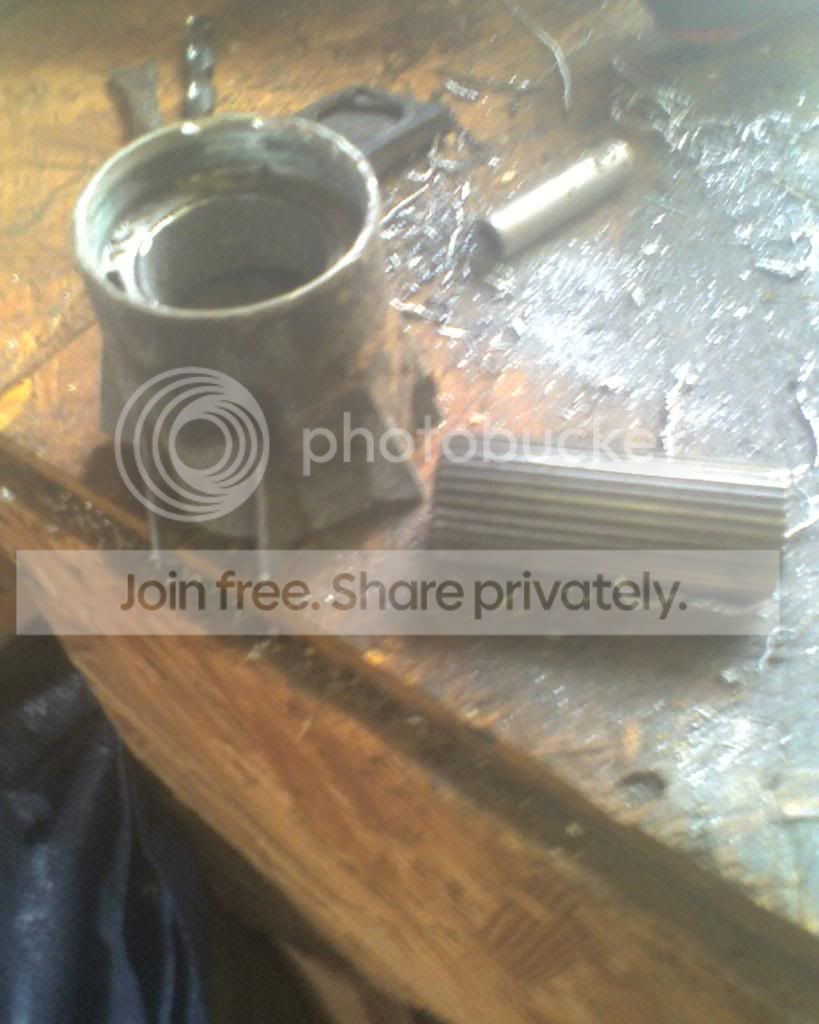

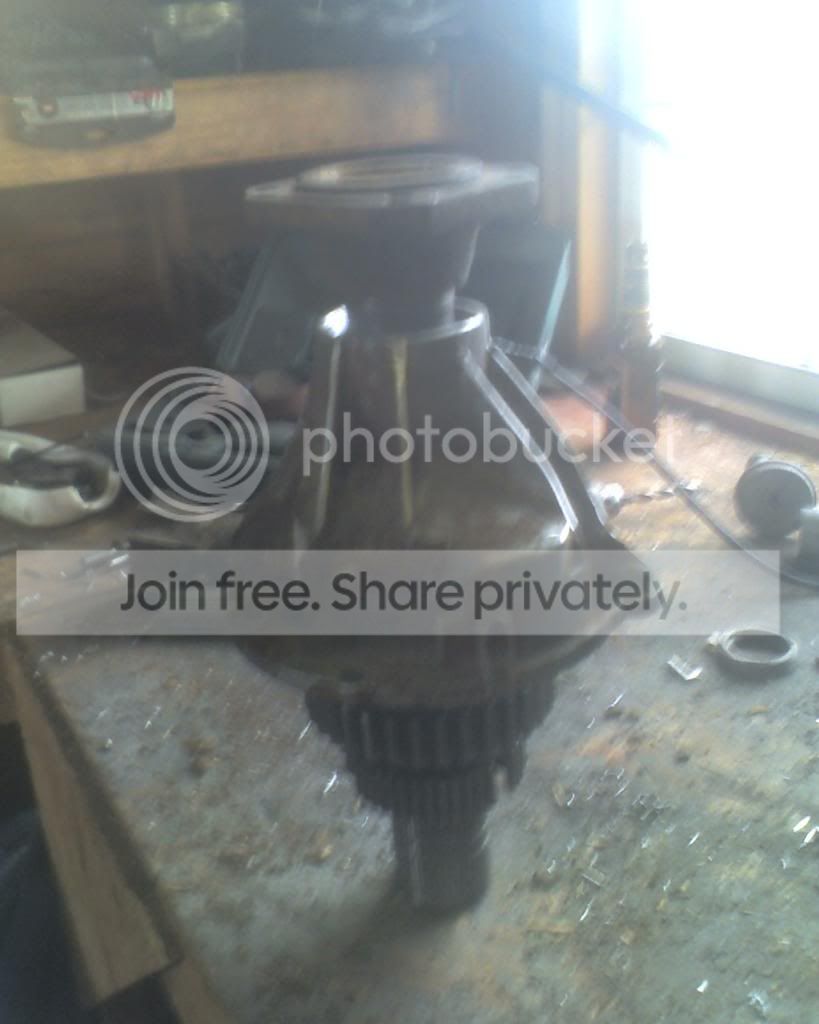

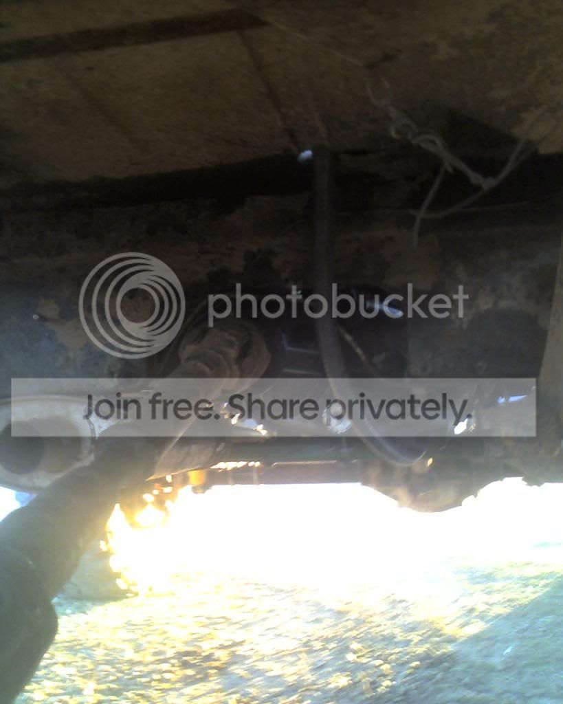

And then I got bored and built an sye for my np208 so I could run a cv shaft in the rear and hopefully get rid of some vibrations. Got some pics of it but I guess my phone didn't save them all
This is what I cut off of the factory slip yoke
And this is the finished product
Ill try and get some more pics of what I did before I install it so that others can see. Did it at my house with no special tools (grinder and a drill) and it takes the factory seal and 32 spline bolt on yokes. Im using a yoke from the front output because I have a cv driveshaft that fits it.
Finished up sye, had to make a spacer to go between the bearing and yoke to take up the slack.
And here it is installed with a cut down front driveshaft from an 86 3/4 ton. Had it up to 55-60 with no vibes, was so nice being able to drive down the highway without rattling your teeth.

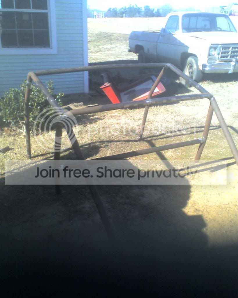

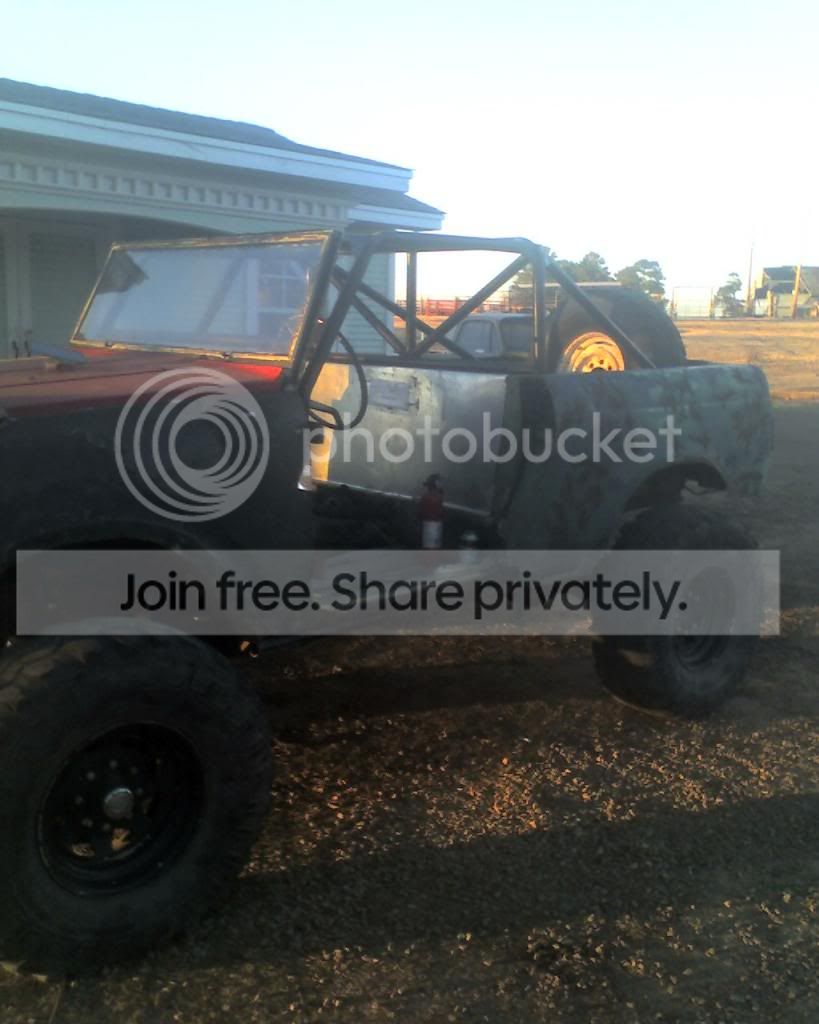

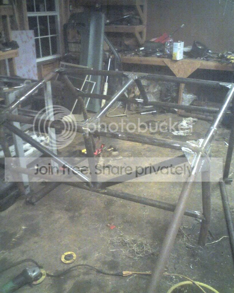

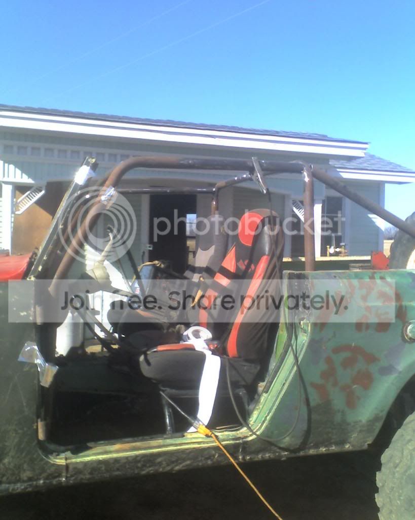

Its 1.75" 1.20 wall hrew. Not dom but it was free and will provide better protection than the windshield frame:whistle:. So I started messing with it and ended up cutting it all apart and redoing it while adding in a bunch of bracing and gussets from stuff I had laying around.

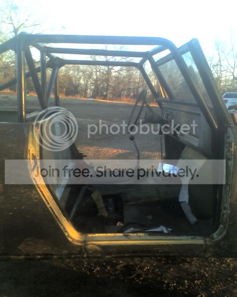

Here it is coming together in the scout

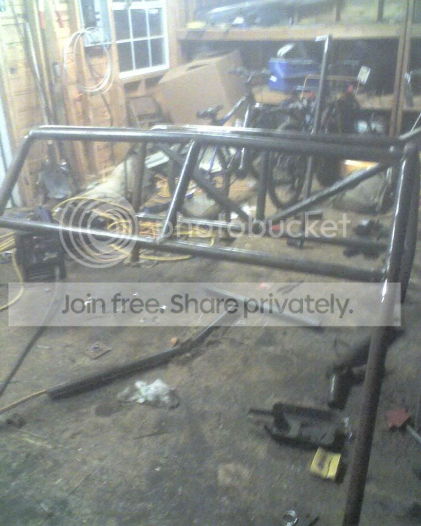

Pulled it out so I could roll it around and not have to weld upside down. Resulted in much better welding than what would have most likely occurred if I had done it in the scout.
You can also see me next project in the background, 74 half ton, bent frame, worn out motor, bad tranny but mostly good body and was free. Plan to swap body on 3/4 ton rolling chassis (also free) and throw in a 5.3/4l60 (probly have to pay for this part:D) and paint it. Going to use it for a service truck for my hvac business.
Heres the cage inside my tiny shed (have a shop coming soon:woot:)
Added 3x3 1/4" gussets on almost every joint, don't want it to come apart
And back in the scout. Was twice as heavy with all the braces and a real pain to get it back in place since after fully welding it no longer flexed.
Replacing a bunch of the rusted floor while everything is apart. Going to weld the cage feet directly to the body and then brace back to the frame. Would like for it to be removable but I made it fit so tightly that with the cage feet on it wont come out anyway. You may also notice that the top and doors no longer fit but Im working on a solution. Probably aluminum top and tube doors.

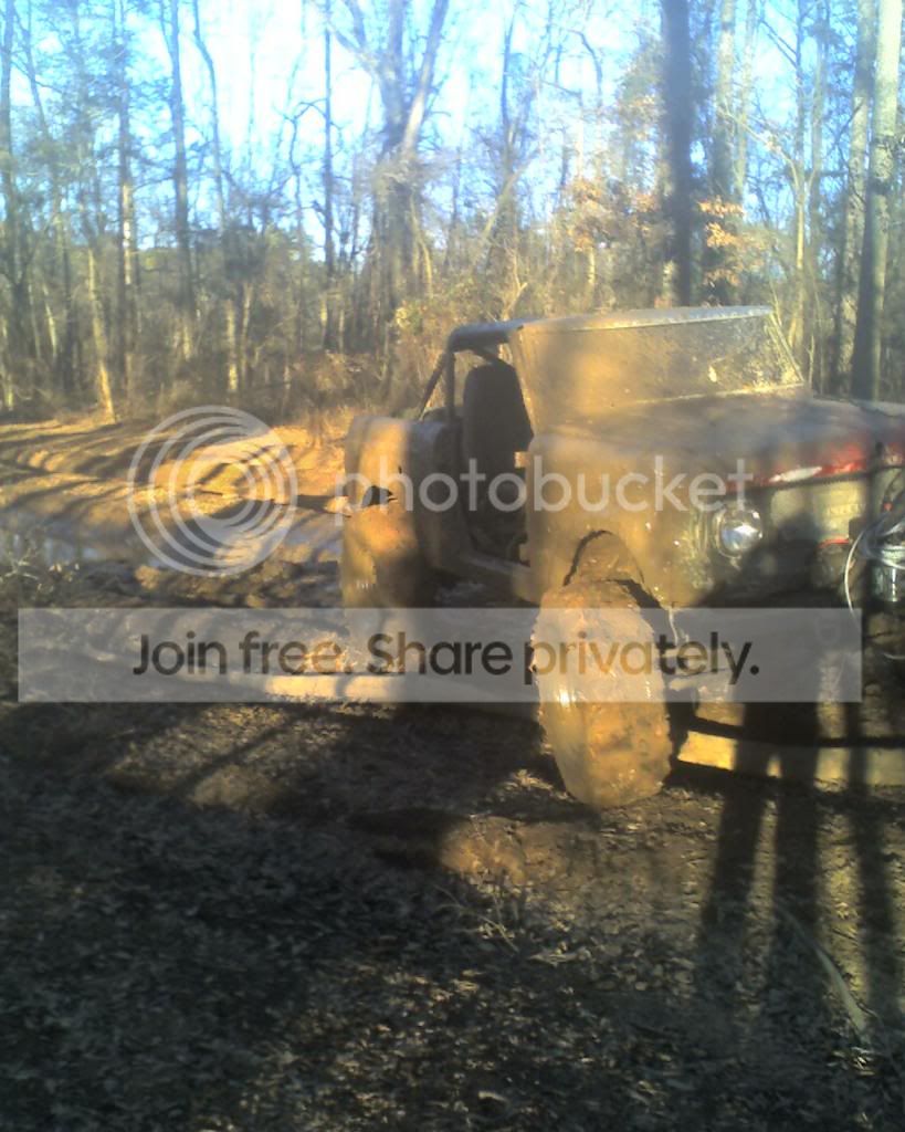

And just for fun the only pic that saved to my phone from our wheelin trip just before I tore it down to put in the cage.

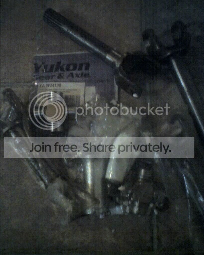

A member here had a killer deal on some Yukon axles and joints for a 10 bolt and even though I really don't need them I couldn't say no to the price. So I picked up some bling bling for my front axle
I have them assembled but yet to install. Like I said I really don't need them at this point in time, been wheeling pretty hard with an open front and have yet to break a shaft. May do a posi up front, really don't want a locker and Im still contemplating on dropping to 33s. I have a decent set just have to swap axles to 6-lug so my wheels will work. Regardless, a front traction aid is out of the question until I get power steering.:whistle:

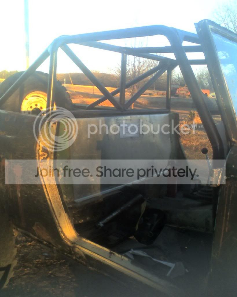

Got the cage mostly welded in. My welder craped out so I still have one side of the floor pan to finish and since I decided to weld my floor plates in so the cage is not removable Im going to use gussets and weld it to the body in as many places as possible to reduce the chances of tearing the sheet metal. Also going to brace it back down to the frame. I have the front a-pillers attached to the frame now but didn't get to finish since my welder died.

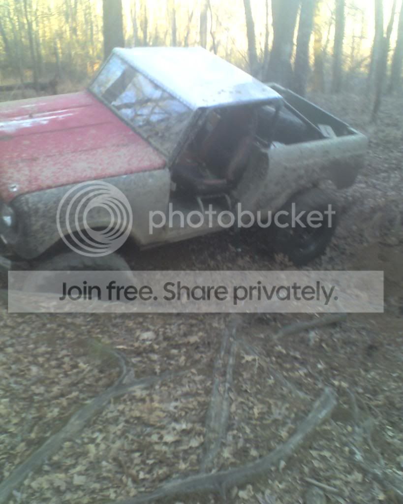

Yesterday took my wife wheeling on an easy trail and she has all the pics. Developed death wobble that it did not have the last time I drove it. Going to have to figure that out:screwy:

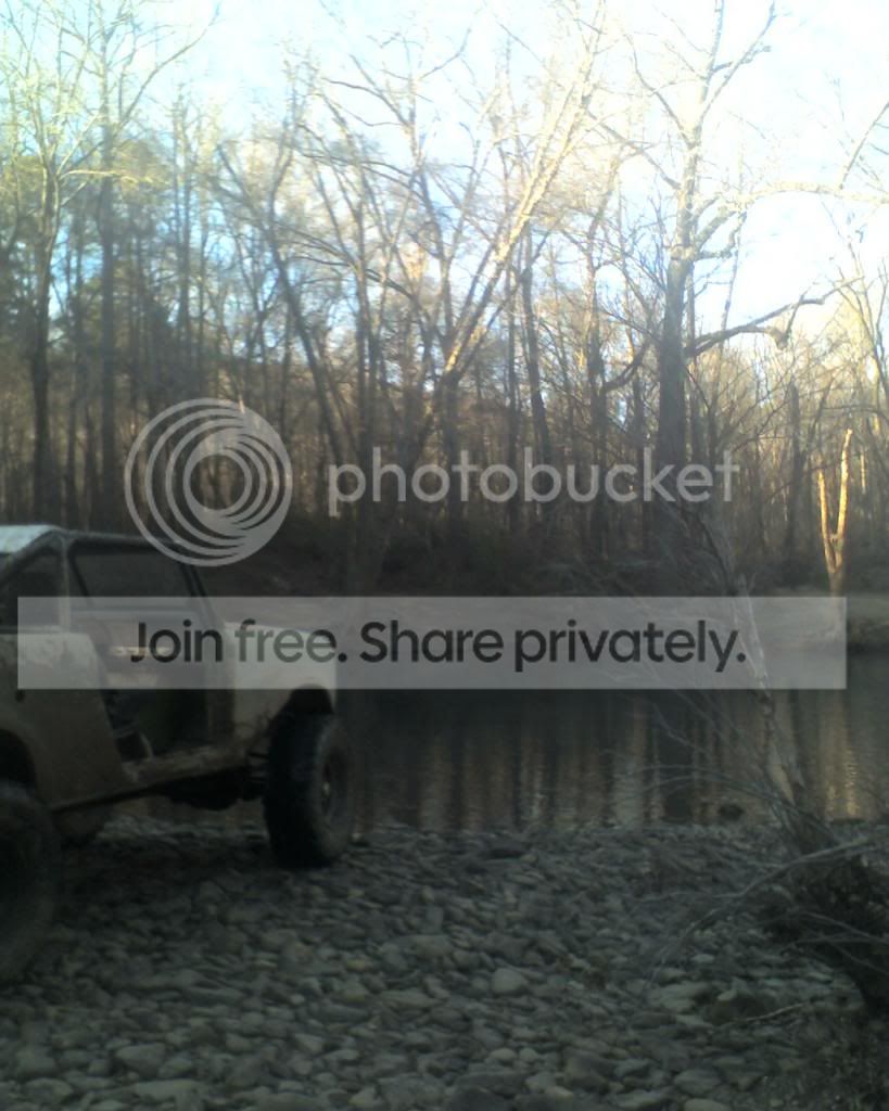

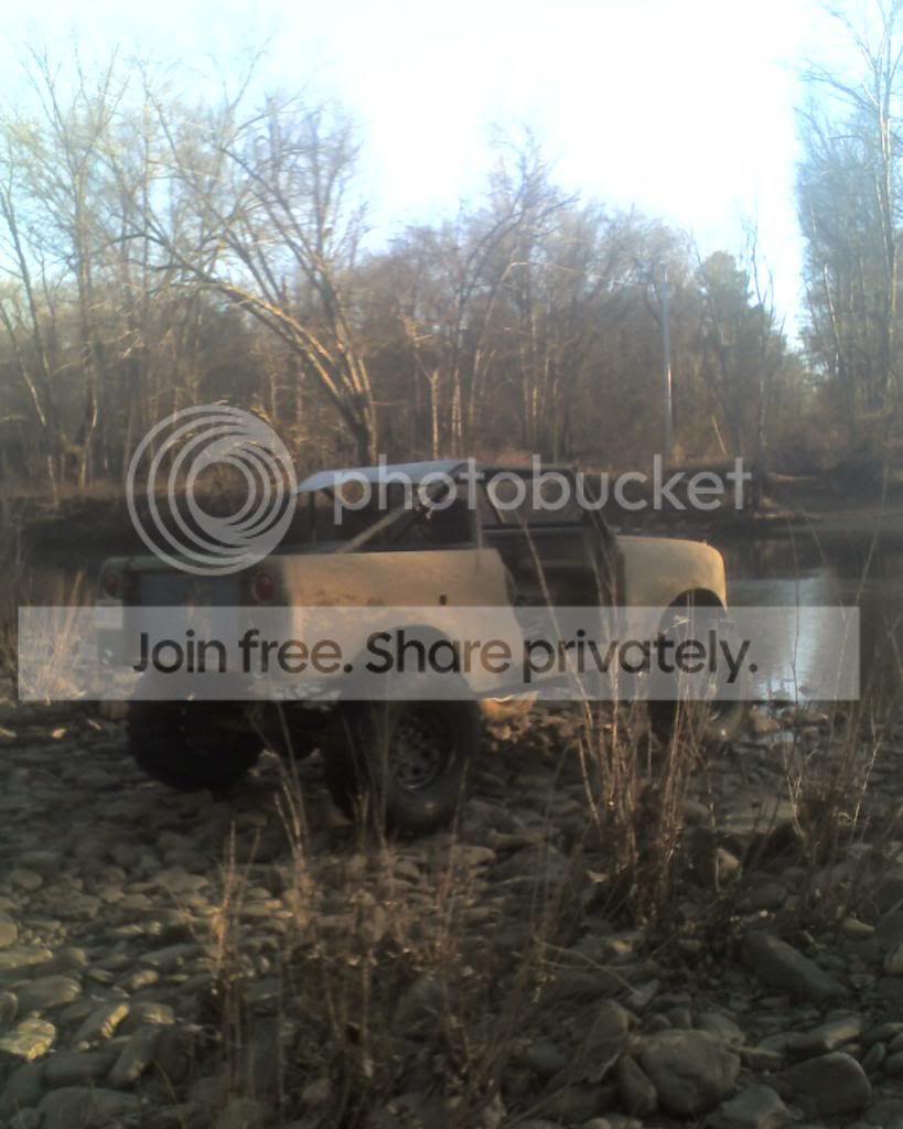

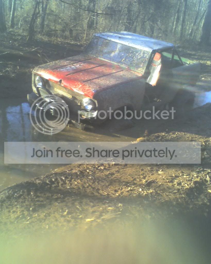

And since I was off today and bored I decided to take a little trip. 3 hour ride and I never touch pavement from the time I left my driveway till a short 2 mile stretch on the way back.:D

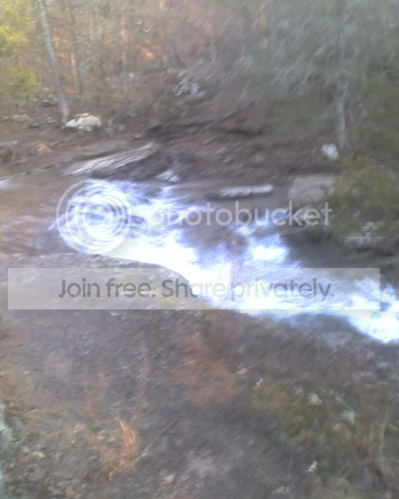

First creek crossing
Crossing a ditch. You can also see my aluminum top that I attached to the cage
Using what little flex I have
Either need trimming or less rubber
Second creek crossing
and then I found a nasty mudhole on the other side
Good thing the winch works:whistle:
Got some real nice pics of the creek at the crossings but for some reason my phone saves some pics and deletes others:confused:. Oh well at least I got some proof that the scout leaves my driveway.

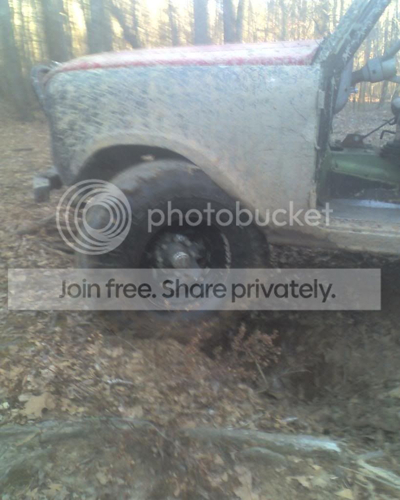

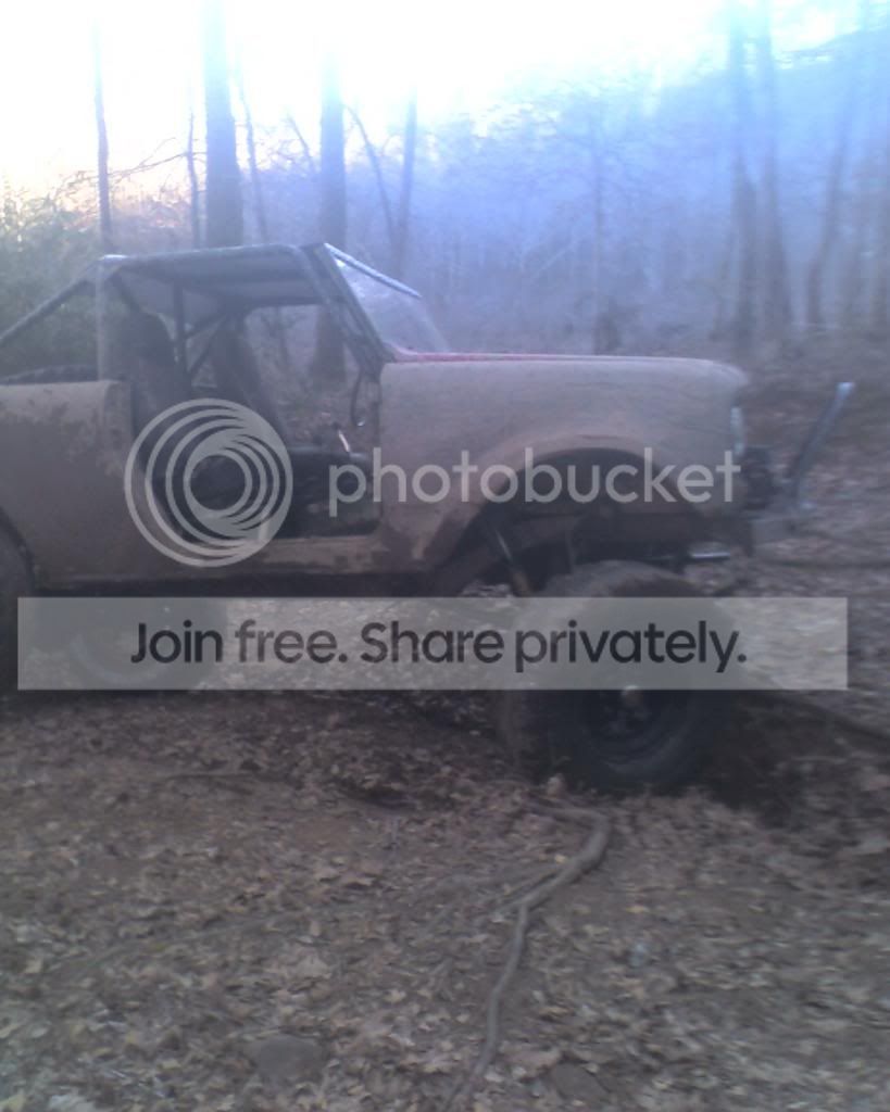

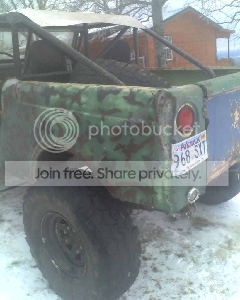

Took the scout out for a little snow wheeling and recovery last night. Was a long night.
First we got this freakish winter storm yesterday. Was sunny and 70s on Friday, cloudy and cooler on Saturday and teens with sleet/ice/snow falling all day so I had no plans to do anything outside. But it was not meant to be.
Brother in law calls me at 6 "is the scout running?" I tell him it is and he says good Im stuck. So I tell him Ill head that way as soon as a get some stuff loaded up.
First thing, all my propane tanks were frozen. Had an inch of ice around the valves and fittings. So I grab a tank and throw it in the bath tub with hot water to thaw. In the mean time I found a screw driver and beat the ice off the hood and windshield. Opened the hood and put in the battery. Got the propane tank and strapped it down and hooked up the hose. Fired right and ran perfect, I love propane:woot:. So while its warming up I grabbed some tools and a spare tire and tossed in the back. Locked hubs and jumped in.
Put it in gear and all it would do is spin the back tires.:doah: Checked to see if the driveshaft was spinning and it was so I knew the hubs weren't locking. Had to take the caps off and beat around on them with a screwdriver till they locked. Finally I was able to move and it is now 7 pm.
So I drive 10 miles through sleet and snow with no doors, heat or windshield wipers stopping every couple miles to clear the windshield and finally make it to the road where the trail head is. They had walked back to the road so that I could find them. Once I found them it was 8 pm. So we take off down the trail, everybody thinking we've got it made until we slide down a hill and into a dirt pile killing the engine. Now this would normally be no problem, no damage was done, except somewhere in my hour long drive the neg. battery cable end broke and the battery wasn't charging:doah:.
We leave the scout with a pair of vice grips and walk about a mile through the woods to where the jeep is and grab the battery out of and walk back. By now I had quit looking at the time, it didn't matter anymore. Get back to the scout, out of breath and sweating (at least we weren't cold:whistle:) and take a break. Toss in the battery and off we go. Come to the first hill climb and after several full throttle assaults there we were wedged, well not really wedged but there was a tree on one side and a cliff on the other so we decided to winch.
Got past the first hill and had to wind through trees that were barely wide enough for my tires to squeeze through and came to the second hill climb. First you go straight down into a dip and then straight up the other side. Engine sputtered on the way down and lost all momentum. Backed up and hit it again wide open. Front tires broke over, back tires caught something and slung us hard sideways into a tree. Had to winch again.
Now we are finally back to the jeep. Hook up cable with the scout pointed uphill and the cable was dragging the scout toward the jeep. So I back up, chain the scout to a tree and winch away. Finished out the trail with no issues and back to my brother in laws house. Left the scout there for the night and took his jeep home. I walked in the door at midnight, soaked from head to toe and ready for bed and there sat my wife at the kitchen table with a hot drink and a warm meal:bow::bow:
Only got one pic cause it was dark. But here's the carnage the day after
Oh and by the way, mostly worn out swamper suck on ice and hard packed snow. Im sure I wouldn't have had trouble on the hill climbs with better tires.
