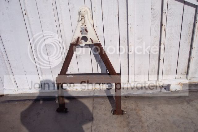

Heres a rough draw:

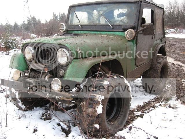

Heres the rig:
It has to move up and down, well not really but its not a trailer so it should. I built one well two just like that and they worked fine towed two Blazer's with them one to Idaho from AZ the other hear from AZ.
mine is just tabbed to the front and uses 1 3/4 delron bushings and 9/16 bolts. I tope the sub with it so i upgraded to a 2 5/16 ball over the standard 2'. My tow bar now connects to the shackle hole on the a bomb.
