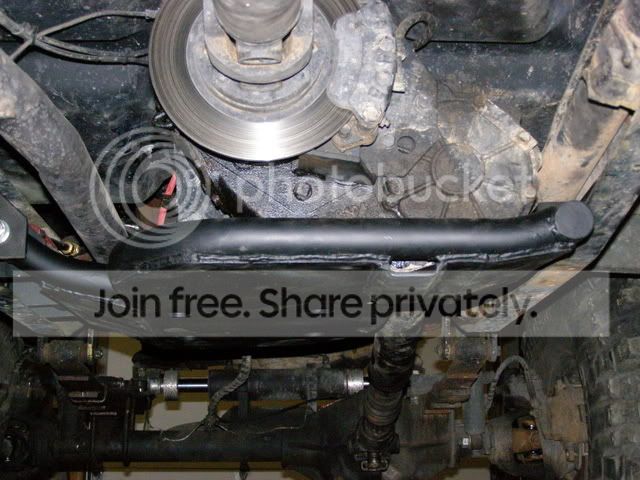

well, this isn't a full blown bouncer, but it is its intended purpose. I would rather be a little long and have 90 degree front and rear and be flat belly than be short and miss out on that stuff. I could have moved the front axle back when doing the spring mounts and cut off the end of the frame but then I would have no room for my winch.
I guess I need to take a ride down there one of these days to check on the goings on......And point out what your doing wrong.:D
Yes, I was going to make it flip down but just decided when I need to drain I will just pull that skid. I couldn't come up with a clean strong way to make a drop out cover.
The skid on mine is so tight to the t case you couldn't get the plug out with out dripping the skid or making that cover doo out. No room for a wrench.
You could probably replace the plug with a one that uses a hex wrench.
If you really think about it, how many times would you need to change your case oil anyway? It's not like they see high miles. I think the only time I've changed mine was when I had to tear into the case to fix something and to do that the case needs to be out of the truck anyway.
that was kind of my thinking on it.
