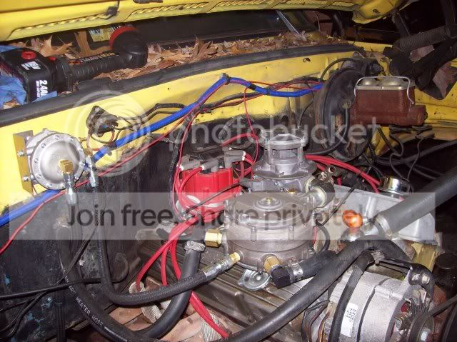

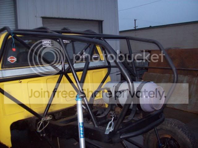

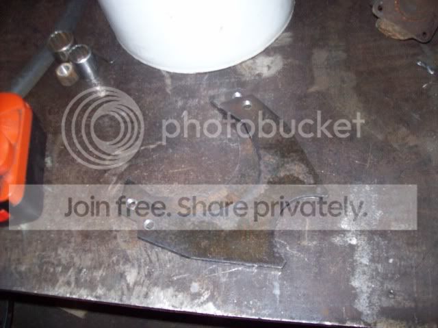

Savin jay the trouble.Not much to report today,but we did get the propane on
and the 14 bolt caliper brackets made.

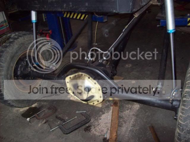

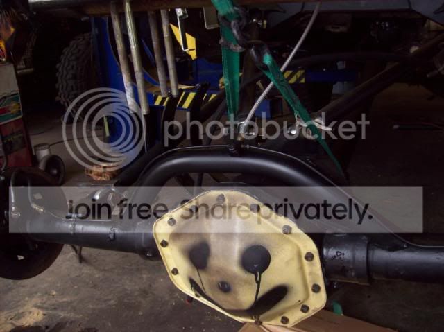

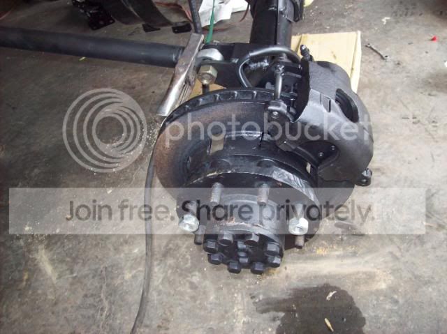

We got the rear disc on and brake lines ran.

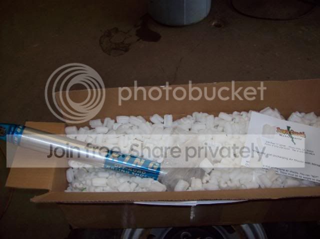

While we were workin on that the brown santa brought these.

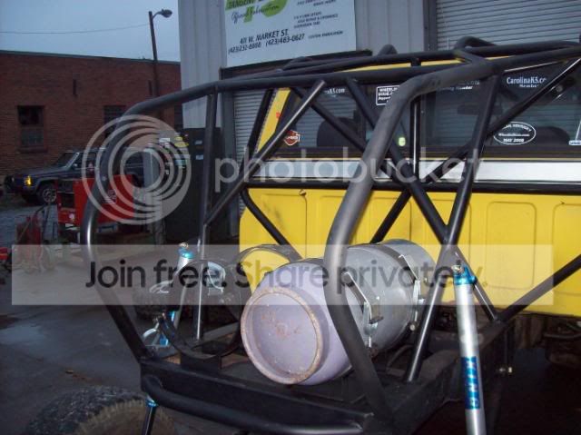

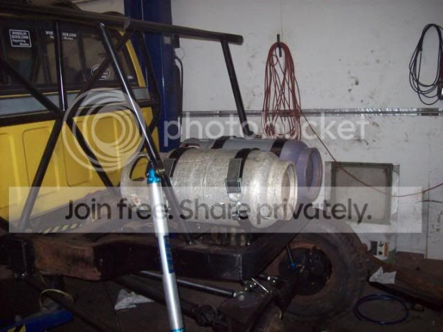

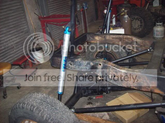

So today was shocks and tanks day.
This is full droop,were goin to have to put some limiting strap's on before it kills the air shocks.

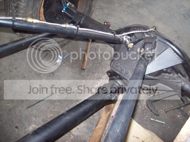

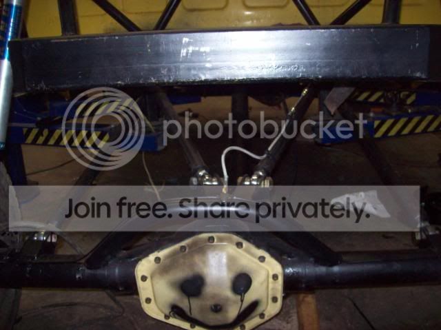

Driveshaft at full droop.

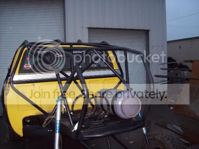

Latest progress.We finally got the rear tubes done and the truck started yesterday.
That'll probably be all for a few days since we have a few others to finish.

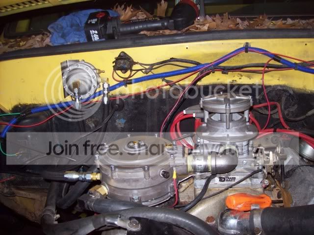

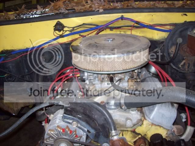

looks good. question 4 ya what kind of compression do u have to have to run propane..? is it only stock motors, i run race gas in mine its 12.5:1 race gas is pricey ...fill me in guys much appreciated..
I am not aware of a minimum amount,but the more you have the better propane runs.IIRC propane is over 100 octane.In your case it would probably be ideal to switch.
im running like 8.5 or mabye 9 to one,not very much but the propane guy told me you can run like 13.5 to 1...in a case like that u might have to run 2 mixers or something but its definitley possible...propane likes compression

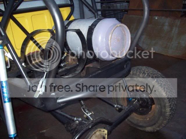

whats the overall price for propane, how large are the tanks you have and what do they run to get filled..? also how much do the kits usually run and wheres a good place to get it..?
here is what i got from the guy i got mine from...
$475 for kit and all fittings.
$60 for supply hose.
tank brackets are $75 per tank $150 for 2 sets. just let me know how many you want.
chevy fuel pump blockoff plate. $5.00
$25 shipping.
tanks are 50 to 75 bucks used...about 25 to 30 bucks to fill...here is his info if you wanna talk to him
