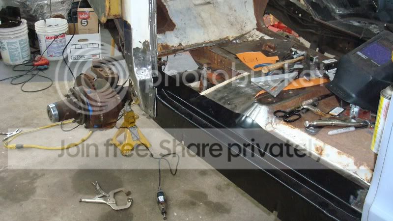

Does anybody here know what part this is, I want to make sure I get the correct patch.
The part in question is the one that looks like it was cut with a dull blade in a jig saw. This is the inside of the passenger side rocker box, left side of the picture is near the door, the right side is near the transmission.
If you are talking about the left side of the pic. It looks like the flange, were the floor, and the rocker box meet. The rust has separated them.

That photo is showing what most of us call the "inner rocker" panel... it connects the torsion box vertically to the floor area.
The aftermarket part you'll find is pretty lousy, and if your floor is bad along the door sill (which yours appears to be) then you'd be better off with a patch part that is for a truck. I accidentally ordered them when I was doing my rust repair and it turned out to be a fortunate mistake...
This part is what I'm talking about (image here is the driver side).... see how you get the vertical part you need (inner rocker), but also a good portion of the outer floor/ sill area too?? That little bump around the raised seat mount area gives you a great "index" to lay in the new part and make sure you've got it lined up right.
The part number is buried somewhere in the first 200 posts of my "Might As Well" thread.... you can search for the keywords "fortunate mistake". I think that's how I worded it when I was describing the part and part #. The parts came from Tri-Pro Automotive.
EDIT: Link -> http://coloradok5.com/forums/showpost.php?p=2177285&postcount=52
Hope that helps! :thumb:

Greg, Shane, thanks for the info. I agree that the hump in your picture should make it a little easier to get the alignment right. I tried to look up Tri-Pro but it looks like they are closed. I found a inner rocker for a truck that I like from americanclassic.com. It seems to have several parts combined such as rocker brace, inner rocker, along with a larger portion of floorboard sheetmetal. Has anybody used americanclassic and does this part look right to you guys.
Here is a link to that item.
http://www.americanclassic.com/asp/...Patch+Panels+-+Cab&iyear=1972&ytype=to&exyear=
Part number CFO7L and CFO7R
EDIT--->>> I just cross referenced the part number CFO7L and the part number from Greg's 0849-227 and they are the same part. Both are made by Key Parts.
Bama,
Looks like you found the right thing.... :waytogo:
I think you'll be a lot happier using that part instead of the "correct" one, and the results will be a lot better too. Because it's a truck part, you'll end up cutting off some of the extra structure on the b-pillar side of the replacements to get them to work on the Blazer.... not a big deal, but don't feel bad when you have to cut-up your shiny new patch parts. :)

Greg, will that truck part work with all the factory torsion box in place? just asking, if I'm not mistaken you removed all of your factory stuff, and up graded right.:dunno:Or are the trucks, and blazer close to the same in that aspect/area?
The part should work the same whether you keep the torsion box or not....the only part where you need to get creative is on the new part near the b-pillar area. The shape there needs to be cut to match the Blazer tub profile. The pickup will have a completely different shape back there since it's a closed cab.
Hard to explain, but easier to see once you have the part in hand and can hold it up to the Blazer to compare things.
:usaflag:
X2. I used the same part on mine without removing the rocker boxes. You just have to cut the spot welds that become visible when you tear the outer rocker off.
Also, don't trust the two holes in the rear of that patch panel. Mine were about 1/2" off. Just drill new ones and weld up the old.

Good reminder.....my rear holes were off by 7/16"!! :D
