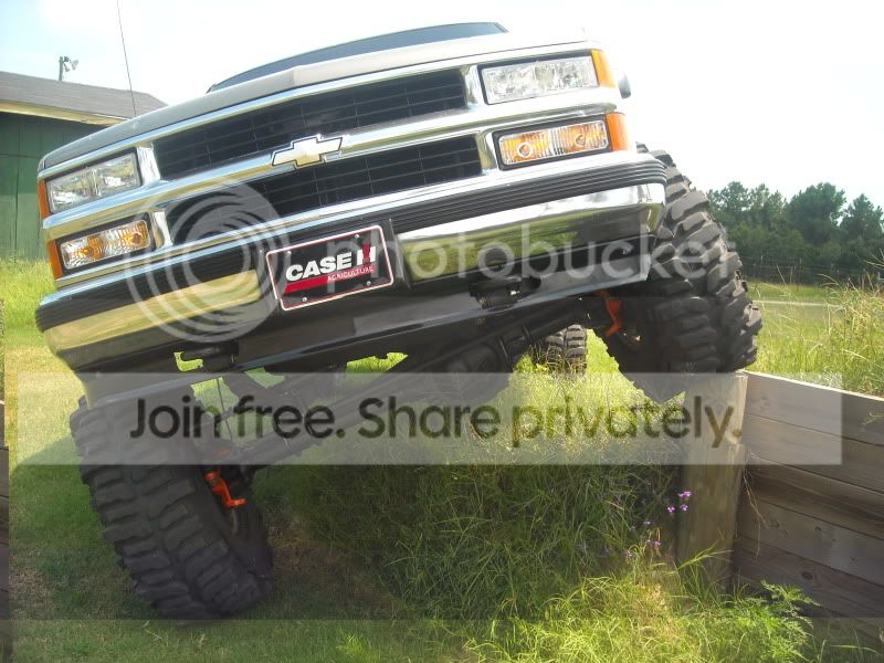

Interesting. Is it a business or just a dude doing it on the side? I ask because i have always wondered what it would cost to have a 10 bolt switched to driver drop. Like for a SAS on 95ish tahoe...
Like this guy.
its a shop. thats all they do is diff housings and gear stuff. 2 older guys run it.
that pic is funny. my apprentice at work has a full width driver drop 10 bolt under his s10 blazer. i asked him why he didnt just use a ford d44? i havent heard a real explanation yet on that.
