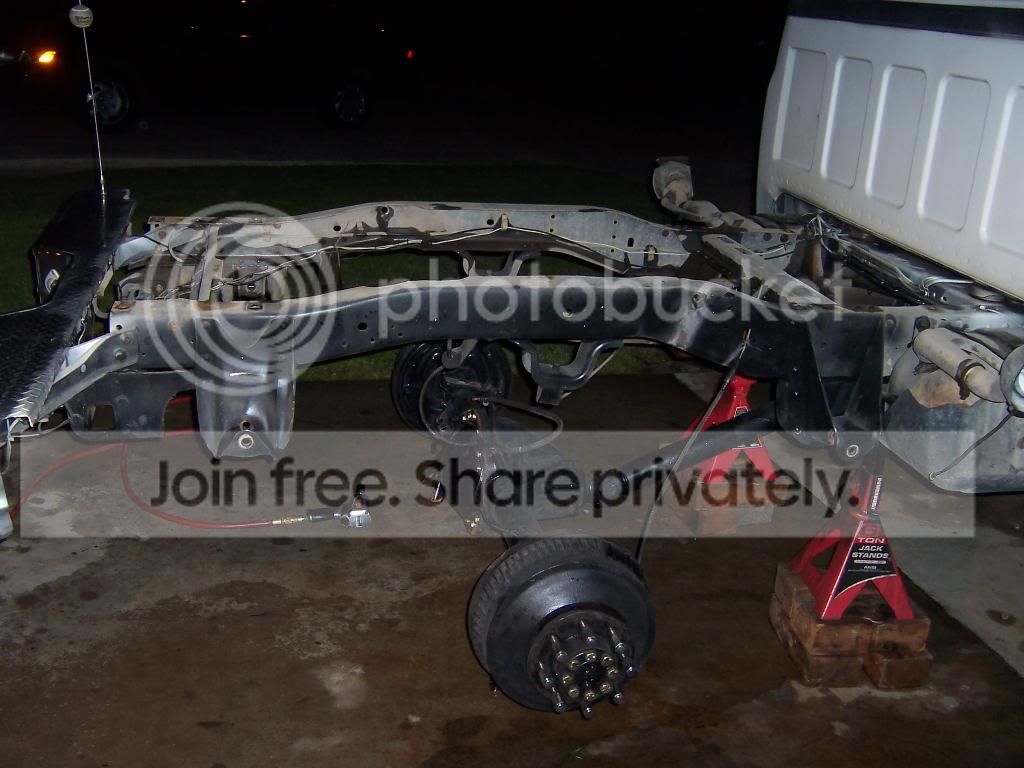

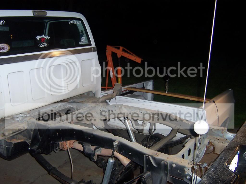

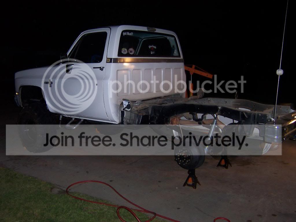

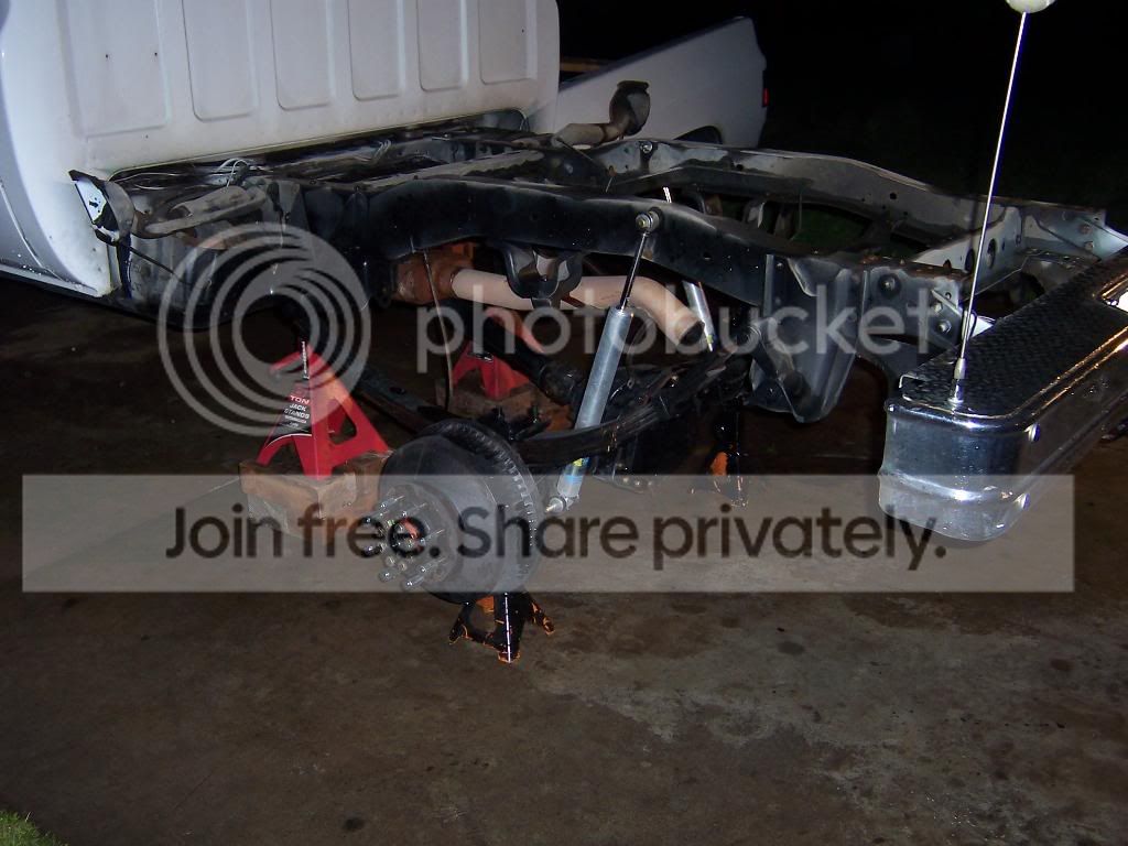

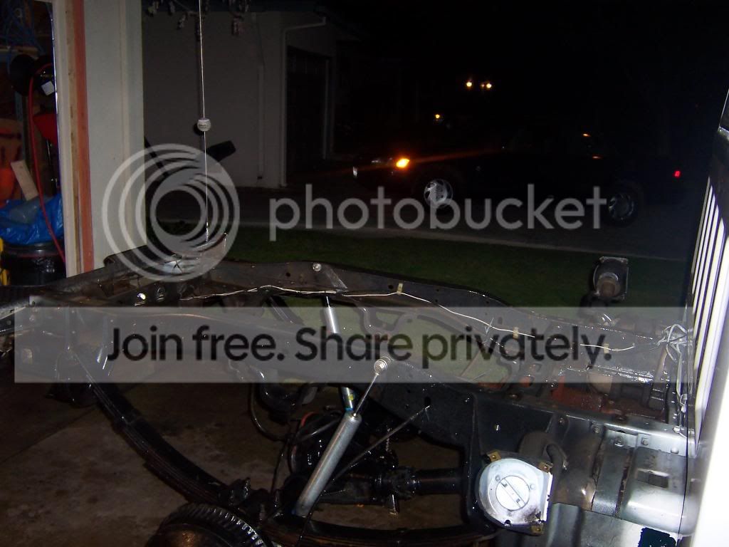

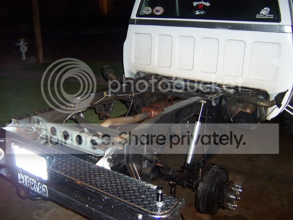

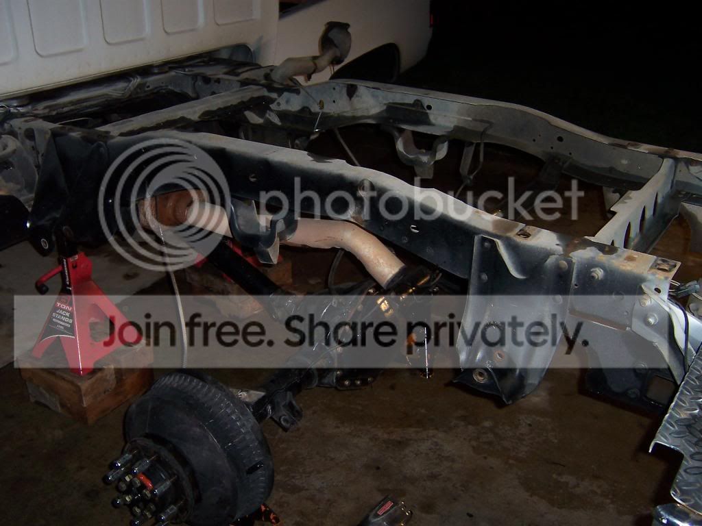

Well it's been a long time coming but I'm finally tearing into my rear end project...

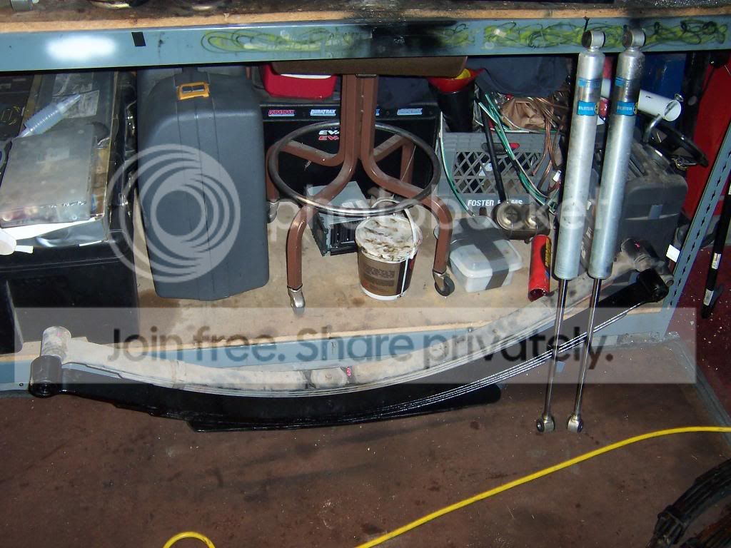

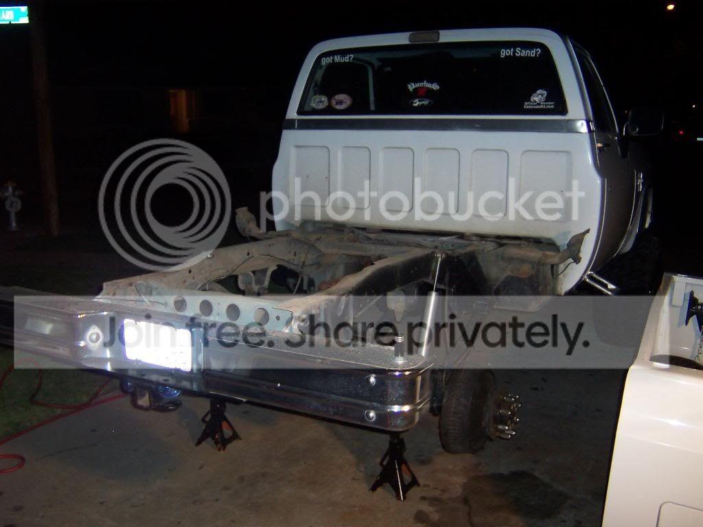

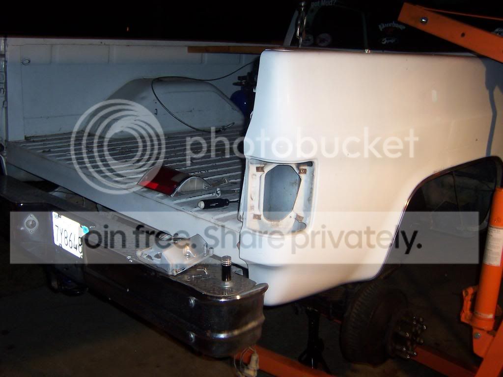

On the agenda tonight was stripping everything off the frame and undoing all the wiring and other stuff attached to the bed. Then pull the bed, springs, shocks and anything else in my way... :D

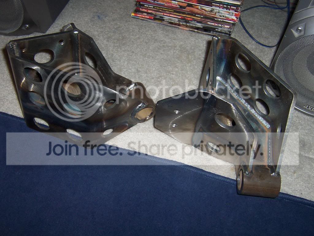

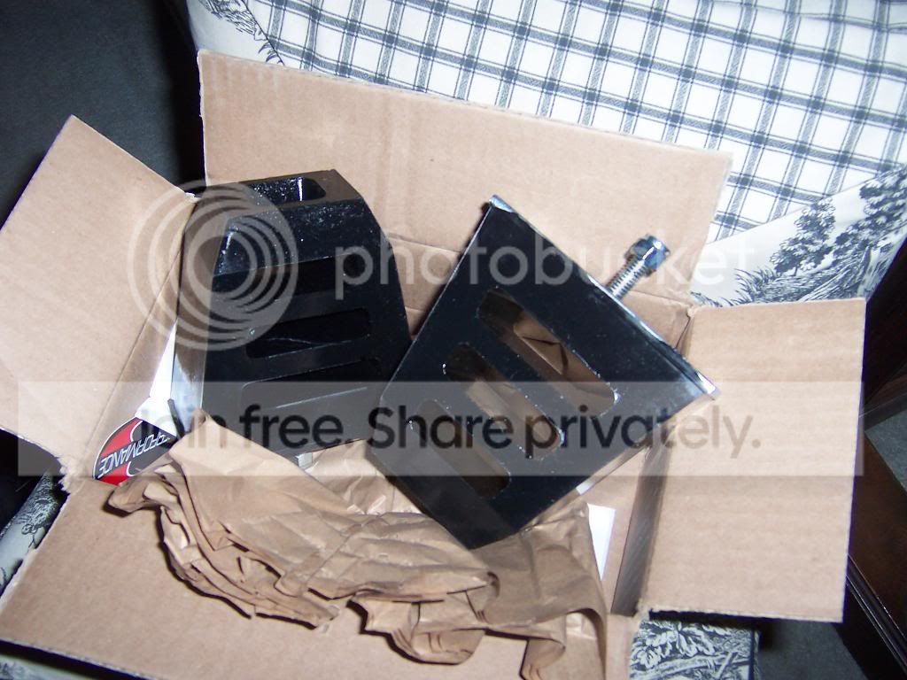

Tomorrow I'm going to put on Kert's sick lookin' brackets along with my junk yard find Ford 57's and a few other goodies...

I'm going to tube out the back with a halo behind the cab (a full cage is in the works down the road but for now this is a start). I'll cut the bedsides off the bed and come up with a way to quickly attach/remove them to the tube but I'm going to do a mini-boatside so the front of the bedsides will be at the normal width and the rear will be frame width.
My plan right now is to get the suspension done but I figured since the tube/bed work is next on my list I might as well remove it now... plus it makes it really easy to work on stuff without the bed in the way :)

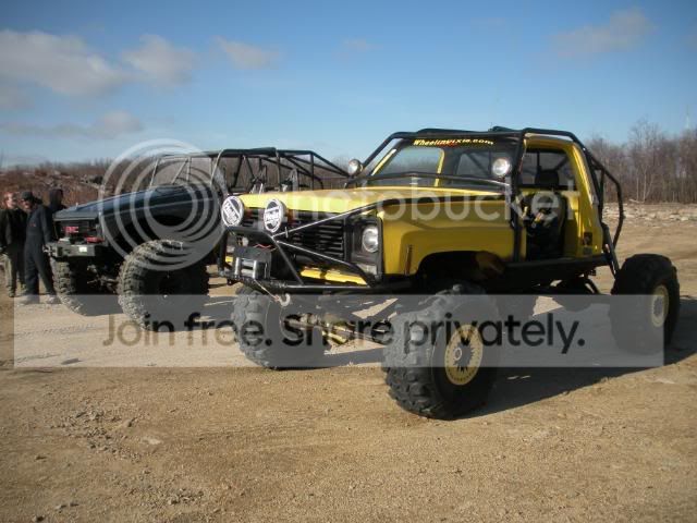

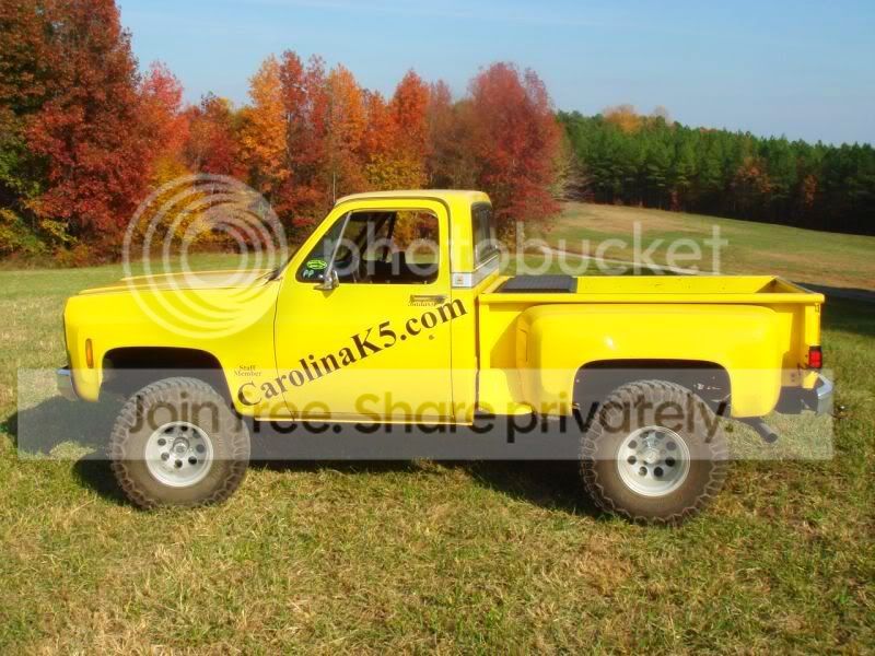

im all for it mine went from this
and its beautiful in my eyes.i havnt even owned this truck for a year yet :eek1:
Best part of the transformation is ya got rid of the CarolinaK5.com sticker on it :D :haha:Should be a CK5.com sticker on it.
nope wheelindixie man.we all met off of here and a few of use are still on but ive been in it since the begining.best group of people ive ever met.we just had our 1 year aniverary and have about 500 memeber already
if no one knows thats formuds truck beside mine.in a little over 2 years his went from this
to this
