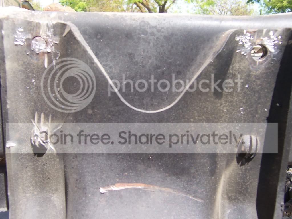

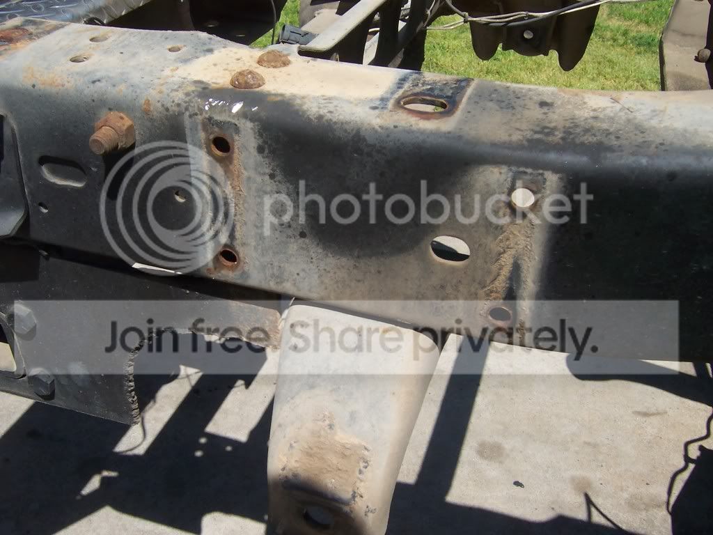

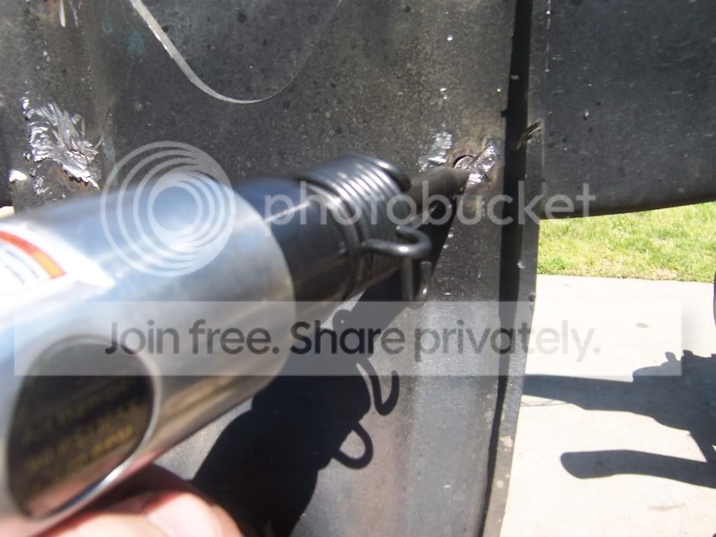

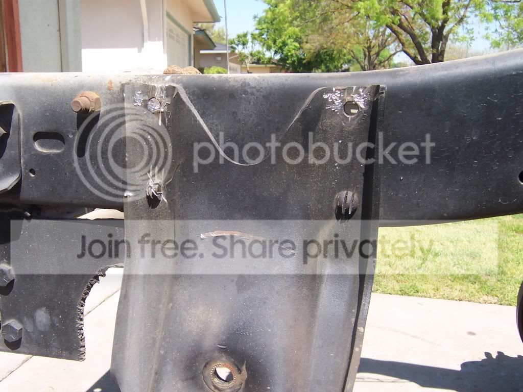

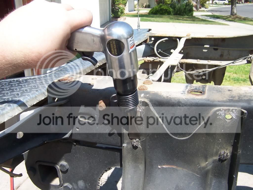

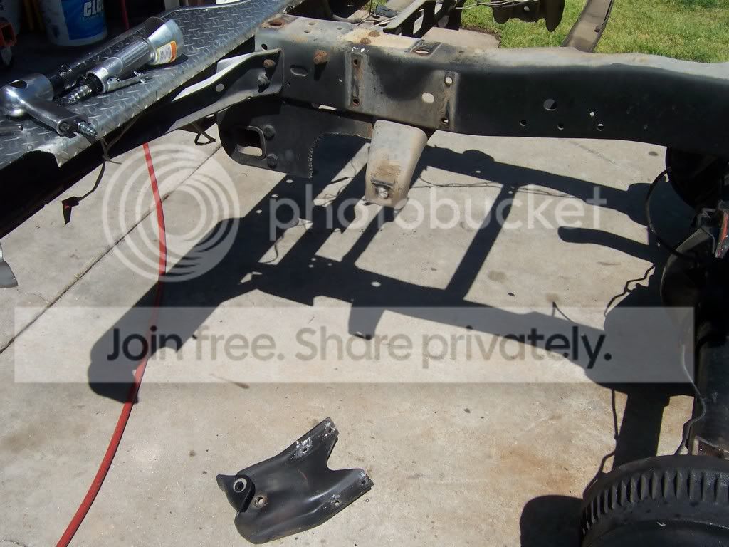

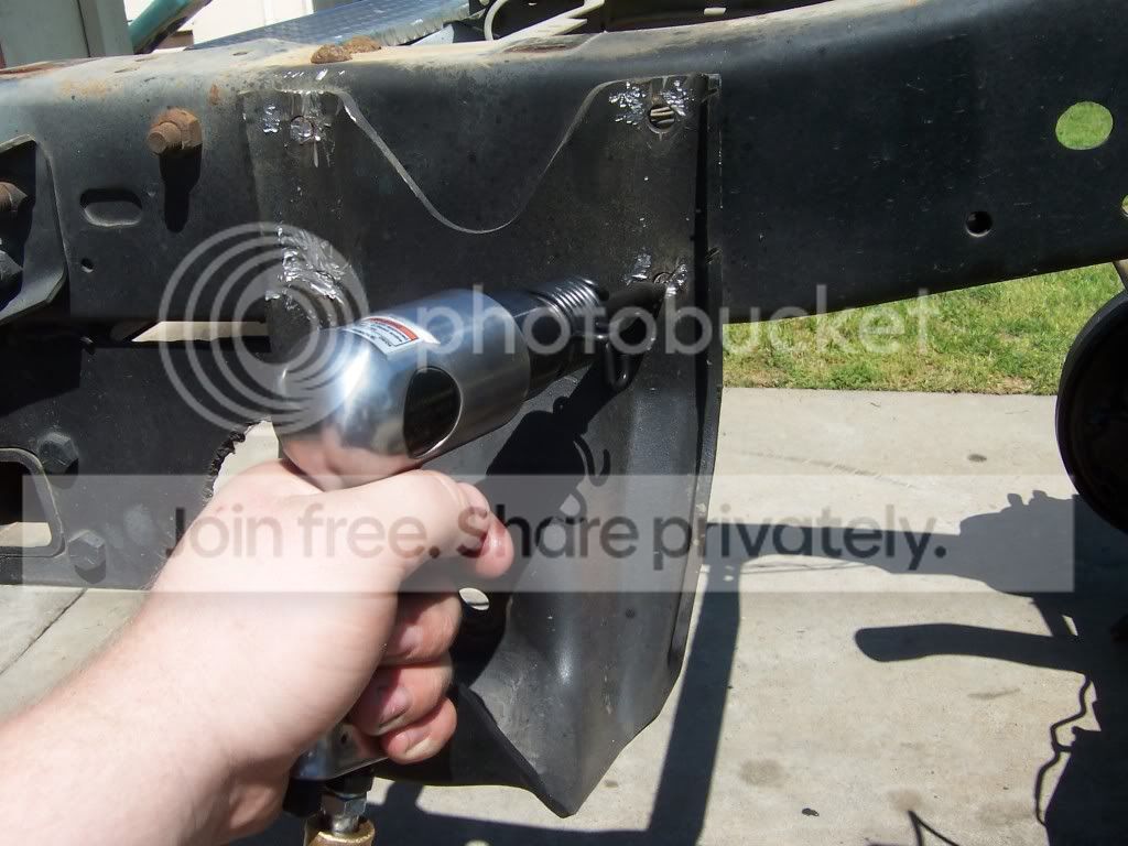

TaDa! Here's my Rivets-b-gone method...
Took about 20 minutes to do all four of these...
The first pic shows my progression starting at the bottom left going clockwise... slices with the cut-off wheel... more slices... flat spade on the pneumatic chisel... then a punch on the chisel...

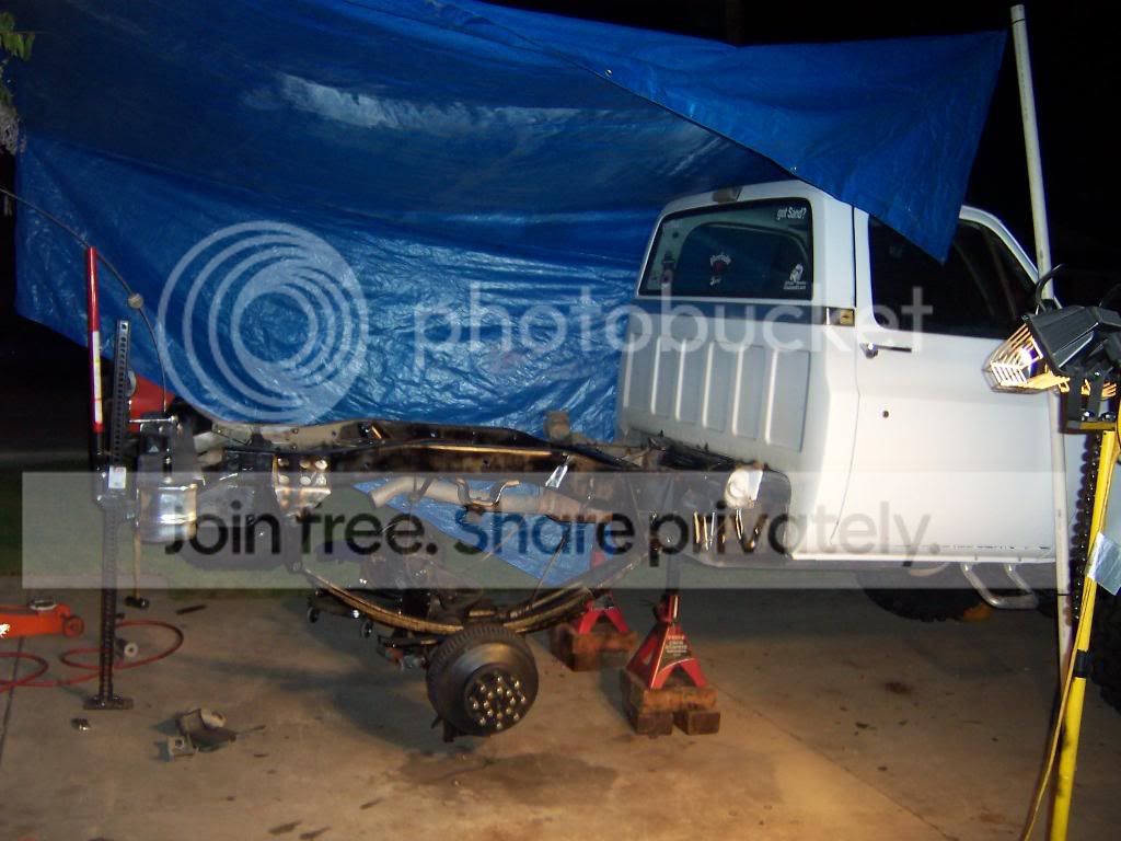

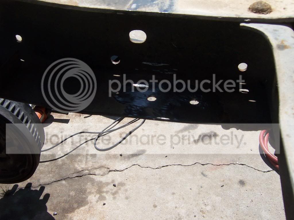

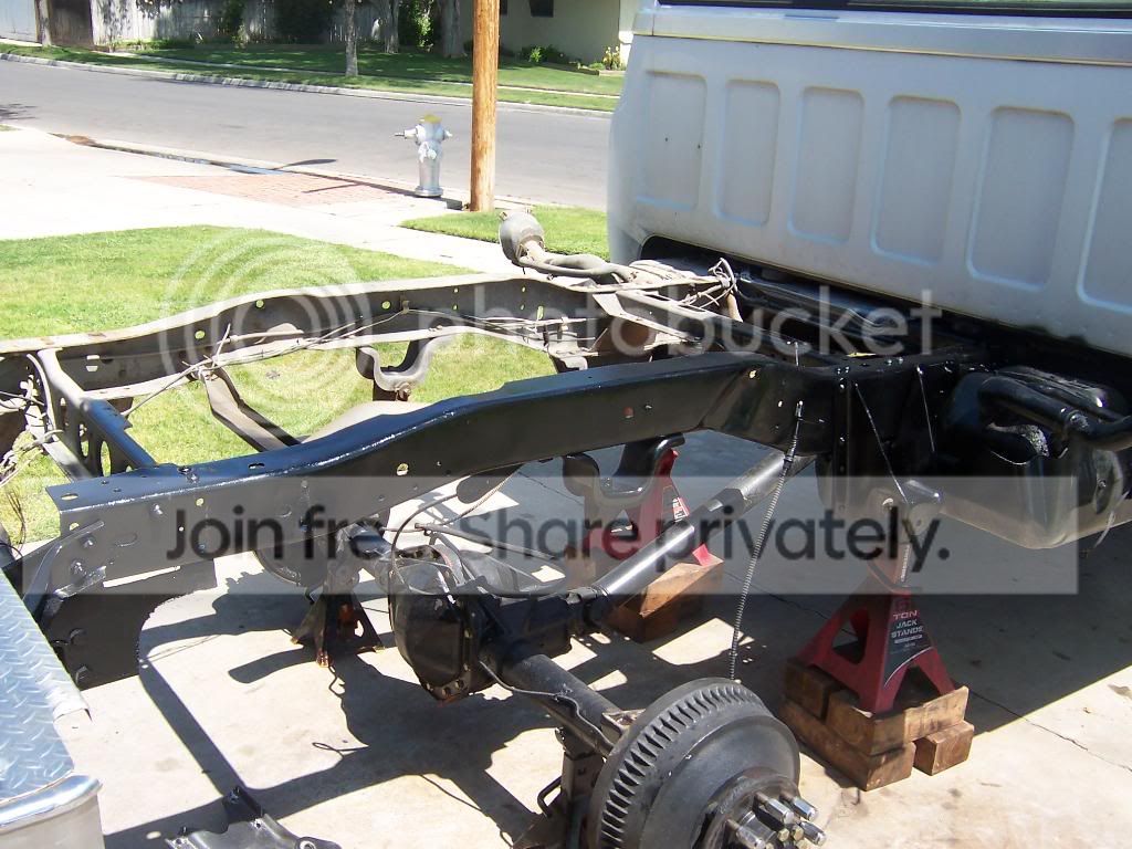

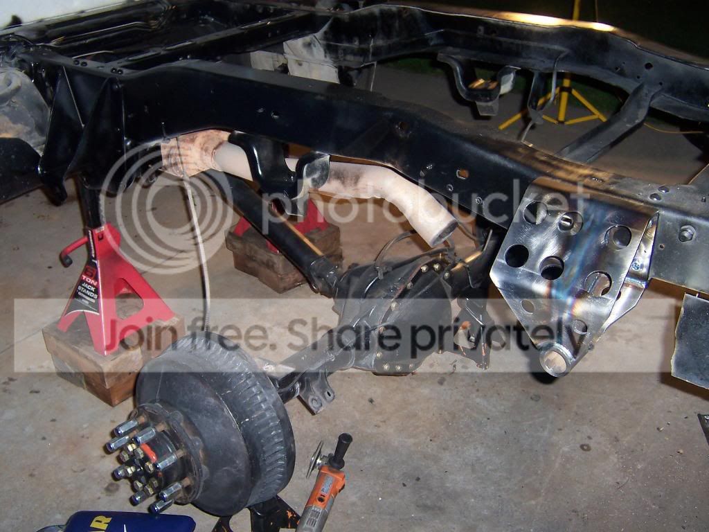

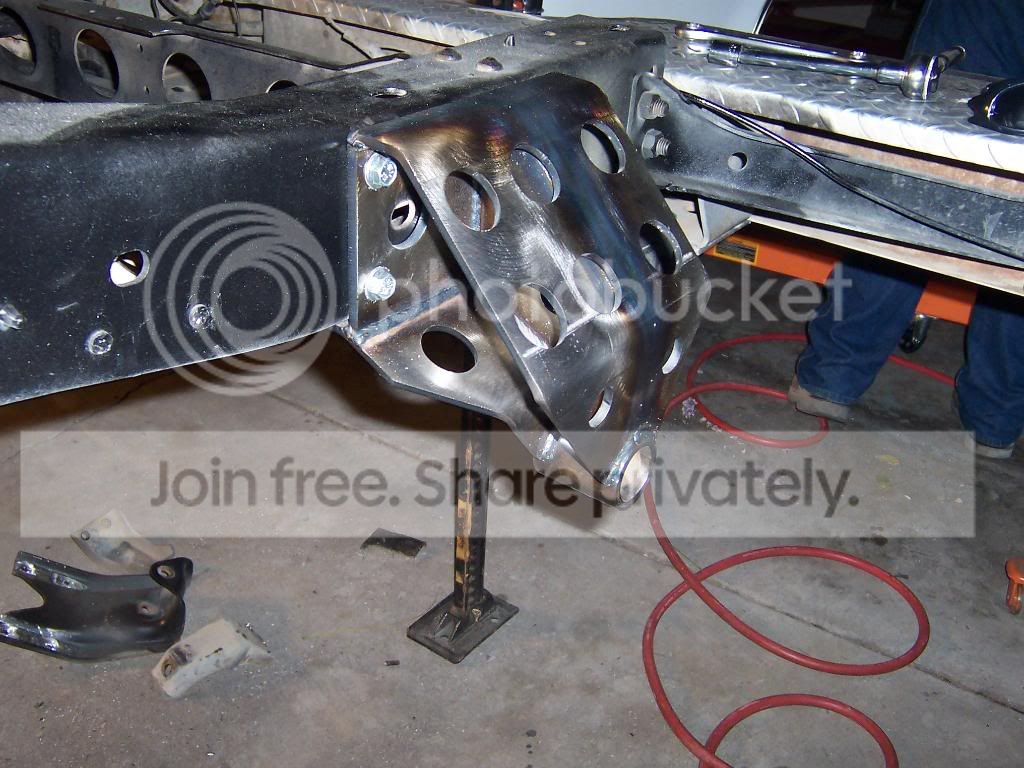

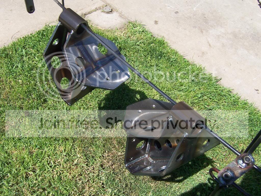

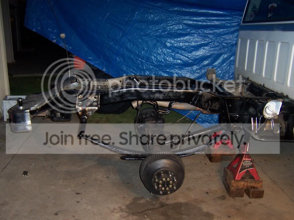

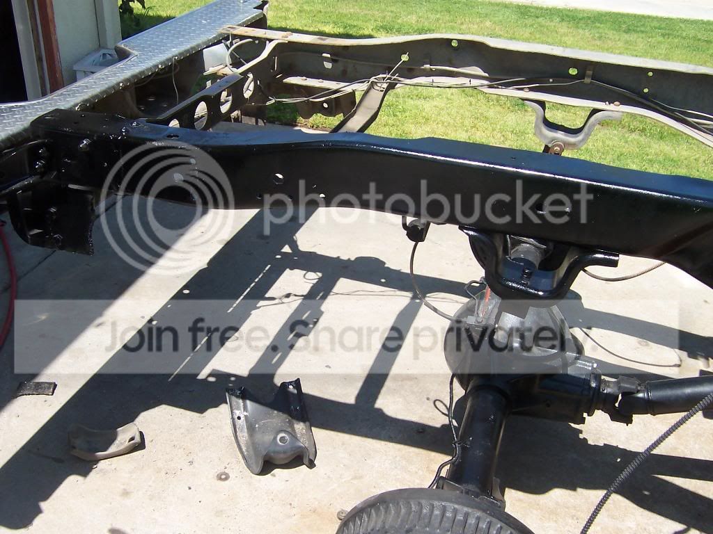

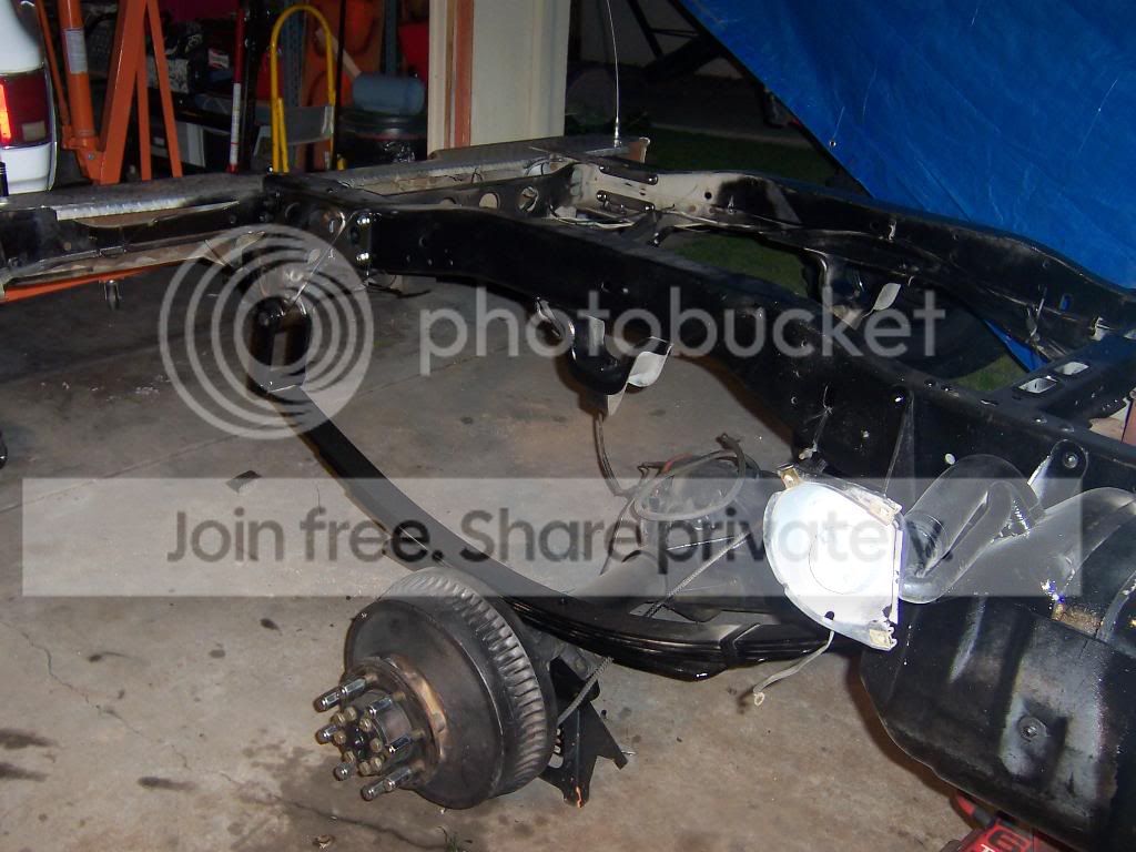

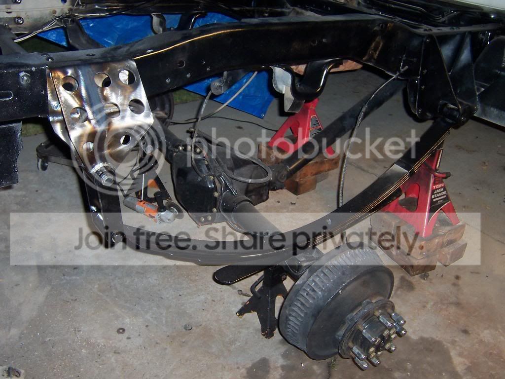

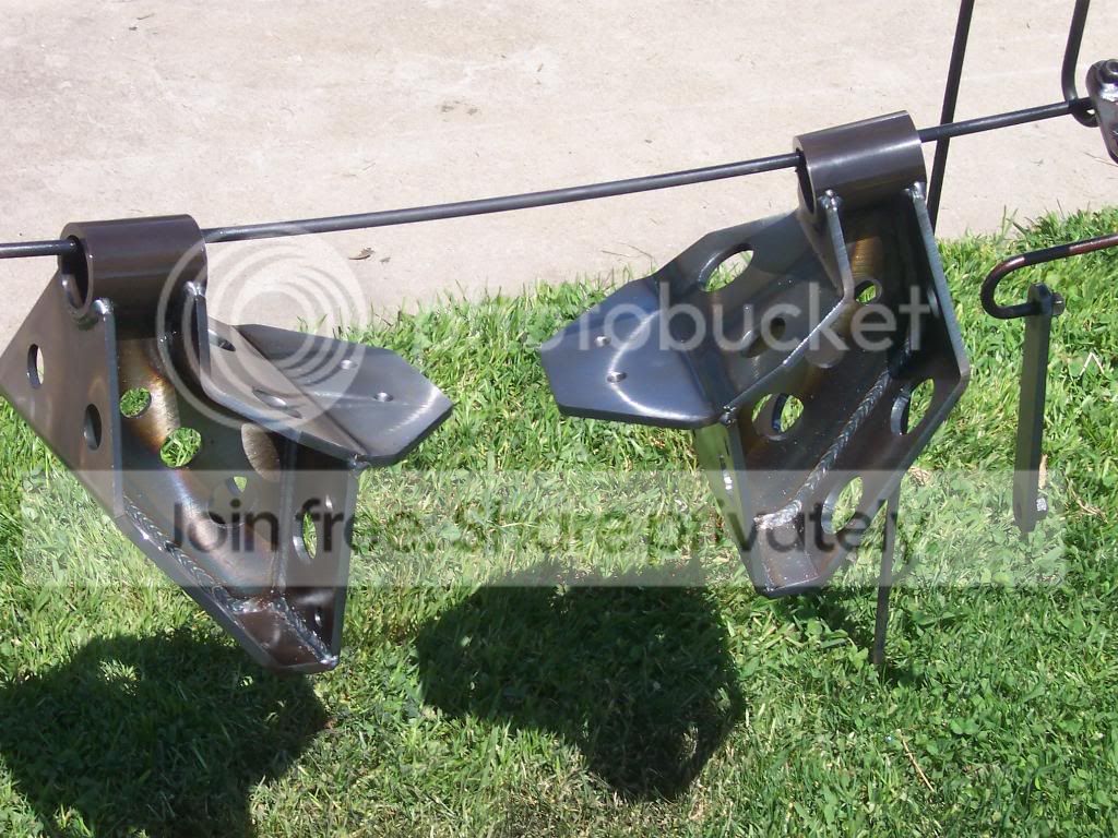

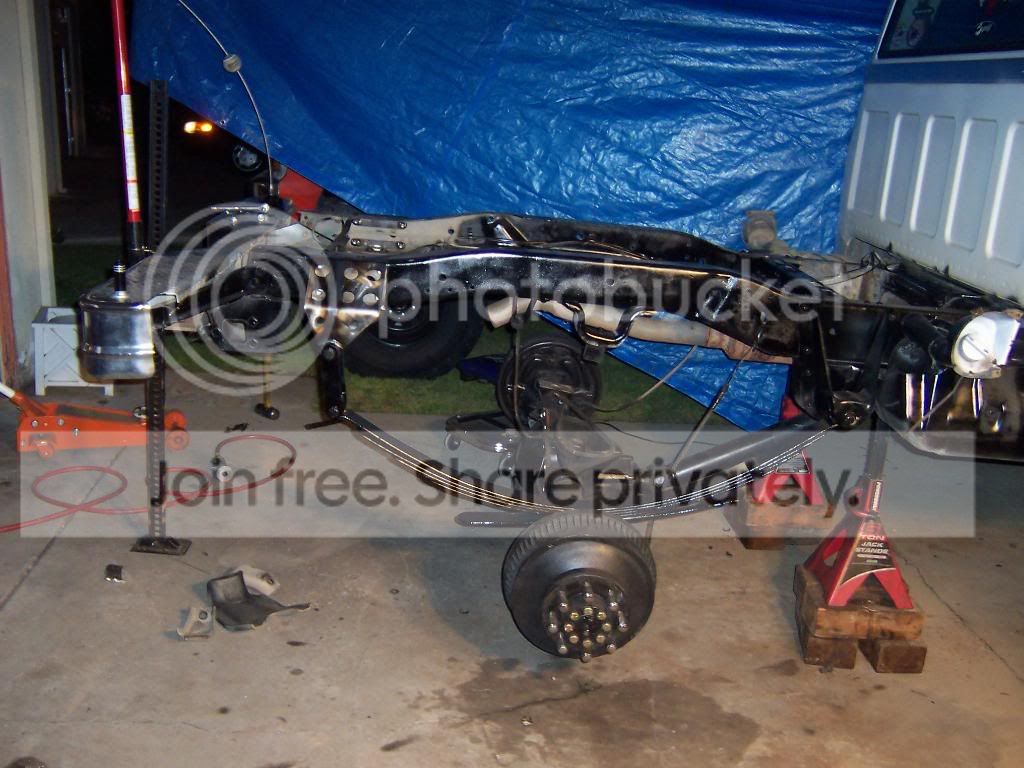

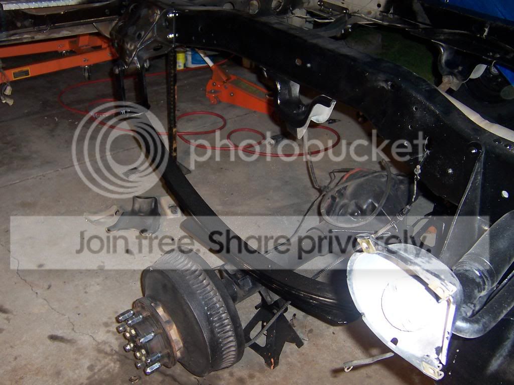

Ok here's some progress pics... I put 5 coats of clear on the shackle flip brackets since I liked the way they looked in bare metal with the bluing from the welds so hopefully they won't rust but if they start to I'll just paint them down the road, it has a cool industrial look to it though.
