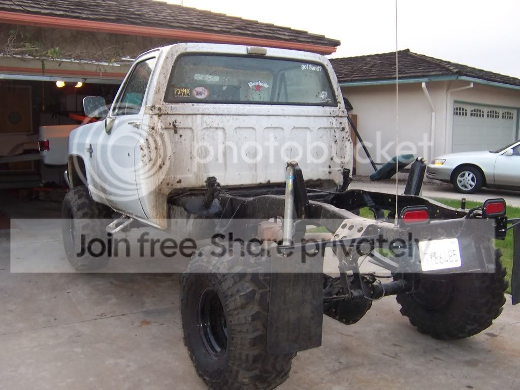

I can already tell the ride quality is better, I'll be excited to get it out on a trail or hit the dunes to see how it feels out there...
Soft rear and stiff front--it is going to be a little bouncy in the front.

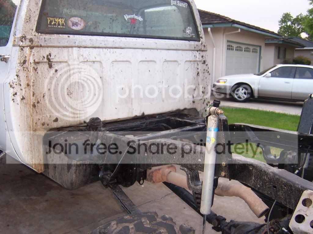

Following along quietly and I like the direction it's going.Will you be going back to the RTI ramp now that the shocks are on to see how bad if any the shock towers flex?I would hate to see you crack/rip your frame after all the warnings you've had.Look great man:D
I'm sure once they tie tube into it, it'll be a non-issue...
I don't think the shocks binding is causing frames to crack. It is the resistance of the shocks and the leverage of the towers that is causing the problems. Yes the shocks are moving but it is hammering frame at mounting points. Think of it as hitting the top of those towers side-to-side consistency with a dead blow. May not seem doing any harm but it is gradually fatiguing the frame.

but you should really box your frame or it's gonna crack :p::p:
i hear ya on the mud flaps, i have to run em too :mad:
looks really great, avery. i agree that you should definitely make supporting those shock towers your next priority (a post from a few pages back first stated it.... but i've been outta town all weekend. :) )

The tube bender is on the way which means a cage is on the way... we'll tie those towers into the cage to stiffen stuff up.
