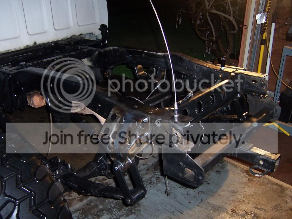

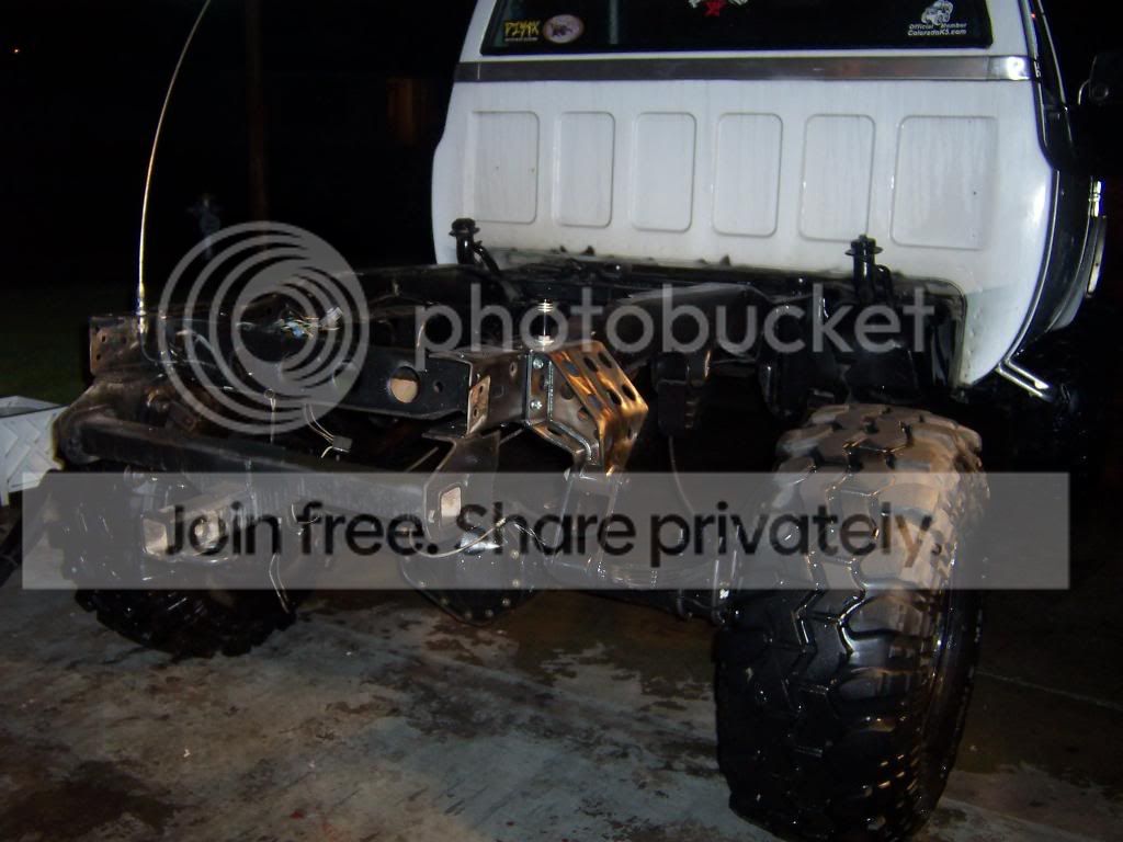

it does indicate worn body mounts. having worn mounts doesn't allow the body to contribute to frame strength as much, so your frame flexes a bit more than usual which makes it more prone to cracking. beings that our frames are riveted they are made to take some twist, but it does have limits.
It's not flexing as much as the rear (obviously :rolleyes:) but it's flexing a couple inches... the driver's side tire was about 1/2" away from kissing the wheelwell...
Plus look at the passenger side, doesn't look like it does at ride height to me...
I'm seeing very little frame flex there. I think you're good to rock it as is. The amount of body/frame/mount flex I'm seeing in this picture is minimal at best. granted, there's no bed on the back, but from what you can see of the front bumper - you have hardly any issue with it. You can also see plenty of lean/flex in the rear suspension by way of how the rear bumper is tilted. looks good. :waytogo:
box the frame or plan on doing it on another frame after you mess up yours and have to swap all your stuff, it only takes like a week, well worth it
as soon as driver side front hits a rock at the same time passenger rear hits a rock of any decent size your frame will crack or bend, but like i said if you dont plan on doing any real trails you should be fine
We are going to hit some hard trails up here this summer and I can assure you his truck is not going to break and fold in half.

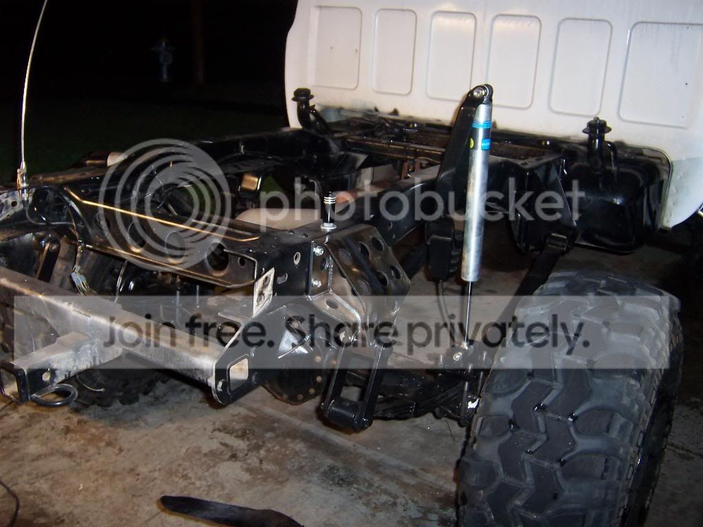

I got some work done tonight... I had my dad on hand which was nice, and the dog which was not so nice... she always wants to be where I need to be standing. :doah:
I got stuff mocked up and wrote down what hardware I need so in the morning I'll go grab some grade 8 bolts and get it bolted up.

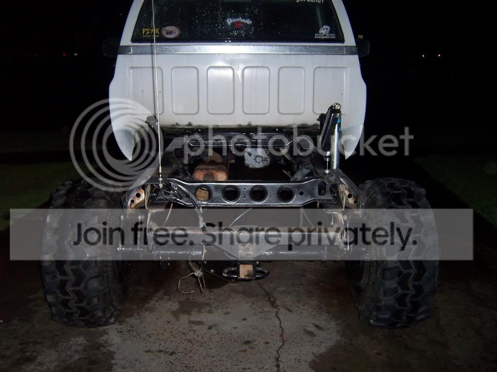

I also got the rear bumper pulled off... I'm going to get my new stop/turn/tail LED lights wired up tomorrow then drive it over to Frizz's place to torch the hitch off since it's welded on.

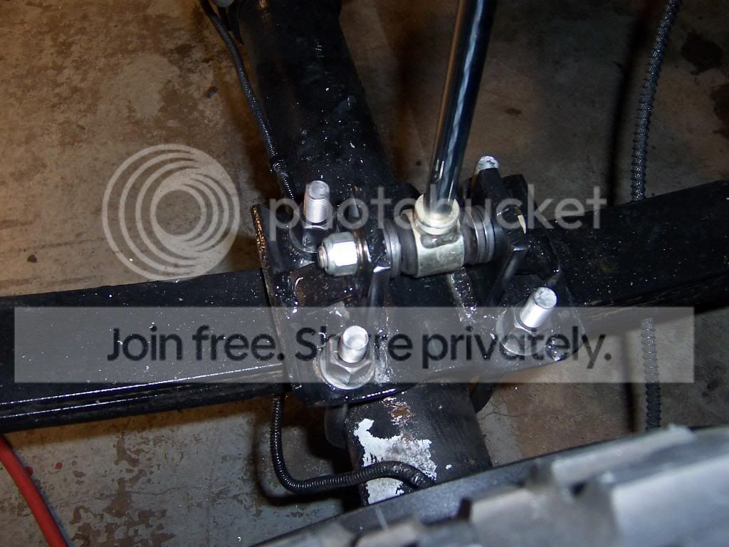

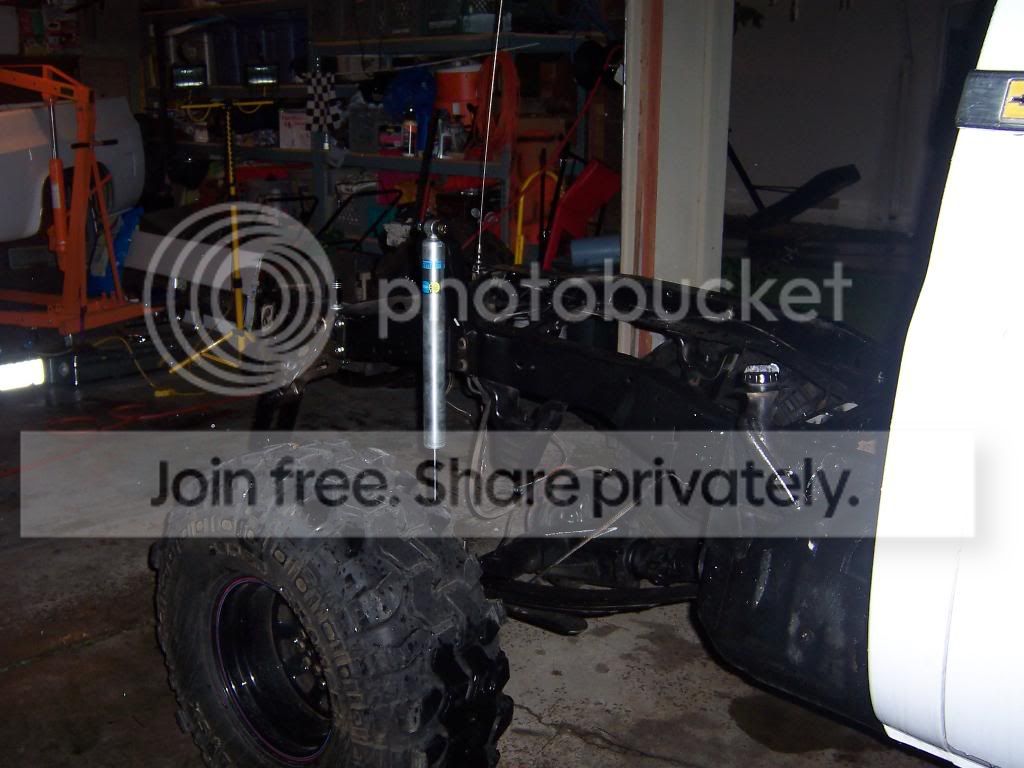

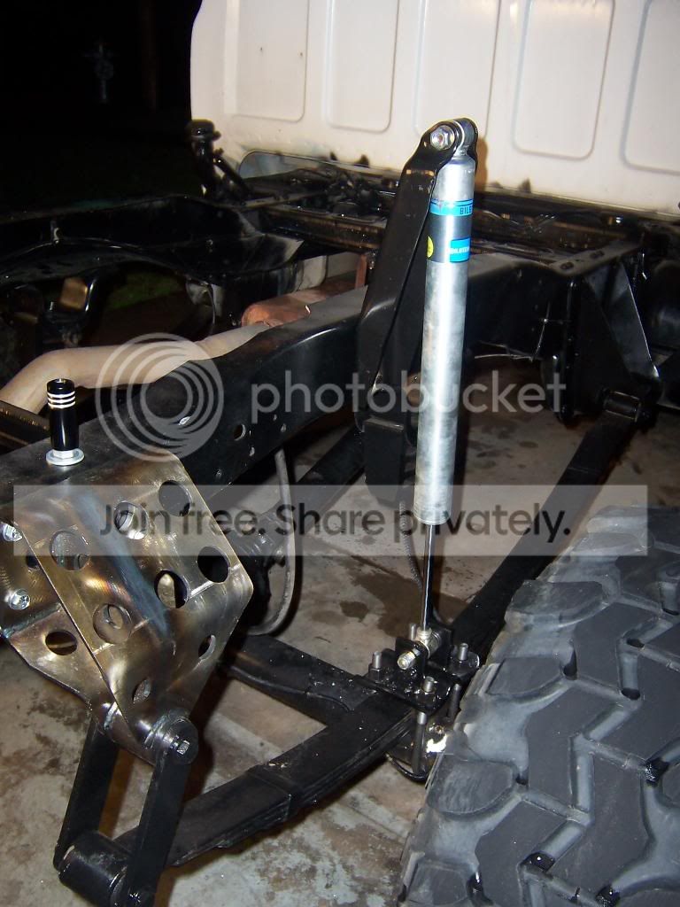

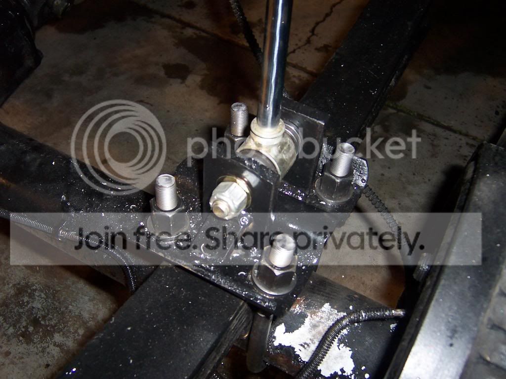

Avery - I'm not really liking the gussets on your shock tabs. Looks like you made the tabs out of real thick material, so you're likely ok, but I'd MUCH rather see a gusset that goes along the edge of the tab, making a 90* with the tab. The tab you've built is still prone to failing in the same plane as your tab, where as if you made a tab that looked like a L or a [ shape, you'd have lateral strength in 2 planes rather than just the one.
Yeah I wasn't really sure what to do and I had about 45 minutes at lunch yesterday to whip something up so that's what I made...
I'm thinking that when the tube project starts my shocks might move but to be honest I'm not sure. The shake-down run at Bald will show me the truck's weak spots :D
I like what you're saying though so if I end up keeping them here maybe I'll mill some new u-bolt plates with some integrated tabs.
I wouldn't worry about it. From the looks of it, they are already over built. It'd take a HELL OF A LOT to fock those up. The shock shaft would bend before the tabs broke.
I don't see a need for a "edge" gusset. I'd be VERY suprised if those pulled off without a gusset at all. Shock mounts don't see near enough abuse to break or bend those.
As long as the welds are decent your good.:waytogo:
