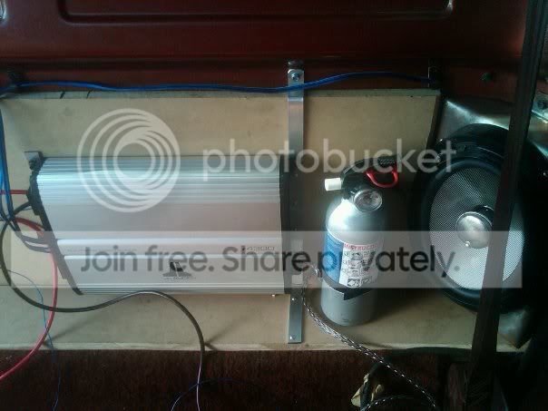

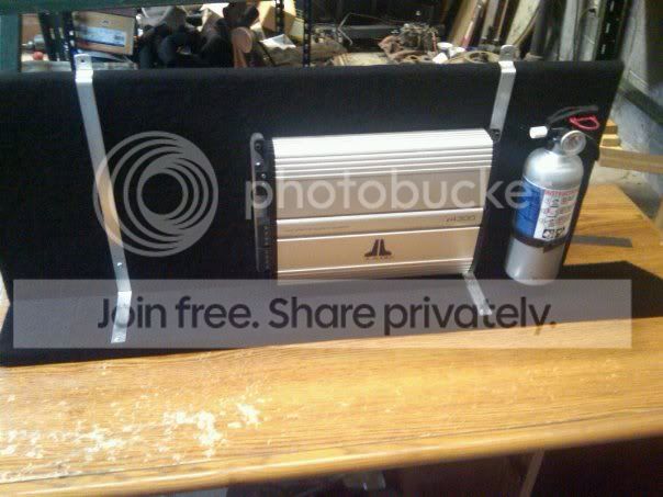

Been working on the audio. Still looking for another headunit, may use current, but for now ive got a jl audio E4300 amp, the 6.5 brackets are sold out for the front, so currently the plan is:
Front
Need to decide 3.5 fronts (probably kicker KS series). I was thinking about using rod doors front kickpanel mounts but they are indefinitely sold out, so i may just run the 3.5s for now, although i did pick up a set of inifnity kappa 6.5s for 85 on clearence as well.
Rear
Picked up a set of infinity kappa 6x9s on clearance, new in box for 125 (usually 180 so SCORE!). Gonna mount using custom 6x9 cab corner speaker brackets.
Additional
Maybe a single sub (have a 12" p1 in the shop, boss at works giving me some brand of 10 he has, so idk the plan yet).
Amp puts out 75x4 at 2 ohms, and 150x2 at 4 ohms, so im going to run the 6x9s on 2 ohms or 75 a piece, and the sub at 150 4 ohm bridged. If i do get the front mounts id just run the 75x4 on all 4 corners, but the 3.5s dont need anything over headunit in my opinion. Just taking my time doing this ya know, do it once do it right.
