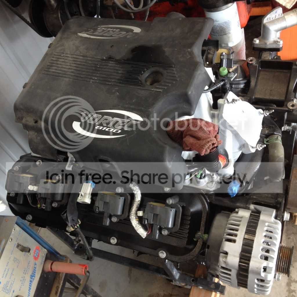

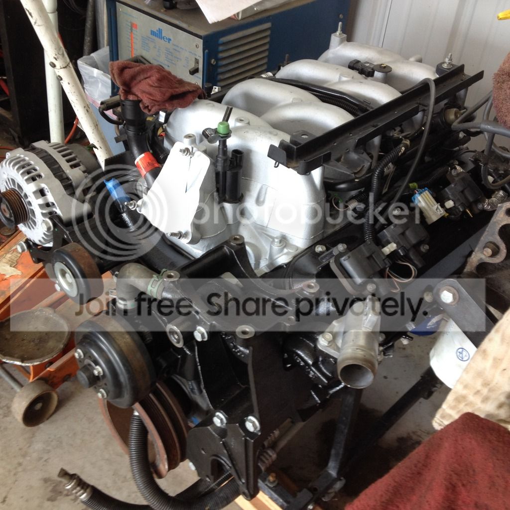

    Hmmmm, finally found an 8.1.....
    [​IMG]
    [​IMG]
    [​IMG]
    [​IMG]
    2002 8.1L with 91k miles on it. Already has the workhorse brackets on it with the correct water pump, just need to get the correct harmonic balancer for the workhorse and the tensioner puller as that is missing. Also came with an L29 throttle body (no spacer yet so need to get that too) with the correct oil filler neck as Larry mentioned before (missing the stupid cap so need to get that and also Larry will probably notice that the plastic cover is the 2002 model, so if I want to run that and make it look clean I will need to get a 2004+ one to match the oil filler tube). So some odds and ends to still pick up on it but those are not bad. I will end up doing a Howell full stand alone now that I have this setup.
    I'm pretty freaking excited!!!

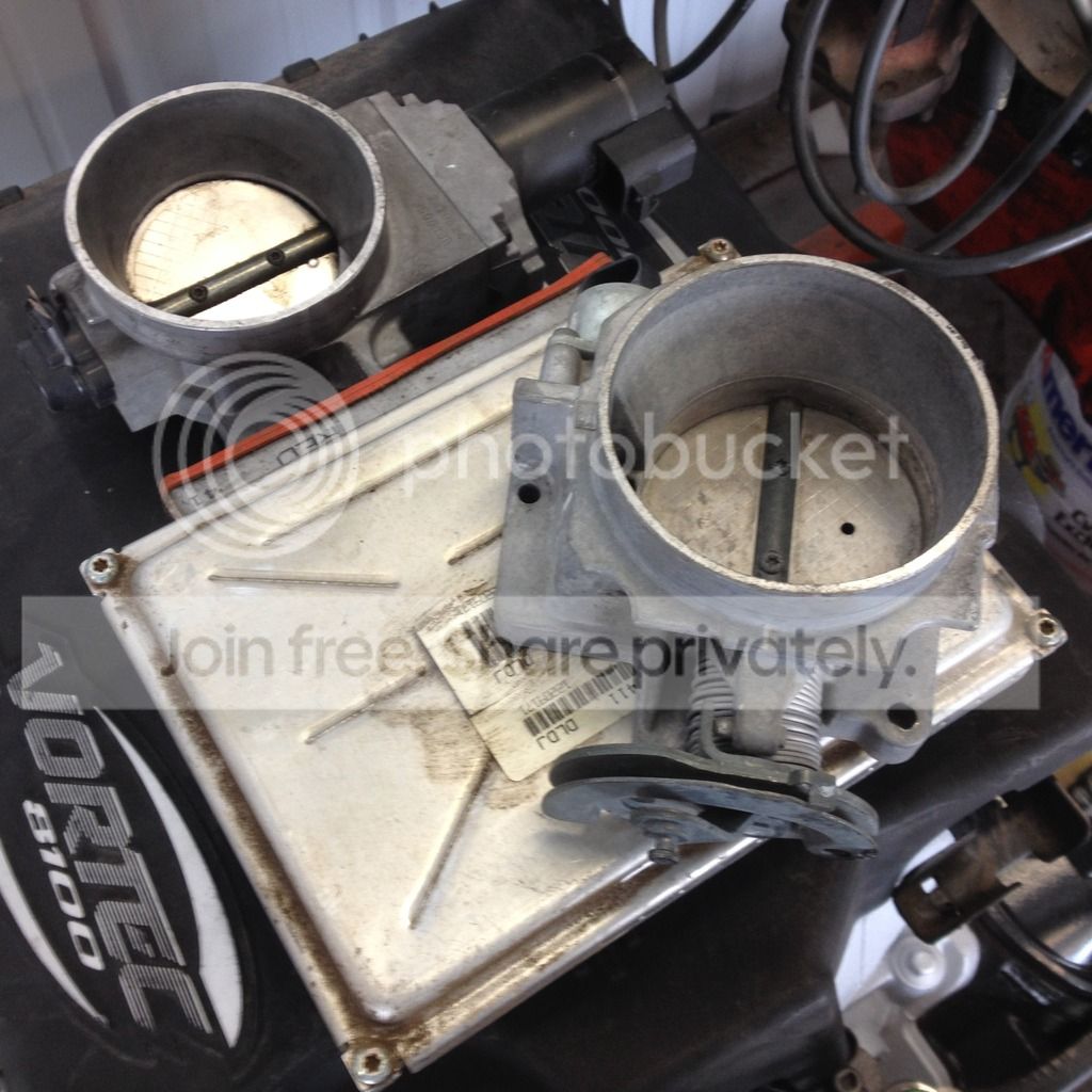

    Last 2 Howell 8.1 dbc tunes I have seen were 5.3 tunes with nothing properly corrected. Just a word of warning.

    Awesome! That thing looks clean! Congrats! The crank pulley/balancer that you need is part number 12555140
    My two L18’s run Howell tunes with 5.3L VIN numbers as well. Howell told me the reason was the fact I prefer to run mechanical throttles where the L18 never used mechanical throttle (outside of Marine L18’s running on MEFI-4 ECMs) so they use an early (99-02) 5.3L calibration that has the firmware to support mechanical throttle. Then they sprinkle L18 fuel and spark maps over that. I wouldn’t doubt the 5.3L VINs in most of their tunes also have something to do with the tuning software sham that where royalties are due for each individual VIN. I bet a dime to a doughnut the VINs in my Howell ECMs are the same VIN on the L18’s you “fixed”.
    Like I say, I am no tuner but I’ve dealt with enough of them to notice each tuner is better than the last, or at least they think they are. I can tell you this based on experience, the Howell tune for mechanical throttle body runs great. I’ve been running that tune in my K10 since 2009 (and about 35,000 miles) and it runs circles around my stock 2001 Silverado HD’s L18. Unlike the live tune I paid $600 for in Colorado Springs (that has now been replaced along with big cam) the Howell tune is a very smooth drivable tune with zero BS hiccups, mystery check engine lights, etc. It starts, runs and runs better much stronger than stock GM calibration. Can’t beat that for an out of the box tune even if it is based on a 5.3L plateform.
    Kay86K5 likes this.

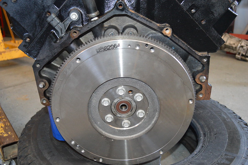

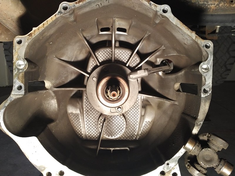

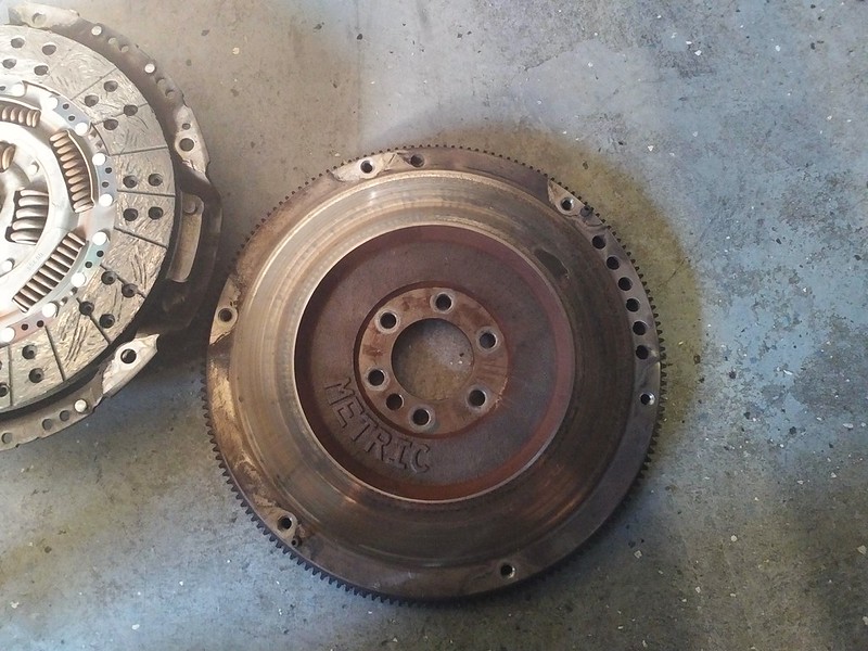

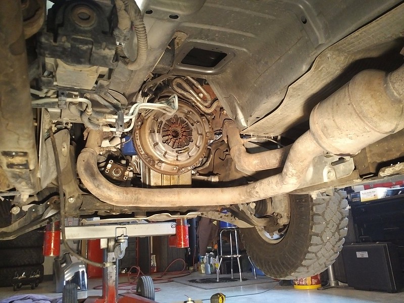

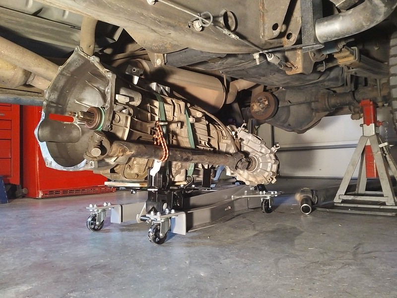

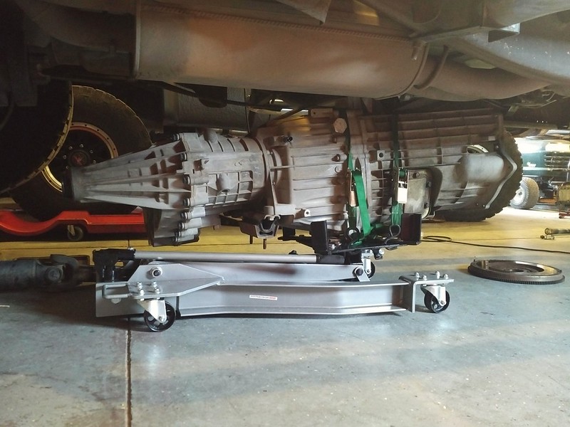

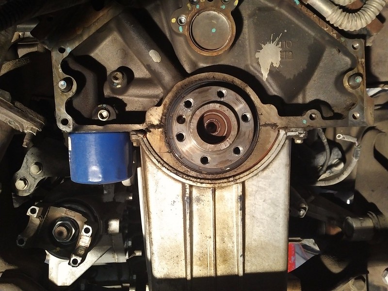

    Had to tear my 2001 Silverado down to replace a rear main seal. If anybody ever wondered what a Silverado HD ZF S6-650 looks like here you go….
    [​IMG]
    [​IMG]
    [​IMG]
    GM flywheel part number 12582964. Now here is something odd, the 12582964 I used on the 8.1L in the K10 and Suburban look different. This is the first 8.1L flywheel I’ve ever seen with the big “METRIC” on it but this truck is a very early GMT880 and L18. Build Date of 12/2000 which would have made the engine production around Sept/Oct 2000
    [​IMG]
    For comparison sake here is the service replacement 12582964 that are in the K10 and Burb
    [​IMG]
    Another interesting thing found is this truck did not come with downstream O2 sensors. I don't think I ever remember anything about the L18's no having having them. I've own this truck since new
    [​IMG]
    Pesky oil leak
    [​IMG]
    y5mgisi likes this.
